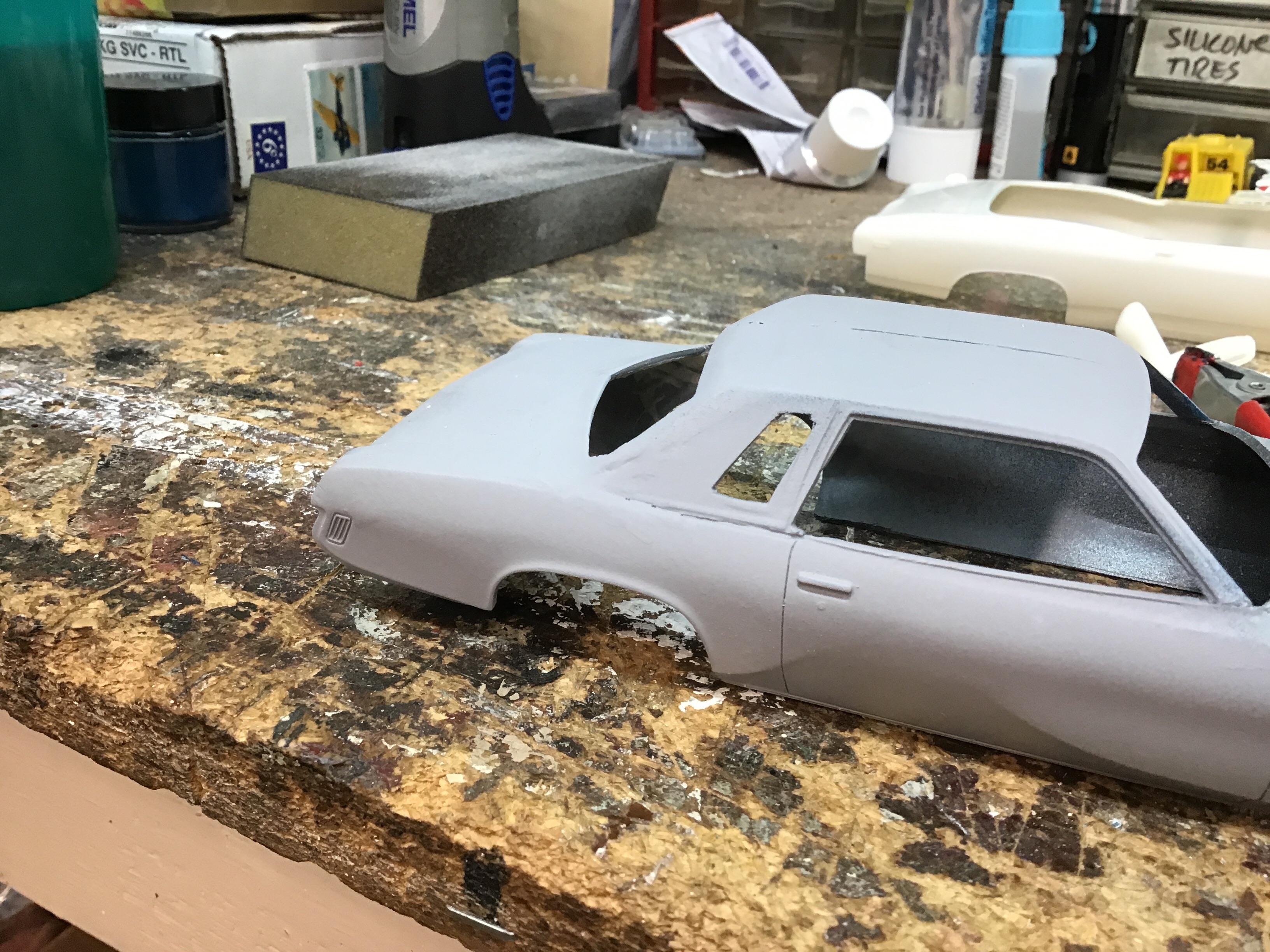

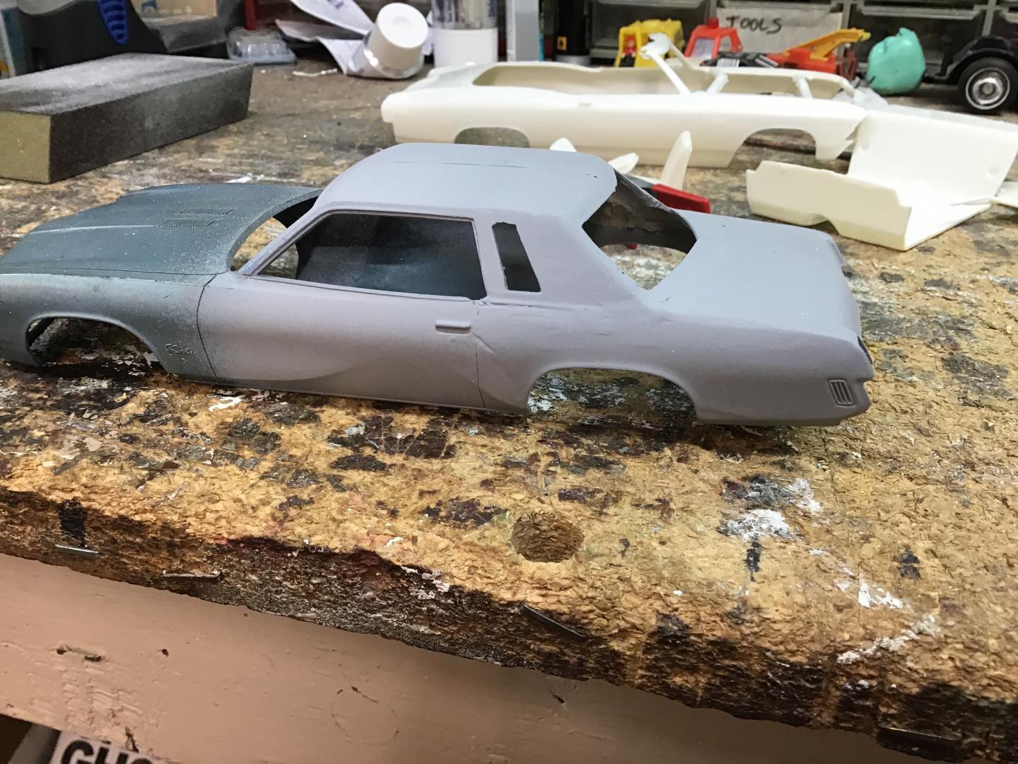

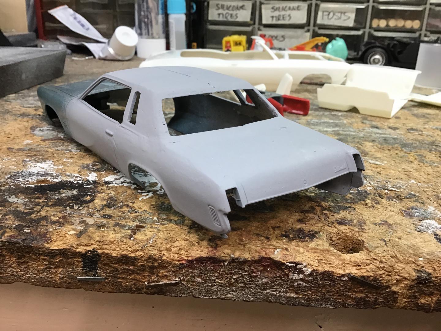

I think that one of the reasons the roof appears different between the Olds and the Chevy has more to do with the shape of the Quarter Panels. The Chevy has very pronounced flair/arch over the rear wheel opening and the Olds it is much smoother. Outside of measuring actual cars, I think if you just hold a finger or two over the body portion in the above pictures you will get the idea. My own thought is that it would cost GM far to much to have this much difference in roof panels between two models based on the same basic body.
Looking at the photos the Cutlass certainly looks as if it has a more leaned back rear window with different shaped opera windows. I cut a pie shape out of the back and leaned it forward as was suggested here and stared to reshape the opera windows. I think it looks much cleaner and more like a Cutlass roof line! What do you guys think?
Phillip, that definitely looks better! You're still working on it......those cars had sharp corners in the upper rear window. That's one of those things in my book that give a roofline an "attitude". Think GM 1959-'60 B body Bubbletop hardtops and opposed to 1961-'62. Sharp corners as opposed to rounded corners.
A change I'd make........the rear window could maybe be a bit shorter. This'll also raise the lower part of the vinyl roof just above the beltline at the trailing edge of the doors----not quite level with it. I know------I notice subtle things too much! A complaint my Mom had of me when I was a kid. :P
Also, don't forget to make the lower corners on the beltline at the trailing edge of the doors a bit more rounded. That's one detail that Revell forgot on the Monte Carlo, or at best sort of halfway attempted it.
Keep up the good work!
When I leaned it forward I tried to keep the rear window the same, it didnt work out well! Do you think I should shorten up the rear window by adding plastic at the bottom of the window? That was my first thought. I havent looked much at the doors cause I was more focused on the rear roof portion but I will round the door corner out, that would look way better. What do you think about the shape of the opera windows? I dont want to overshoot these! A lot of this is learning for me, I would like to do a couple of other cars from the late 70's. The red Cutlass in the background I would like to make or at least attempt a 77 Olds 442 using some of the Salvino nascar body parts.

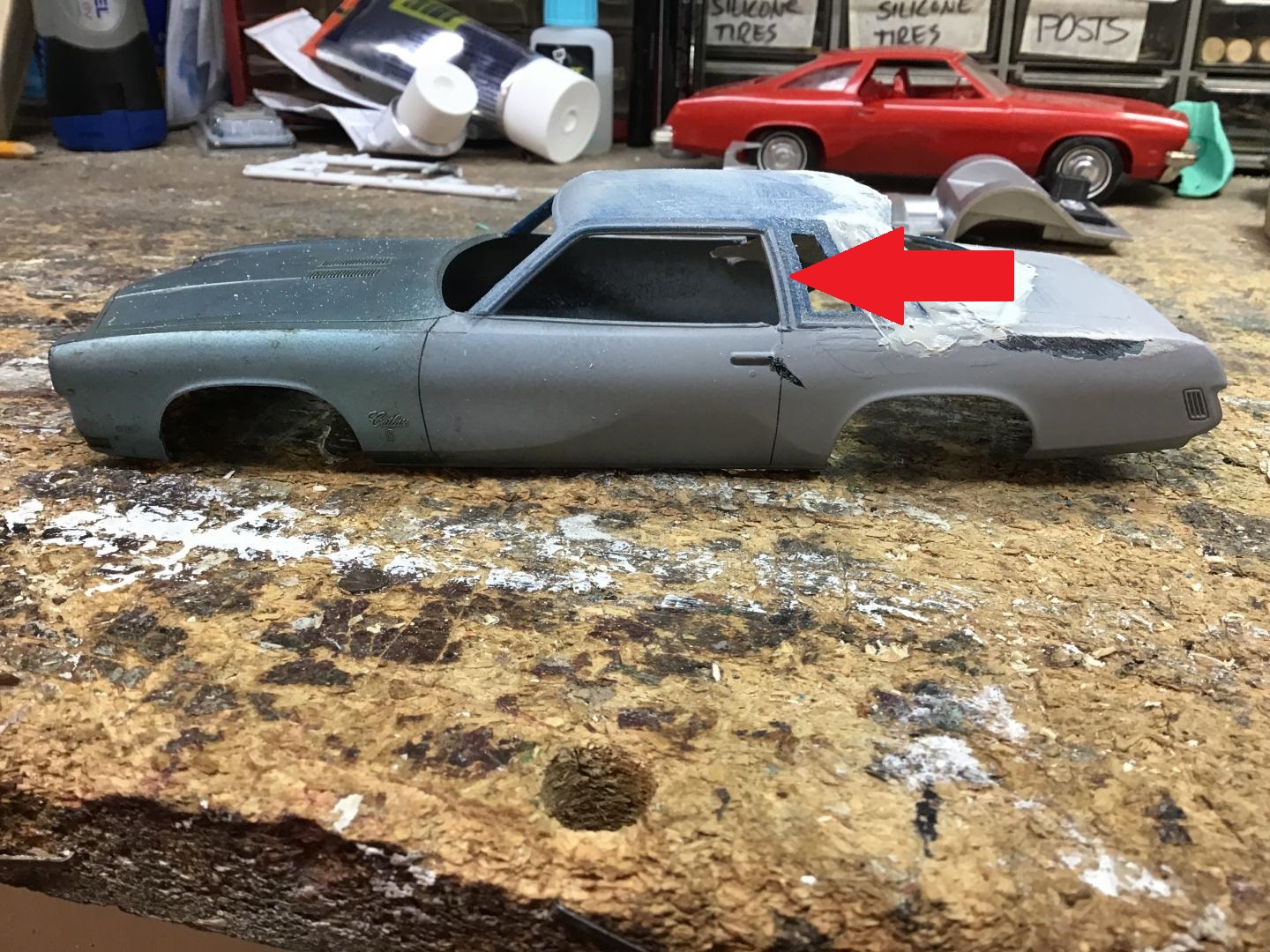

I think the B pillar needs to slant forward more as well.
It does look like it should be more slanted, I think I might try and shape that a bit better. Thanks for the tip!

Yes, I would add some plastic to the bottom of the window to shorten things up. Perhaps a scale inch or two? At the same time, I'd shorten the side windows just a teeny bit. The shape is very good---------they are trapezoidal like the 1:1.
Yes, I agree. If you take a look at the red car you have in the background, its B pillar has the correct slant. Of course it's also a Johan and they were at the top of their game once upon a time when it came to body shape accuracy.
I agree, I suggest adding a wedge shape to the front of the B pillar and blend it into the body. Then sand the shape to the correct angle. Then open up the front of the quarter window to match the angle of the new B pillar.

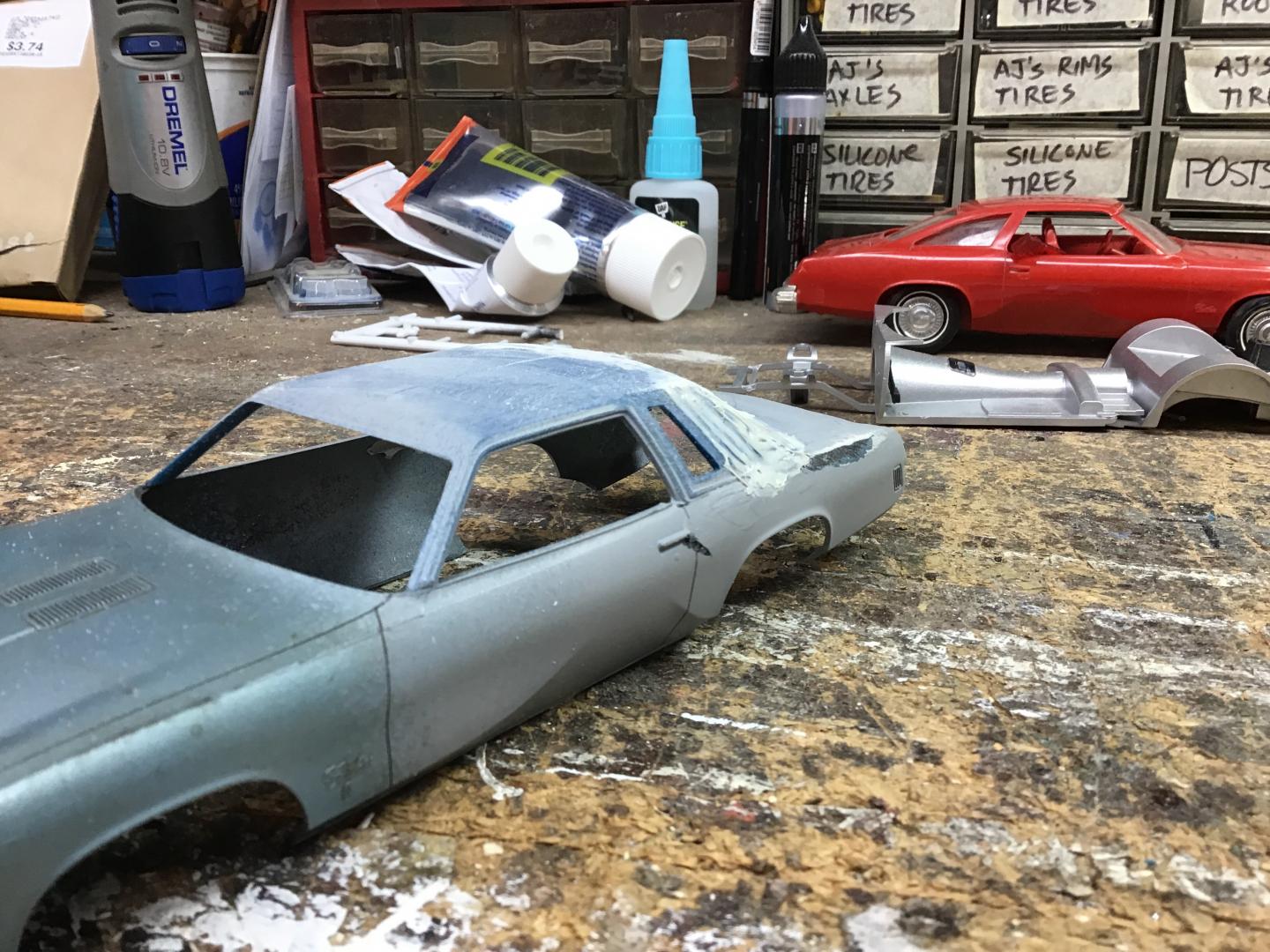

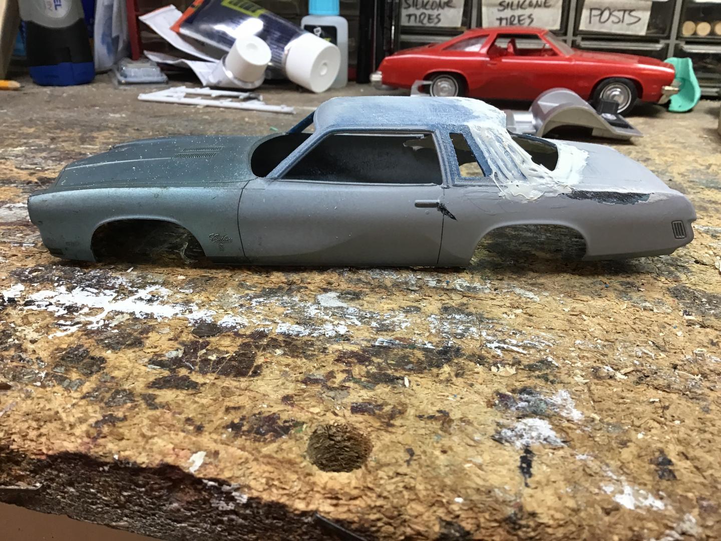

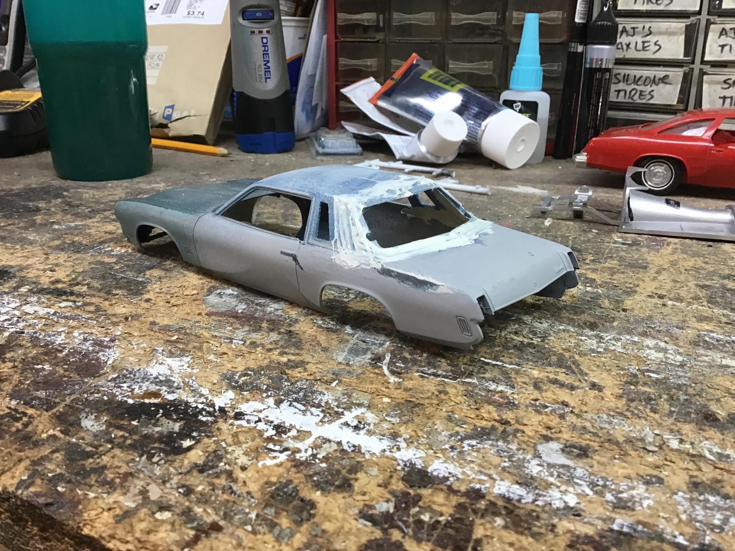

I did some more work on the roof, what do you guys think? It’s still very rough but coming along. I think I need a edge/crease at the top of the quarter panels where the roof flows into the trunk but not sure of a good way to do that. Any suggestions?
Roof slope looks better, but I think you're rear window opening goes down too far into the tulip panel area. There should be a bit of metal that curves up and the window doesn't need to be that big. (See my Buick above, for the example).
As soon as I can find it, I will post pictures of the Cutlass Supreme I've started and show you how I resolved the roofline crease you're talking about. Its subtle, but you're right - it is there!

Use your red Cutlass as a guide for the angle of the B pillar and the shape of the side windows will follow.

Thanks for the pictures! This is the area (above on the yellow car) where it doesnt look right on my model. My roof is a bit wide at the base and I dont think I can correct it easily. I was going to try and file this shape along the bottom of the vynyl roof and the crease at the top of the rear quarter panel but I dont know if it will work.
If it were me trying to shape this, I'd add some plastic to the side of the quarters and work from there. You can shape and sand to whatever contours you need.........you'd have enough of a base to do so. ;)

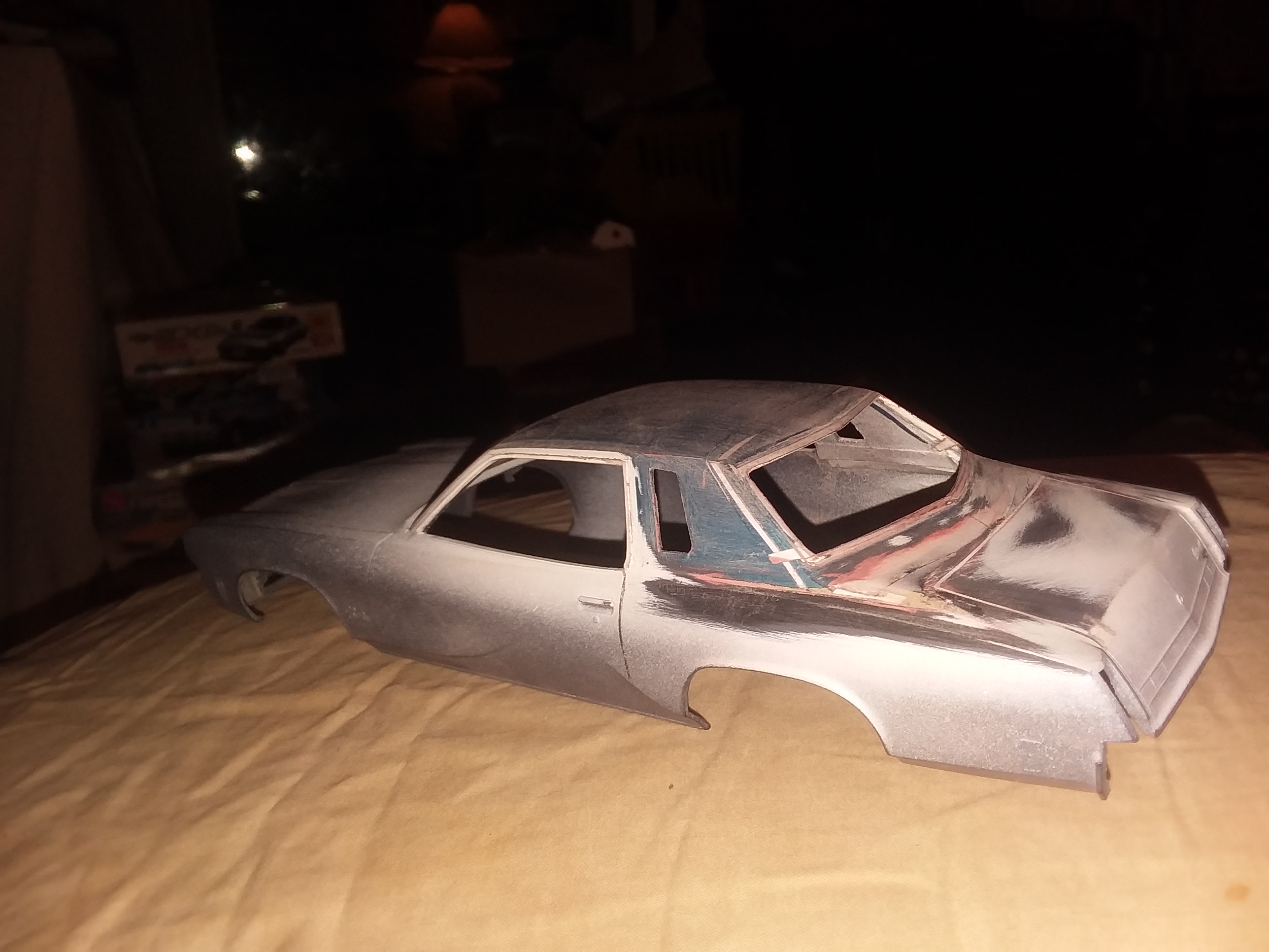

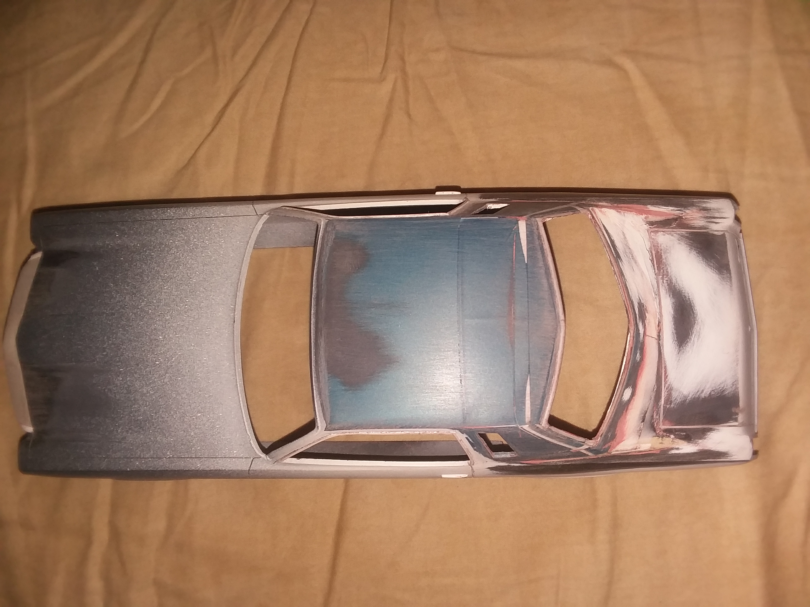

Here's my Oldsmobile roof conversion so far.
The body has little primer so you can see the mods.
And the nose mods for a '75
