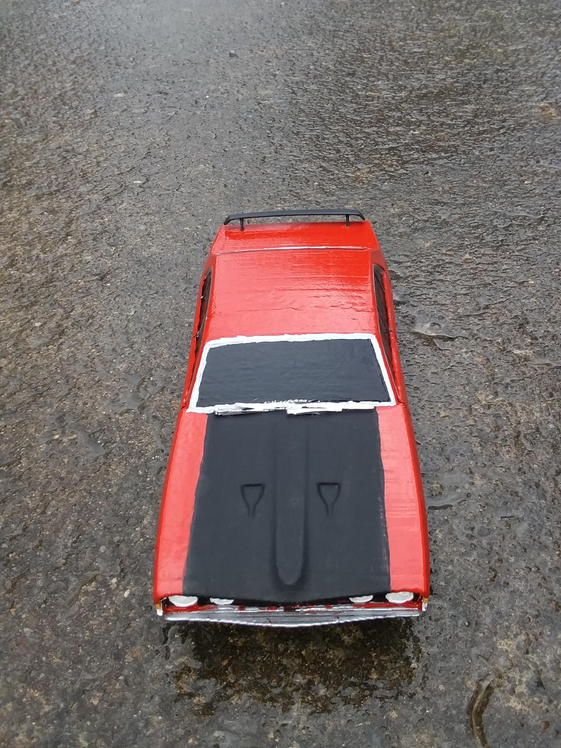

here is my 1/25th scale 3d printed 72 ford falcon xa sedan kit
i have a few more of these 1/25th scale 3d printed ford falcon kits comming soon
i added the trunk spoiler  and the wind shield wipers
it had rained earlier in  morning and i just took these pics a few minutes before posting them
Neato! I think it's pretty cool that we're starting to see the early days of hobbyists printing entire model cars for themselves.
For the next ones you print, I'd suggest maybe skim-coating them with a layer of 2-part body filler (like Evercoat, etc) and sanding  to smooth over the terraced deposition pattern! It will help create a smoother base for gloss paint.
Very nice work on an iconic Aussie car.
As Spex84 said, some body filler to remove the transition lines especially in the roof & boot (trunk) lid. As you can see by the pic the side windows need some help. The picture is of a GTHO Phase 4, one of 4 made.
thanks i coated it with 2 coats of duplicolor filler primer for deep scratches  and  since the body was printed in two halves i had to use thin peices of plastic to fill in the gaps were the two halves did not join pefectly then had to trim away the rest of the rest of the thin plastic and sand it down  then shot it with normal primer

thank you  i was not going for the allan moffat xa sedan but a normal everyday non racing  xa sedan  i did like the black hood and lower body paint against the red  paint

Thanks Michelle, I posted that pic just to show how "off" the side windows are. I agree, these cars look good in these colours. I'm not part of FB but thank you. There was someone doing a 4 door conversion awhile ago that incorporated the Aoshima kit, I missed out on that one. The Parts Box does an XB but they're 1/25.
