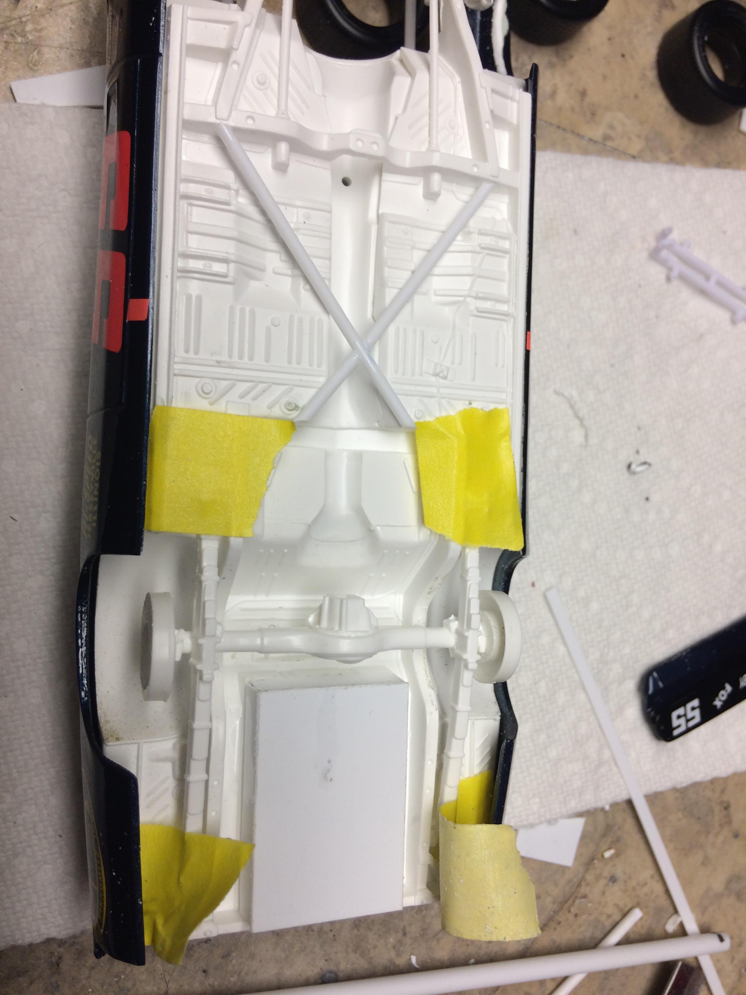

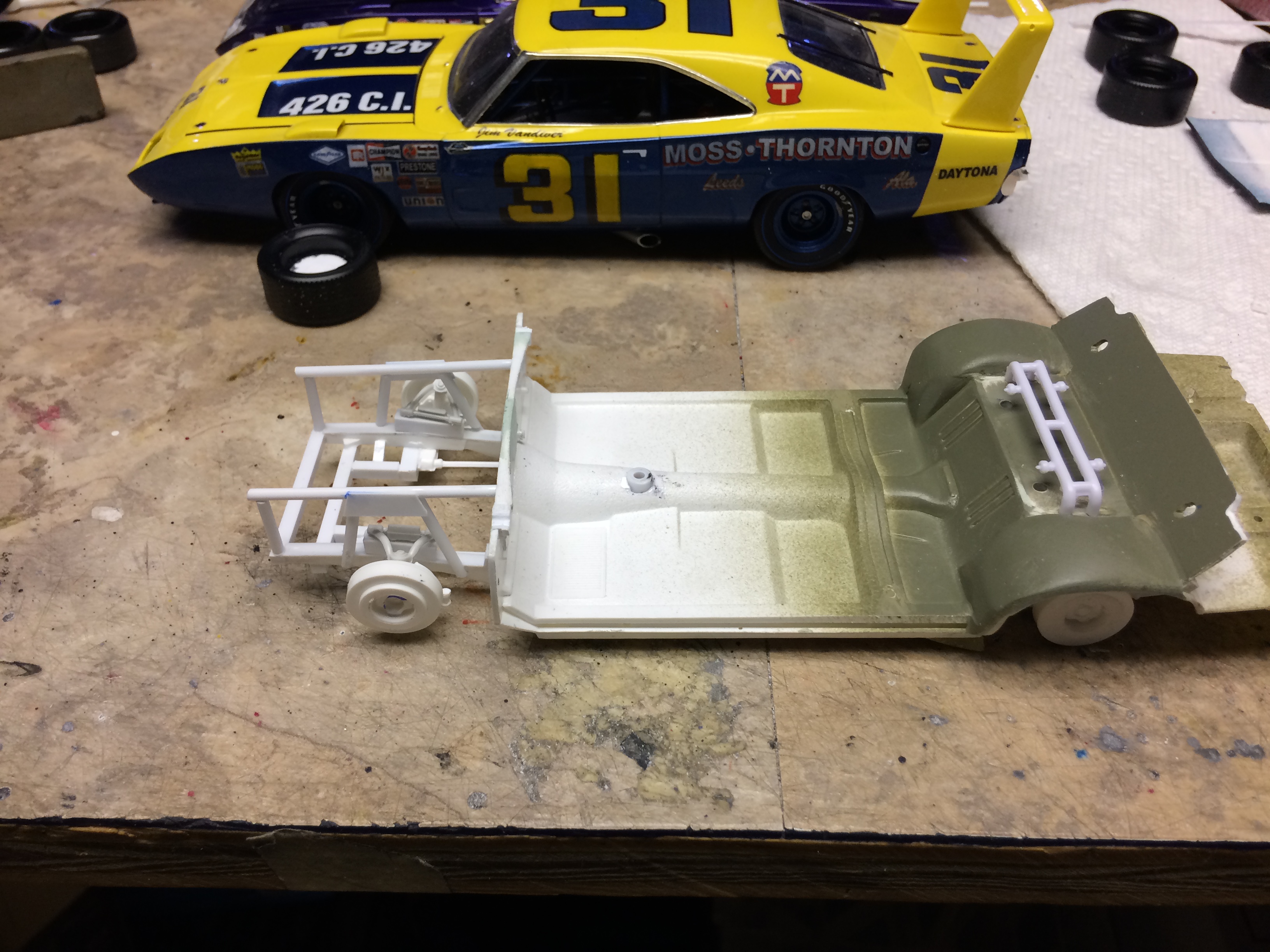

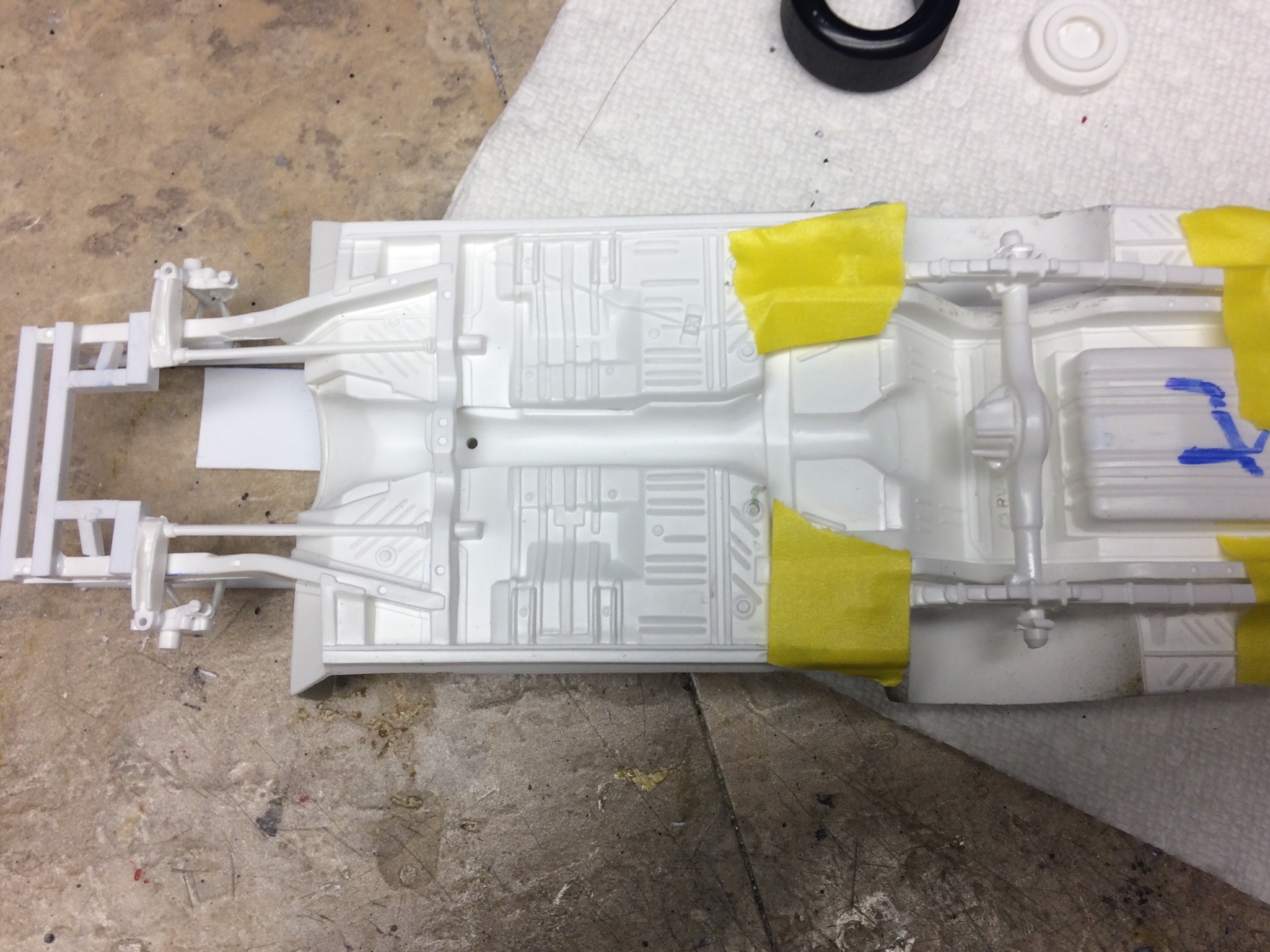

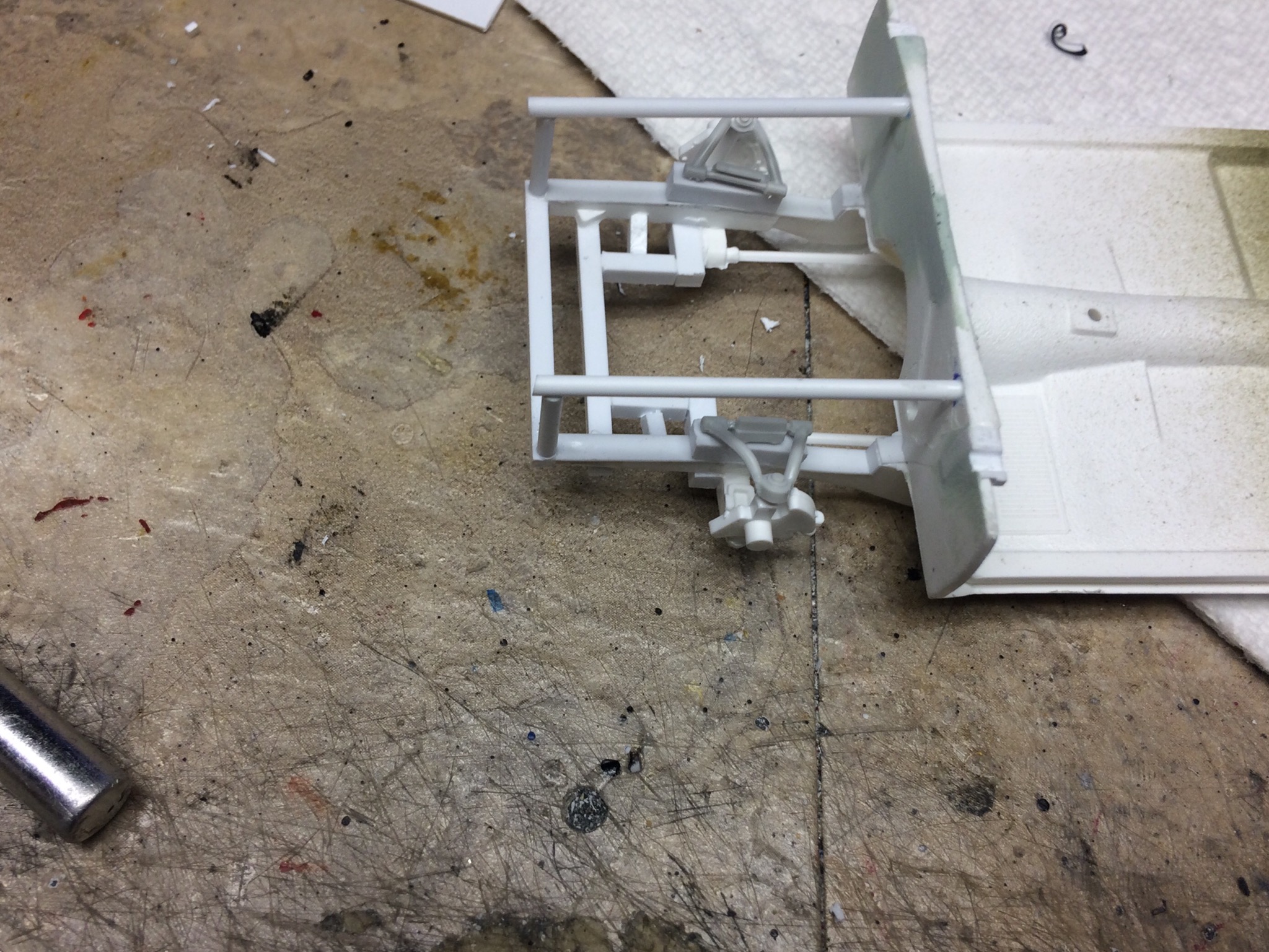

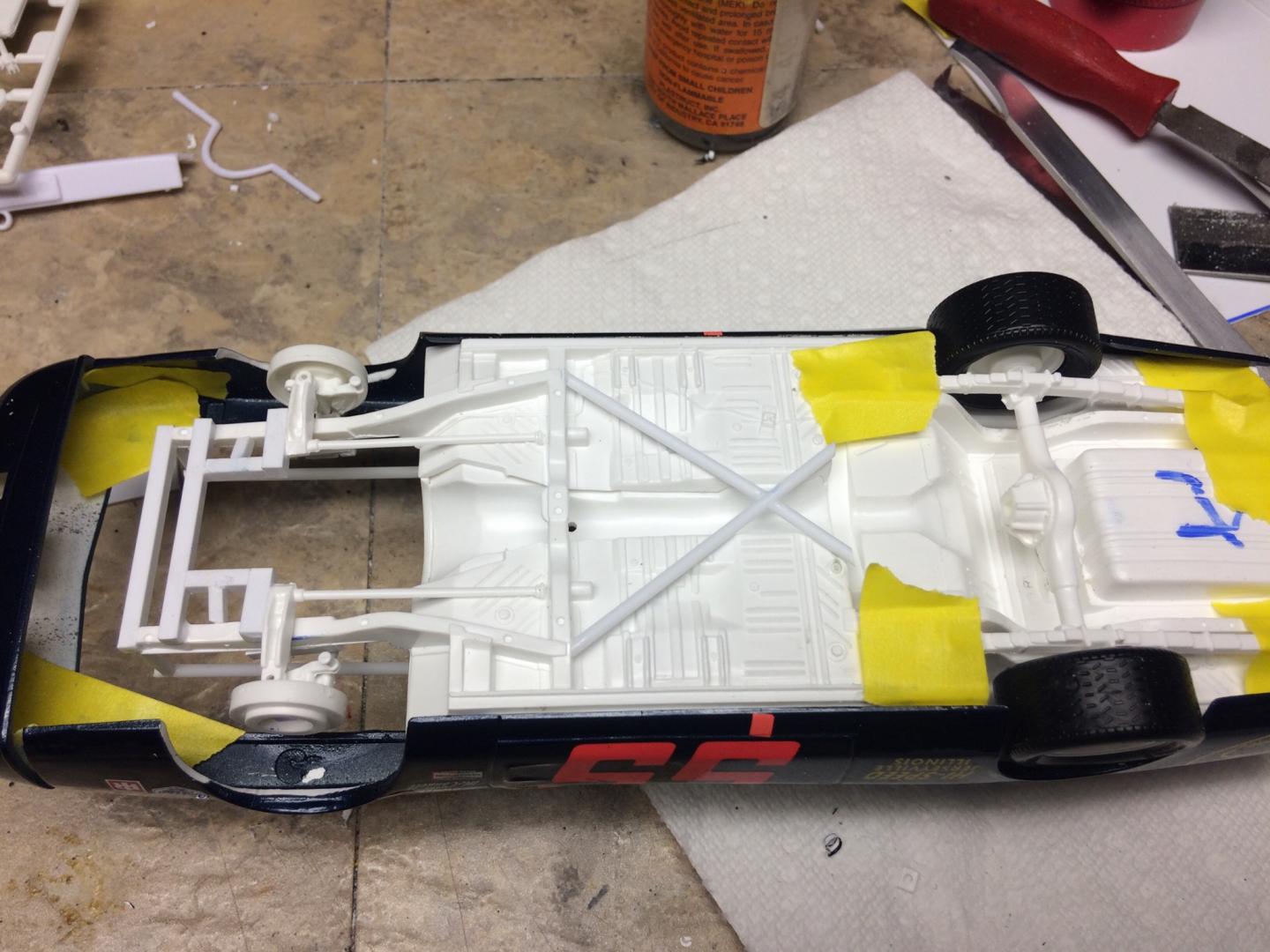

yellowsportwagon Posted March 23, 2019 Posted March 23, 2019 1 hour ago, fiatboy said: Was the Dodge Charger Daytona ever kitted with a proper NASCAR chassis under it? You know, roll cage, suspension, engine, wheels/tires, etc., etc. Thanks No! MPC did do some with a generic racing chassis but that’s as close as it gets. I make my own out of Revell Charger Daytona kits. Not too difficult if you like to scratchbuilt. Here is some in progress pictures I’ll see if I can find some further along pictures.

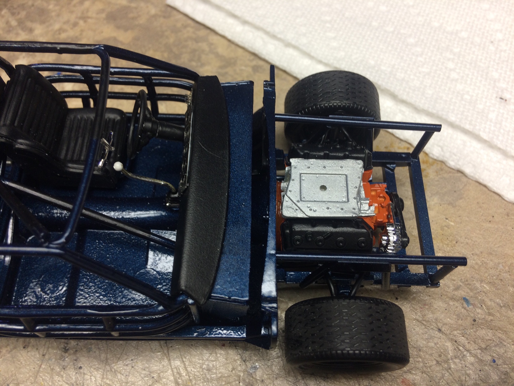

yellowsportwagon Posted March 23, 2019 Posted March 23, 2019 Here is couple more. The dash and rollcage are from a Polar Lights Talledega kit. Fits great to the Charger body.

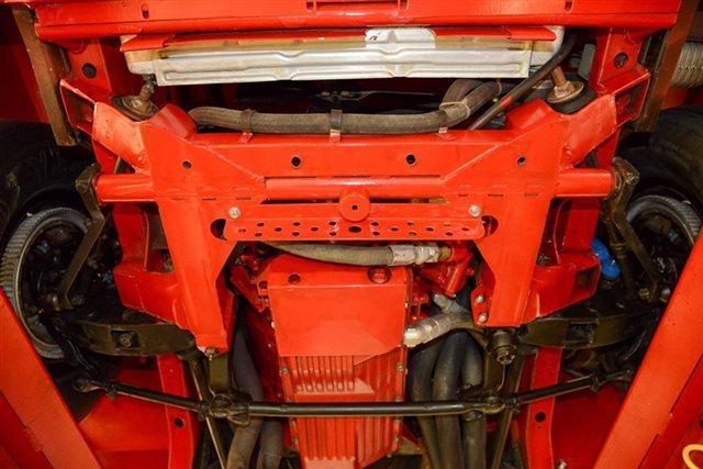

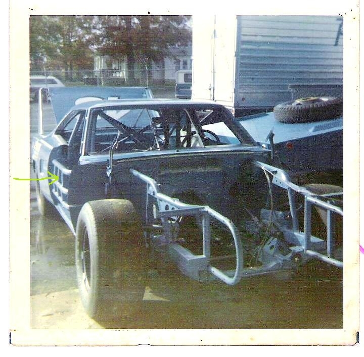

yellowsportwagon Posted March 24, 2019 Posted March 24, 2019 None of the kits ever had the correct frt bars and dabbed K members that the race cars had.
magicmustang Posted March 24, 2019 Posted March 24, 2019 (edited) 7 hours ago, yellowsportwagon said: None of the kits ever had the correct frt bars and dabbed K members that the race cars had. Still have my copy of SAE from Oct 1990 which has the article on how Doug Whyte converted a MPC Daytona Charger to a NASCAR version. See the PDF file below. whyte daytona charger.pdf Edited March 24, 2019 by magicmustang
yellowsportwagon Posted March 24, 2019 Posted March 24, 2019 1 hour ago, magicmustang said: Still have my copy of SAE from Oct 1990 which has the article on how Doug Whyte converted a MPC Daytona Charger to a NASCAR version. See the PDF file below. whyte daytona charger.pdf That’s ok but missing the fabbed K member that Nichels engineering added when they built these cars.

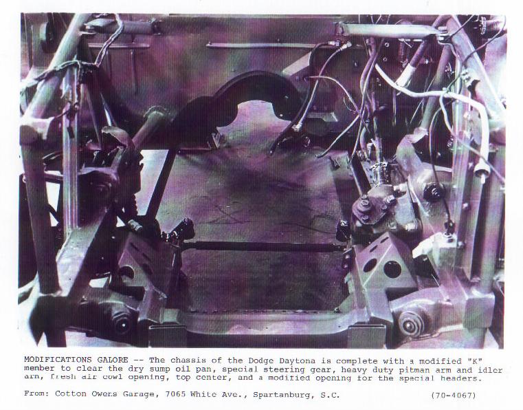

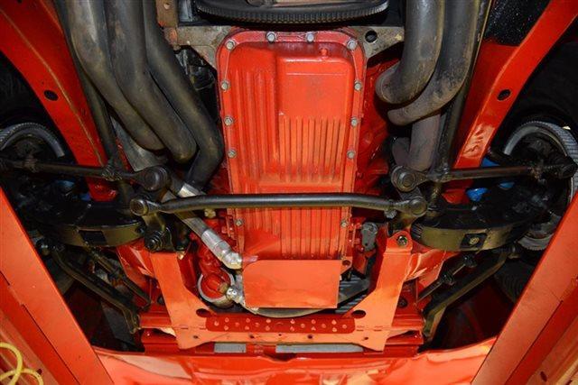

Force Posted March 24, 2019 Posted March 24, 2019 (edited) Is this the K-member you are talking about? Here is one from Richard Petty's car. Under the No 71 K&K insurance car or if it was the No 6 Cotton Owens car. Edited March 24, 2019 by Force
yellowsportwagon Posted March 24, 2019 Posted March 24, 2019 Yes 13 minutes ago, Force said: Is this the K-member you are talking about? Here is one from Richard Petty's car. Another version Under the K&K insurance car. Yes
