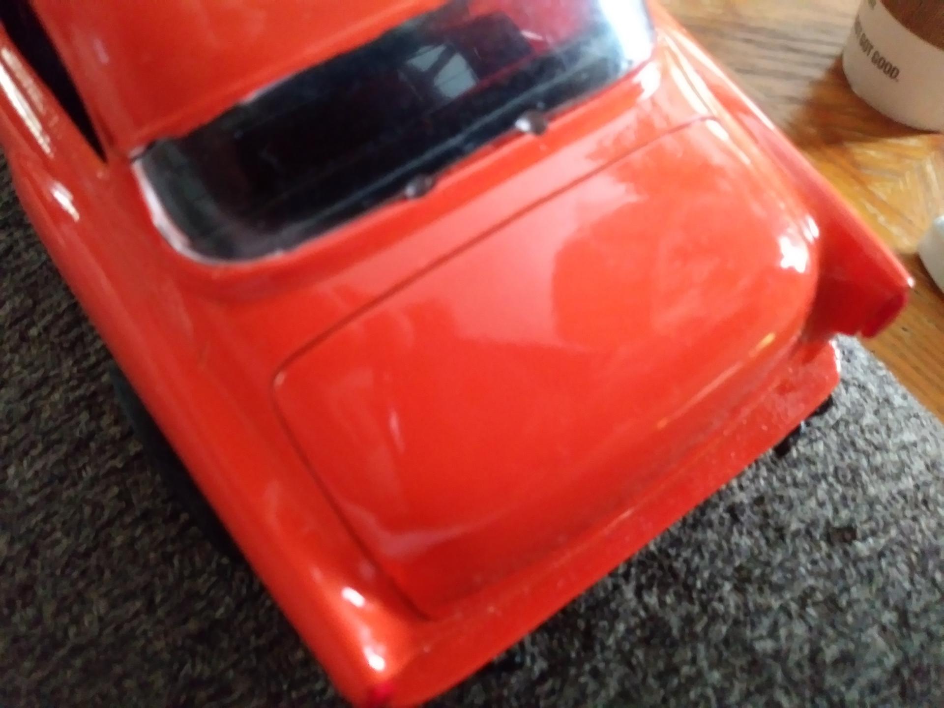

Scott8950 Posted April 1, 2019 Posted April 1, 2019 15 minutes ago, thatz4u said: Scott, can you give just wee bite more info on this subject please? i usually do a few light coats with about 10 minutes between then one heavier coat. i go over the car with a hairdryer and get the paint hot but not enough to warp or damage the model. I never polish them but i don't show them either. i just painted this 54 im sure its not up to everyone's standards but its good enough for me.
Scott8950 Posted April 1, 2019 Posted April 1, 2019 (edited) works great with or without primer. i tried to get better pictures but my phone can be stubborn at times. Edited April 1, 2019 by Scott8950
thatz4u Posted April 2, 2019 Author Posted April 2, 2019 looks great to me, how far away do you hold the dryer?
Scott8950 Posted April 2, 2019 Posted April 2, 2019 about 8 to 10 inches away. you want to get it hot but not hot enough to do damage. just keep it moving.

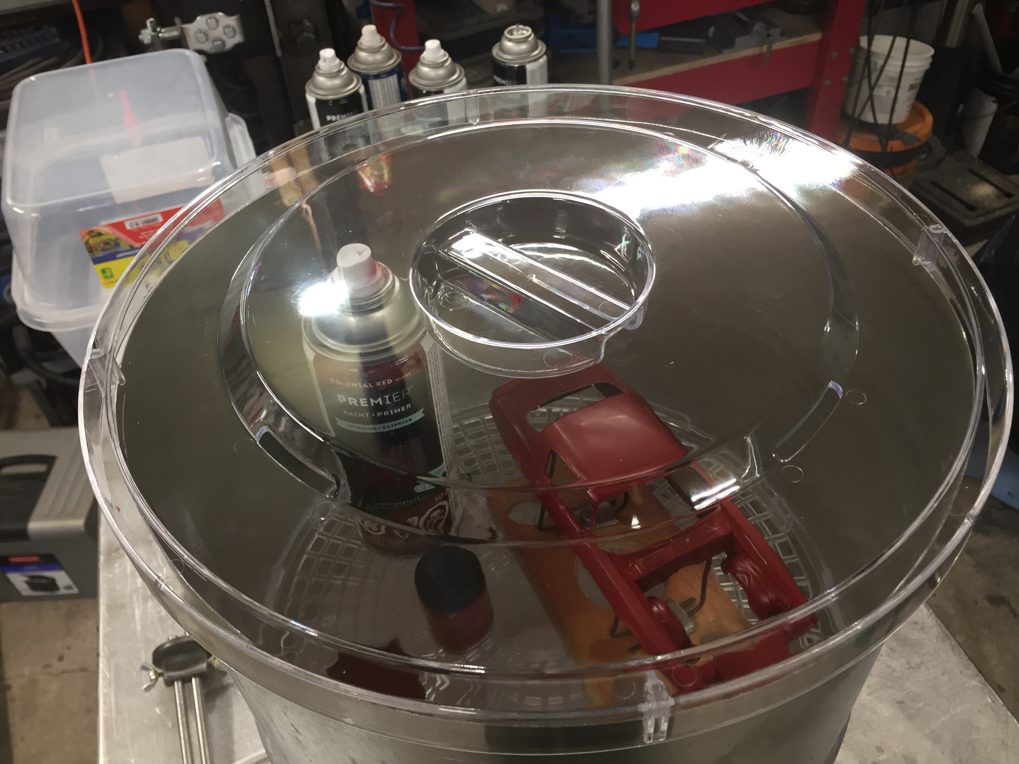

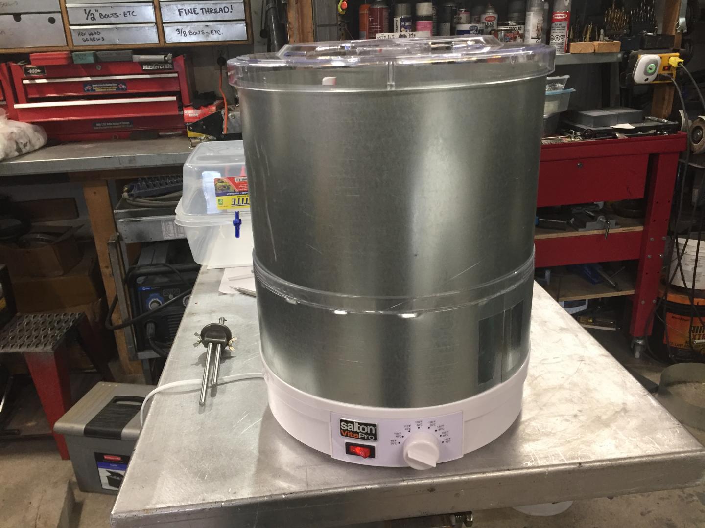

NOBLNG Posted April 7, 2019 Posted April 7, 2019 This winter I made an extension for my dehydrator and I put everything in there including the paint can to warm up before painting.
