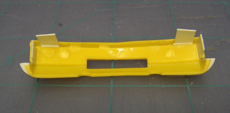

afx Posted April 2, 2019 Posted April 2, 2019 5 hours ago, djflyer said: I have heard of this but never tried it. Have you had any issues with shrinking or cracks over time? Do you use this instead of other fillers in certain situations only or most all of the time? I haven't had any issues with shrinking or cracking. I like to use it mostly to reinforce joints similar to a welder would use weld. I use it to reinforce joints when I make a roll cage or I will brush it on the backside of a joint that has very little contact surface. I also like to use it to build up edges, for instance if I need to change the shape of a wheel opening. I let it dry overnight then I can sand it just like virgin plastic. I built up the edge of this air dam (the white plastic) then sanded it to shape after it setup.

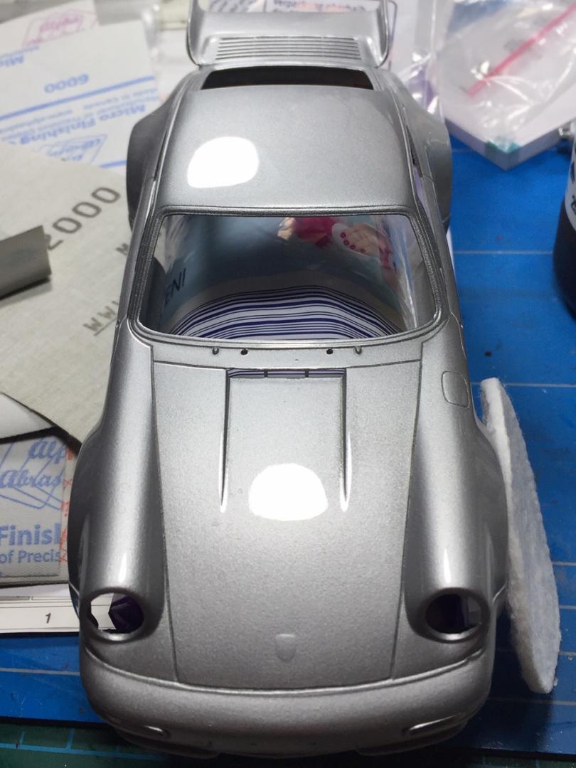

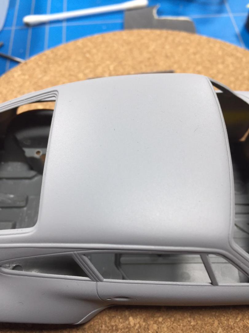

Tommy124 Posted April 3, 2019 Posted April 3, 2019 (edited) I have used this technique occasionally. IMHO the downside is that styrene/glue mix is likely to contain small bubbles which may appear no sooner than after sanding, making it necessary to fill and sand again. However, as we know that the application of glue helps to prevent ghostlines, this is a good way to go for filling panels lines etc. I did it on my Porsche in order to fill the sunroof lines and it worked well: 5 hours ago, peteski said: If applied to a clean plastic surface and sanded within few hours of setting up, it sands well. But if you wait a day or two, it is not so good (it sets harder then styrene). Of course I assume that you use accelerator to set the glue (I use the BSI brand accelerator). Yes, the CA is much harder than styrene once it's dried. That's why it's important to apply a CA layer as thinly as possible. See Dann's tutorial here: And as (almost) ever, Tamiya have a product solution to this: https://www.tamiya.com/english/products/87187/index.htm This is a "softer" type of CA, designed especially to be easily sanded... Edited April 3, 2019 by Tommy124
