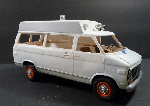

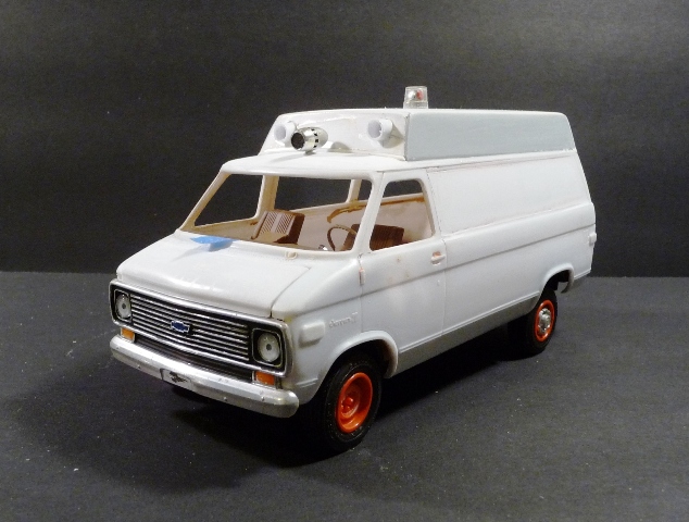

GLMFAA1 Posted April 16, 2019 Posted April 16, 2019 Easy to do, here are some of my old original release van the was fortunate enough to have the windows. Cut the roof above the gutter strip use evergreen plastic sections to make the side risers Some tubing used for the warning lights, use the roof for the top some putty will be needed greg
