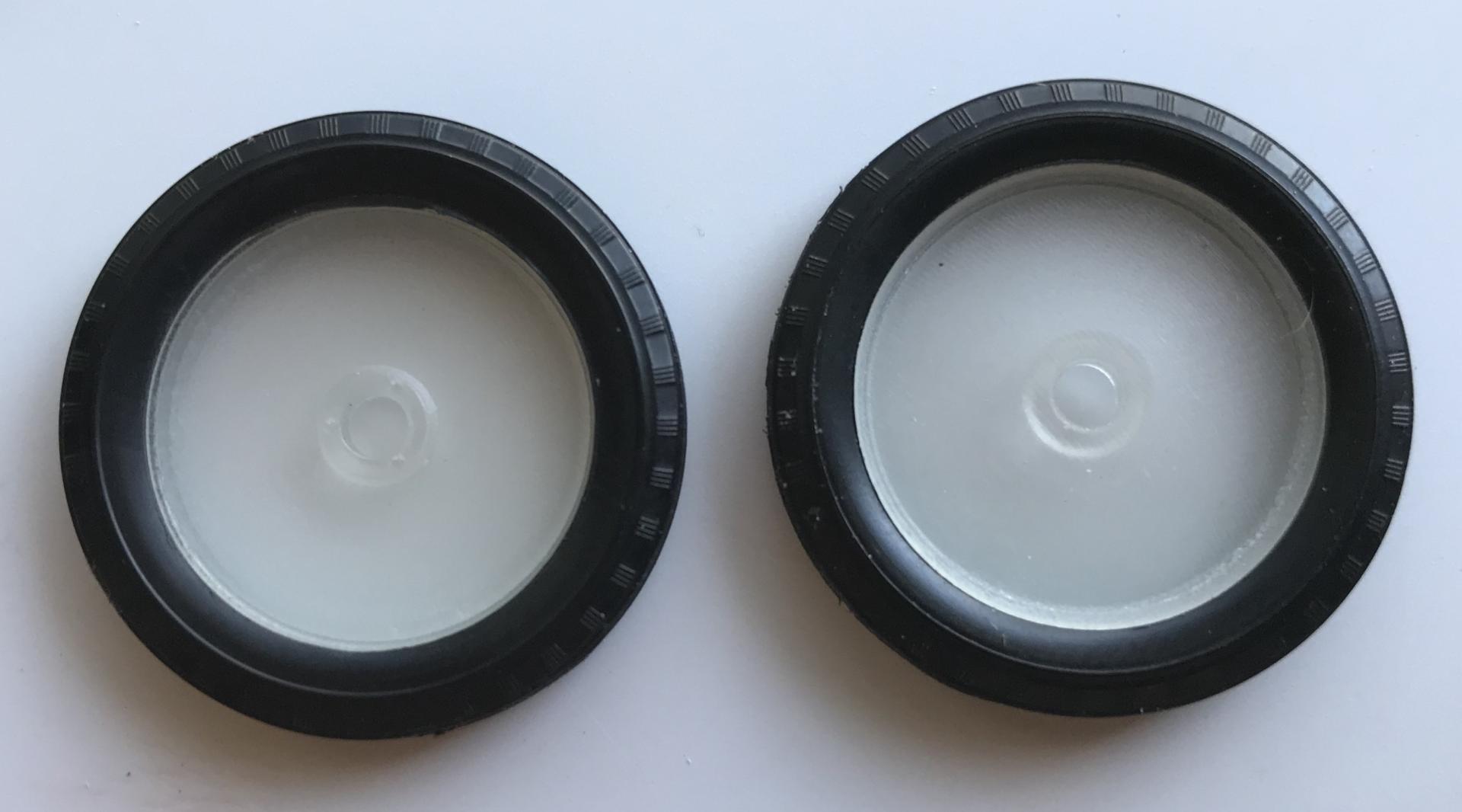

jaxenro Posted April 16, 2019 Posted April 16, 2019 Attached is a pic of the Disteel wheel I had printed for the Ford Model T ICM Speedster kit to convert it to Disteel disc wheels - these were a popular aftermarket item for model T speedsters. Going to have some resin copies made it is a bit hard to see the details once I get the paint on them they will pop more but they match the prototype photo pretty good. Shown with the tire from the speedster kit
Mr. Metallic Posted April 16, 2019 Posted April 16, 2019 Is the tire separate from the wheel? They look pretty nice so far
jaxenro Posted April 16, 2019 Author Posted April 16, 2019 (edited) Yes I had the wheel printed the tire is from the ICM kit. I am going to have one printed in brass (technically they print in wax then do a lost wax casting) and use that to make resin copies. The brass is smoother than the plastic when printed and takes and holds details really well Shapeways uses it for jewelry I don't have other model T kits in 1/24 or 1/25 to see what the wheels fit but it should fit many of the early style skinny tires like this Edited April 16, 2019 by jaxenro

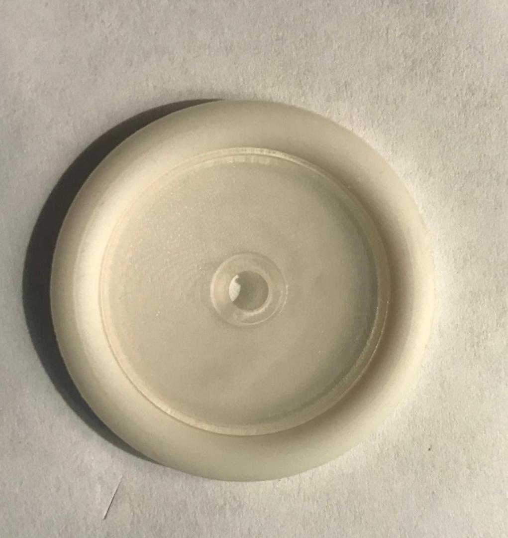

jaxenro Posted May 2, 2019 Author Posted May 2, 2019 (edited) These fit the 1927 AMT T touring car kit tires. The other AMT T kit is slightly larger and will be a little loose but if I make the wheel any large it won’t fit these so I am going with this will post when the resin copies are ready Edited May 2, 2019 by jaxenro
