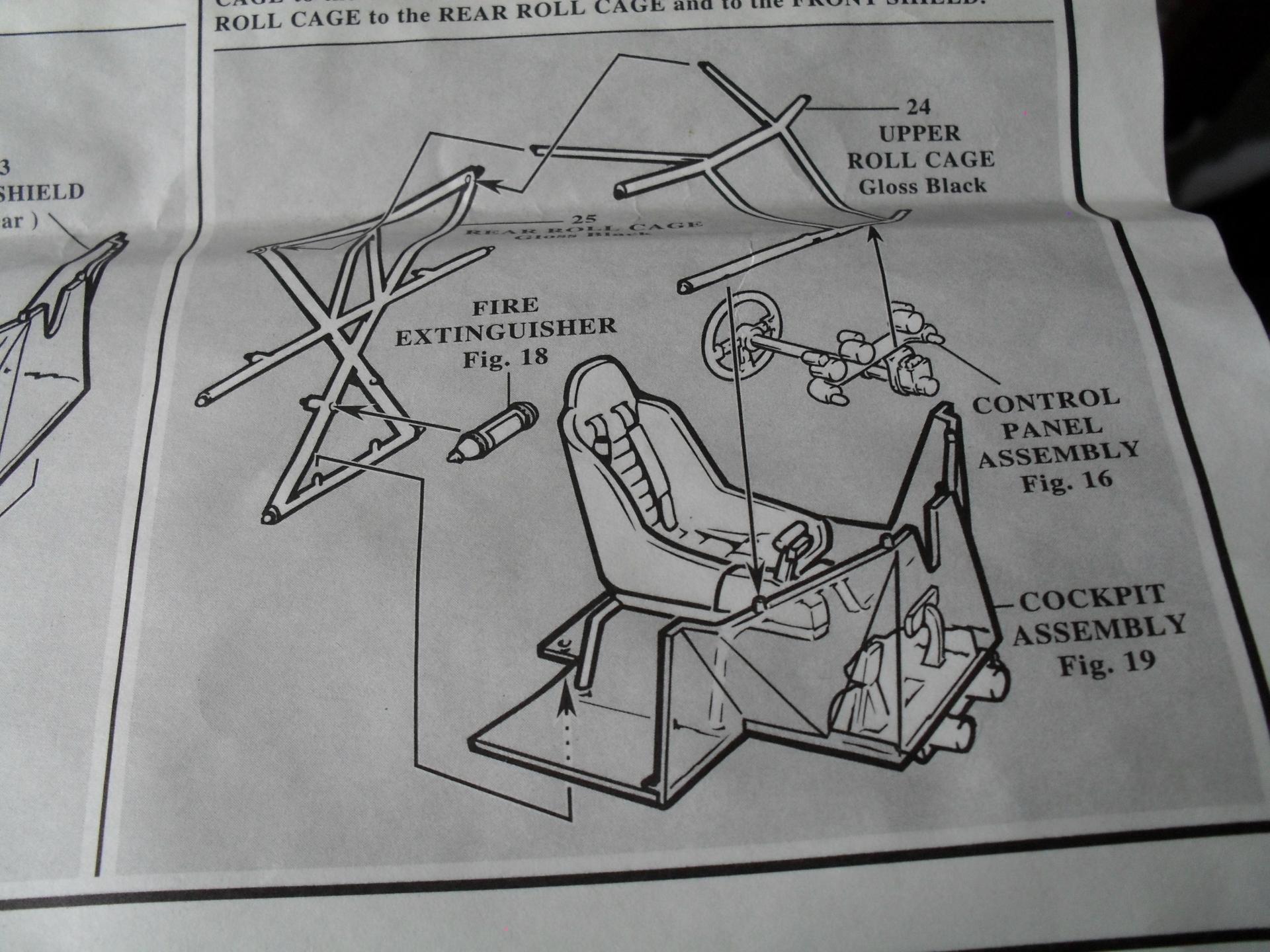

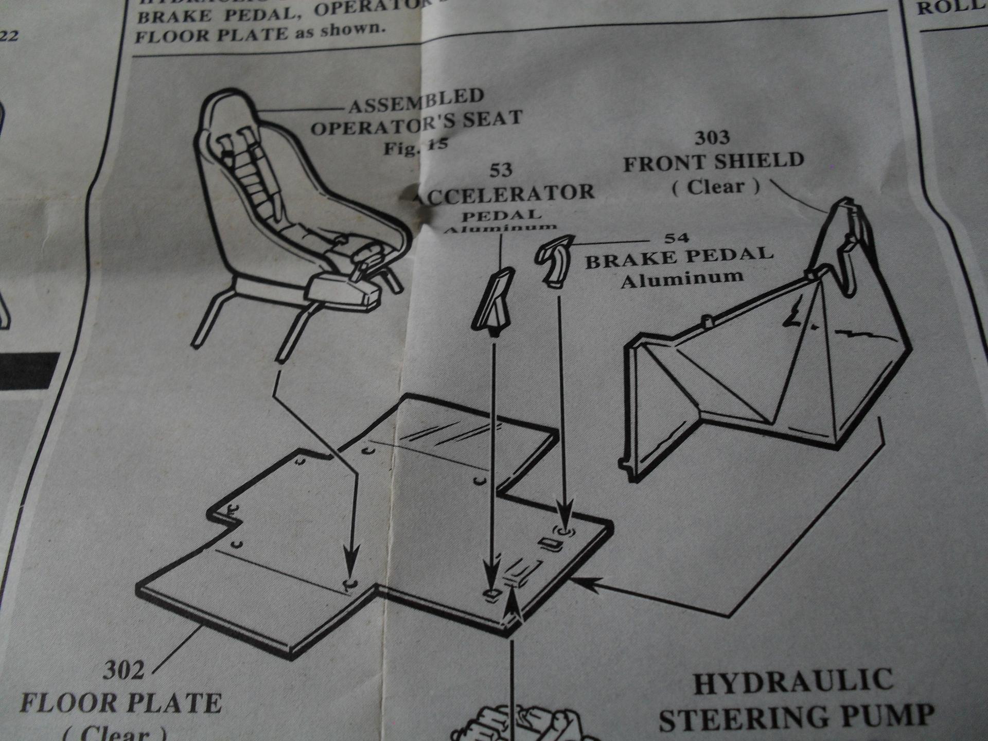

R.D.F. Posted April 27, 2019 Posted April 27, 2019 Hi Putting together a model I have had for years, Big Foot monster truck. The cockpit is clear and I am using Testors clear parts cement. I understand this is a type of wood glue but I need something with more strength because I have to clamp the roll cage to it when I glue the cage in place. I'm using rubber bands to do this I guess I'm going to answer my own question and say to use clear epoxy. Here are some pictures of the construction. Thanks
