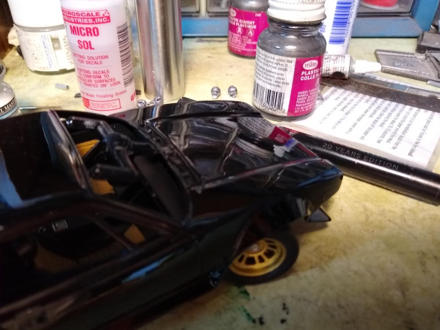

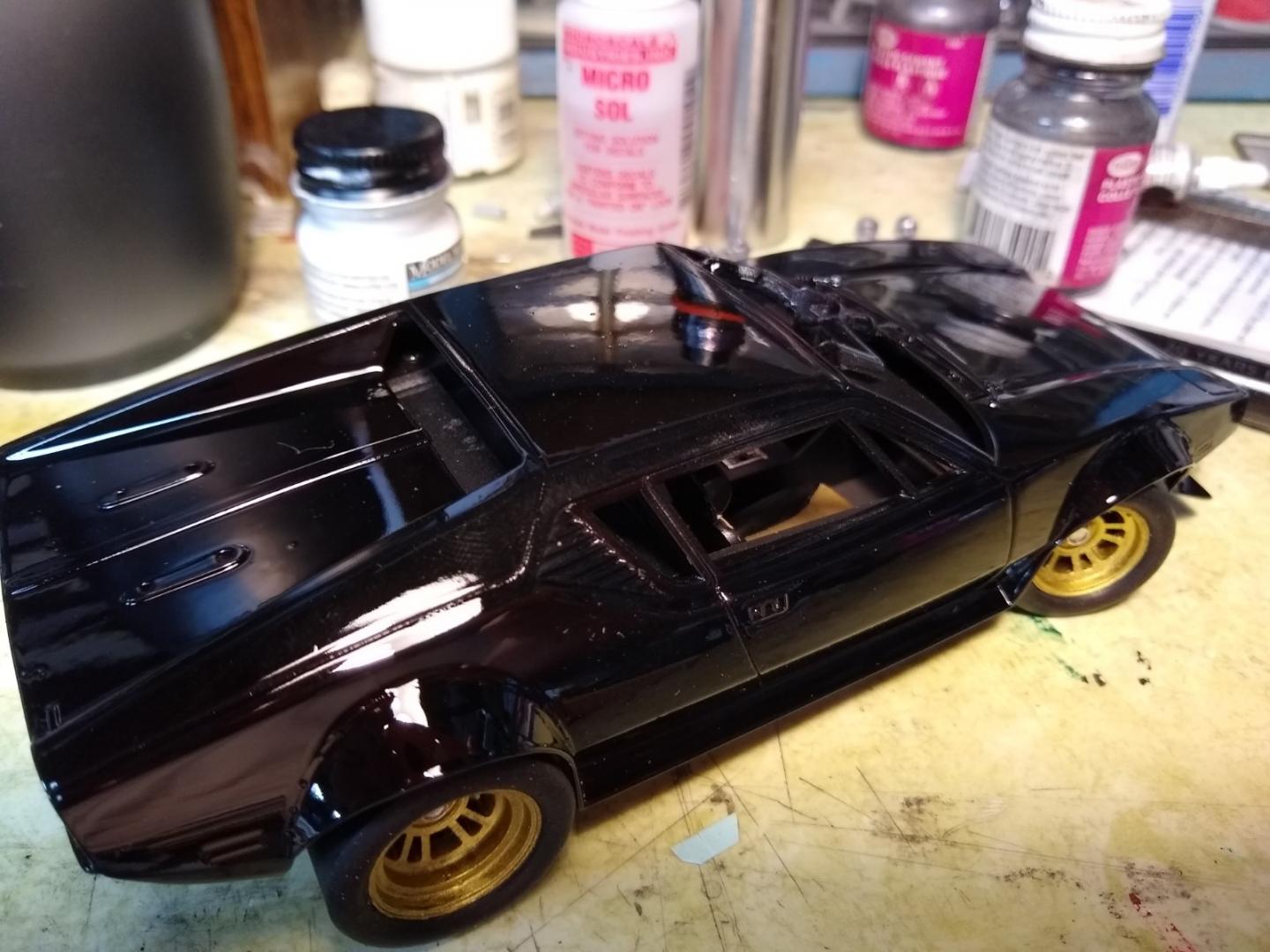

Tommy124 Posted May 7, 2019 Posted May 7, 2019 23 hours ago, MrObsessive said: Certain plastics may warp sooner than others so yeah.......you want to keep an eye on any bodies you put in there, especially if anything is opened up. You surely have a point there, Bill. The first kit I dried some days ago (the only one so far) is an old Monogram one from 1984, the thick stuff I like to call "panzer plastic"... Surely needn't worry about anything warping in that, but with modern kits, Tamiya, Hasegawa etc. - they certainly have softer plastic. And I agree on keeping an eye on the process every once in a while, better to be safe than sorry...
