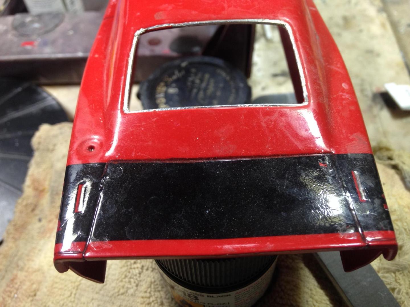

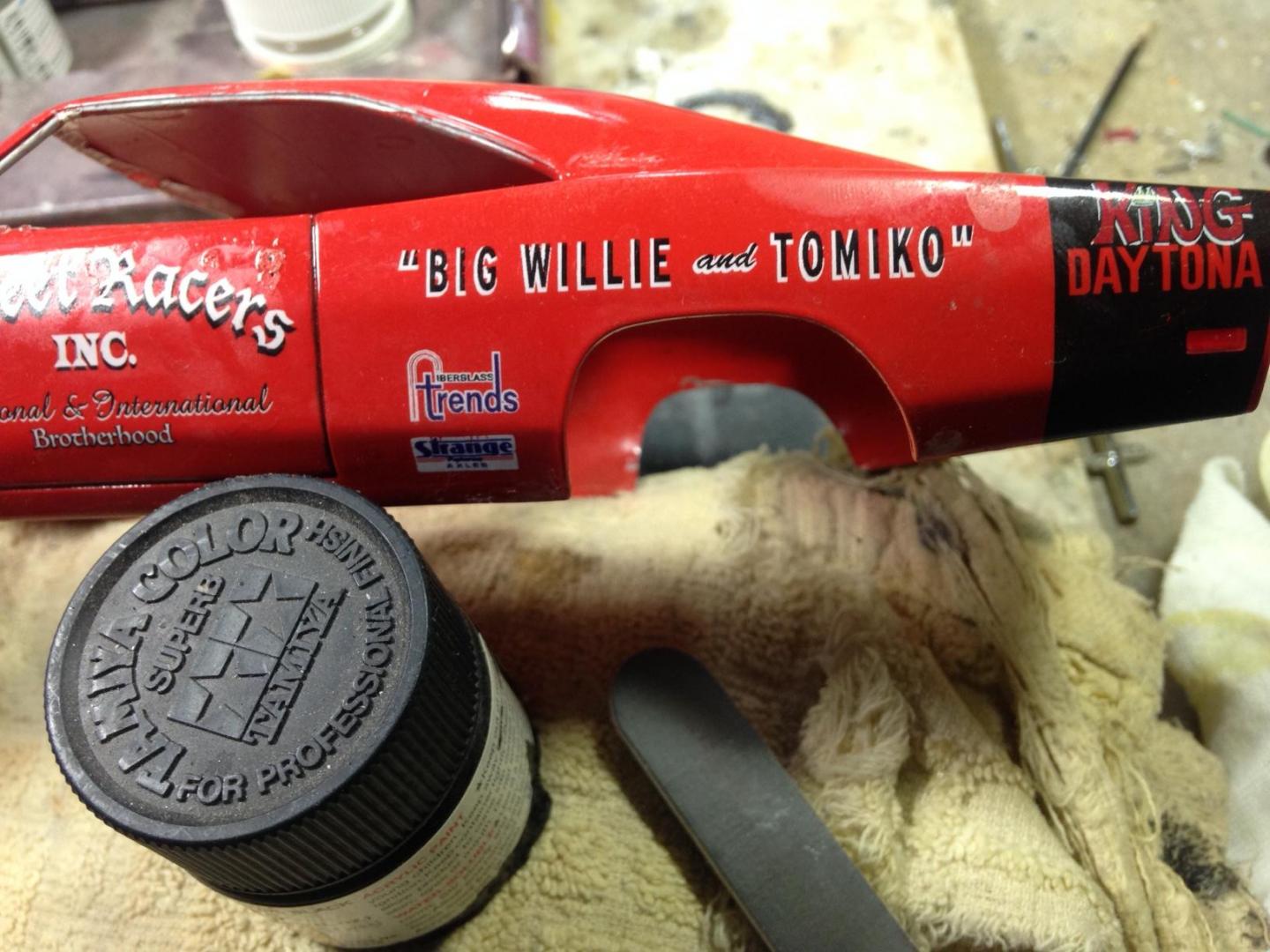

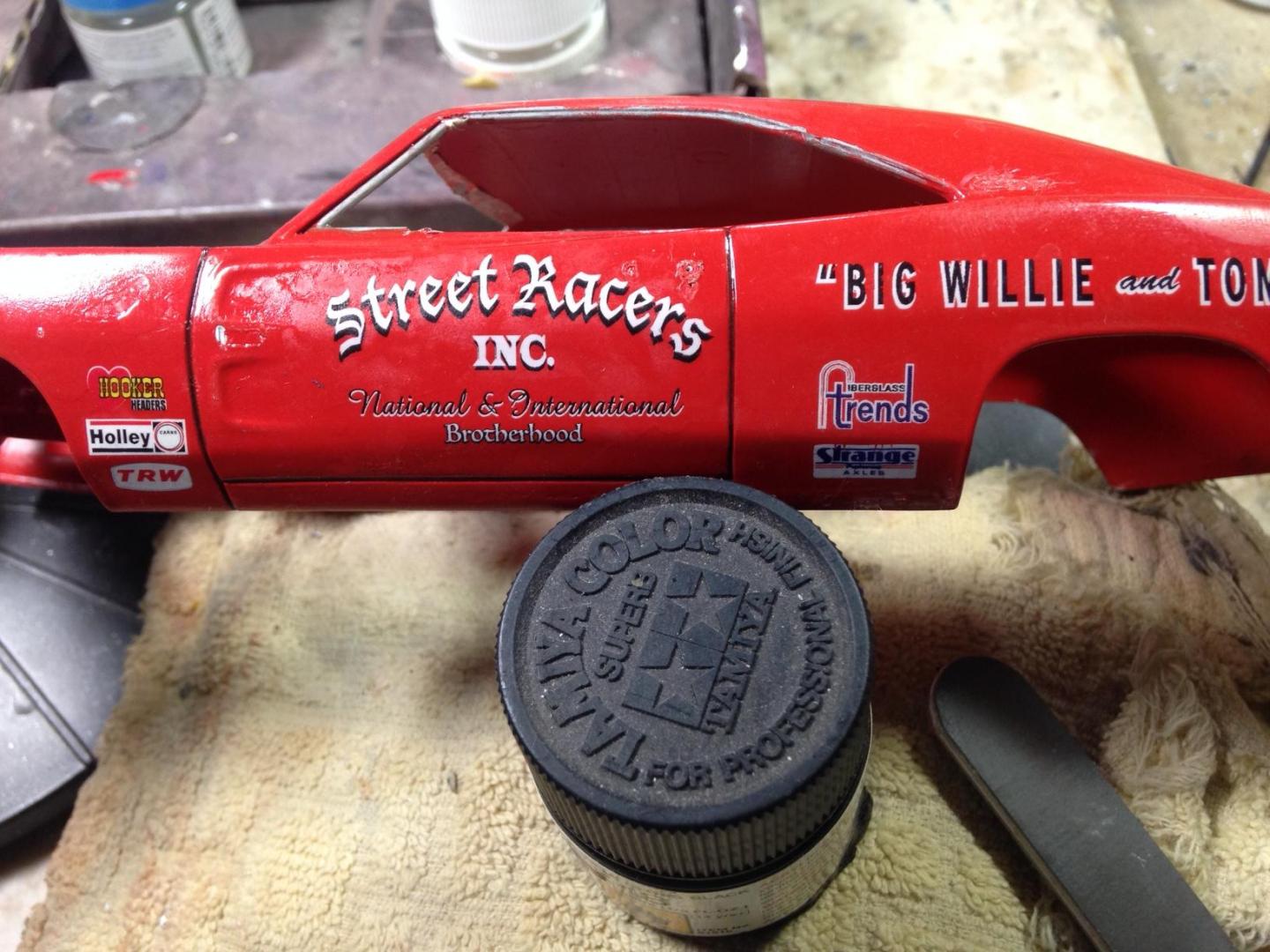

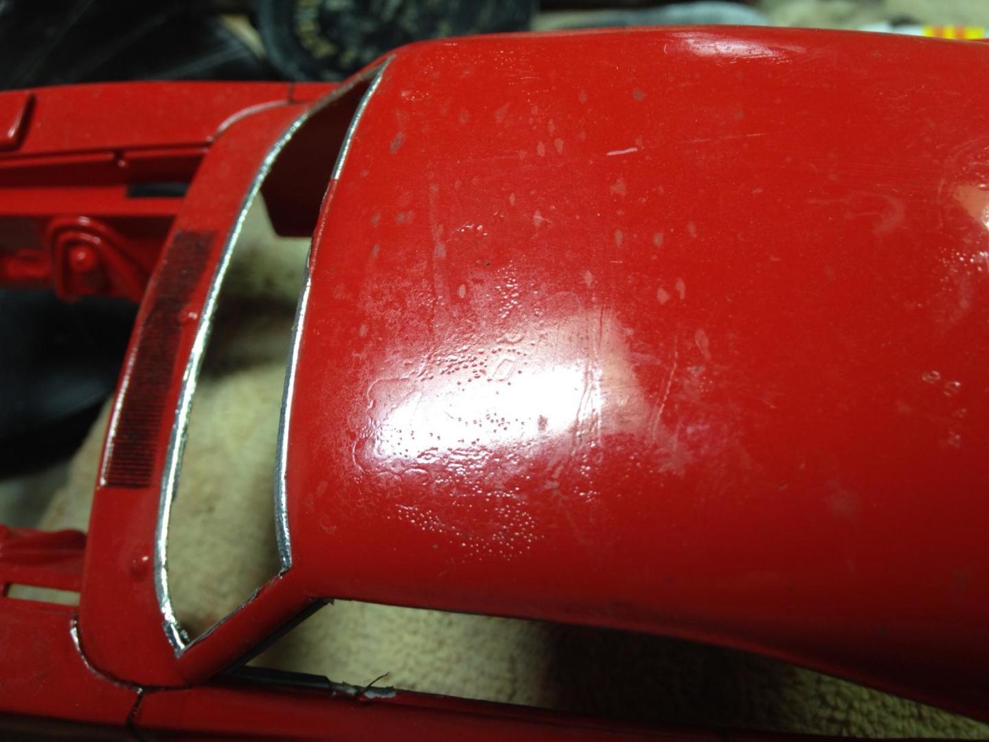

69NovaYenko Posted May 4, 2019 Posted May 4, 2019 After devoting a substantial amount of time over several months, effort, money for era correct paint (Scale Finishes), photo-etched parts & "custom" made decals etc for this project I was finally down to the final steps of completion when this happened. My LHB guy had recommended Max 2X high gloss clear coat as a final topcoat. I`m was devastated. I attempted to strip it but it was to no avail. the Max 2X was harder than petrified rock. So it become a junk body in my parts box. My question is what did "I" do wrong. How can I avoid this from happening again. ANY and All advise and input is welcome. Thanks in advance
StevenGuthmiller Posted May 4, 2019 Posted May 4, 2019 (edited) Use a different clear coat. I have always had pretty good luck with Duplicolor clear top coat in a rattle can. I haven't tried it yet over Scale Finishes paint, but will be soon. Of course, you can't use Duplicolor clear lacquer over enamel, so unless you're using an automotive type lacquer color coat, the Duplicolor will not work. I'm pretty certain that it won't work over decals either. You would have to apply your decals after clear coating. Steve Edited May 4, 2019 by StevenGuthmiller
Daddy Mack Posted May 4, 2019 Posted May 4, 2019 Sheesh! Looks like water or incompatible thinner mixed in with the clear.

Ace-Garageguy Posted May 6, 2019 Posted May 6, 2019 28 minutes ago, gman said: 28 minutes ago, gman said: Was the two part clear mixed and shaken exactly as directed? The surface of your cleared model almost looks like the two components of the clear were not completely mixed with one another during application over the enamel. That is one of the reasons I have not taken the plunge with the new 2K type clears. The "two-part" clear in question isn't. It's a pre-mixed rattlecan product that contains the same isocyanates used in hardeners in real two-part products that have to be mixed prior to application. The problems the OP has in his photos look very much like a reaction to surface contamination in some places, almost mimicking the dreaded "fisheyes" you get when you have contamination from silicone, wax, or in some cases, even skin oils.
gman Posted May 6, 2019 Posted May 6, 2019 2 hours ago, Ace-Garageguy said: The "two-part" clear in question isn't. It's a pre-mixed rattlecan product that contains the same isocyanates used in hardeners in real two-part products that have to be mixed prior to application. The problems the OP has in his photos look very much like a reaction to surface contamination in some places, almost mimicking the dreaded "fisheyes" you get when you have contamination from silicone, wax, or in some cases, even skin oils. It suggests there is a separate compartment in the can that has to be activated after initial shaking to mix the separated components (the hardener part) inside the can for use. I was trying to post a link to the user .pdf from the manufacturer's website, but it posts as an image of the page header. spraymax.com/fileadmin/user_upload/Downloads/Produkte/Prospekte/992466-SprayMax-Produktfolder_USA.pdf ^^ try this with "www." inserted in front of the text to read manufacturer's instructions
