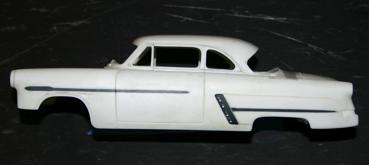

SfanGoch Posted May 5, 2019 Posted May 5, 2019 I gotta split this reply up due ton that annoying "404 Error" nonsense. Remember the Lindberg '53 Ford Victoria I was converting into a '52 Mainline Business coupe/NYPD RMP? When I bought it as an open box sale item, the body and hood were sprayed with a bright neon green lacquer over the unprimed plastic. I brushed ELO on the parts and within 20 minutes, the paint was wrinkled. I removed it per the previous post; and, after reapplying ELO to remove any remaining paint residue, the parts were bright and white. ELO works better than Super Clean, Purple Pond, brake fluid, oven cleaner. You don't need to submerge the parts, as with the other stuff. Youalsondon't have to wait hours, days or weeks.

SfanGoch Posted May 5, 2019 Posted May 5, 2019 4 minutes ago, martinfan5 said: Super Clean will remove Tamiya primer, you may have to use your elbow some and scrub, but it will come off, now, for some reason, not always though, but in most cases it will remove it. Ive found that its just easier once you get down to the primer, to use the 91% alcohol and it will just literately wipe it off with little effort. That's too much unnecessary work. This is the '53 Ford body using only ELO and very little, if any, elbow grease: You're not getting that from Super Clean in 20 minutes. And, like I said, you don't need a tub full of ELO to get it done.
