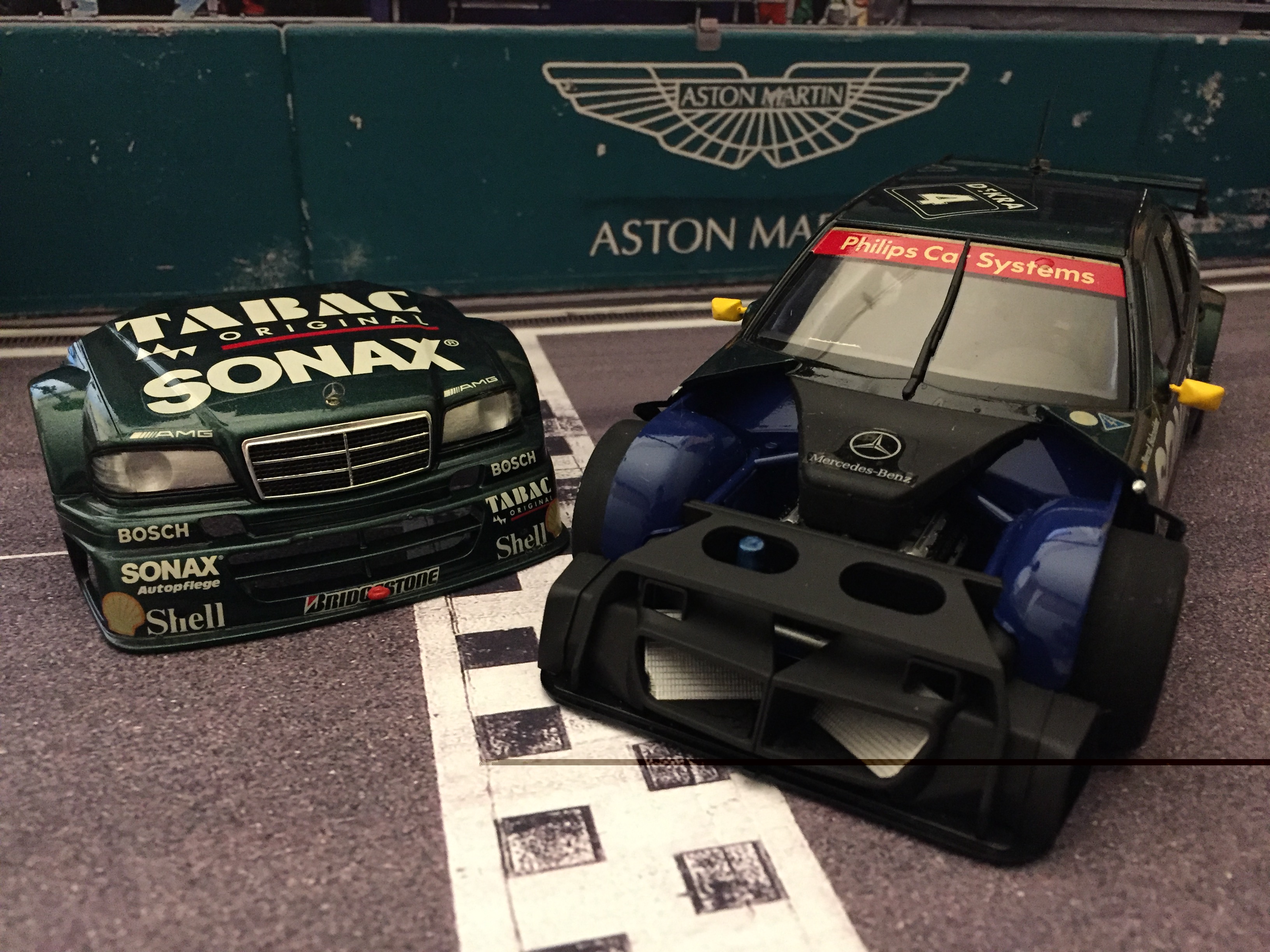

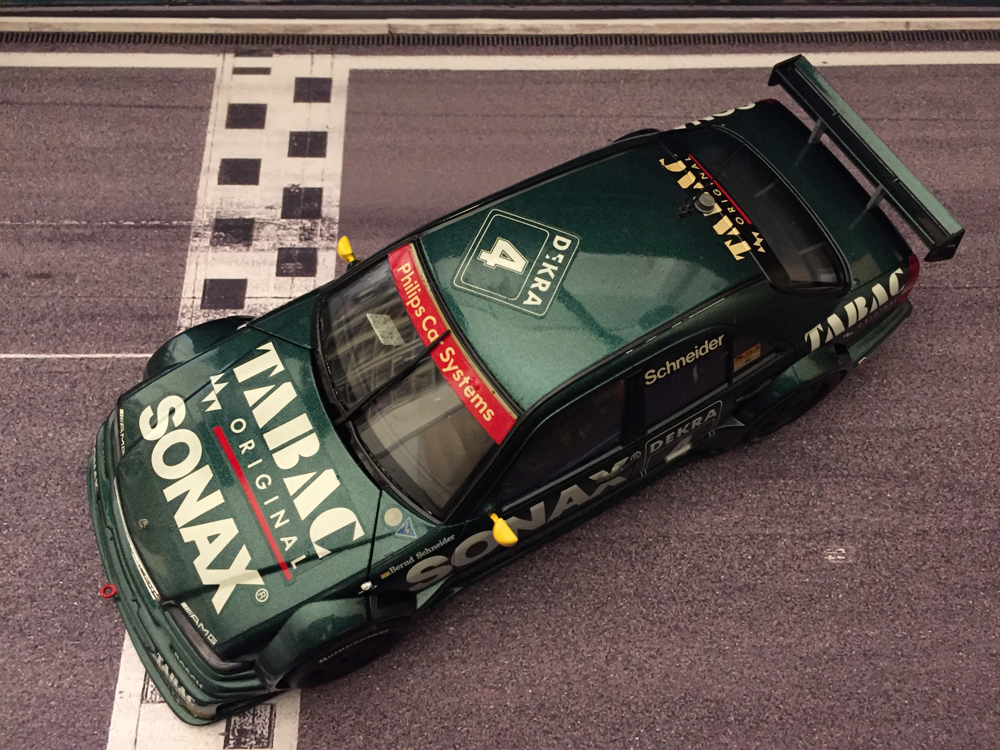

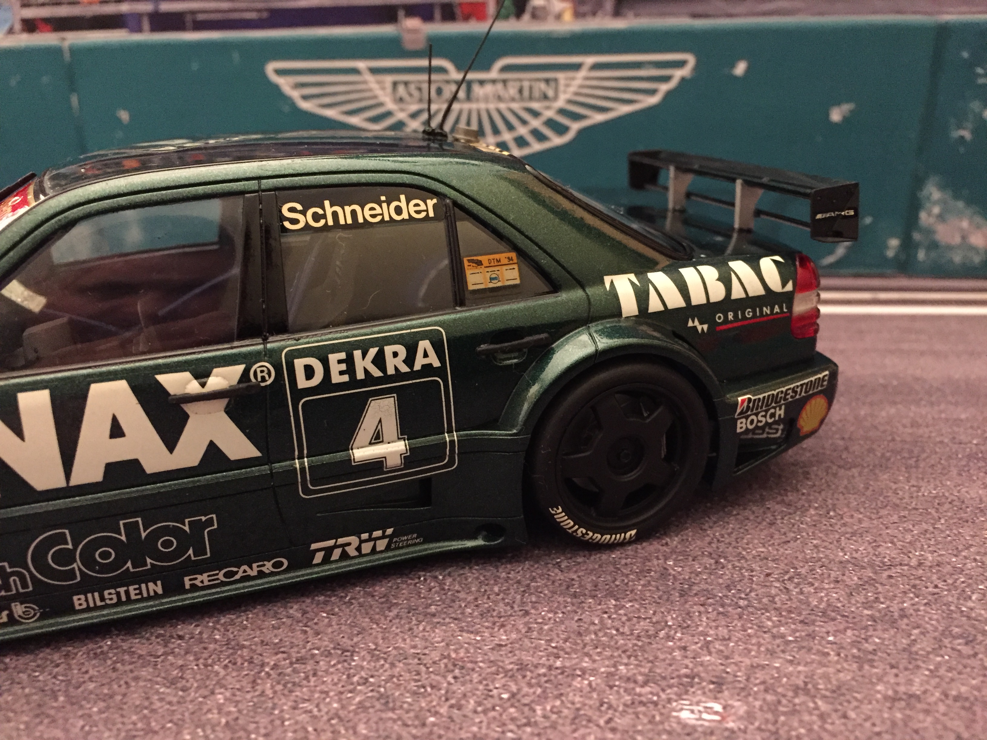

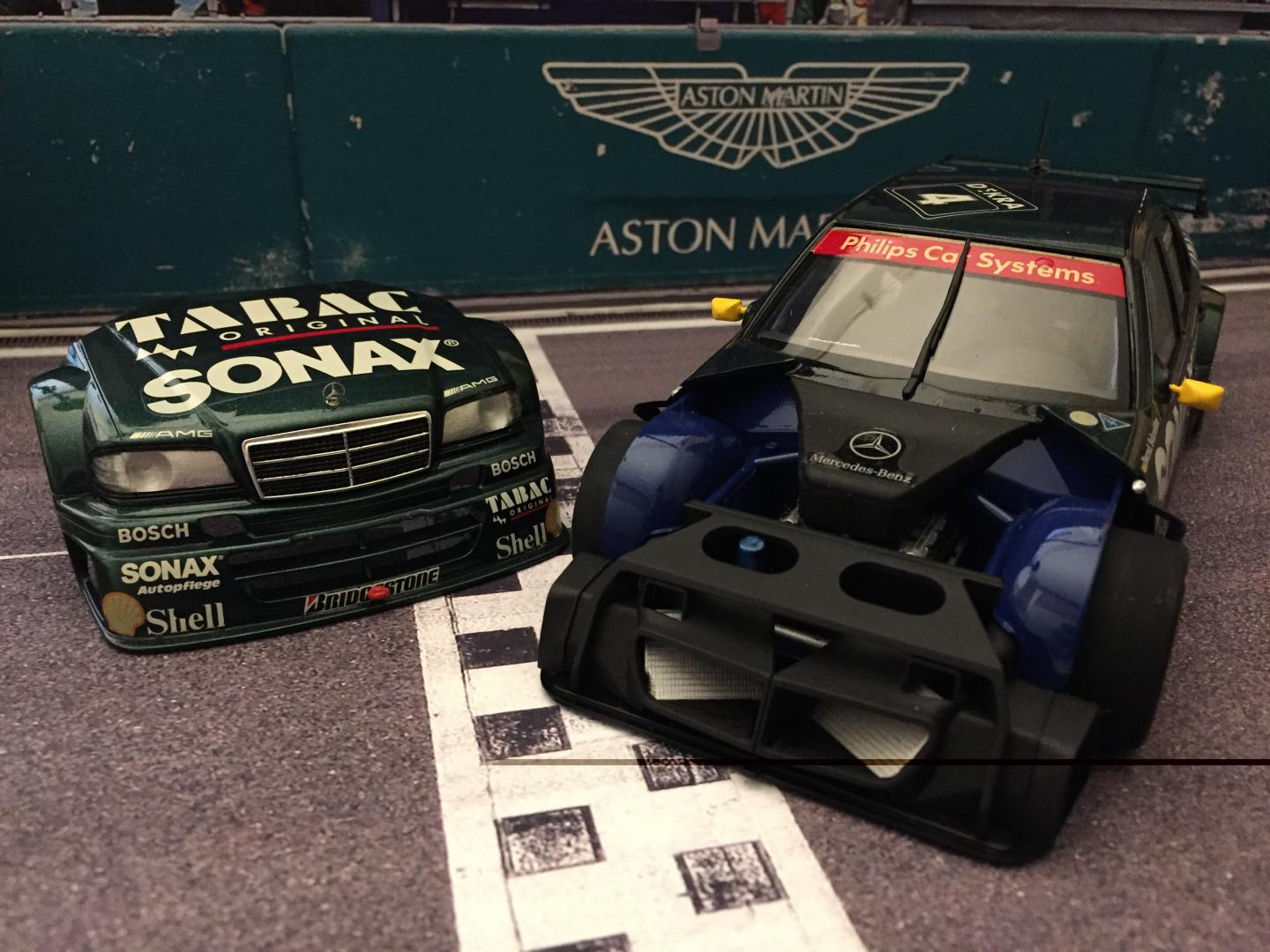

Tommy124 Posted May 9, 2019 Posted May 9, 2019 (edited) I built an AMG C-Class DTM Tamiya kit back in 1995/96 and that was exposed to pretty much sunlight over quite some time. I used Tamiya acrylics for basecoat AND clear coat back then. Yes, the white letters of the "Tabac" livery yellowed quite a bit (especially the one on the rear side of the roof) but it's mainly the non-cleared decals on the clear parts ("Philips" sticker on the windscreen and the "Schneider" sticker on the side) that took the most damage... Edited May 9, 2019 by Tommy124
