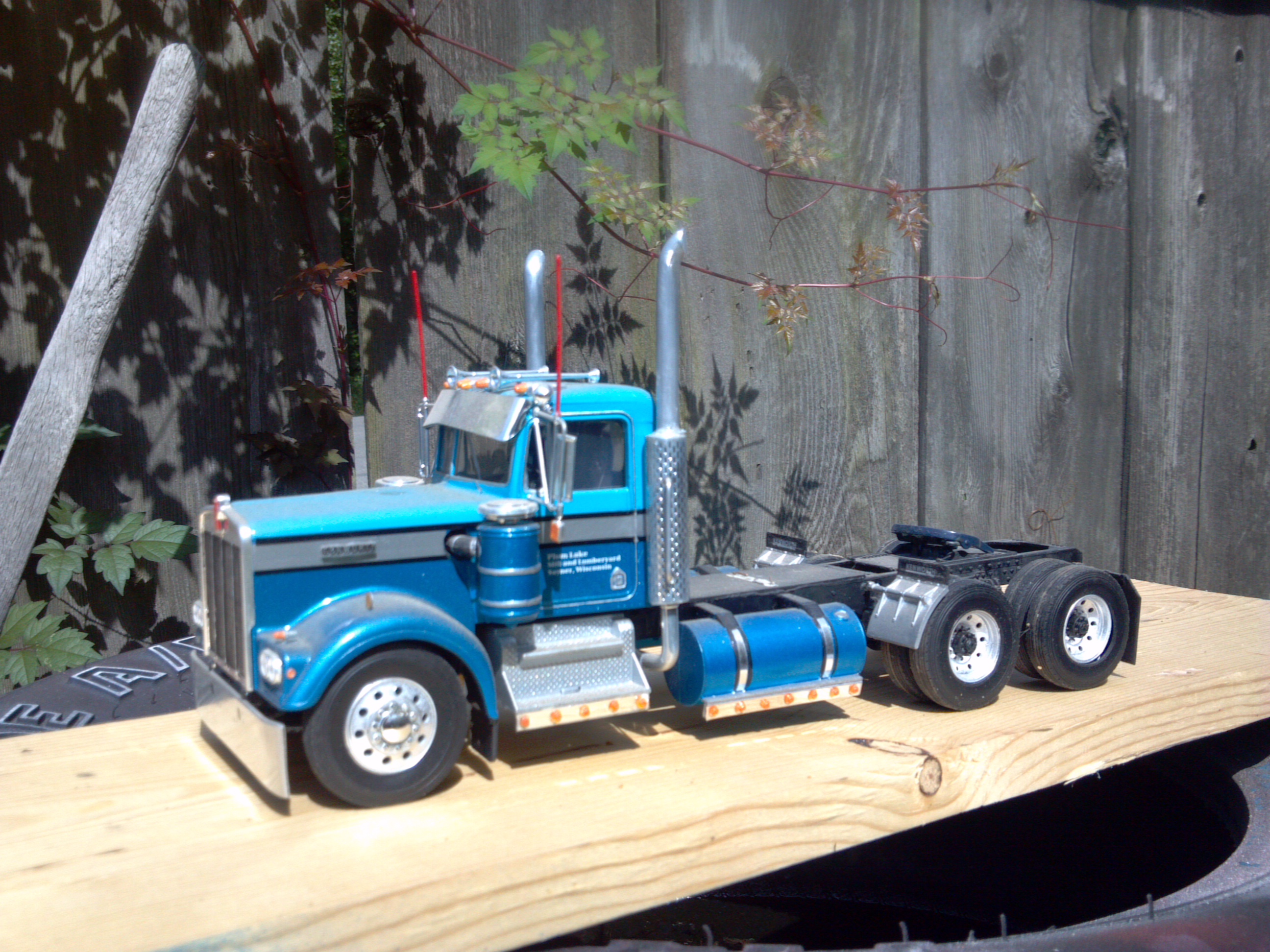

signguy2108 Posted May 19, 2019 Posted May 19, 2019 Here"s one. i've done several, but the rest have 60" flat sleepers on em.

Goodwrench3 Posted May 25, 2019 Posted May 25, 2019 Love the day cab !! Did you scratch build the back panel or take it from somewhere ? Looks great !
highway Posted May 25, 2019 Posted May 25, 2019 On 5/13/2019 at 5:37 PM, Oldmopars said: I picked up a Revell W900 and was looking to see if anyone has converted one of these to a Day cab. I know that the tow truck version is a day cab, But is it even the same kit base? Anyway, I really like this W900 and it seems I could convert it, but was hoping to see some others that have been done. Both this sites search and Google did not return anything useful. Since no one answered the second part of your question, no the Revell wrecker is not the same base kit, it is based from the Revell of Germany W900 which share nothing with the ex-Monogram Aerodyne snap kit. Another alternative to hacking and cutting the Aerodyne snap kit would be AMT's KW reissued a couple of years ago. It has the back window cutout and even has a piece of "glass" on the clear sprue, so a day cab conversion is as simple as not putting the sleeper on.
signguy2108 Posted May 25, 2019 Posted May 25, 2019 No Jeff, scratchbuilt roof and back panel, cut out the v shaped part of the roof and sleeper, heated and formed a new roof panel, It had a headache rack on it, but i took it off for the pics.thatma and thanks for finishing the question Matthew
