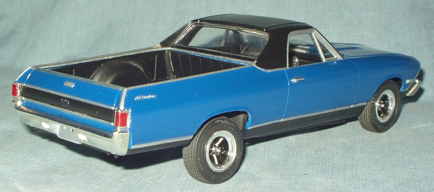

Snake45 Posted May 25, 2019 Posted May 25, 2019 The right taillight on this (glue bomb rescue) Elky was scratchbuilt from a clear plastic Walmart blueberry container, colored with Red Sharpie inside and out--no paint at all. I think it looks pretty good. I've used Red Sharpie for taillights on my diecasts and several kits and been very happy with the results. I'll probably be doing it on another diecast this weekend.
