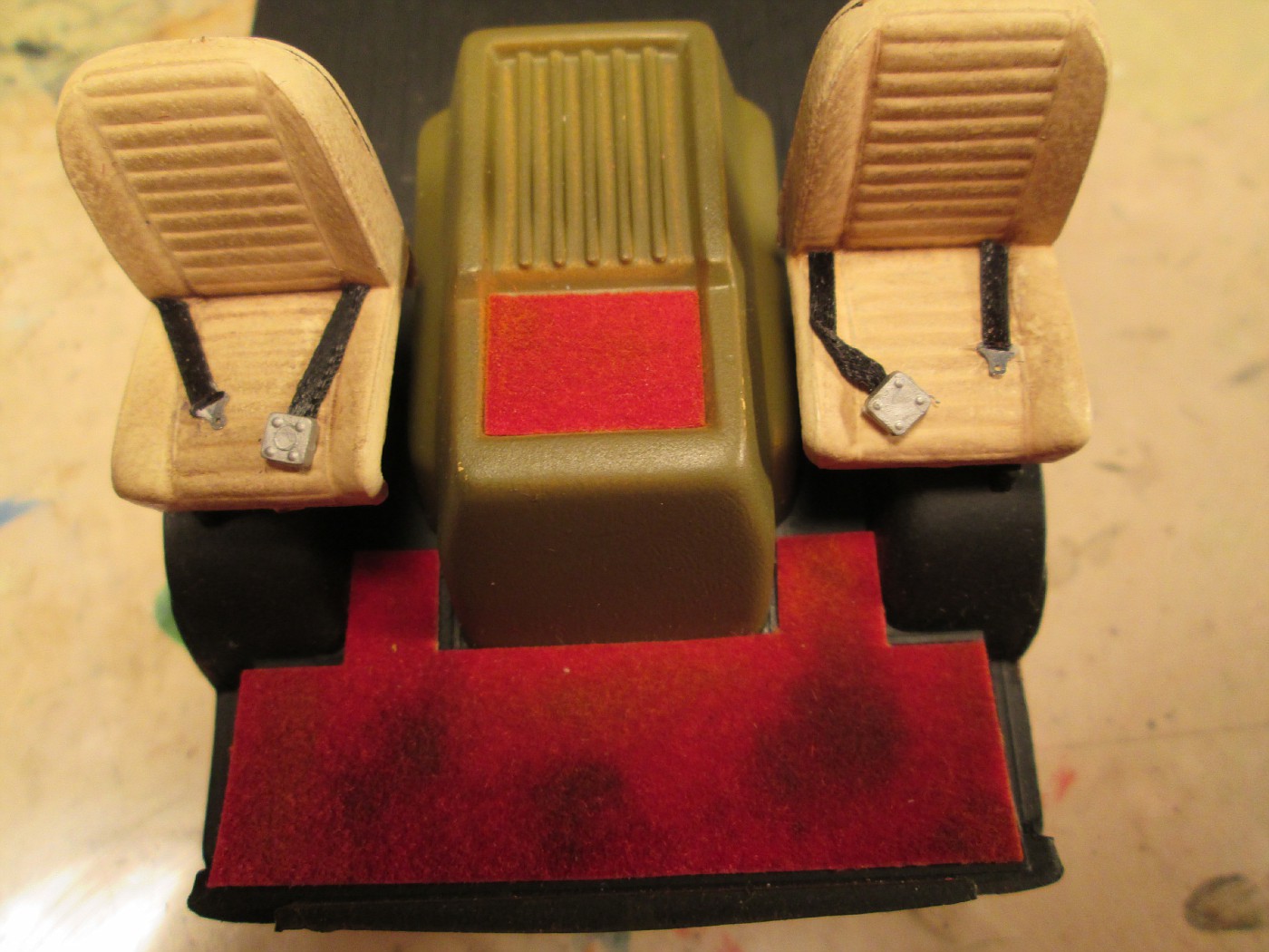

Tom Geiger Posted May 29, 2019 Posted May 29, 2019 Why mess around? Here's a set of Model Car Garage photo etched seat belts. I added a layer of Evergreen plastic to the female ends to give them depth. Then just use a chrome pen around the edges. I bought three packs of the belts for less than $20 postpaid. 1/16" ribbon. Got all of this on eBay for less than $10 shipped. So I spent about $30 and now have a lifetime supply of seat belts. It's just not worth the effort to play around.

Tom Geiger Posted May 31, 2019 Posted May 31, 2019 18 hours ago, Scott Vinton said: Could you show a couple of "how to" pictures for this? Brian, as I get a chance in the next few days, I will do a tutorial for you! Here's a photo showing the depth I created for the buckle end using scrap Evergreen plastic. These are in my Dodge A100 pickup. But in the meantime, here's a few other ideas.. This is the interior of my Jimmy Flintstone Dodge A100 van. I was intent on getting this one done quickly, so I used photo etched female ends, along with the ribbon I showed above. For the male end, those were cut off plastic seat belts that were in an older kit. So those buckles can be saved by simply cutting the seat belt away. Interior of my 1930 Ford pickup street rod. Another example of cutting both ends off kit seat belts. Again using the ribbon. Note that I purchased the 1/16" wide ribbon on eBay because I couldn't find it locally. Seems most places have 1/8" and wider. If indeed you wish to narrow ribbon you have, it will fray like crazy... unless... the trick is to coat the back with white glue and let it dry. Then it will cut clean with scissors. Here's an example of those old plastic seat belts that came in early kits. Today we curse them because they are the source of glue marks on seats we are trying to restore. But why not save the buckles? An early interior... 1977 Plymouth Volare front seat These were done with narrowed ribbon (using the white glue technique) and I made those buckles from scrap plastic. I have also created seat belts from masking tape. The trick is to neutralize the sticky side by spraying it with Testors Dullcote. Then you can cut the tape to the necessary width and paint it any color you wish. I hope this has helped someone!
