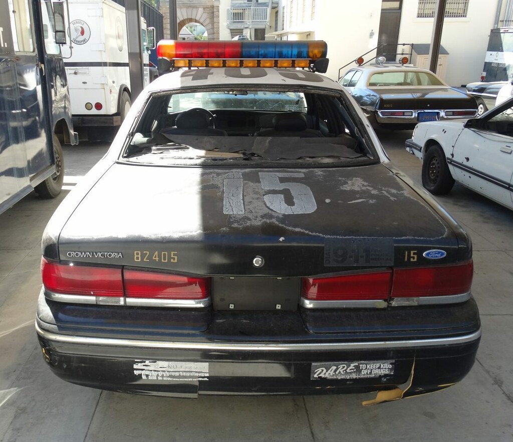

kymdlr Posted May 28, 2019 Posted May 28, 2019 (edited) Had this idea for a little while . The North Hollywood shootout happened in LA back in the mid-90's. It was a notorious crime but if you haven't heard of it, its all over google & youtube. The idea for this model is to show a period correct car that would have been involved in the response & heavily damaged from gun fire. A couple reference pics were used to get the effects (I do not own these). Edited May 29, 2019 by kymdlr

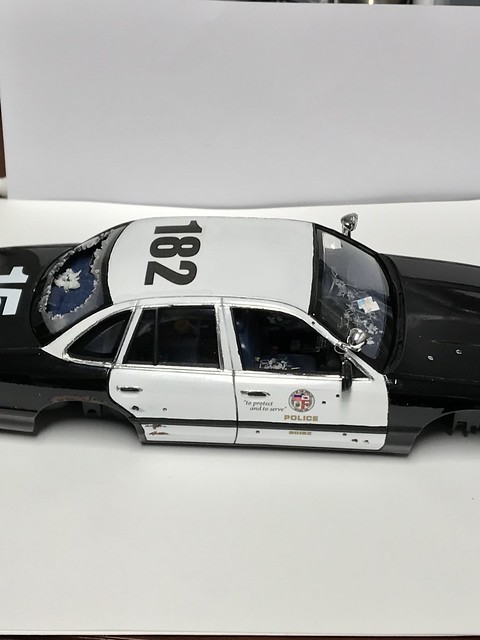

kymdlr Posted May 28, 2019 Author Posted May 28, 2019 (edited) Base coat white on body, followed by the addition of the black coat & some interior details. Ive added some entry bullet holes to the body with matching exit holes on the interior doors & seats. Added the shattered glass look to the interior using shaved clear plastic. The holes in the seats and doors were filled w/ loose cotton from a q-tip & painted yellow to simulate cushioning. Since this is a heavily used car in the fleet, Ive added a few rust spots to the body as well. Also added seat belts to the front seats. The black trim on the body is rough in these pics because there will be chrome trim over top of it. Edited May 28, 2019 by kymdlr

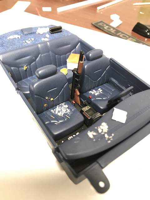

kymdlr Posted May 28, 2019 Author Posted May 28, 2019 More interior details. I found some 1:35 scale shell casings (didnt even know such a thing existed) that fit great on this build to simulate some of them landing on the passenger side seat. Added more shattered glass to the dash, police electronic equipment to the center console, a baton & a map.

GLMFAA1 Posted May 29, 2019 Posted May 29, 2019 Interesting project, neat work on the bullet hole in the interior, One suspicion is that the reference pictures are from a movie car rental pen and not the real LAPD car as john noted the real car went back in service. Don't stop I want to see it done greg

Agent G Posted May 29, 2019 Posted May 29, 2019 There would be no rifle casings in the police car. The LAPD didn't have rifles then. That's why they were outgunned during this incident. G
kymdlr Posted May 30, 2019 Author Posted May 30, 2019 (edited) 19 hours ago, Agent G said: There would be no rifle casings in the police car. The LAPD didn't have rifles then. That's why they were outgunned during this incident. G Yes and no. The patrol guys didn’t have rifles, but the swat guys who eventually responded & took out the shooters did. Also the patrol guys went to local gun stores to secure rifles that they were able to use Edited May 30, 2019 by kymdlr
kymdlr Posted May 30, 2019 Author Posted May 30, 2019 This car wont have a prisoner partition between the front & rear seats so I didn't have anything to mount the shotgun on .Scratch built one & attached it. Got the chrome trim applied around the windows & added rust & light paint damage.
martinfan5 Posted May 30, 2019 Posted May 30, 2019 (edited) On 5/28/2019 at 6:49 PM, GLMFAA1 said: Interesting project, neat work on the bullet hole in the interior, One suspicion is that the reference pictures are from a movie car rental pen and not the real LAPD car as john noted the real car went back in service. Don't stop I want to see it done greg The photos are of a real LAPD CV that was damaged in the shootout, that is not a movie rental unit, keep in mind that were more than just one patrol units that received damage that day, I have no doubts some of them were repaired and returned to duty. The unit in the photo is a part of I think the LAPD's personal collection as it sits in a covered lot with other ex LAPD units. Edited May 30, 2019 by martinfan5

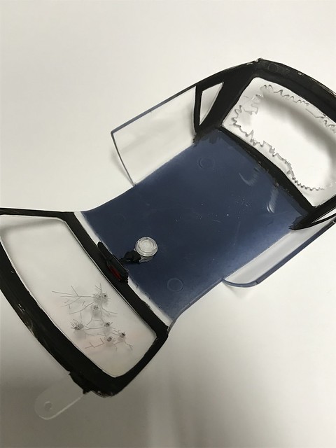

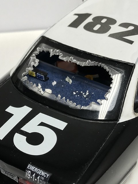

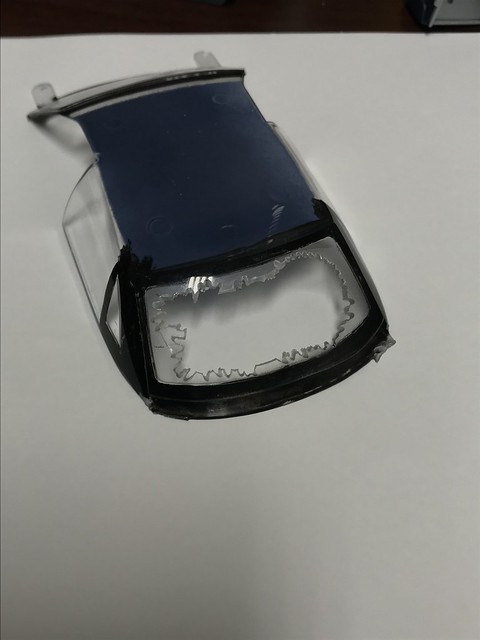

kymdlr Posted June 3, 2019 Author Posted June 3, 2019 All the black & chrome trim for the windows is finished. Added a few more bullet holes to the hood & front glass. For the rear I have the whole back glass blown out.
Agent G Posted June 3, 2019 Posted June 3, 2019 (edited) On 5/30/2019 at 5:20 AM, kymdlr said: Yes and no. The patrol guys didn’t have rifles, but the swat guys who eventually responded & took out the shooters did. Also the patrol guys went to local gun stores to secure rifles that they were able to use Of course the SWAT guys had rifles. They were late to the party though. Thank God they got there when they did. If you're modeling a North Hollywood Division B/W, then there should be NO spent rifle cases in the car. G Edited June 3, 2019 by Agent G
av405 Posted June 4, 2019 Posted June 4, 2019 Is that a rear deck light that you added? Are you trying to make a slick top? The regular patrol cars (the first that would have been on the scene and all shot up) all had light bars. A heavily damaged slick top car probably wouldn't be accurate as those were driven by the SWAT/other specialized guys who arrived late to the party. Not criticizing. It seems like you're striving for accuracy so I want to help.
kymdlr Posted June 7, 2019 Author Posted June 7, 2019 (edited) On 6/4/2019 at 1:00 AM, av405 said: Is that a rear deck light that you added? Are you trying to make a slick top? The regular patrol cars (the first that would have been on the scene and all shot up) all had light bars. A heavily damaged slick top car probably wouldn't be accurate as those were driven by the SWAT/other specialized guys who arrived late to the party. Not criticizing. It seems like you're striving for accuracy so I want to help. Thanks for the input but Yep its going to be a slick top car because I hate that era lightbar & yes im aware of who drove them. Im sure there was at least one slicktop that got some bullet damage during the exchange, for instance the still shot that I attached showing the SWAT caprice that was used by officers for cover while the shooter used that white sedan for cover. Edited June 7, 2019 by kymdlr
