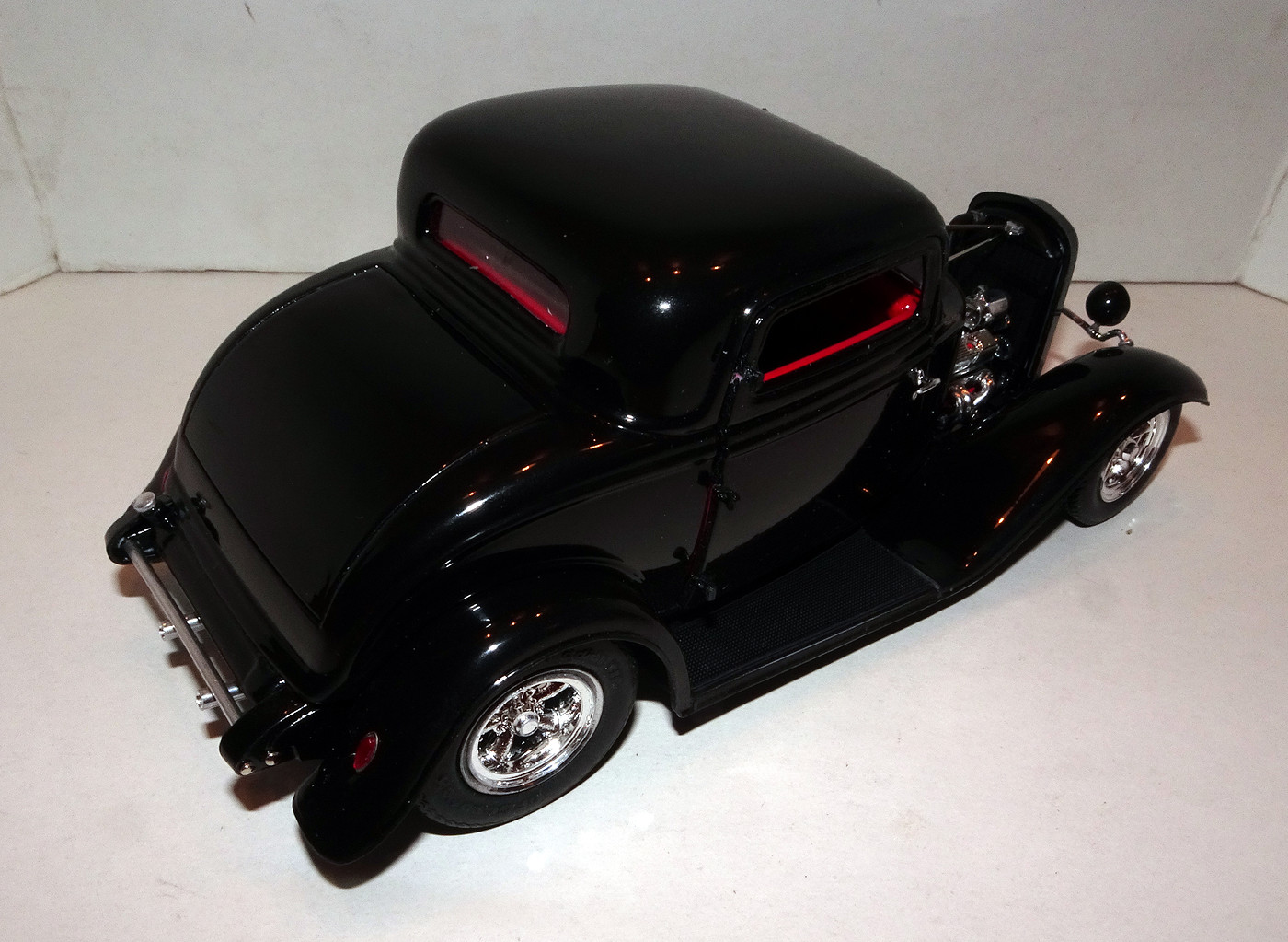

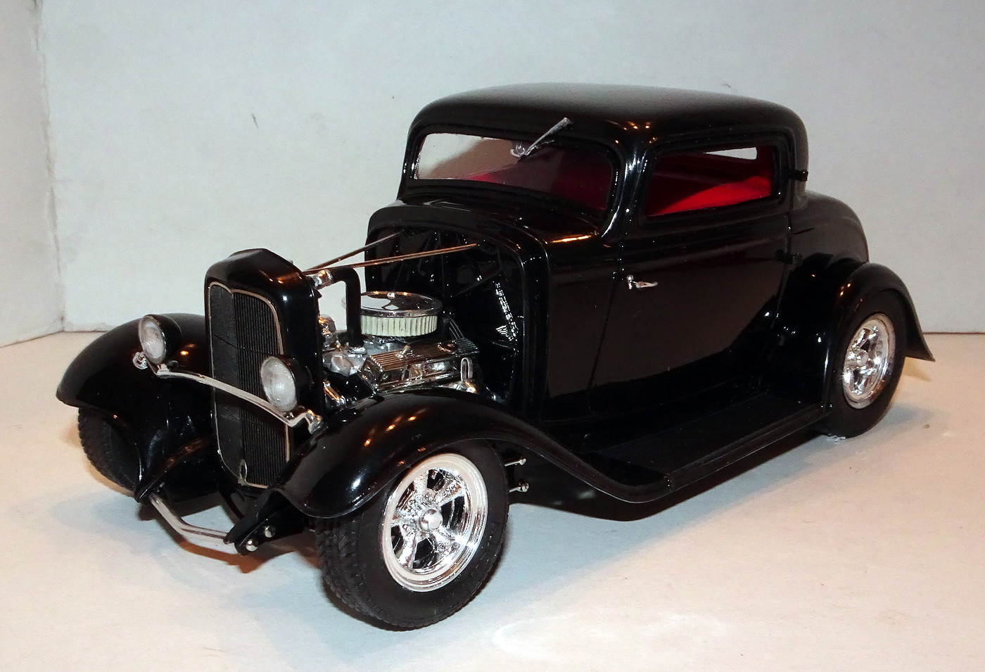

Phildaupho Posted June 3, 2019 Posted June 3, 2019 (edited) This is a replica of Mike O'Neil's car which was the first Deuce Coupe to appear in The Rodders Journal in bare steel in the first issue and completed in #8. It was also the first Rodders Journal poster car. Edited June 4, 2019 by Phildaupho
Phildaupho Posted June 3, 2019 Author Posted June 3, 2019 (edited) Body Revell 1932 Ford 3-window coupe The roof was chopped about a scale 2-1/2 inches Door hinges replaced with the accurate ones from Replicas & Miniatures Passenger side door opened up Louvers opened up on stock hood sides Replicas & Miniatures grill shell and radiator Photoetched details and grill from Model Car Garage Aluminum tube spreader bars with pin-head bolts Interior Seats and door panels modified from Revell 5-window coupe Steering wheel AMT ’71 Corvette Dash incorporates gauge panel from Revell Willys Street Rod Chassis Floor cut out of kit frame Cross tubing added Fuel tank removed for frame photo Front Suspension Kit tube front axle converted to beam axle with sections from R/M 1/24 Deuce Roadster Shocks separated from bracket and pinned for installation Kit radius rods and steering Rear Suspension Four bar trailing arms and Panhard bar modified from Revell Willys Street Rod Kit rearend trimmed Kit coil-over shocks pinned for modified mounting Front Wheels and Tires Kit Torque-Thrusts wheels Parts box Michelin tires Rear Wheels and Tires Kit Torque-Thrusts wheels – diameter slightly increased Parts box BF Goodrich T/A Radials narrowed Drive Train Chevrolet smallblock engine and transmission from the Rat Roaster Shift linkage from Replicas & Miniatures Parts Box supplied intake manifold, exhaust manifolds Corvette LT-1 valve covers from AMT 71 Corvette Pulleys and belt assembly modified from Rat Roaster for air-con pump Carb and air cleaner from kit 7-blade fan from AMT ’49 Ford Dipstick and some wiring added Edited June 4, 2019 by Phildaupho

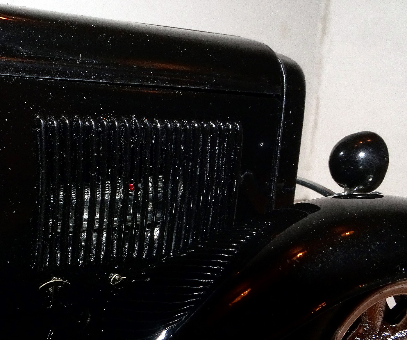

Rider Posted June 4, 2019 Posted June 4, 2019 Super job all round. Very nice work on the hood louvers.,
Phildaupho Posted June 4, 2019 Author Posted June 4, 2019 13 hours ago, Rider said: Super job all round. Very nice work on the hood louvers., Thanks Curtis - I have always liked seeing engines through the louvers on full scale hot rods so wanted to try and replicate that. I am kind of disappointed with how dusty these photos turned out so plan to take some more.

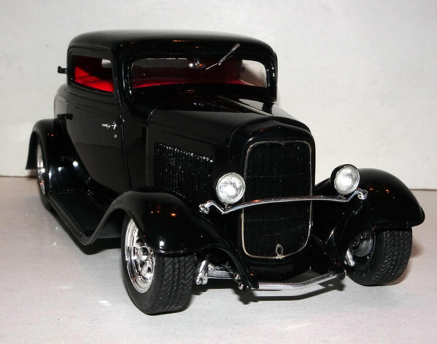

Phildaupho Posted June 4, 2019 Author Posted June 4, 2019 I was not happy with the original photos so took some more but found the editing function did not work as expected
Phildaupho Posted June 5, 2019 Author Posted June 5, 2019 (edited) Here a couple more views that I really like. Forgot to mention the reason why I used a reddish background on previously posted photos is because the full scale car was photographed with a similar background for The Rodder's Journal. Edited June 5, 2019 by Phildaupho
Spex84 Posted June 5, 2019 Posted June 5, 2019 Turned out great! Nice hinges on the doors, by the way! I also like the V'd spreader bar.
Phildaupho Posted June 6, 2019 Author Posted June 6, 2019 (edited) 18 hours ago, Spex84 said: Turned out great! Nice hinges on the doors, by the way! I also like the V'd spreader bar. Thanks Chris - The hinges are one of the many great Deuce parts from Replicas & Miniatures. I used aluminum tube for spreader bars 17 hours ago, ChrisR said: Looks great!! Thanks Chris Edited June 6, 2019 by Phildaupho
Rider Posted June 6, 2019 Posted June 6, 2019 Black is such a difficult colour to photograph. These pics look better, nice interior.
Phildaupho Posted June 6, 2019 Author Posted June 6, 2019 4 hours ago, Rider said: Black is such a difficult colour to photograph. These pics look better, nice interior. Thanks Curtis - Yes I agree about the difficulty of photographing black. I have also had problems with red. Think I need a better camera that has a broader amperage range.
Flatout Posted June 6, 2019 Posted June 6, 2019 Beautiful 3 Window Phil, love everything about it! How did you open up the louvers on the hood?

Phildaupho Posted June 8, 2019 Author Posted June 8, 2019 On 2019-06-06 at 12:55 PM, Flatout said: Beautiful 3 Window Phil, love everything about it! How did you open up the louvers on the hood? On 2019-06-06 at 6:28 PM, crazyjim said: Gorgeous hot rod. Love the SHINY 1 hour ago, Koellefornia Kid said: Nice, clean, low, black, 5-spokes... can a Deuce look better? Thanks guys Forgot to mention I scribed the louvres with back side of #11 blade over a very long time
Flatout Posted June 8, 2019 Posted June 8, 2019 10 hours ago, Phildaupho said: Thanks guys Forgot to mention I scribed the louvres with back side of #11 blade over a very long time Thanks Phil! Sounds a bit tedious, but I’m looking forward to giving it a try...it really adds realism to your build.
