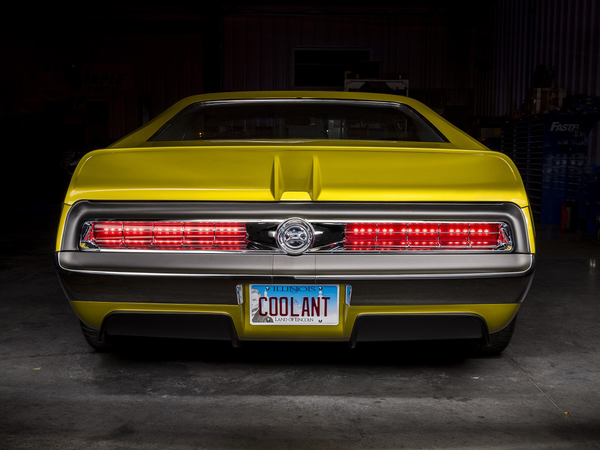

69NovaYenko Posted June 4, 2019 Posted June 4, 2019 (edited) This one is for all the A.M.C. connoisseurs out there. This 1972 A.M.C. Javelin is appropriately named “Defiant”. This 1,100 H.P. creation is arguably the wildest custom vehicle design ever built by the Ringbrothers. They decided to rely heavily on Solidworks digital design tools to render the car’s new panels, which were then brought to life in their machine shop and carbon fiber facility. They extended the Javelin’s wheelbase by moving the wheels forward six and a half inches. The car’s distinctive wheel arches were moved forward and recreated in carbon fiber to pair with a new hood, front fenders, grille and front valance. Other custom details include tail lights, bumpers, trim and engine bay accessories all machined out of blocks of aluminum at the Ringbrothers facility. To finish the look of the car and highlight the body work, the exterior of “Defiant! is coated in a rich, BASF Glasurit color named “Jalop Gold.” The build was commissioned by antifreeze expert Prestone to celebrate its 90th anniversary, hence the car’s distinct yellow exterior .Under the hood is a transplanted Hellcat engine . However, the 6.2-liter supercharged V-8’s 707 horsepower didn’t suffice so Ringbrothers swapped out the stock supercharger for a 4.5-liter Whipple unit that now sees the engine deliver 1,100 thundering horses! Among the Numberous upgrades the card includes a custom 4-link rear suspension, a 12-bolt axle, side exhaust exits, and dics braking system. Enjoy the clip https://www.motorauthority.com/news/1113581_1100-horsepower-amc-javelin-by-ringbrothers-debuts-at-sema Edited June 4, 2019 by 69NovaYenko

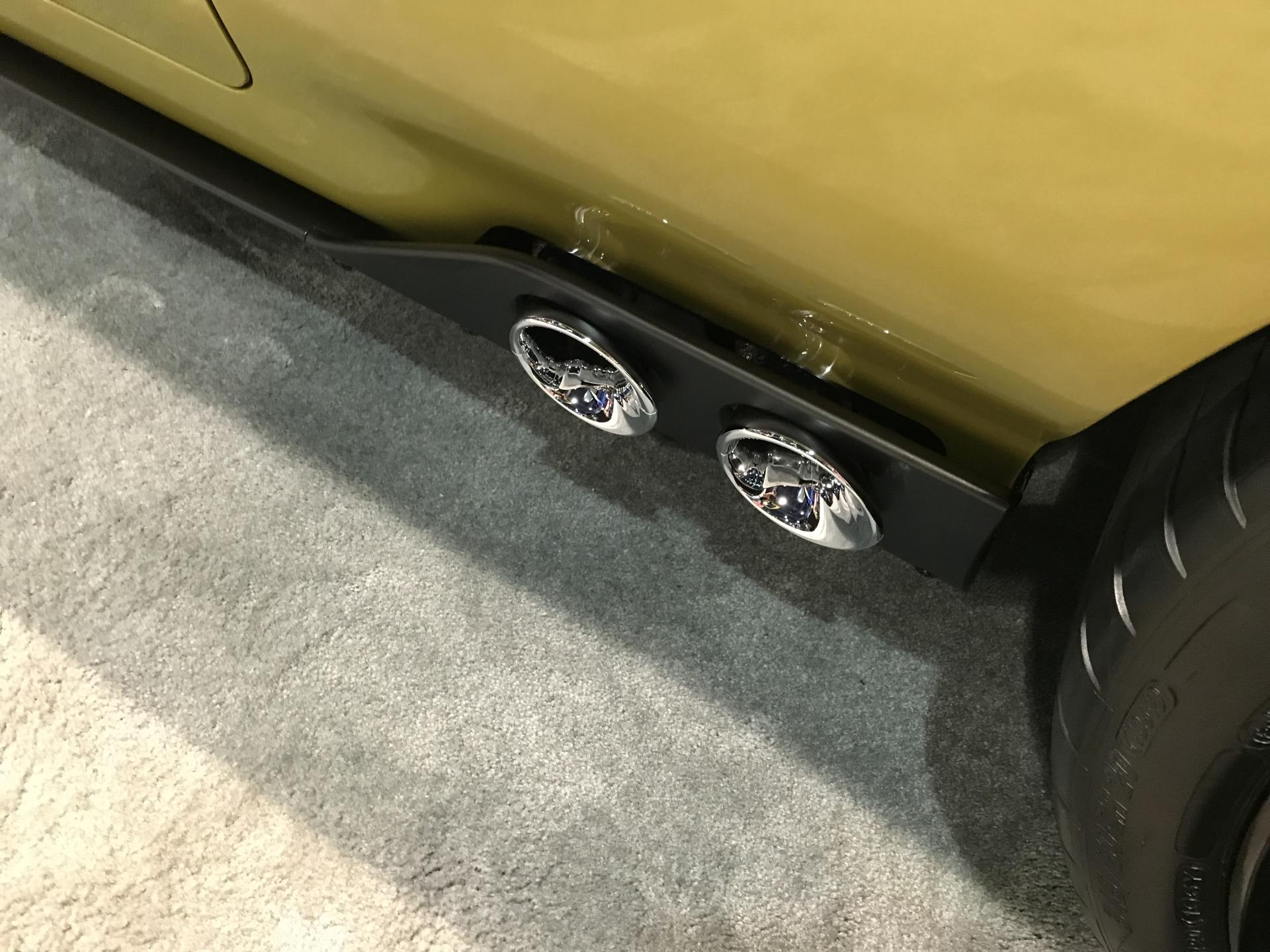

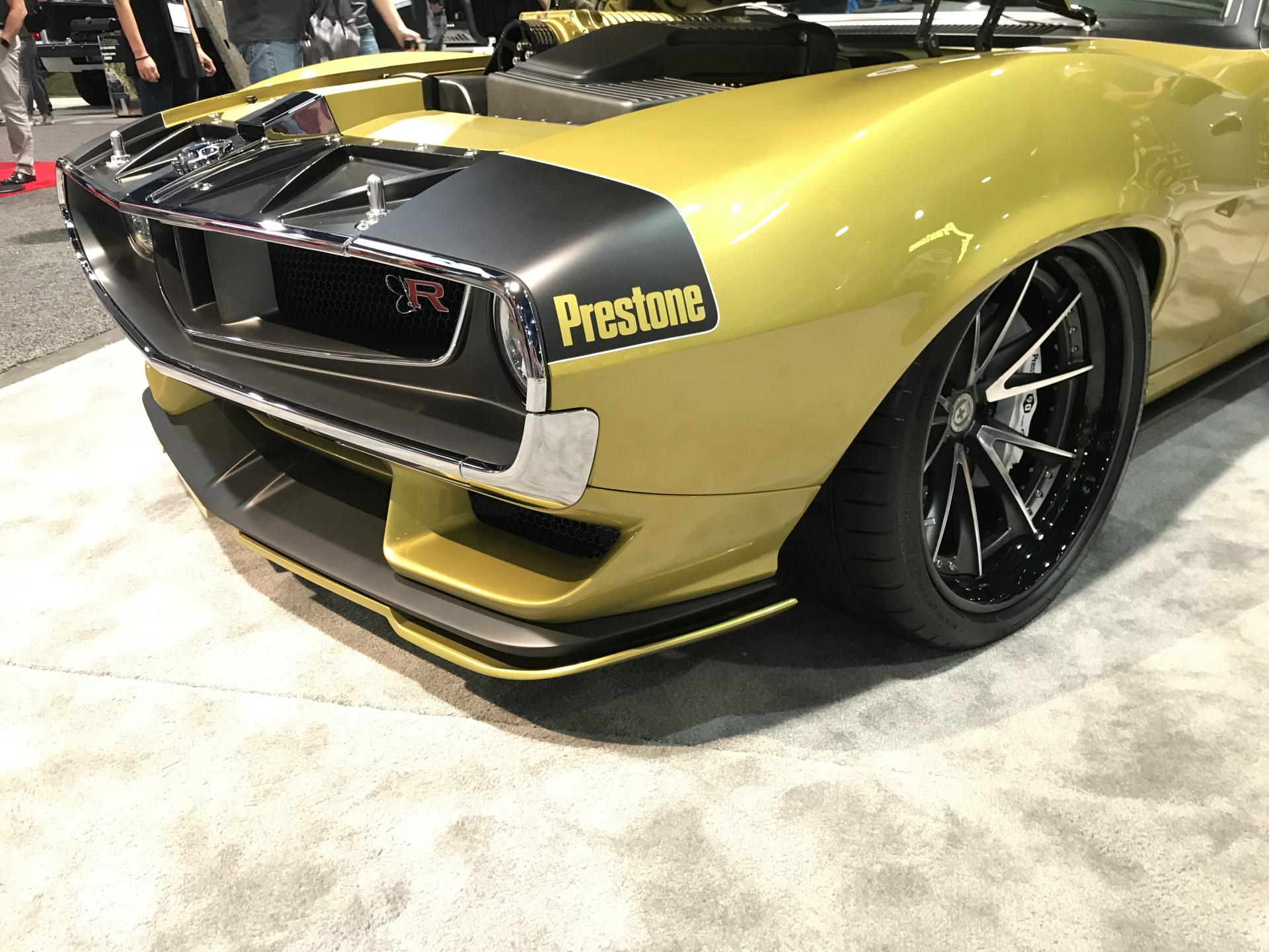

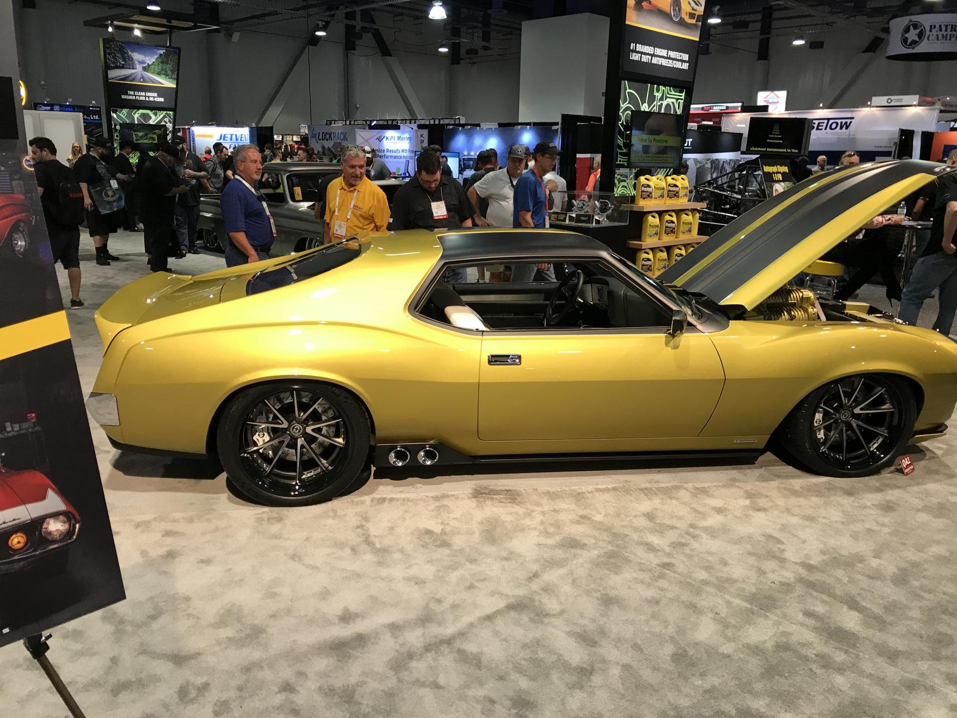

Impalow Posted June 5, 2019 Posted June 5, 2019 This is one of those ones that pictures don't do justice... I had the pleasure of getting to drool all over its debut at 2017 SEMA.... its amazing. here are some of my detail shots.
Karl Sheffer Posted June 6, 2019 Posted June 6, 2019 For those thinking of replicating this car, please note that the wheelbase was stretched and the front fender openings were moved 6 1/2 inches forward. More information: https://ringbrothers.com/1972-amc-javelin-amx-defiant

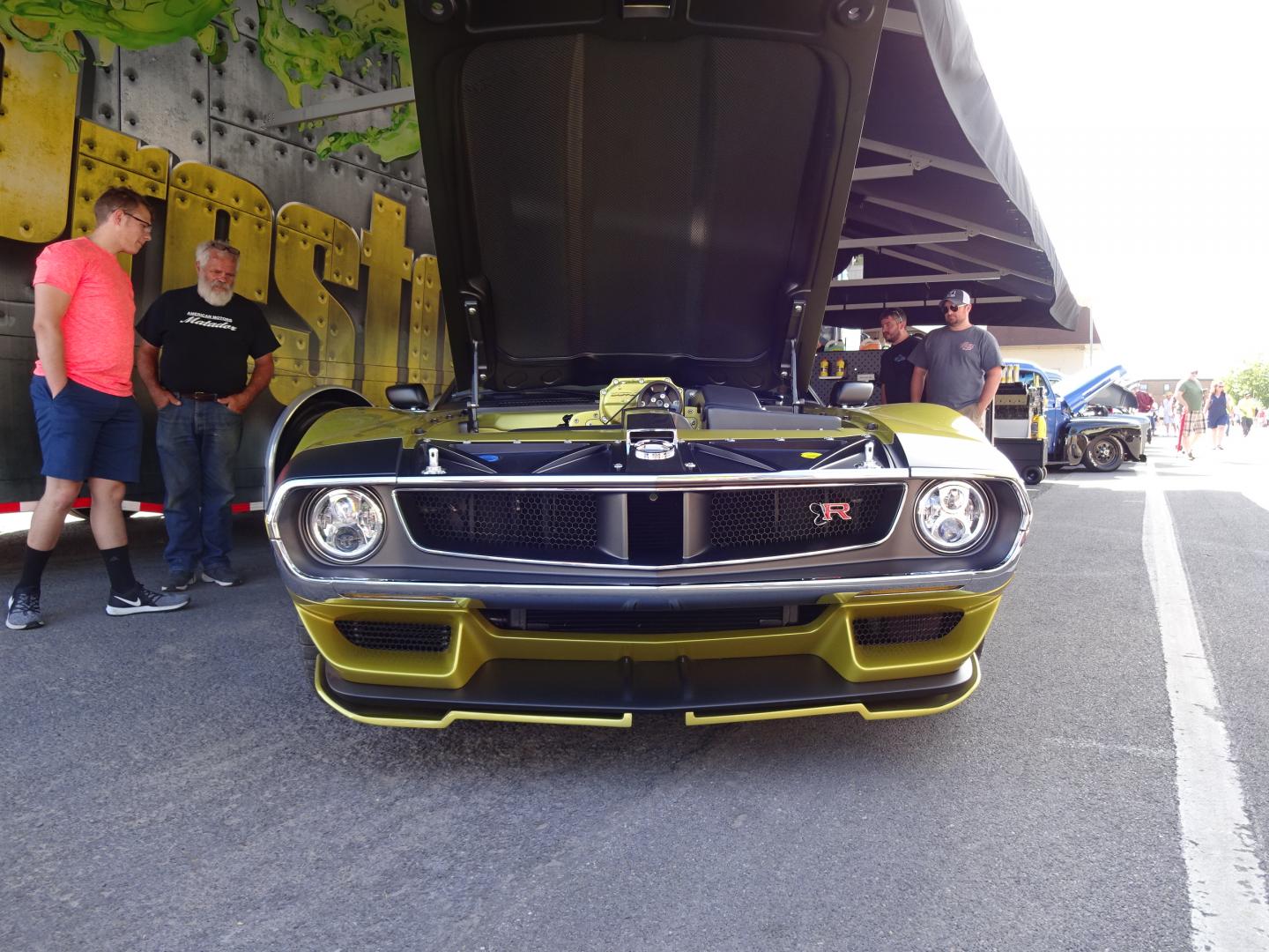

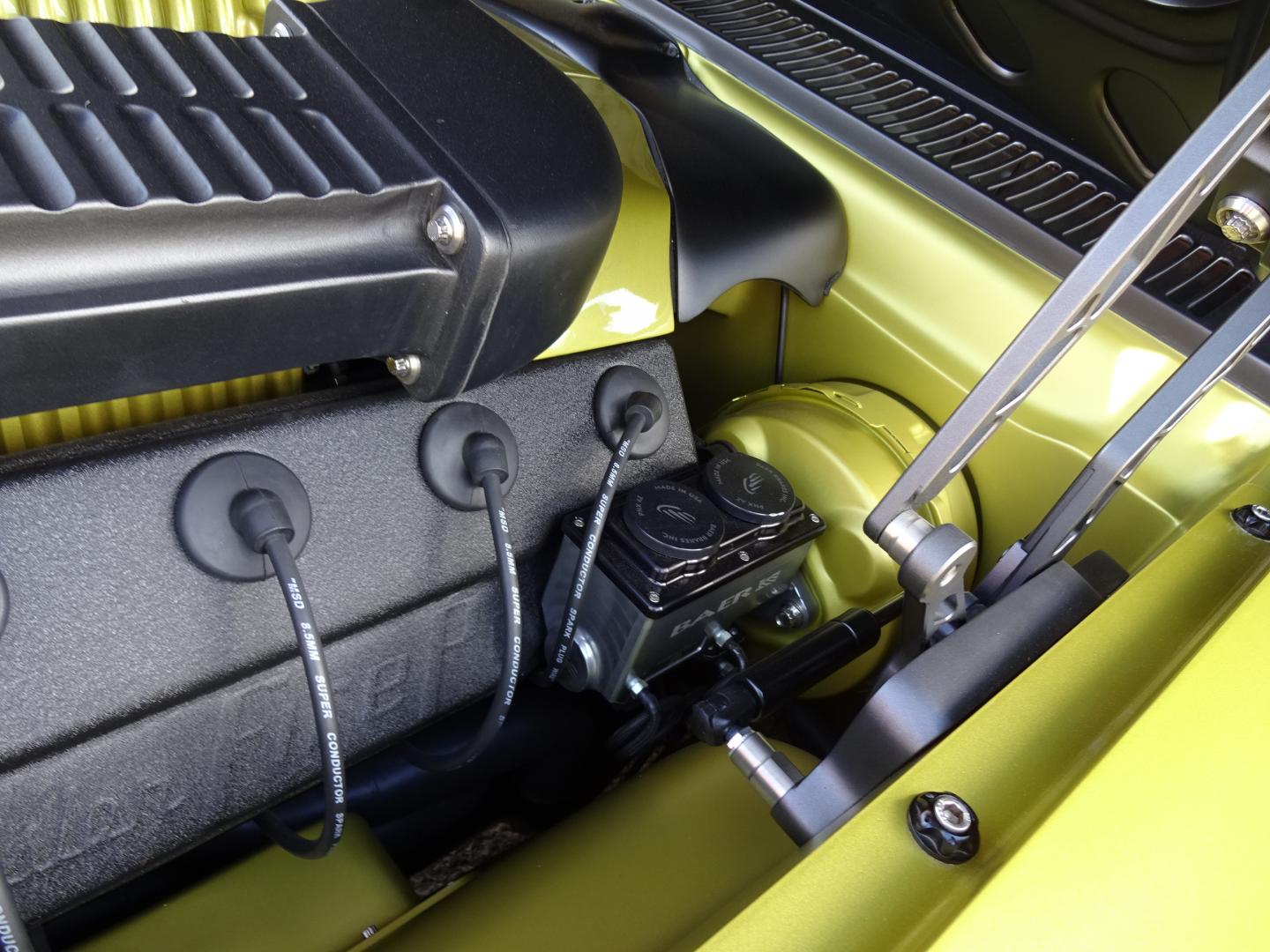

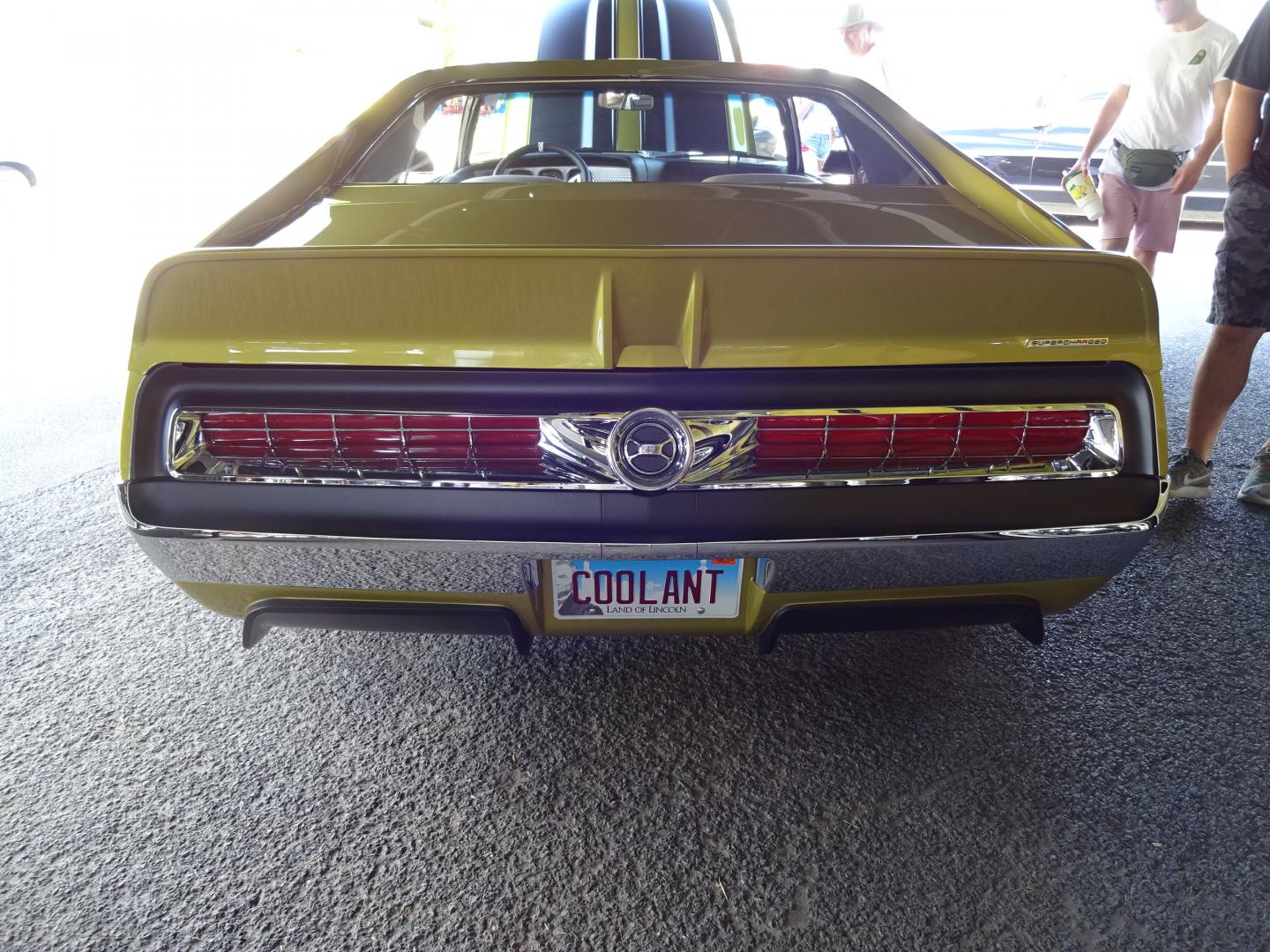

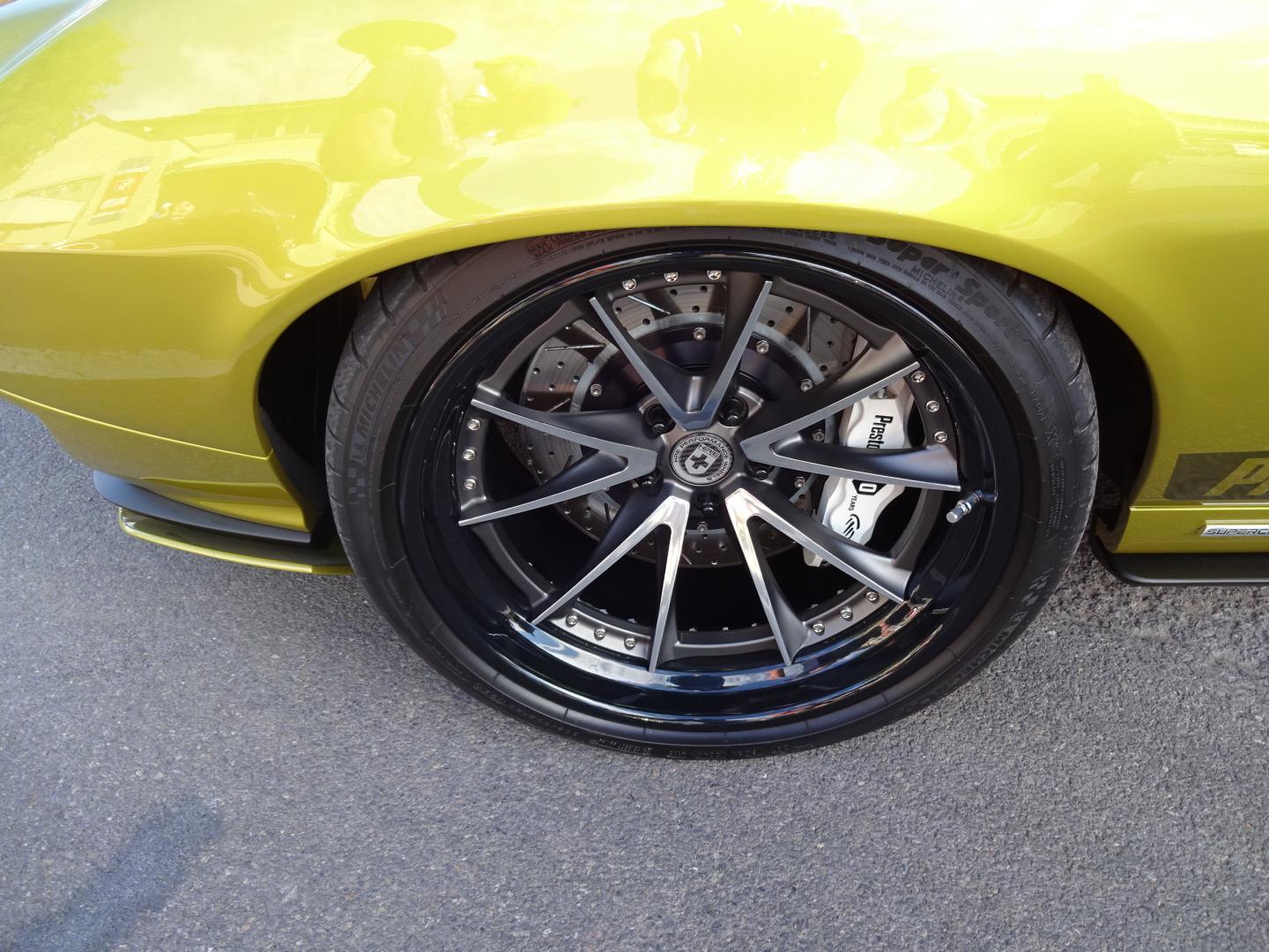

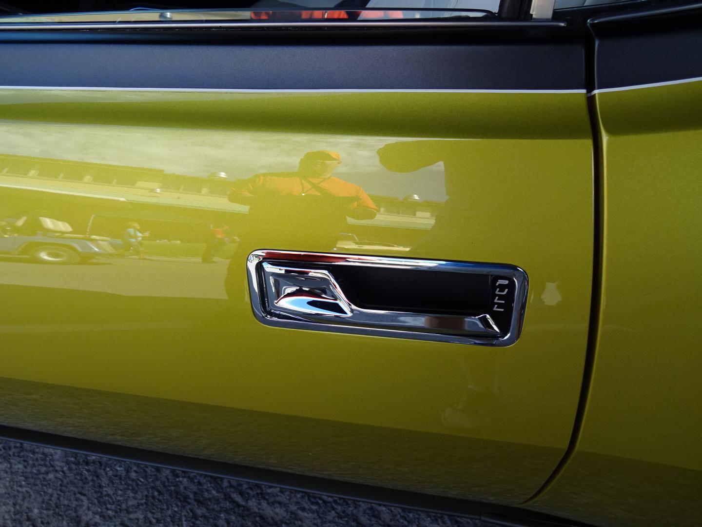

Karl Sheffer Posted June 6, 2019 Posted June 6, 2019 Detail shots I took at the Syracuse Nationals last year.

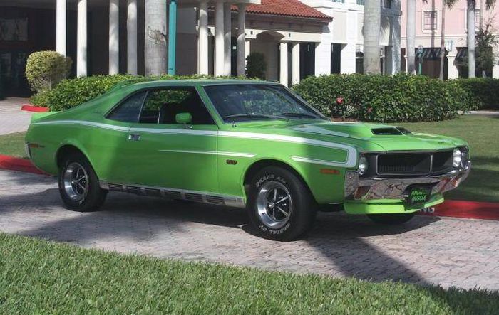

Dave Van Posted June 6, 2019 Posted June 6, 2019 (edited) I'm not buying that 61/2 inches were added to the front fenders. I know these cars.......that fender on the 'modified' car looks a LOT like the fender on my 73. (same for all years 71 thru 74) Maybe the WB is altered....but not 6.5 inches anywhere....IMHO ONLY. The 1971-1974 Javelins front fenders are about 6 inches longer than the first Gen Javelins. AMC had no money but wanted a different look for the 1971.......look under the hood and between the radiator bulkhead and grille is a huge gap! found a pic Thanks Edited June 6, 2019 by Dave Van
espo Posted June 6, 2019 Posted June 6, 2019 12 hours ago, Dave Van said: I'm not buying that 61/2 inches were added to the front fenders. I know these cars.......that fender on the 'modified' car looks a LOT like the fender on my 73. (same for all years 71 thru 74) Maybe the WB is altered....but not 6.5 inches anywhere....IMHO ONLY. The 1971-1974 Javelins front fenders are about 6 inches longer than the first Gen Javelins. AMC had no money but wanted a different look for the 1971.......look under the hood and between the radiator bulkhead and grille is a huge gap! found a pic Thanks First off you have a great looking Javelin and you should be proud of it. I agree the 6+ inches seems a little much, but if you do it right it isn't supposed to be noticeable. Looking at the side view of your car, ands it may just be the angle, but the front tire looks almost as if it is set to far back in the fender flair. Looking under the hood on the Ring car you can see how much additional space there is between the engine and the grill area. These guys have built several amazing cars and they really know what they're doing so I'd have to take their word for the wheel base changes.
Dave Van Posted June 6, 2019 Posted June 6, 2019 51 minutes ago, espo said: First off you have a great looking Javelin and you should be proud of it. I agree the 6+ inches seems a little much, but if you do it right it isn't supposed to be noticeable. Looking at the side view of your car, ands it may just be the angle, but the front tire looks almost as if it is set to far back in the fender flair. Looking under the hood on the Ring car you can see how much additional space there is between the engine and the grill area. These guys have built several amazing cars and they really know what they're doing so I'd have to take their word for the wheel base changes. It is an amazing car......a bit over the top for me as I said.....but great to see someone think of a AMC for such a project. My photo is a crappy cell pic.....but only one close to a side shot.....most of mine are 3/4!! Either way....if it's a AMC I love it.....with 2nd gen Javelins at the top.....for me!! Thanks

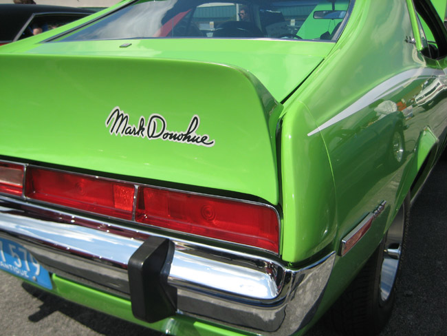

69NovaYenko Posted June 6, 2019 Author Posted June 6, 2019 I hope so. Even though I once owned a 1:1 `68 Javelin, my favorite model year is the `70 SST 390 Mark Donahue Javelin .

bobthehobbyguy Posted June 7, 2019 Posted June 7, 2019 I don't think the front fenders were lengthened 6 inchs. The front wheel wells were moved forward to center then with the arch in the front fenders. I think it was for 2 reasons. I think for appearance and for function. To me it looks better. Also effectively moves the engine weight back for better handling. I like what was done with the car.
