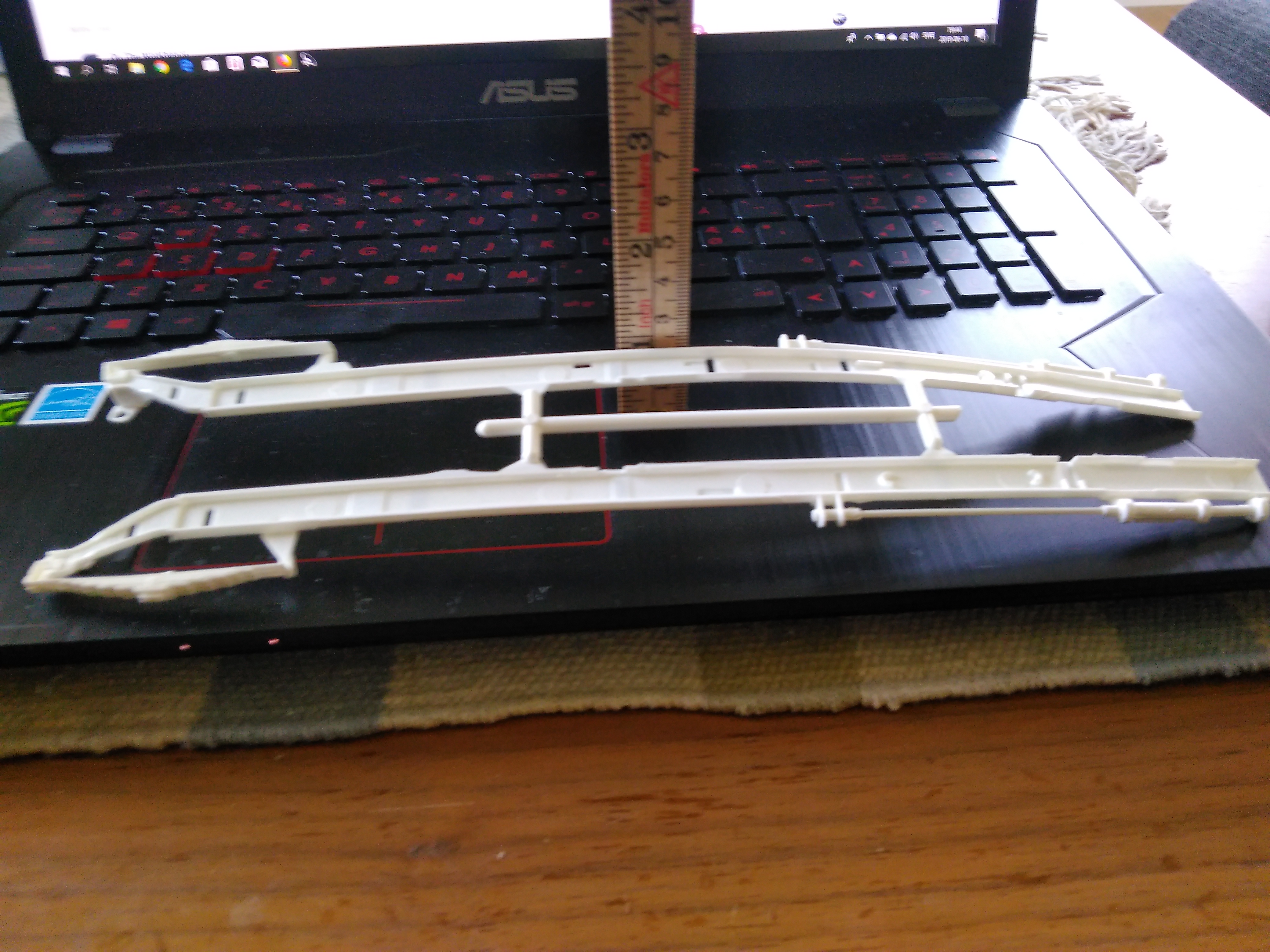

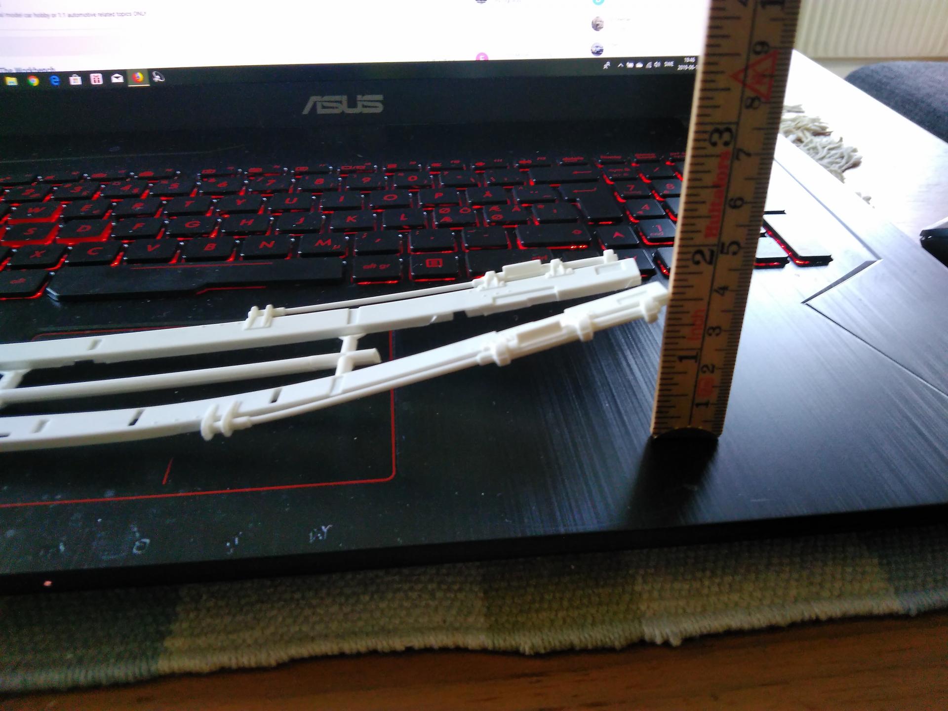

PierreR89 Posted June 18, 2019 Author Posted June 18, 2019 Here are some photos of the frame. Is it possible to save it with heat (water/heatgun) or its better to make/find a new one?
DrKerry Posted June 19, 2019 Posted June 19, 2019 20 hours ago, PierreR89 said: Here are some photos of the frame. Is it possible to save it with heat (water/heatgun) or its better to make/find a new one? With the way I do it would work too... Start in the middle of the frame and glue it two of the cross members and keep the two sides parallel with each other so it doesn't throw off the rest of the frame. Working your way out from the middle and holding rails in place as they dry will save that no problem.. Just to toss it out there, if you're unsure about doing it and you feel safe doing it, you could box the frame parts and send them here and I can put the frame together for you. Just a thought!! I can take pics of my jig if you'd like as well to give you an idea of what I have and how to use it if it would help. I use a smaller one for car and light duty trucks too...

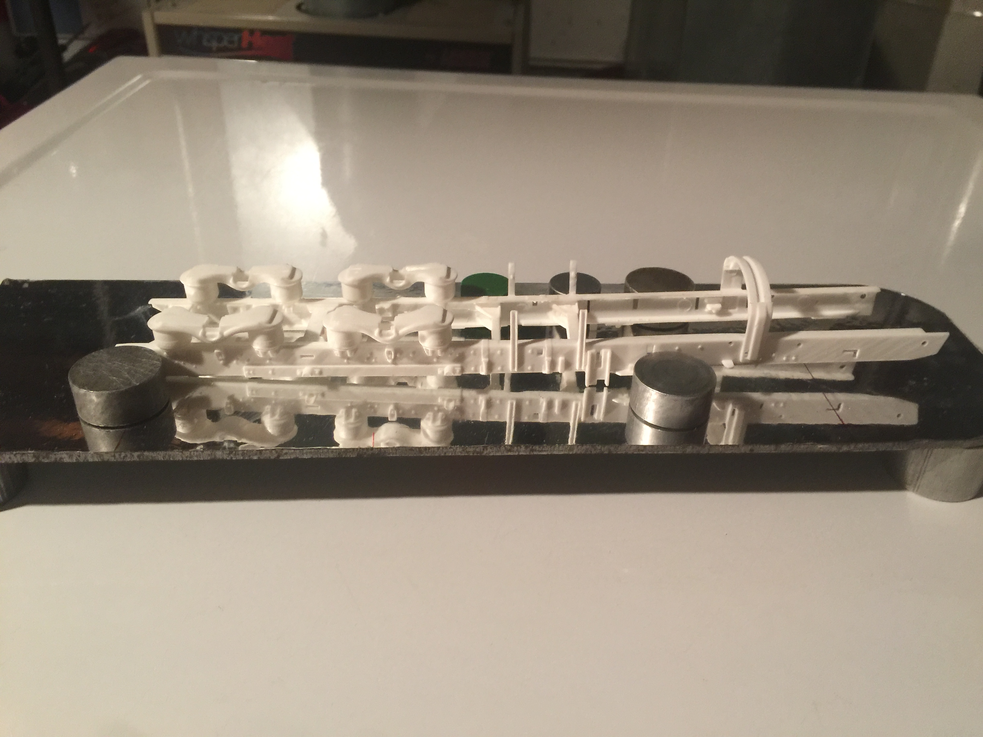

DrKerry Posted June 20, 2019 Posted June 20, 2019 16 hours ago, PierreR89 said: A pic of your jig would be nice so i can try and make something similar if i fail with the other suggestions. Thanks for the offer but i think it would end up costing to much in shipping and i would probably end up having to pay customs for my own things (almost everything from us to sweden gets stopped by them..) I'll take some pics tonight for you!! I have a KW frame built so I can use it to show some of how I use it.. 39 minutes ago, Jim B said: It's interesting that the torsion bars are molded right onto the frame. What kit is that? Hmmm? I'd like to know too.... LOL

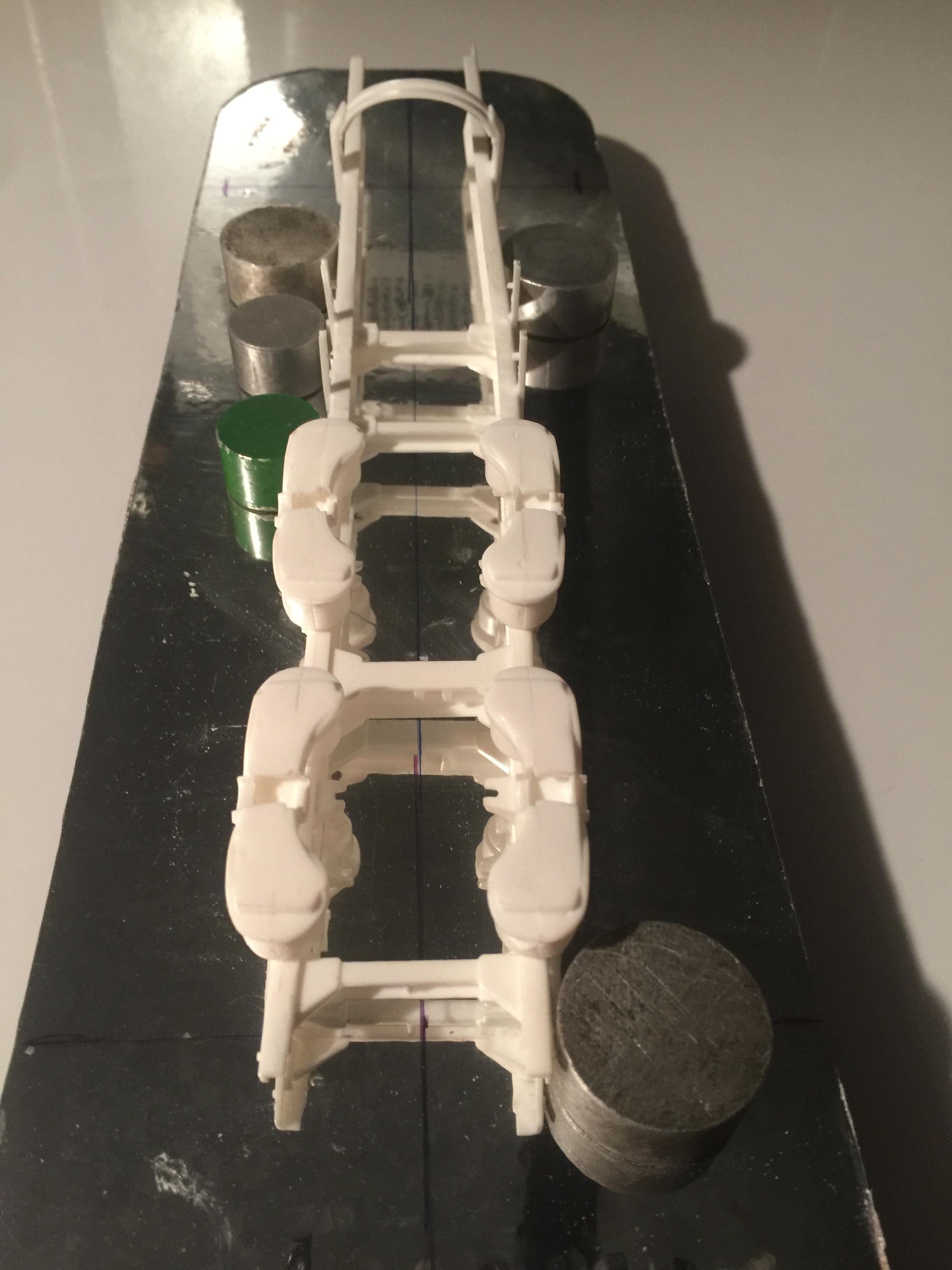

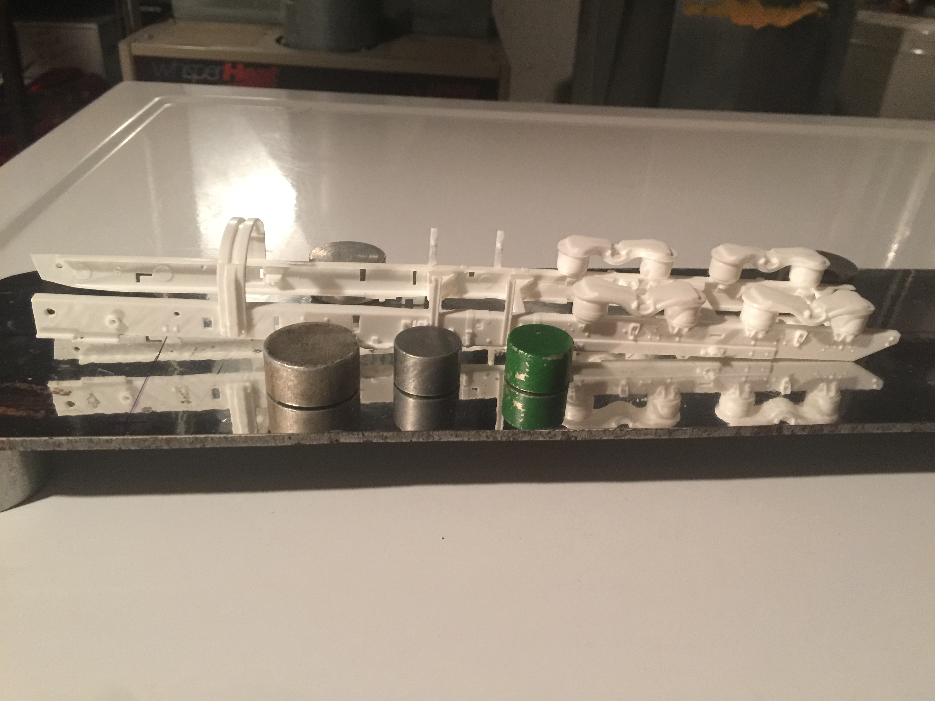

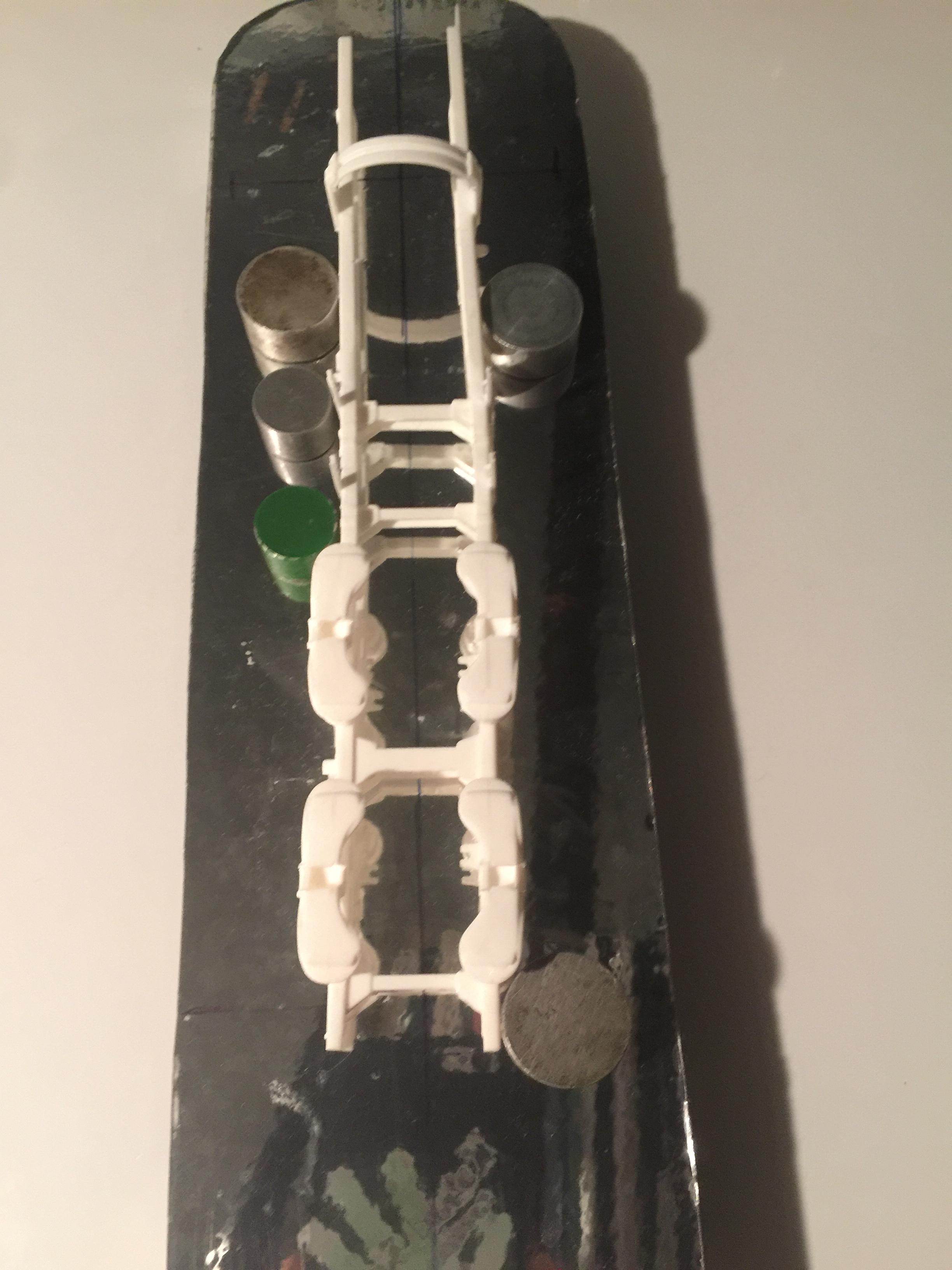

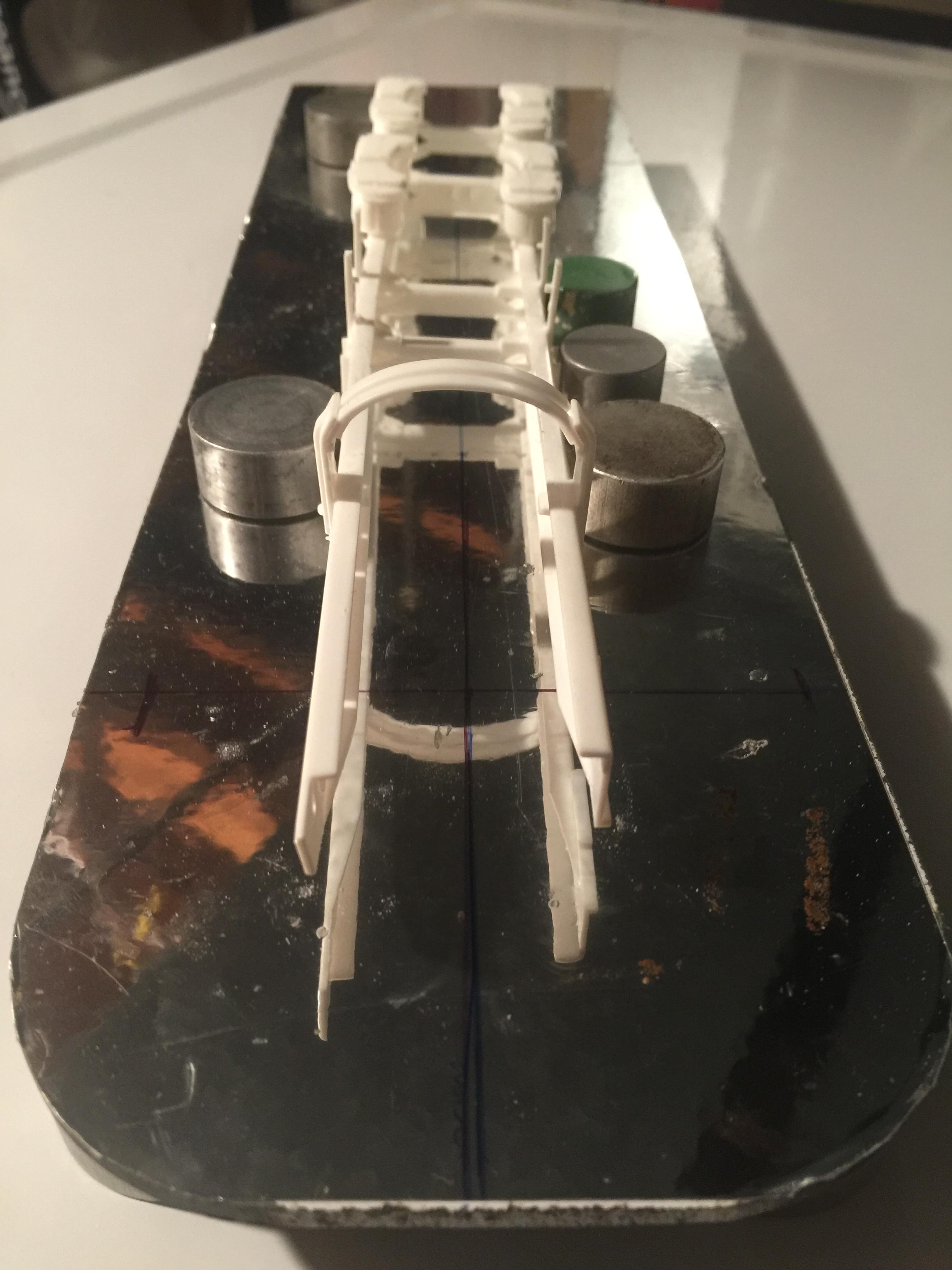

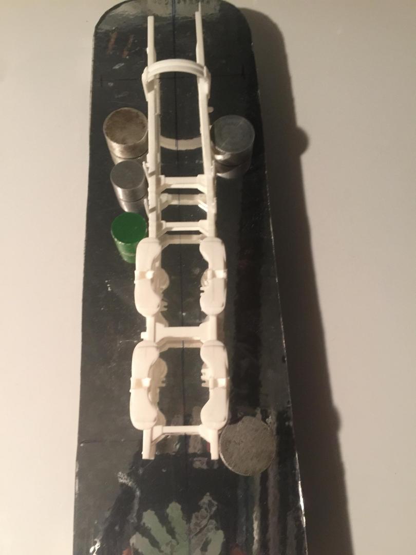

DrKerry Posted June 21, 2019 Posted June 21, 2019 Ok this was a quick throw together.. A person could use a wooden one with holes drilled and pins used. I use metal and magnets so they can be placed anywhere. I also have square steel plates that I can use under the frame to “shore” it up in the air if it needs something to keep it level and flat. I have a center line drawn down the center so that I know if the frame is straight as it dries. I put a slight curve in the frame you see here, you don’t want much of a bend as it may bend the other way.. i have even used a combination square across the back of the rails to keep the rails even with each other as I glue the center two crossmembers in, then wait for them to dry really good before you start working the bends out.. If you have anymore questions ask away, I can show better pics too if needed! Last pic shows the over over bend better...
