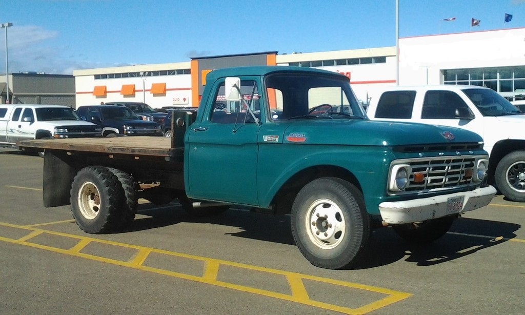

mk11 Posted July 4, 2019 Posted July 4, 2019 (edited) 15 hours ago, bill lanfear said: Thanks Lou, the color I am going with is the Caribbean blue/green color Ford had on these. Like this one? Great concept Bill. I can see I might need to add a few parts to the order Edited July 4, 2019 by mk11
bill lanfear Posted July 4, 2019 Author Posted July 4, 2019 Thanks Mike, no the color is more like this one.
