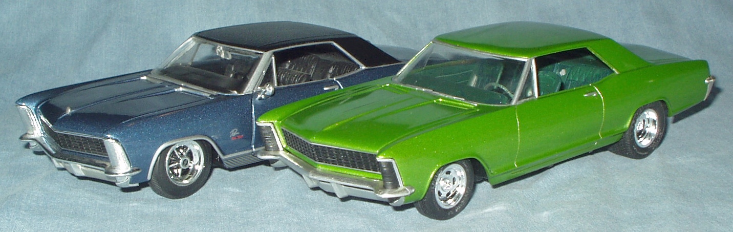

Snake45 Posted July 7, 2019 Posted July 7, 2019 Testor WLC is very tough stuff as paint goes, which is why I suggested starting with #1000 grit, especially for the relatively rough surface you're starting with. Here's the last WLC paint job I wet-sanded and polished out (the green one). 3 coats of WLC, 24 hours apart, then knocked down flat with #1000 wet, then polished with Wright's Silver Cream. Shiny enough for me.
