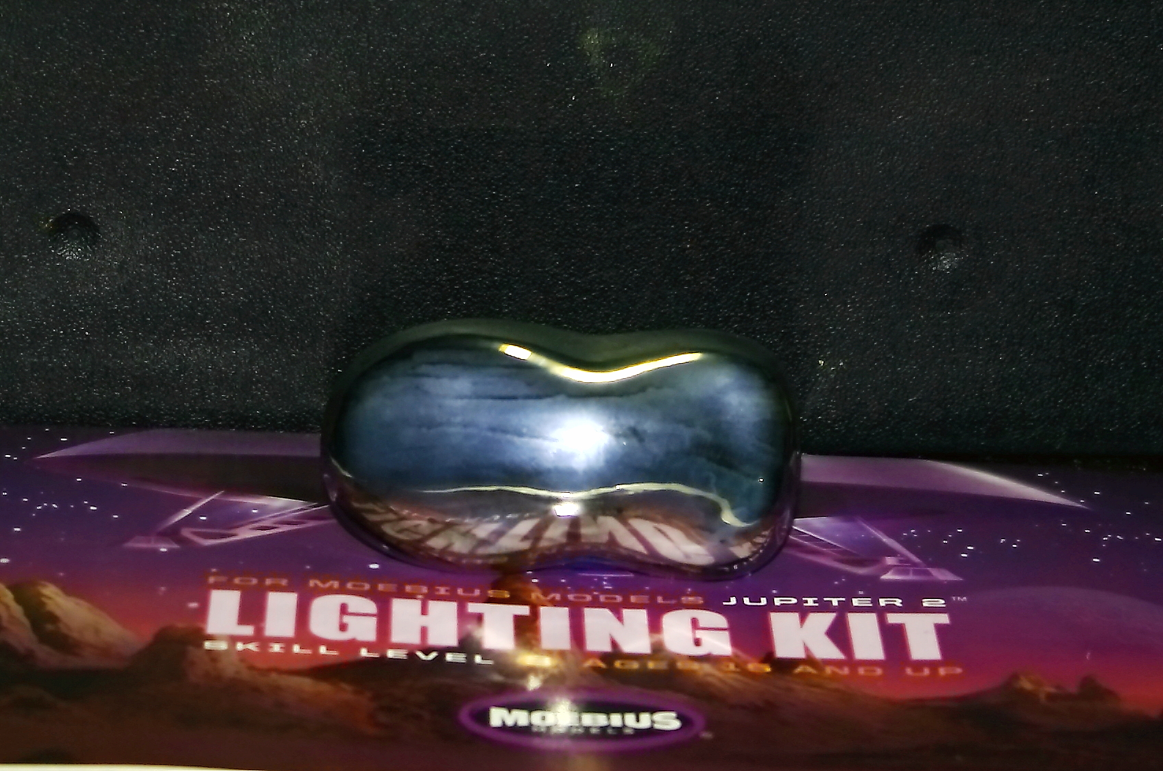

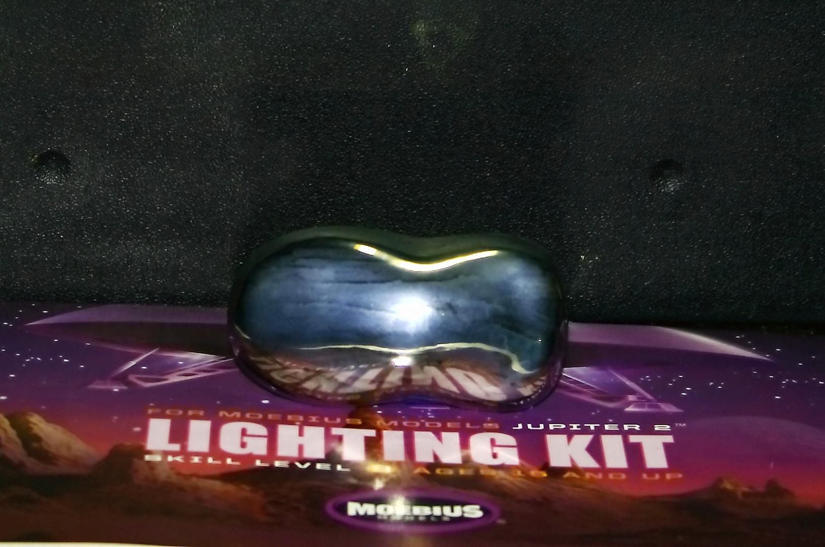

SfanGoch Posted May 2, 2019 Author Posted May 2, 2019 (edited) Ach! Luddites all! You wanted an example? Here it is. This is one of the speed shapes, molded in black styrene, onto which I hand brushed both, using a 1/4" brush, the clear base coat and a single coat of Easy Chrome. No clearcoat was applied: Again, this was hand brushed. Airbrushing produces a much more even finish.It's extremely durable. It doesn't rub off and is fingerprint-resistant. And, you can clearcoat it without diminishing its brilliance and reflective qualities. That said, you can see the lettering from the Moebius Lighting Kit booklet reflected clearly on the speed shape. If this doesn't convince any doubters as to the product actually working as advertised, I don't know what to tell you. You won't get better than this even by vacuum plating, using Alclad and definitely not with Molotow. Edited May 2, 2019 by SfanGoch
StevenGuthmiller Posted May 2, 2019 Posted May 2, 2019 1 hour ago, SfanGoch said: Ach! Luddites all! You wanted an example? Here it is. This is one of the speed shapes, molded in black styrene, onto which I hand brushed both, using a 1/4" brush, the clear base coat and a single coat of Easy Chrome. No clearcoat was applied: Again, this was hand brushed. Airbrushing produces a much more even finish.It's extremely durable. It doesn't rub off and is fingerprint-resistant. And, you can clearcoat it without diminishing its brilliance and reflective qualities. That said, you can see the lettering from the Moebius Lighting Kit booklet reflected clearly on the speed shape. If this doesn't convince any doubters as to the product actually working as advertised, I don't know what to tell you. You won't get better than this even by vacuum plating, using Alclad and definitely not with Molotow. I'm up for the challenge! Now I just need to scrounge up $160.00. Steve
peteski Posted May 2, 2019 Posted May 2, 2019 While the shine is there on that slick "speed shape", how thick is the paint coat? Like Mike said, if the paint goes on too thick, it will obfuscate small details. If I have some delicate parts, I don't want them to look like they were dipped in pancake syrup.
SfanGoch Posted May 2, 2019 Author Posted May 2, 2019 (edited) Literally one, thin coat applied with a paint brush. Easy Chrome has the viscosity of water; so, it can't be sloshed on like, for example, acrylic or enamel paint because it isn't paint. The carrier is lacquer-based. Airbrush application is even thinner. Edited May 2, 2019 by SfanGoch
SfanGoch Posted May 2, 2019 Author Posted May 2, 2019 (edited) On 4/24/2019 at 9:31 PM, Maindrian Pace said: On their site, they say that 5-6 coats of various materials are required for this system to work. You do understand that this refers to large non-model kit applications like car/truck rims, bike helmets, etc.? Look at the speed shape in my photo. One coat of the urethane basecoat and one coat of Easy Chrome. That's it. It doesn't get any easier. But hey, if you want to spend 50+ bucks to re-plate a couple of bumpers/grilles, then maybe wait a couple of weeks to get them back, who am I to tell you how to spend your money? I took a chance after reading the thread Pete J. posted about it in OTL and am satisfied that it does as advertised. Pete J's results: Quoting Pete: "Yes, I did some of the chrome work with a brush just to see how it would work." Nuff said. His pic says it all. Addendum: When applying Easy Chrome with an airbrush, spray very light, misting coats until you see the mirror-like finish appear. Stop at this point and don't apply further coats. Edited May 2, 2019 by SfanGoch
