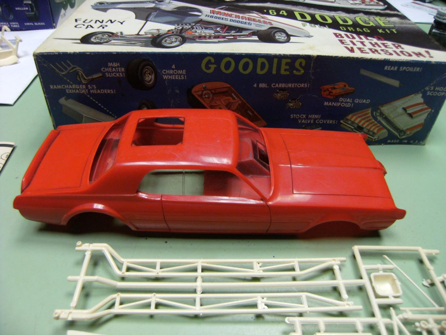

iBorg Posted July 22, 2019 Share Posted July 22, 2019 (edited) Logghe chassis were molded by several manufacturers. These include AMT (the rather poor one under their Vega/Gremlin and maybe the Funny Hugger 1). MPC with two or three versions, including the stage 1 under the Cougar and a stage 2 under the Judge and others and a third under the very rare Candies and Hughes Cuda. Revell with the hot mess under their Funny Hugger Camaro, Maverick and Mustang. Polar Light with their one size fits most chassis under Mustangs, Cuda and Chargers. Revell with the Chi Town Hustler and finally the Jo-Han chassis included with several funny cars such as their Hornet. With that list in mind, I'm trying to build an ACCURATE Dyno Don Cougar. I have samples of each of these. I'm curious as to which chassis the collected wisdom has as their choice of best. Edited July 22, 2019 by iBorg Quote Link to comment Share on other sites More sharing options...

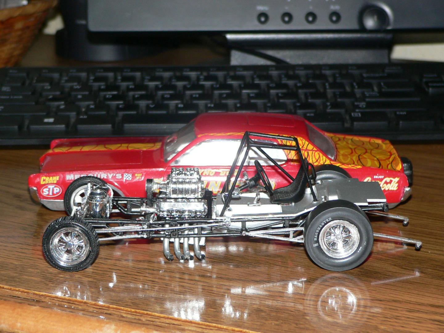

magicmustang Posted July 22, 2019 Share Posted July 22, 2019 (edited) 1 hour ago, magicmustang said: The one shown on the side of the box is the most accurate, but that's not the one inside the box. Inside is a stage I Logghe but Dyno was running a Stage II in late '67 and '68. The later MPC Stage II Logghe is correct but pricy and hard to find. The Polar Lights chassis in their Mustang FC kit is close. My old built MPC kit from the 70's with the correct Logghe chassis. Edited July 22, 2019 by magicmustang 1 Quote Link to comment Share on other sites More sharing options...

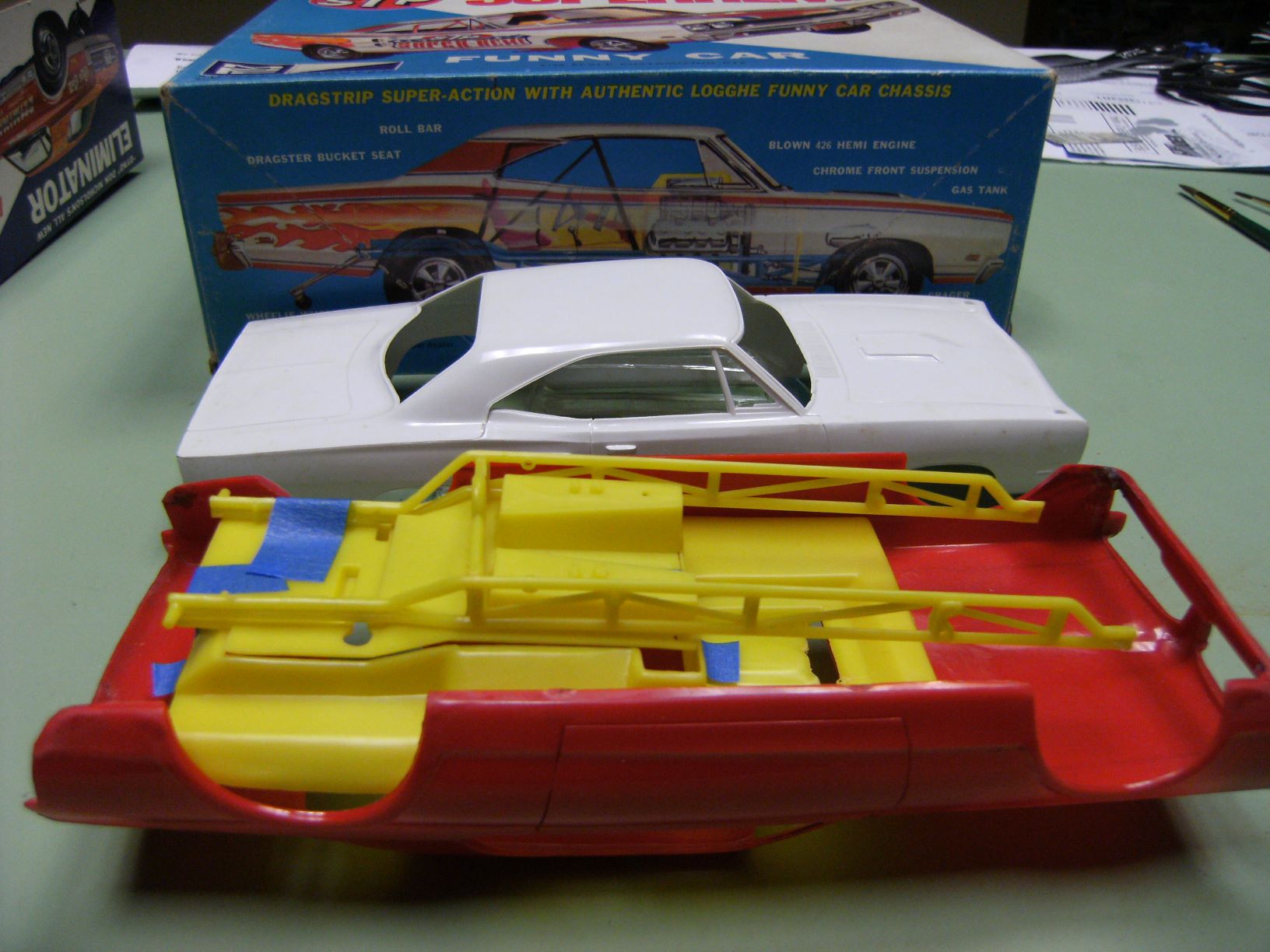

iBorg Posted July 22, 2019 Author Share Posted July 22, 2019 Thanks for the wisdom. So to summarize, the chassis in the MPC Cougar and Judge (since they're both obtainable) are Stage 1's. The PL chassis is a Stage 2 and the Revell Hawaiian is a Stage 3. A bit of reference: 1 Quote Link to comment Share on other sites More sharing options...
magicmustang Posted July 23, 2019 Share Posted July 23, 2019 I would say the chassis in the MPC Cougar and Judge are even "Pre" Stage I. Like your pics. Quote Link to comment Share on other sites More sharing options...
iBorg Posted July 23, 2019 Author Share Posted July 23, 2019 I'd agree. The roll cage is different although Logghe had three or four designs. The first Eliminator 1 had a roll cage that looked like an upright altered. The Eliminator II had a more full cage. Quote Link to comment Share on other sites More sharing options...

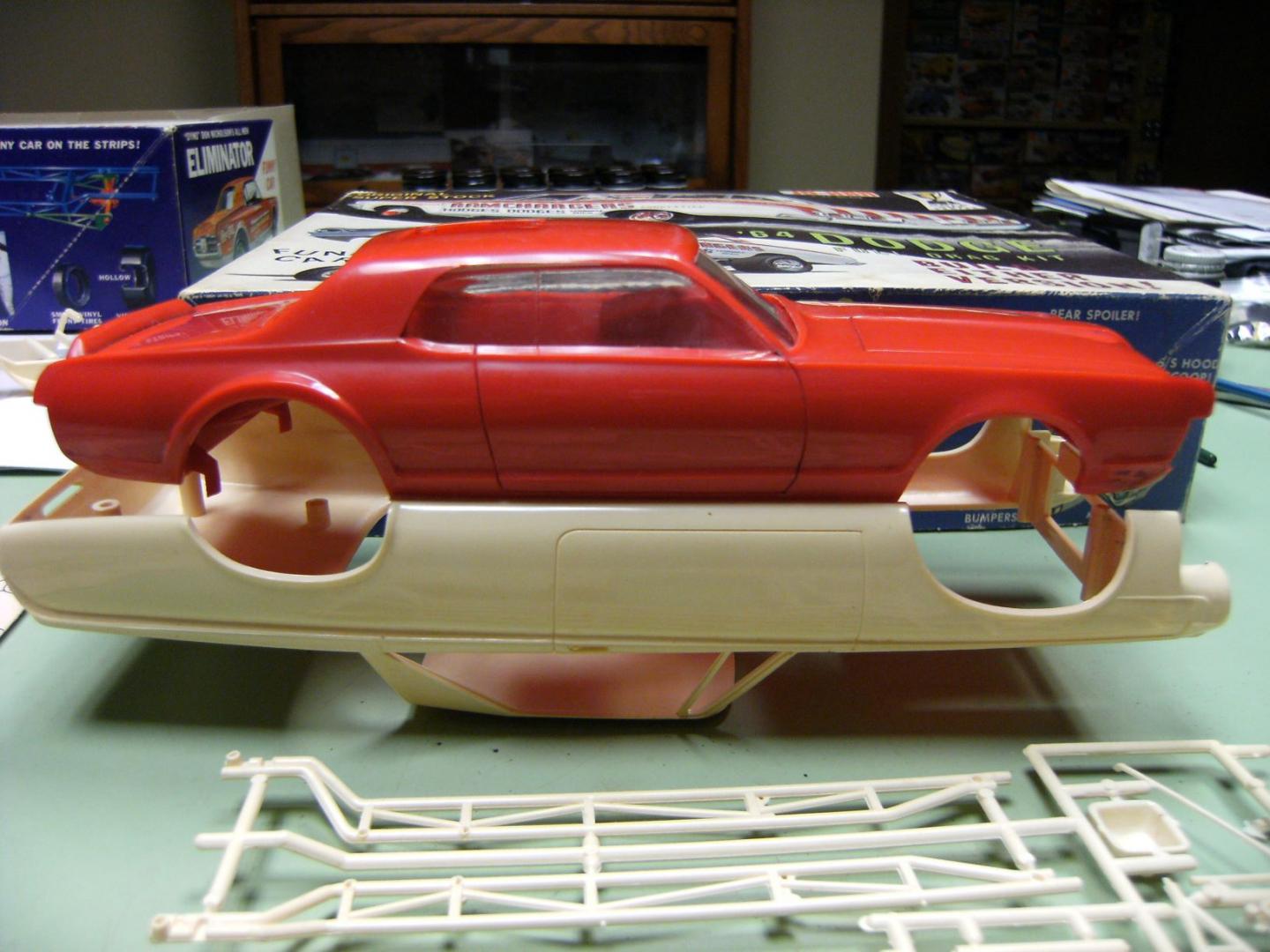

mvadrag Posted July 23, 2019 Share Posted July 23, 2019 Interesting discussion on Logghe chassis. May be hard to find, but the Johan funny car chassis for the 64 Dodge has about the same wheelbase. You would have to narrow the interior "tin" to fit, but looks doable. 1 Quote Link to comment Share on other sites More sharing options...
mvadrag Posted July 23, 2019 Share Posted July 23, 2019 (edited) Also, the MPC Super Hemi funny car (Dodge GTX?) has a Logghe stage II chassis and also has about the same wheelbase. Again, hard to find nowadays. I did a quick mock up, the "tin" would again have to be narrowed. One more comparison. Here are the Polar Lights, Johan, and MPC chassis with the location where the cross member for the rear suspension attaches lined up with the left edge of the scale. Johan frames also had a version that had longer tubes at the rear with tabs below for the body hinge. Edited July 24, 2019 by mvadrag More info. 1 Quote Link to comment Share on other sites More sharing options...
