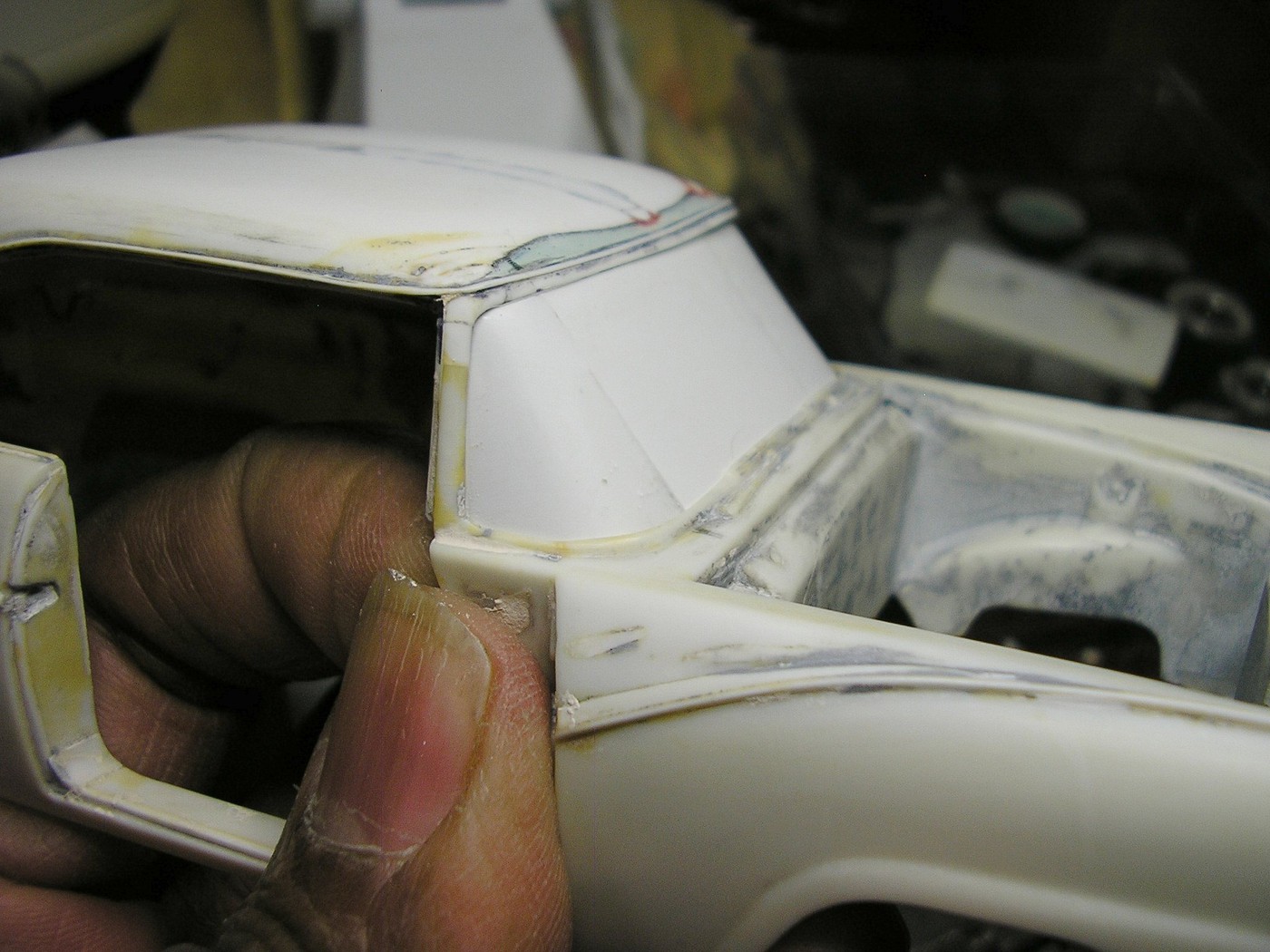

MrObsessive Posted February 23, 2020 Author Posted February 23, 2020 Haven't forgotten about this fellas! Finally able to get back to this! As usual, the hangups about how to approach the glass were daunting to me, especially for a '50's car because there's so much of it. I had used clear stencil sheet for the glass before, but I really did not feel like fighting that to keep its shape as both front and rear glass have compound curves. I had recently bought some clay to try and "mold" the shape using some very low shrinkage stuff called "Critter Clay". Problem is it has at least a week's curing time, and it is VERY messy to work with. I don't have a pic of it here as it's still curing, but in the meantime I figure why not try to make a basic pattern using plastic? So that's what you see here. Like the '59 Chevy and the '74 Corvette, I'll "box these in" and fill the cavity with Plaster of Paris. The clay will come in handy in this case as I can use it to make some sort of base for the bucks to lay on, so it'll form properly in the vacuform machine. I'll get the glass to fit just a teeny bit more flush with the trim. Cars of this vintage did not have flush glass as that was many years away, but they also didn't have a huge offset such as what can be seen of certain kits of the '60's and '70s when built. Here are the patterns I've made using simple sheet plastic heat formed and bent to my liking. As I mentioned, I'll make some sort of flange around the perimeter of the buck, box it in with more plastic, and then fill the inside with the plaster for strength. Before it's all said and done, I'll polish up the surface a bit to make the glass as smooth as possible once it's vacuformed. I'd like to get the glass molded and test fitted in the next week or two. After that, I'll need to tackle the dash as that got damaged when I had to dissassemble the car to redo it. The edge that goes against the windshield base snapped and I'll have to figure out a way to rebuild that. Finally, it's the last teeny bit of bodywork and it's on to the paint booth! Same colors as before, but with extra safeguards this time around that should ward off any surprises such as cracking/crazing bodywork. Thanks to all of you following along!
randyc Posted February 24, 2020 Posted February 24, 2020 Egads! My mind boggles at the patience it would take to do that. I just wouldn't have it. Can't wait to see the results though. I'm sure it will be spectacular.

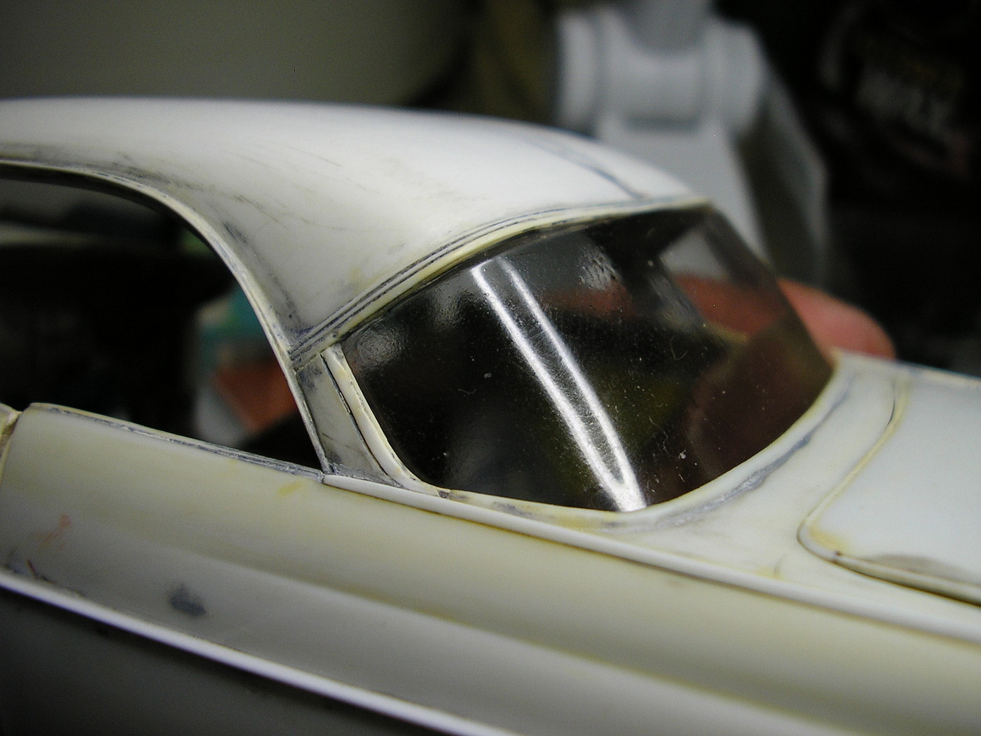

MrObsessive Posted March 21, 2020 Author Posted March 21, 2020 (edited) OK..........posted too soon earlier. Hit the Ctrl/Enter keys by accident and needed to add more. FINALLY! After numerous tries in doing the glass, I was able to get copies that I liked so here they are. It would have been MUCH easier if the glass existed already and I could do molds off of that. But..........since this car was never done before I had to make my own bucks as you saw previously and go from there. On a side note..........I have no extra time to build like a lot of you guys might have due to the virus and its aftermath. Where I work is considered an "essential business" and I'm working my hours as normal (third shift). Just the same, that may change in the coming days so I'm not ruling anything out. Here's the result of what I was able to do with my vacuforming machine. BTW, I should warn those that are looking into getting one of these that PATIENCE is a definite must here. With both the front and rear glass combined, I'd say it was a total of a dozen tries till I got what I wanted. Still not 100% perfect, but MUCH better than fighting with stiff clear stencil sheet like the last time and to my eyes the rear glass is better shaped with those compound curves. Here we go.................. I might tint the glass that '50's bluish-green which was popular back in those days. That'll depend on how well I can get the glass in after a number of test fittings without scratching things up such as the tint. Now it's on to the dash which I wrecked as I mentioned before. After that's done, it's on to base primer/barrier coats, then the color coats which can be set aside for a bit till I figure out what I want to work on next. Thanks for keeping up with this! Edited March 21, 2020 by MrObsessive

MrObsessive Posted March 21, 2020 Author Posted March 21, 2020 Oh I almost forgot to mention..............earlier I said something about using "Critter Clay" as a buck for making the glass. Well, scratch that. There's waaaay too much shrinkage for it to be any use and the way I did this pretty much works for me in the future. Thanks goodness I'm not a prolific builder! I couldn't deal with the distorted glass on a regular basis! Drives me CRAZY! ?

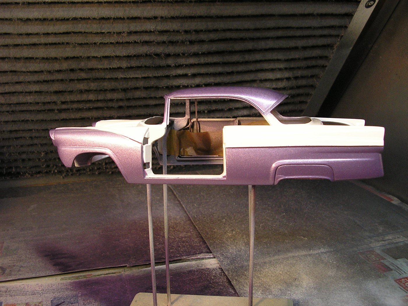

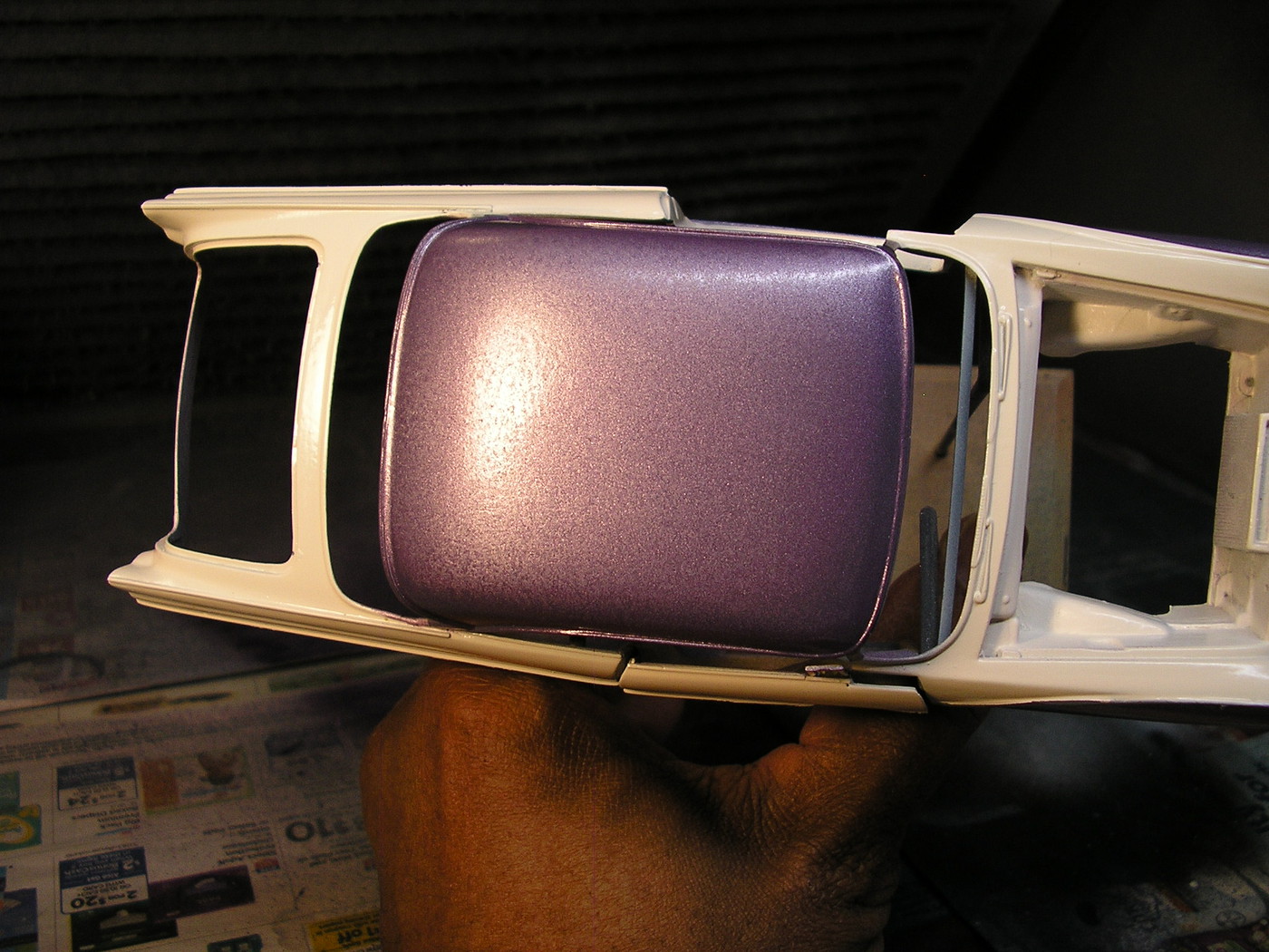

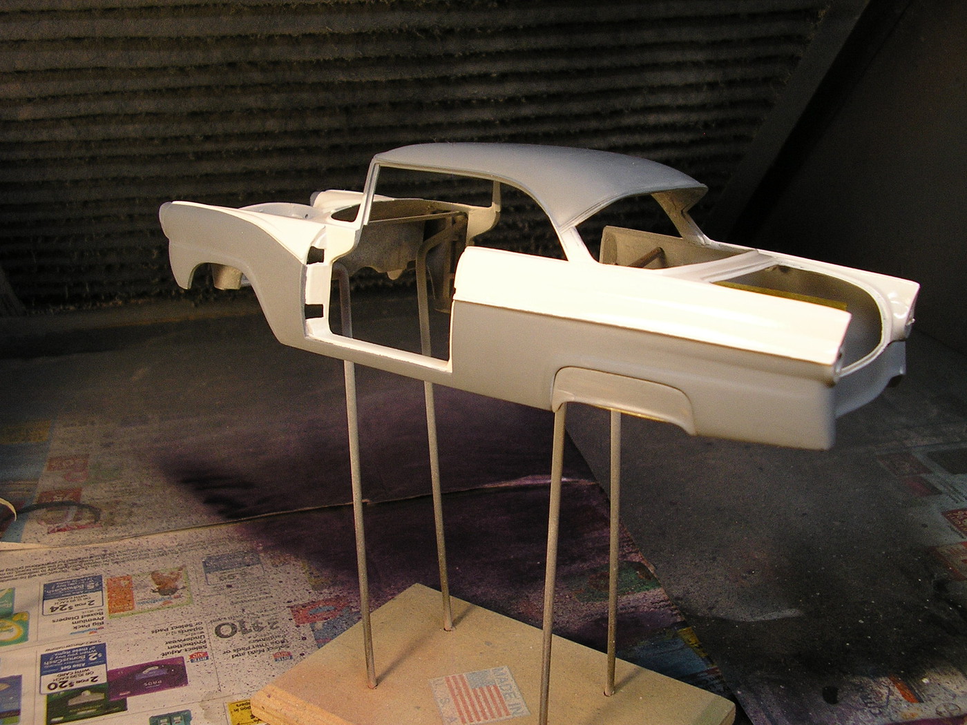

MrObsessive Posted January 16, 2021 Author Posted January 16, 2021 (edited) Has it been almost a YEAR since I posted on this?? I guess so as I see a March post date for the last time I mentioned something. Well, since the Mustang is in the history books as far as getting done, I gotta get back to this one. It's hard to believe that is been OVER 15 years since I started working on this. The reason I remember is because when I went to Puerto Rico in 2006, I remember taking this with me as there's pics of it sitting on one of the pavilion tables when we had a get together at a local park one night. Wow does time fly! Well, it's finally got some NEW paint on 'er. Here are some pics of how that went so far............... This is the second time I've repainted this Ford with the first paint job literally showing the bodywork that was done after a period of time. The entire body was first done in Duplicolor Gray with the BIN Zinsser sealer underneath. I wanted NO chance of any paint crazing the bodywork after all the work that was done to redo this. After the primer was thoroughly dry, I did the first color in Snowshoe White, an original '55 Ford color I got from Paintscratch.com. After the white was thoroughly dry, I painted the second color once again Regency Purple, a 1954-'55 color I got through Paintscratch. I'll be clearcoating the purple in the milder Tamiya X-22 Clear. I don't want to take the chance of ANY issues with clear after all the work done, so this is the mildest paint I have which should have no issues going over the hotter paint. After that's dried through, I'll rub out and polish the clear as I usually do. So far so good! No trace of where the redone work was on the roof. I highly recommend the BIN Zinsser as a sealer ESPECIALLY for the softer plastics that are being foisted on us these days in new kits. That's it for the time being. I'll try to clearcoat it in the coming days, let it dry and then rub out and polish the clear. Then it's on to getting everything back together again with some other details I had never gotten to. Thanks for looking! Edited January 16, 2021 by MrObsessive
Can-Con Posted January 16, 2021 Posted January 16, 2021 Nice to see someone using the BIN. I've been using it for almost 30 years now. Glad to see you back on this one Bill. I know it was giving you headaches in the past.
espo Posted January 17, 2021 Posted January 17, 2021 I'm glade to see you are getting this one restored again. The colors really look good together, one thing about the '50's the manufactures were not shy about using color on their cars. While reviewing your earlier pictures of this build I liked seeing how you created all of the body chrome moldings.
doorsovdoon Posted January 17, 2021 Posted January 17, 2021 That's a combo that pops! Looks very nice.
