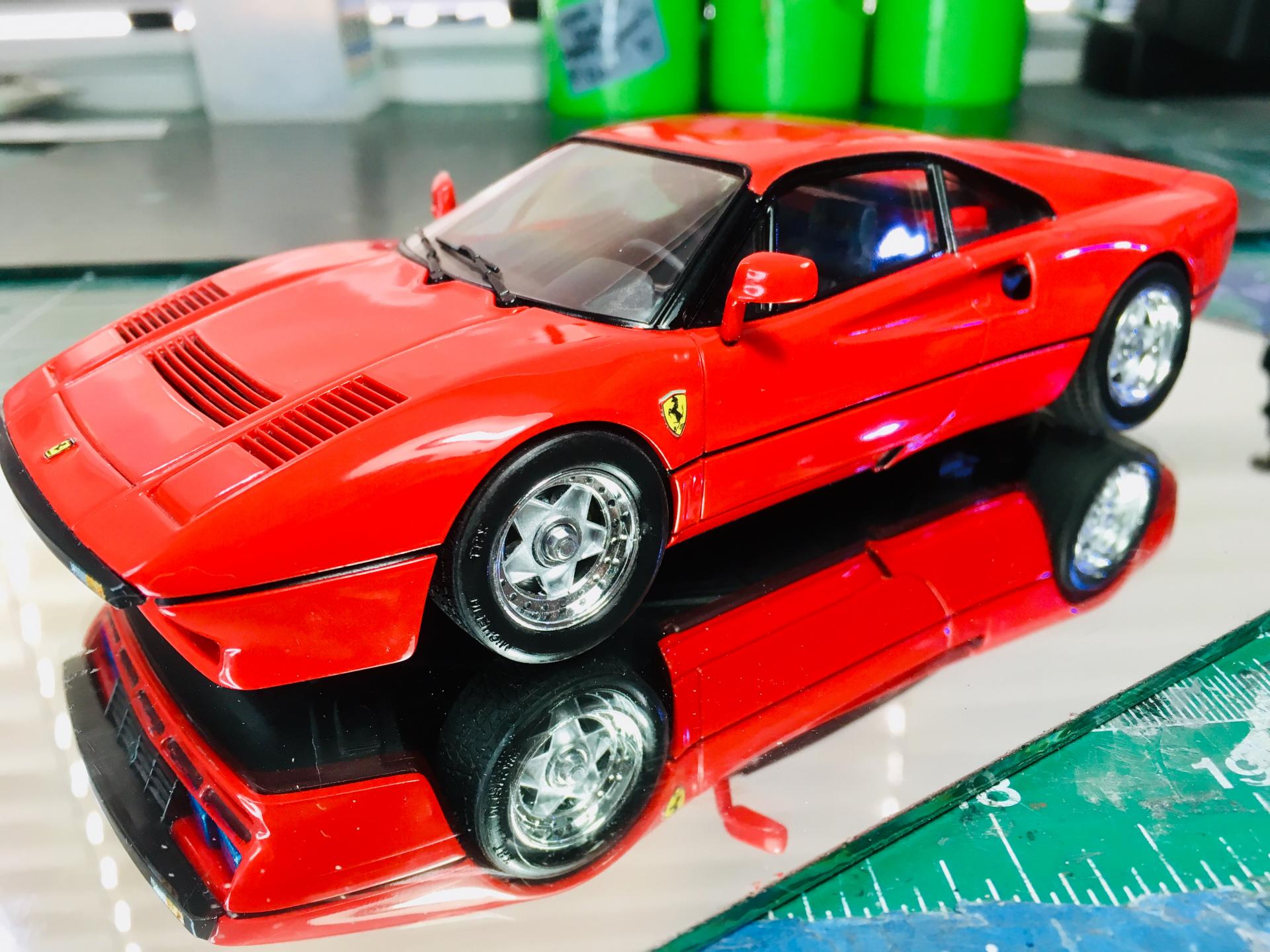

Brudda Posted August 7, 2019 Posted August 7, 2019 I primer just the body and the parts that need filler . Like sinkmarks with superglue, or if it’s really rough , then I prime. It is to see the imperfections and sand out. Otherwise I just paint. This model had sinkmarks everywhere! So I primed the areas that I had to fix. Body, seats, dashboard, rear suspension cradle, turbos and inter coolers, air intakes. It’s your preference but this is what I do.
