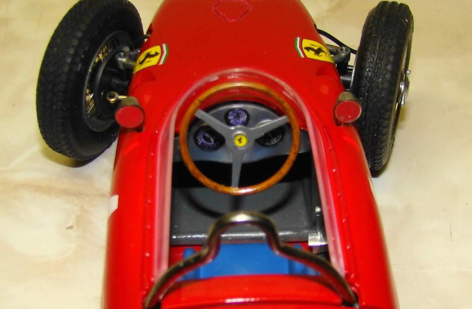

Rich Chernosky Posted August 21, 2019 Posted August 21, 2019 Andy, Thanks for putting this up. It is going to be great fun doing this. I have already started with just a few things. Mostly looking the kit over in great detail. Some body seams cleaned up and cutting out the openings for the rear engine screens. I don't plan on going to quite the great lengths as Andy but there will be many modifications for sure. I plan on fabricating most of the suspension and coil over shock units, cutting open the engine cover and detailing the engine as much as possible. Filling in the seam between the upper and lower body panels will be a must. After market wheels and tires have already be obtained many years ago. We traded these kits in 2010. Most of my reference will come from my experience with the Revival 1/20 version of this car. Shown is the built model I did in 2011. There is also plenty of reference on this car on the web as it is a heavily modeled subject. Not in 1/24 but both CMC and Exoto have done this in 1/18. The chassis on this kit was very detailed to begin with but I added a few extras I am not new to making these screens.

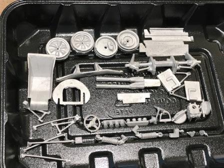

absmiami Posted October 1, 2019 Author Posted October 1, 2019 this is the white metal Louts 25 kit - which will be the basis of the Lotus 32B build plan to use a small portion of the lower body and a part of the upper body plus some of the misc wh metal parts - like the suspension uprights and the wheels the tires - by the way - are not bad - but I will source some Dunlops with proper tread pattern detail
