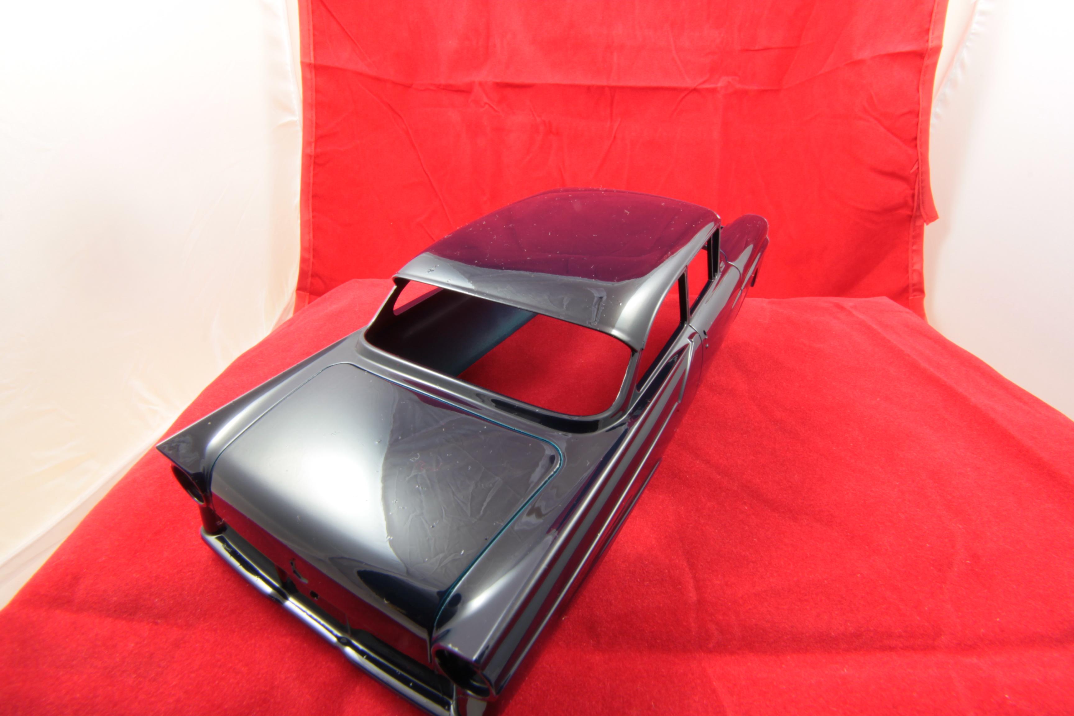

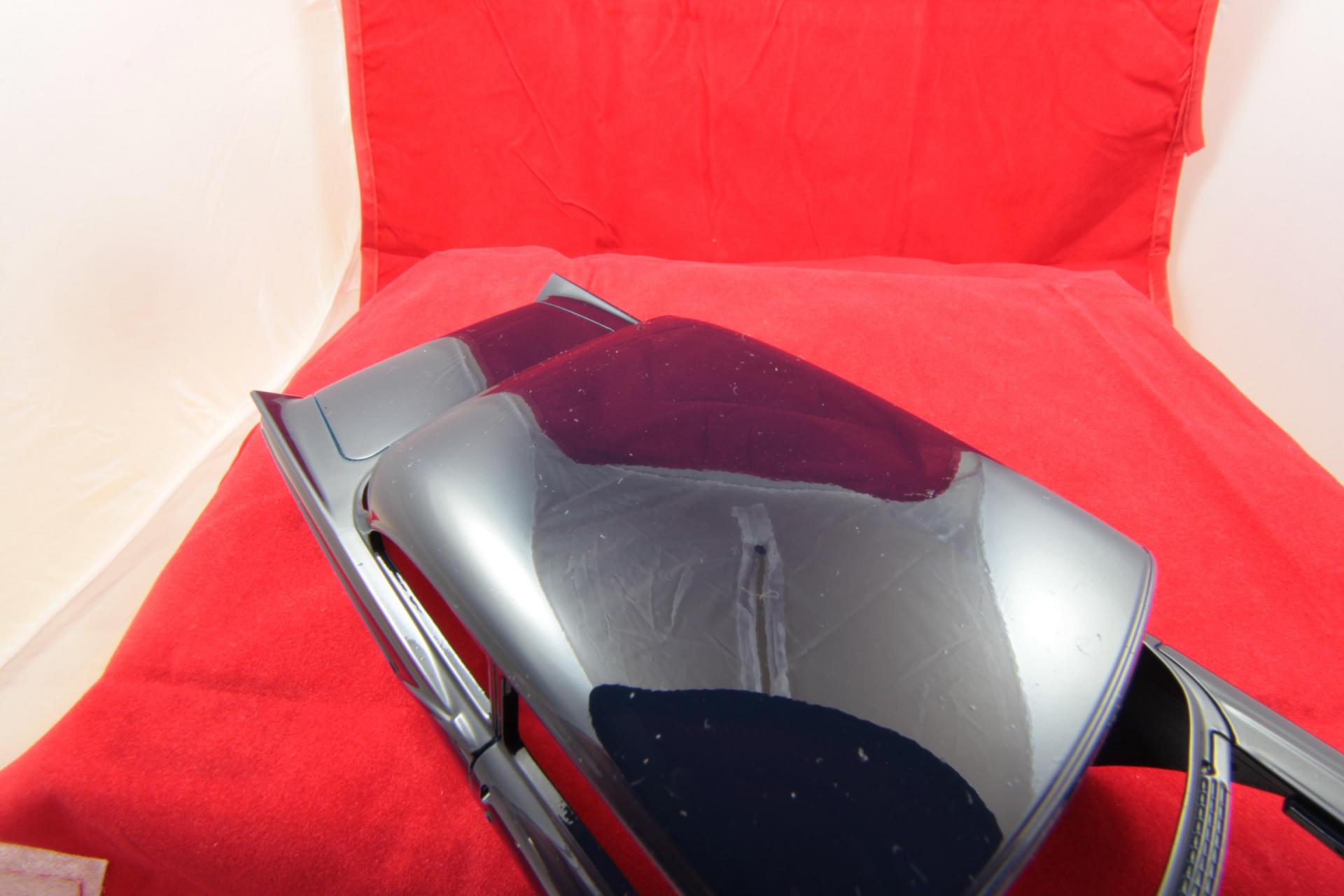

Quick GMC Posted August 26, 2019 Posted August 26, 2019 The enamel sprays better than any other paint I have used. It's been a while since I used it, but it laid down like glass. Unfortunately, I have only used it on one body and I had issues of dust and stuff getting into it, so it got stripped. I attached a couple pics of the 57 Ford I painted with Ford Washington Blue. This has not been clearcoated or touched in any way, this is just the dried enamel

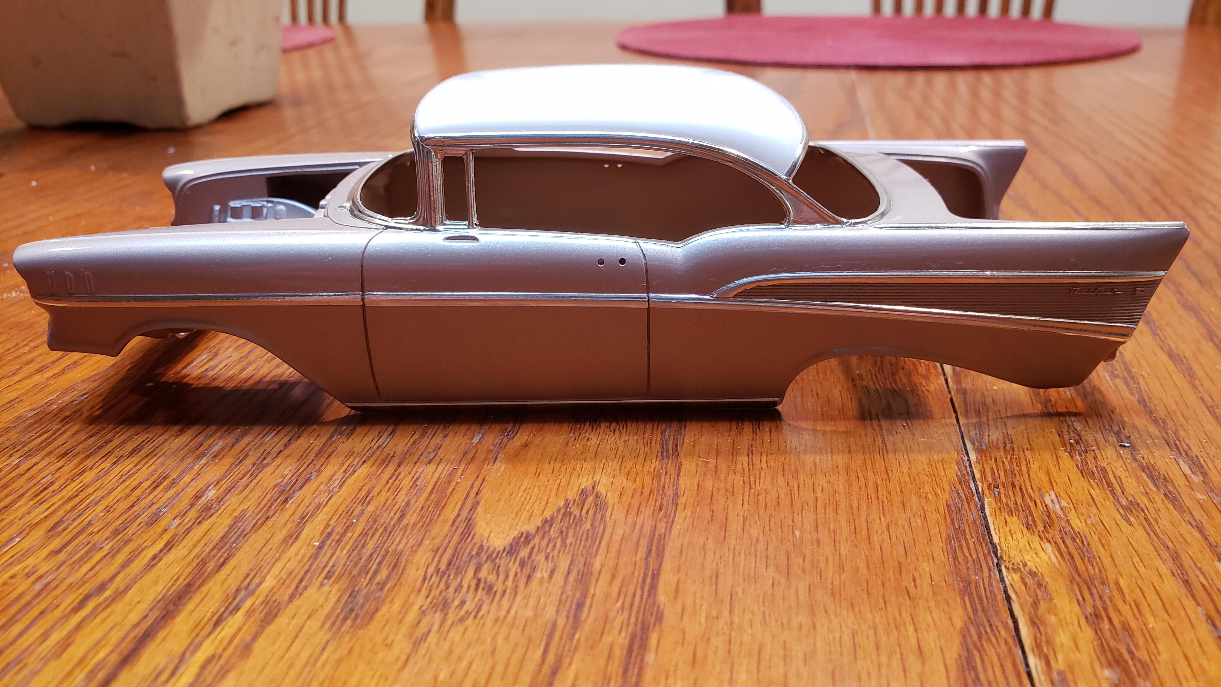

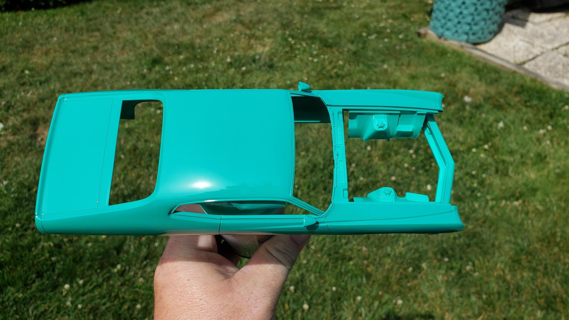

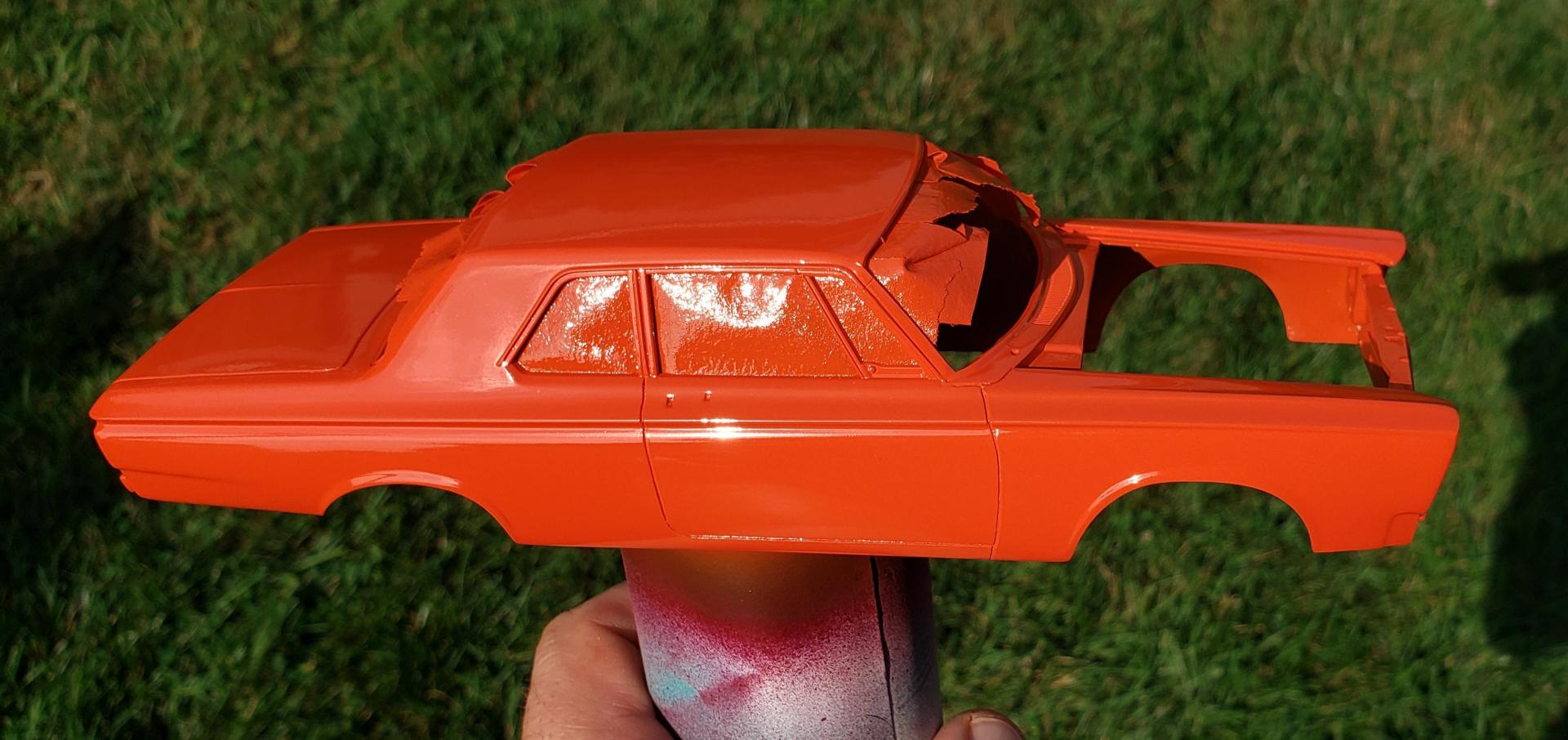

jjsipes Posted August 29, 2019 Posted August 29, 2019 I have used the enamels and like them. You can achieve a nice shine with no clear. Of course I haven't dug a fingernail into them to see if they totally hardened or not as I place them in a case when completed. Here are a few that I have airburshed.
jjsipes Posted August 29, 2019 Posted August 29, 2019 I will also say that I have found that the metallic enamels need clear on them which i have done with these. The one time I used the Lacquer I was not happy with results. Not sure if it was the weather or me.

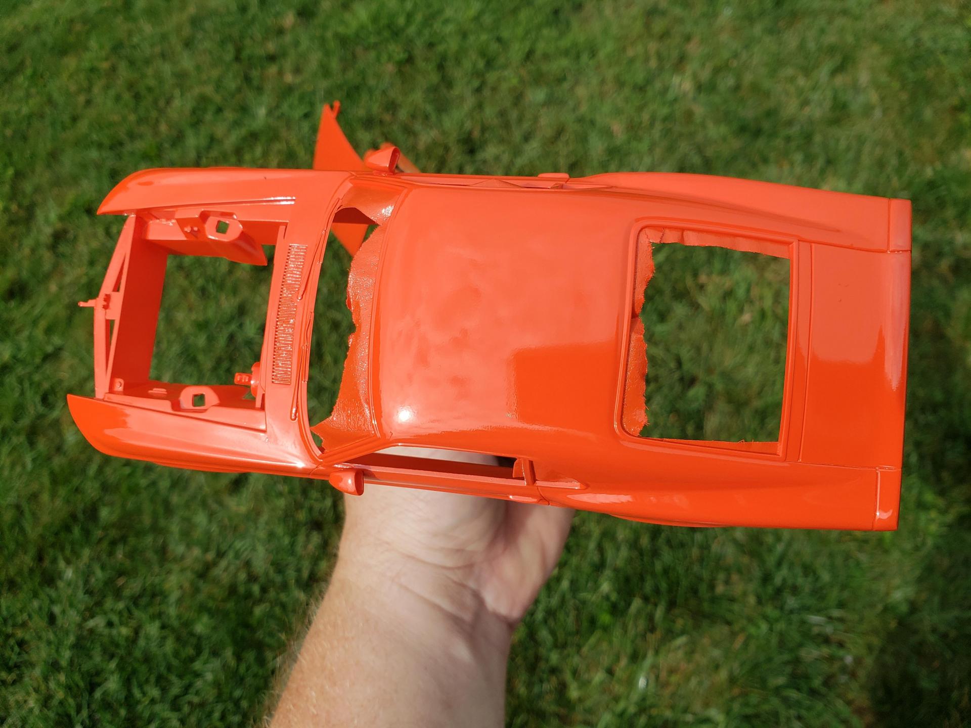

jjsipes Posted August 29, 2019 Posted August 29, 2019 (edited) 44 minutes ago, StevenGuthmiller said: Are you sure that you have this stated correctly? In the above post, you said that you used the Scale Finishes enamel on the '57 Chevy. Steve Yes. The 57 Chevy was the Scale Finishes Enamel but I used Tamiya Clear over it the first time and had issues. Then I stripped and airbrushed again but used Scale Finishes Clear the second time and it turned out great. I used their Lacquer on this 69 Camaro and have what looks like etch marks all over it. It didn't lay down like their enamels for me. Like I said not sure if it was me or the weather, could have been to humid. Edited August 29, 2019 by jjsipes
StevenGuthmiller Posted August 29, 2019 Posted August 29, 2019 2 hours ago, jjsipes said: Yes. The 57 Chevy was the Scale Finishes Enamel but I used Tamiya Clear over it the first time and had issues. Then I stripped and airbrushed again but used Scale Finishes Clear the second time and it turned out great. I used their Lacquer on this 69 Camaro and have what looks like etch marks all over it. It didn't lay down like their enamels for me. Like I said not sure if it was me or the weather, could have been to humid. Most likely not enough of a primer barrier, spraying the paint too heavy, or both. Just like all other lacquers, Scale Finishes lacquers are a hot paint and require a very good impervious base to guard against the lacquer reaching the plastic. By the way, what you show in this photo is really no issue at all. Give it couple of coats of clear, polish it out, and it will look top notch! Steve
