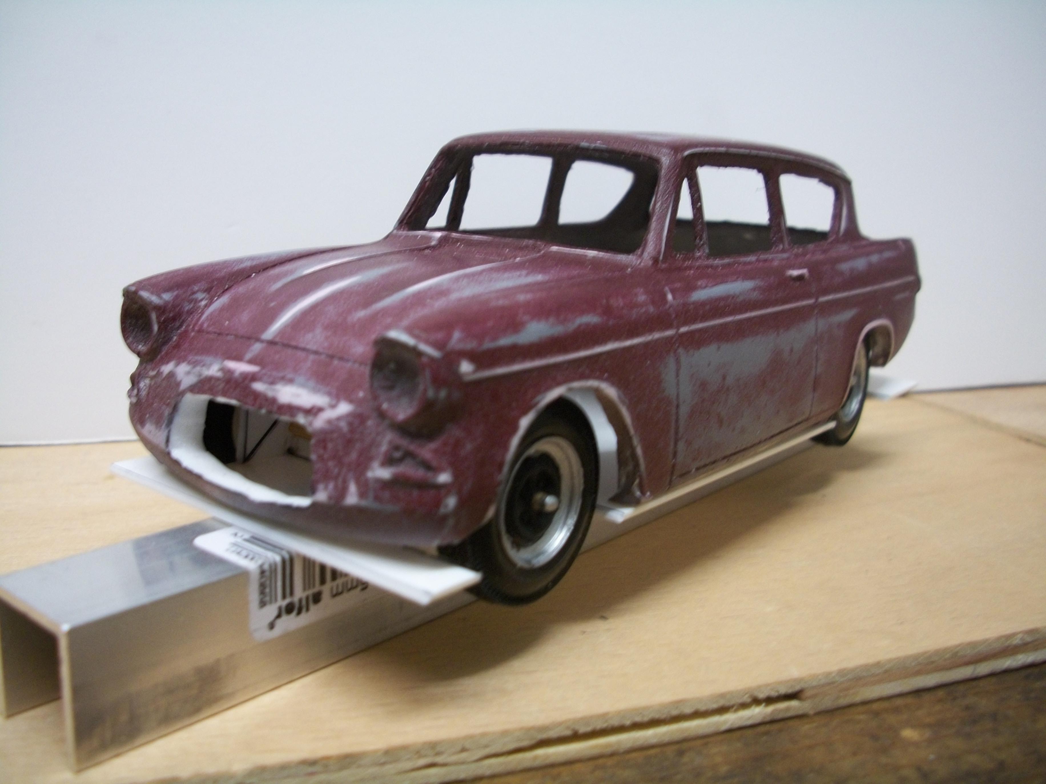

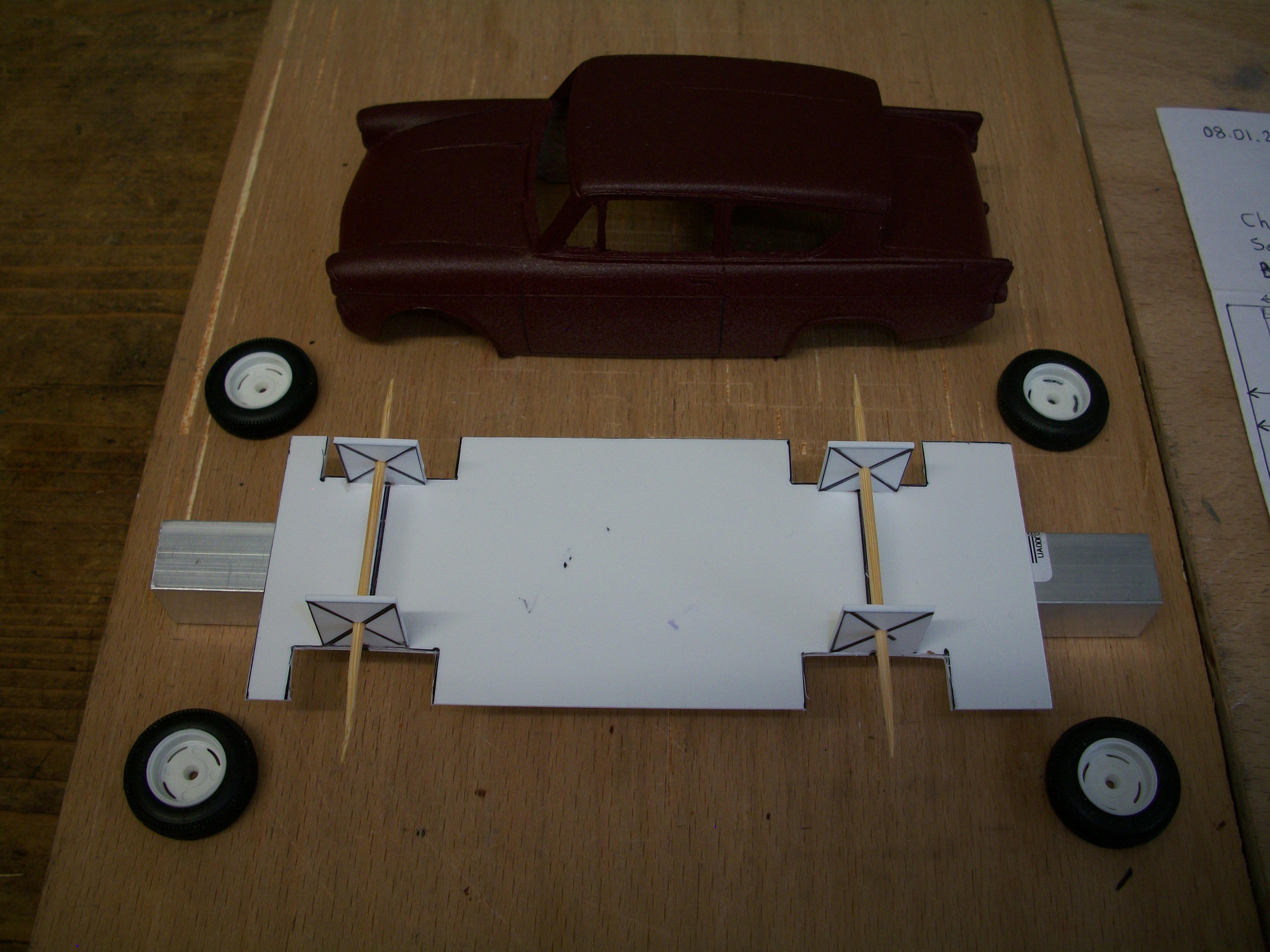

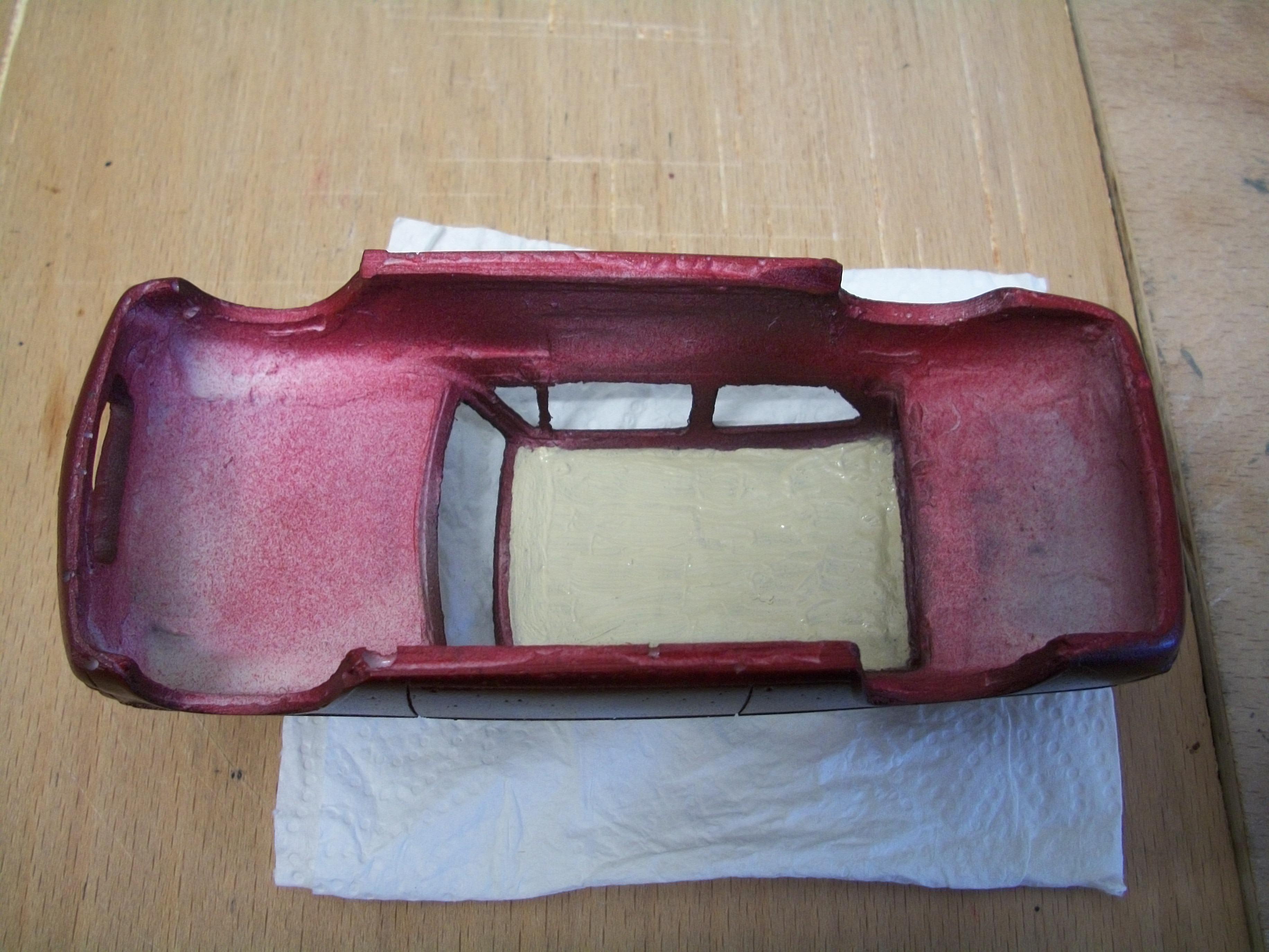

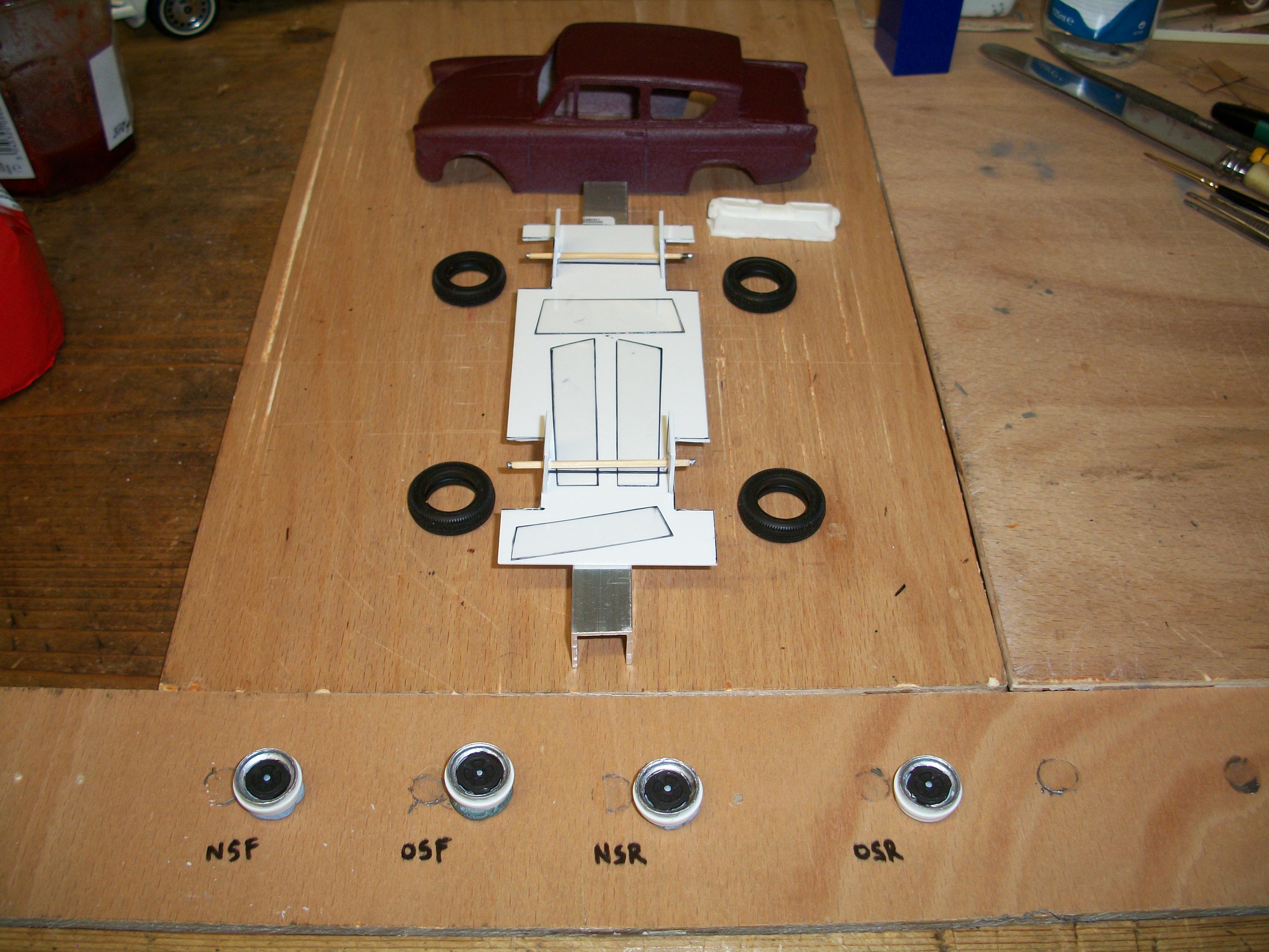

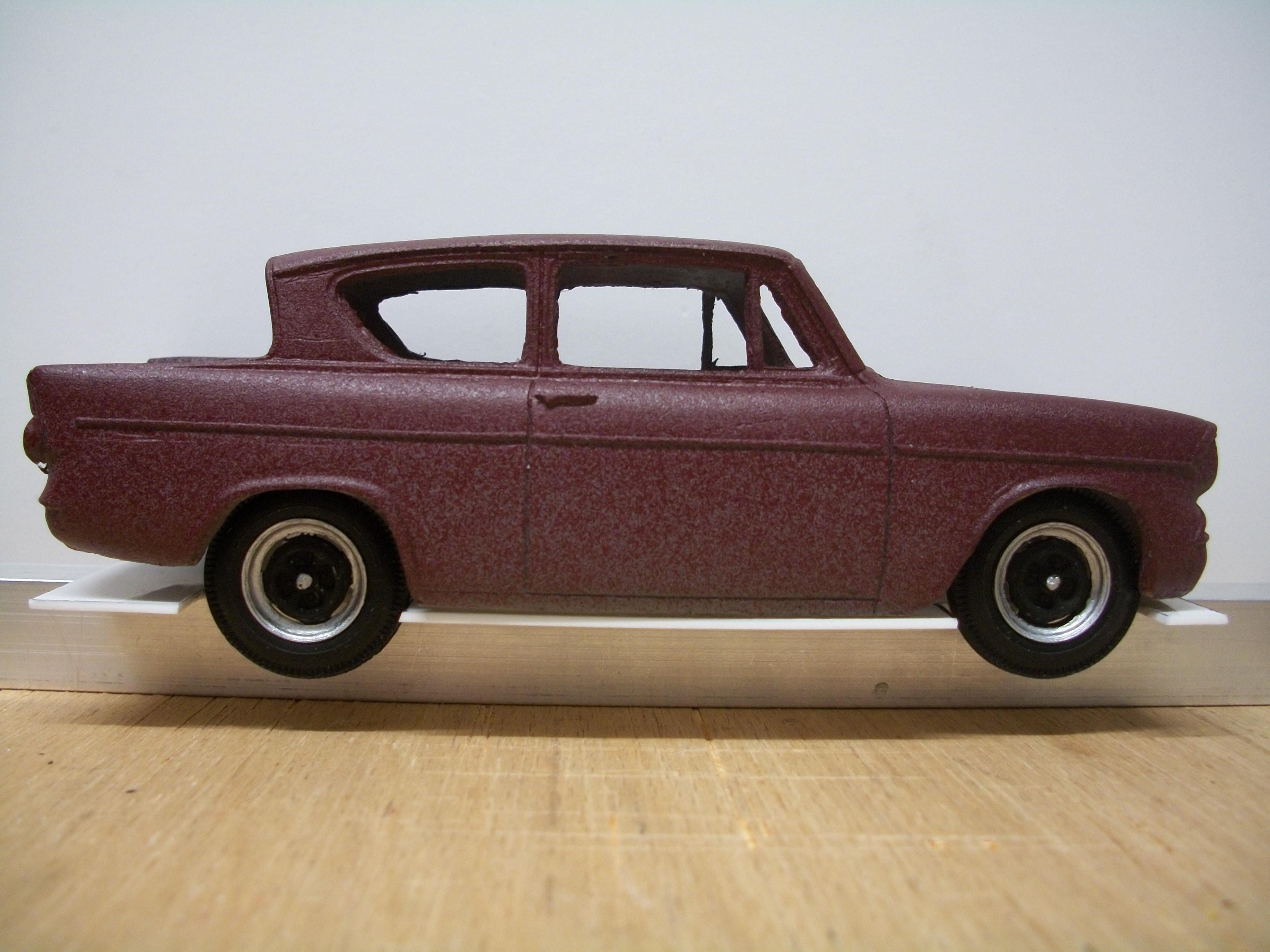

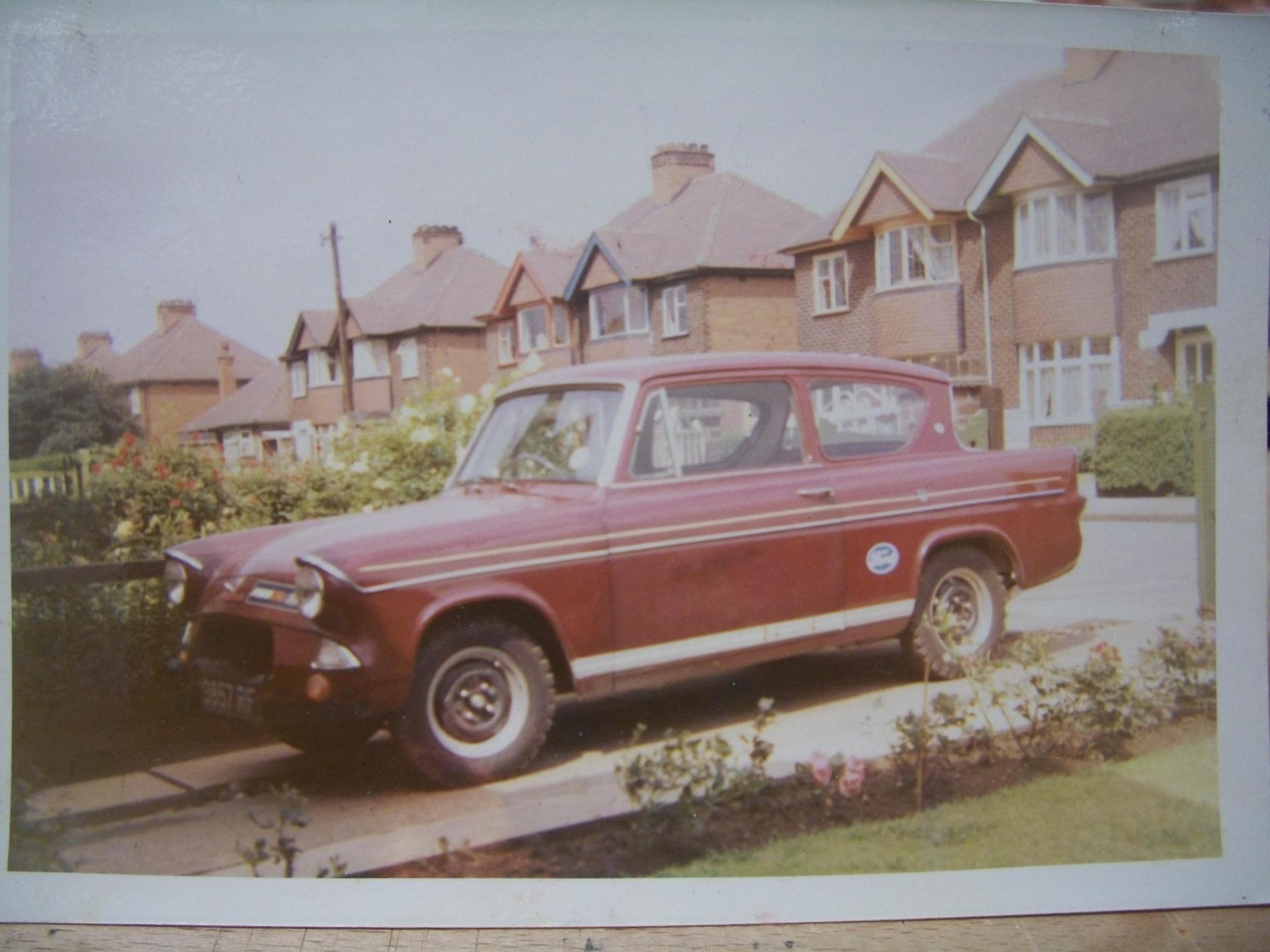

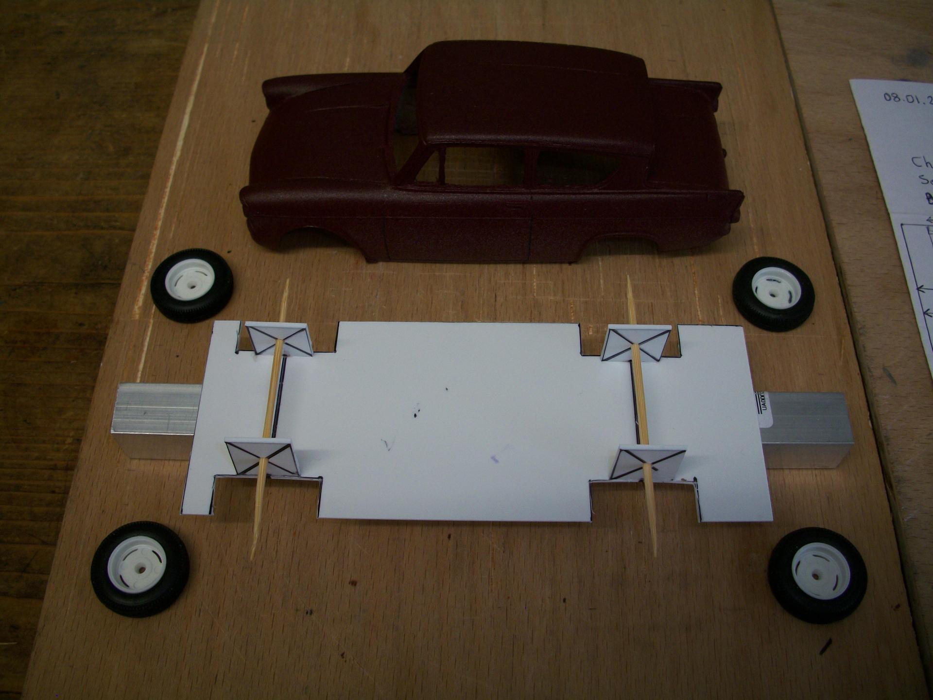

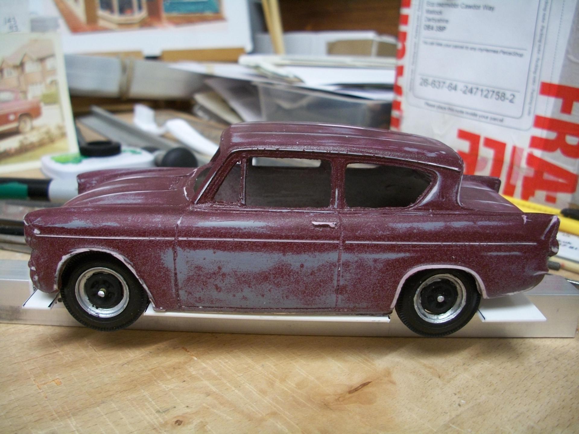

Anglia105E Posted August 23, 2019 Posted August 23, 2019 Here on my workbench at the moment is a scratch built, resin body Anglia 105E in 1:24 scale, which as you can see from the original photo of the real 1:1 car, this was the very first car that I ever owned..... way back in 1970..... This is a curbside model, so no engine, and the chassis is of very simple sheet styrene construction with fixed axles that are made from cocktail sticks. The resin body is accurate and quite good I would say, although there has been a lot of cutting away excess flash and further modification, such as removing the bumpers and radiator grille, which I did on the car I owned. The front air intake has been cut out using a drill, followed by grinding stones and needle file. Paint finish is Halfords Grey Primer from rattle can and cellulose Autopaints of Brighton - Ford Imperial Maroon, also from rattle can directly. The paint finish came out bad, so I have rubbed down the body shell with 600 grit wet & dry, ready for a second attempt on the Imperial Maroon. The wheels are from a Tamiya donor kit, which is the Lotus Super 7, and these look way better than the resin wheels supplied with the body kit. I have cut the window glass to size from clear acetate. The wheels are painted matt black or satin black centres with aluminium silver rims, and they will have chrome wheel nuts just like the real car. Thanks for looking, guys and any comments are welcome. This resin body kit was purchased one year and five months ago now, so it has taken a while to get to the work bench, due to bigger and more important Rolls-Royce projects ! David 1

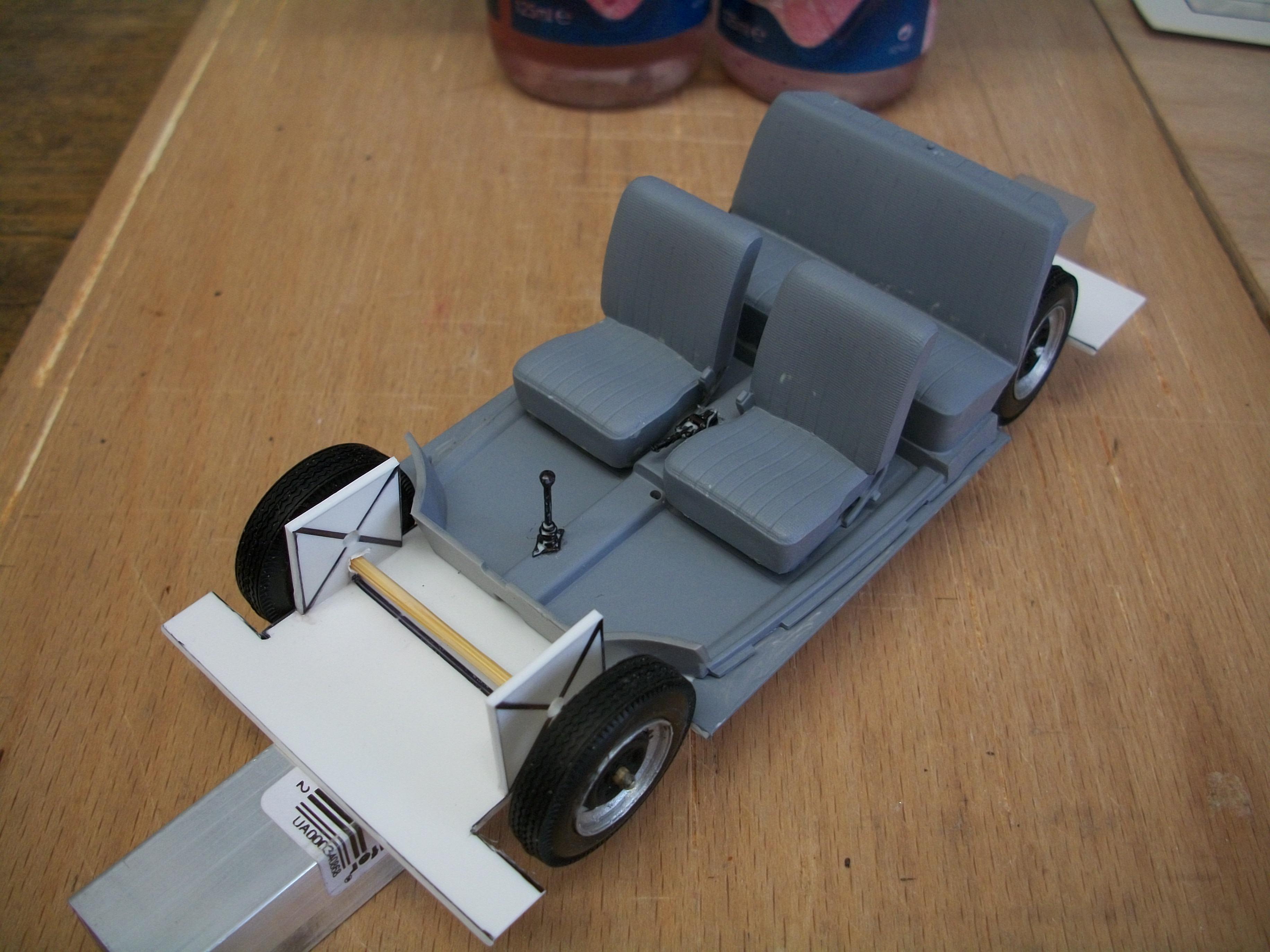

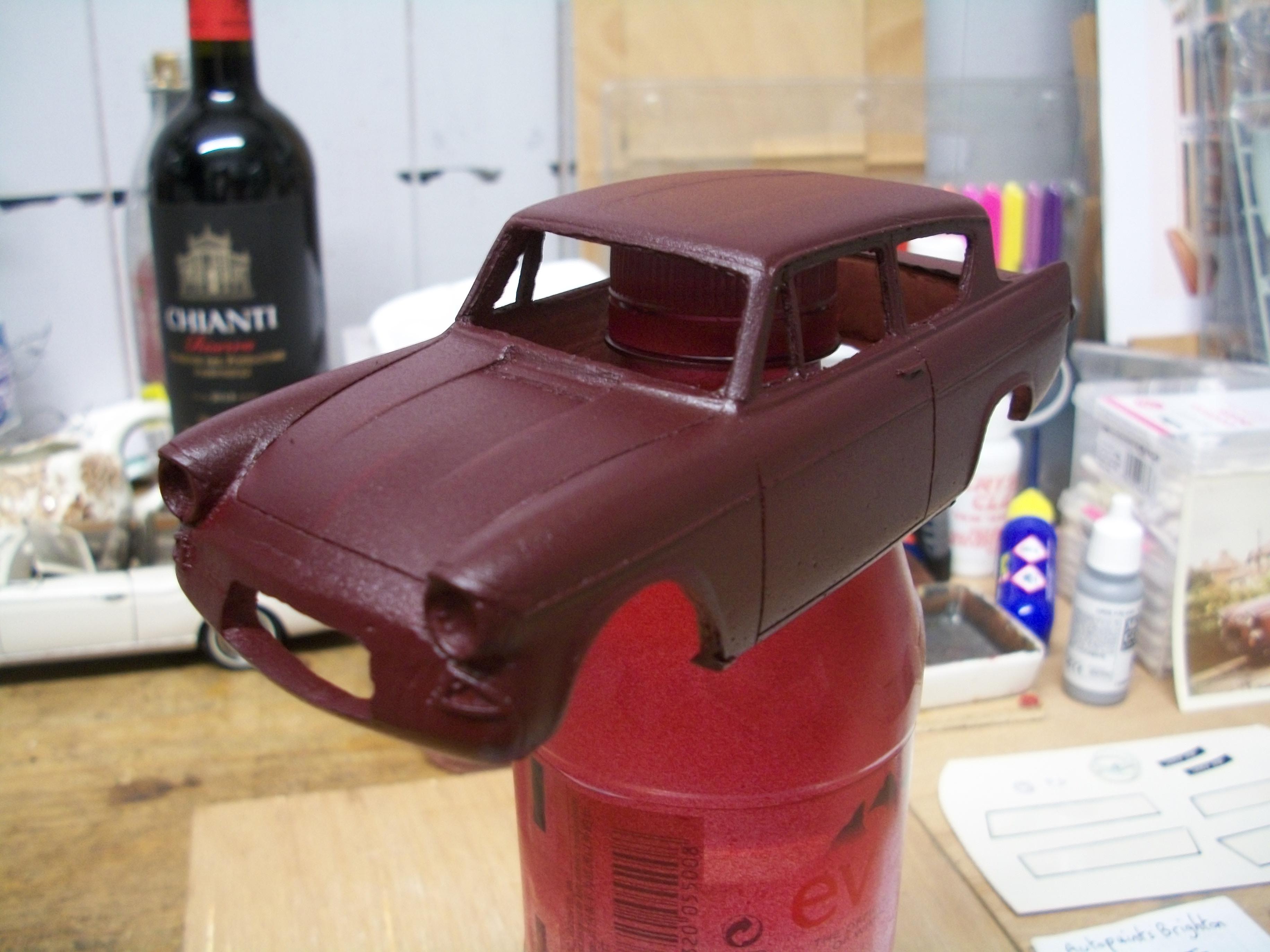

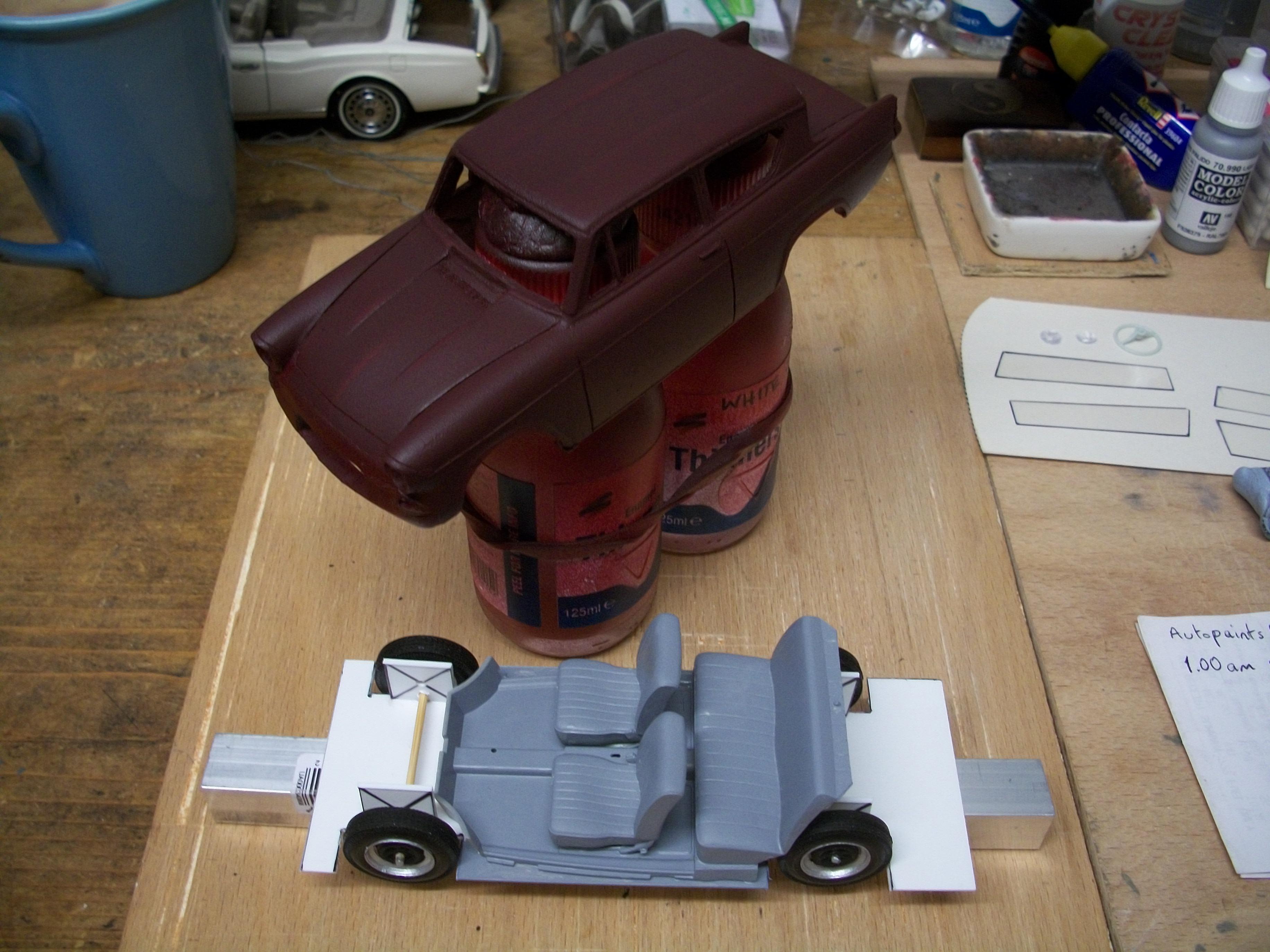

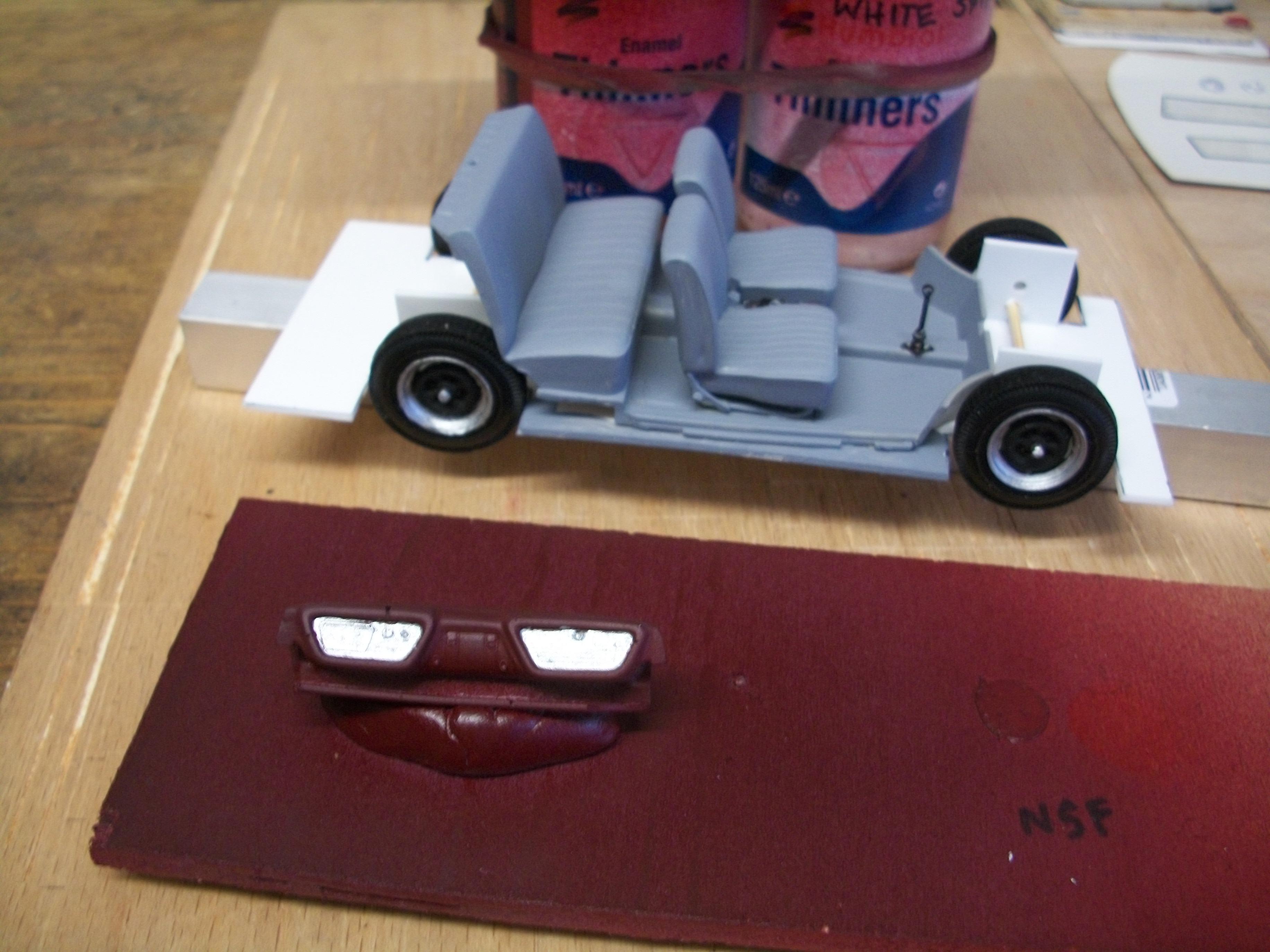

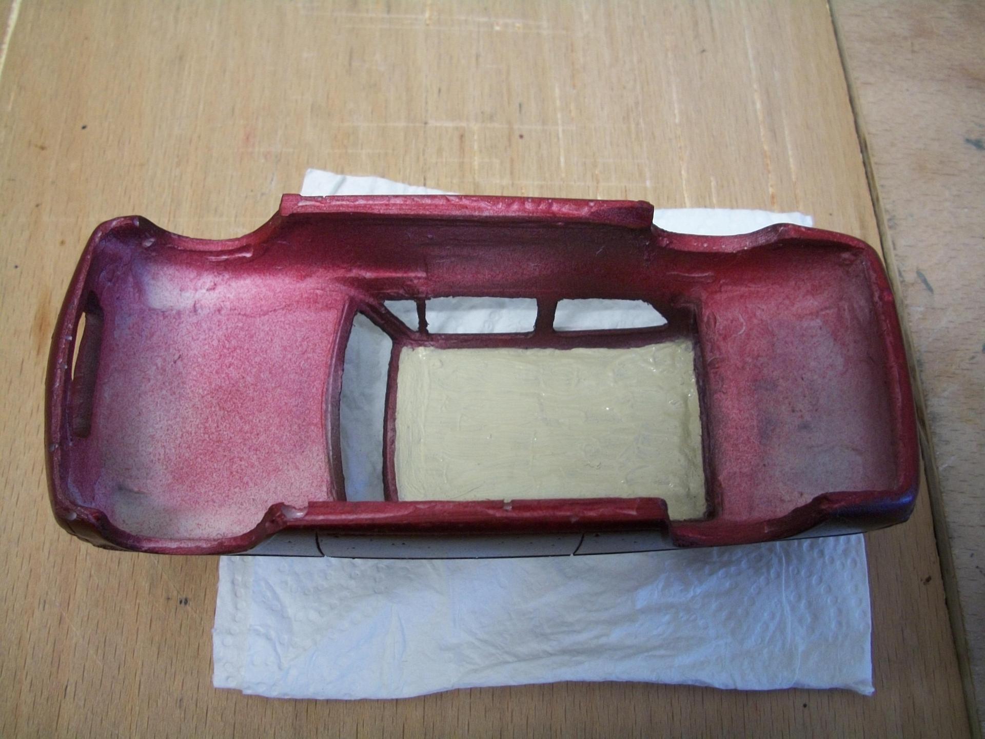

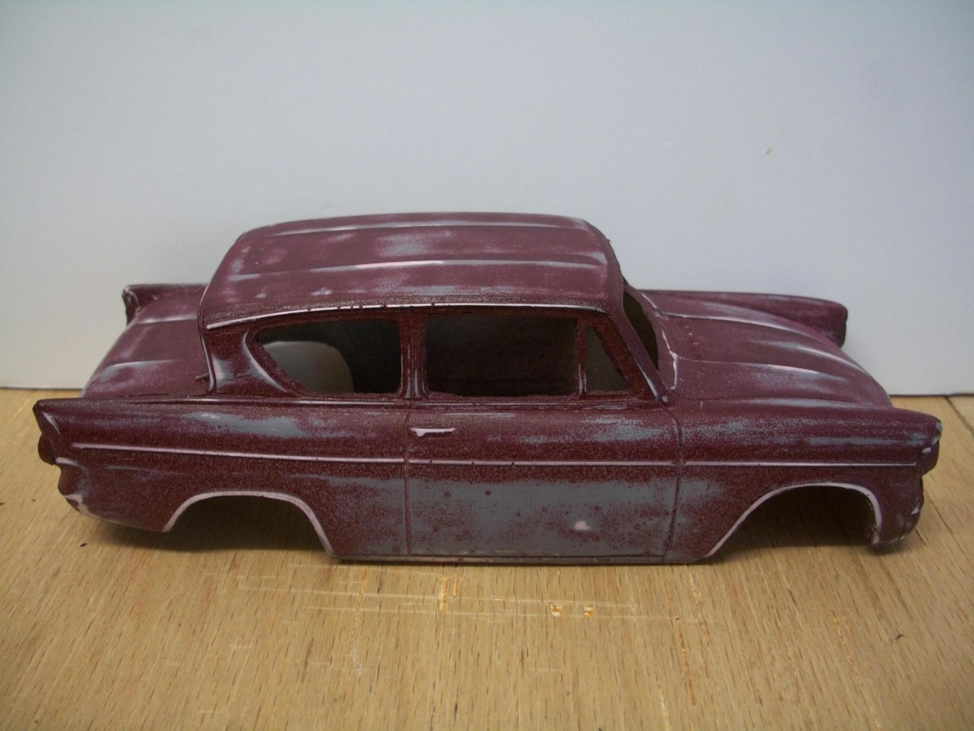

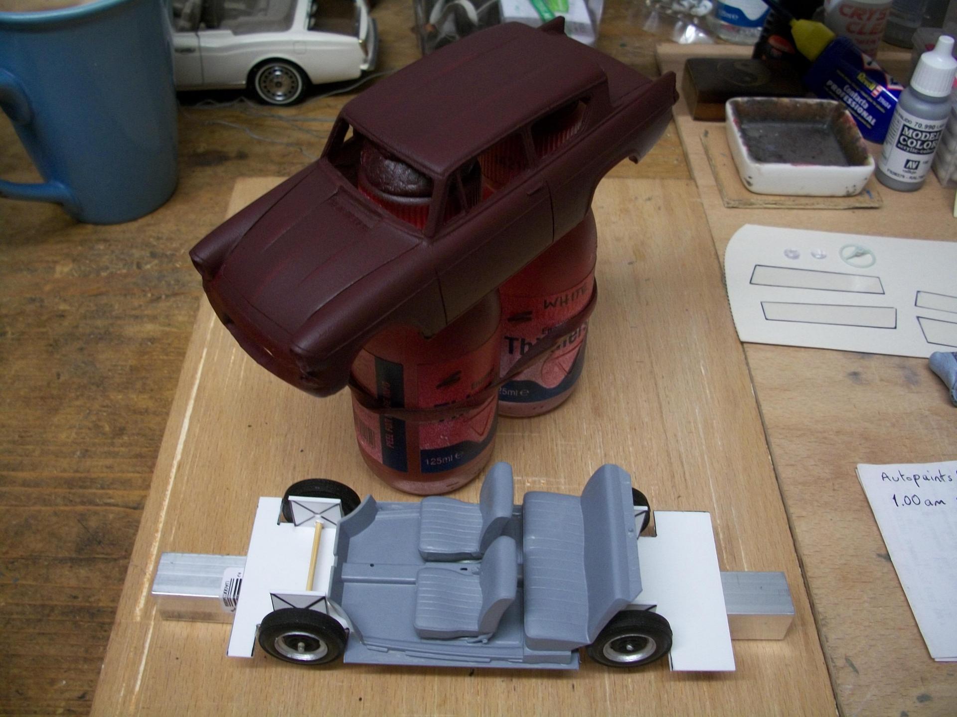

Anglia105E Posted August 24, 2019 Author Posted August 24, 2019 I was not happy with the paint finish after what I thought was the final coat, so I have now applied what will be the final coat of Ford Imperial Maroon. The seats and interior floor pan are from a Revell 1968 Volkswagen Beetle and these seem to fit the Anglia, both cars being of the same size and both from the '60's. There was some cutting to do, in order to make the floor pan fit. While starting to detail the dashboard / instrument panel, I noticed this is actually a LHD dashboard, which is very surprising because the resin caster supplied this body kit from Halifax in Yorkshire, U.K. Changing it from LHD to RHD will be quite easy, and I usually have to do this for Minicraft Rolls-Royce Silver Clouds, which are also LHD setup. Once the body shell is ready, I can apply yacht varnish to the areas that will be chromed, and then apply Molotow Liquid Chrome Pen over the yacht varnish, which is a high gloss surface. David

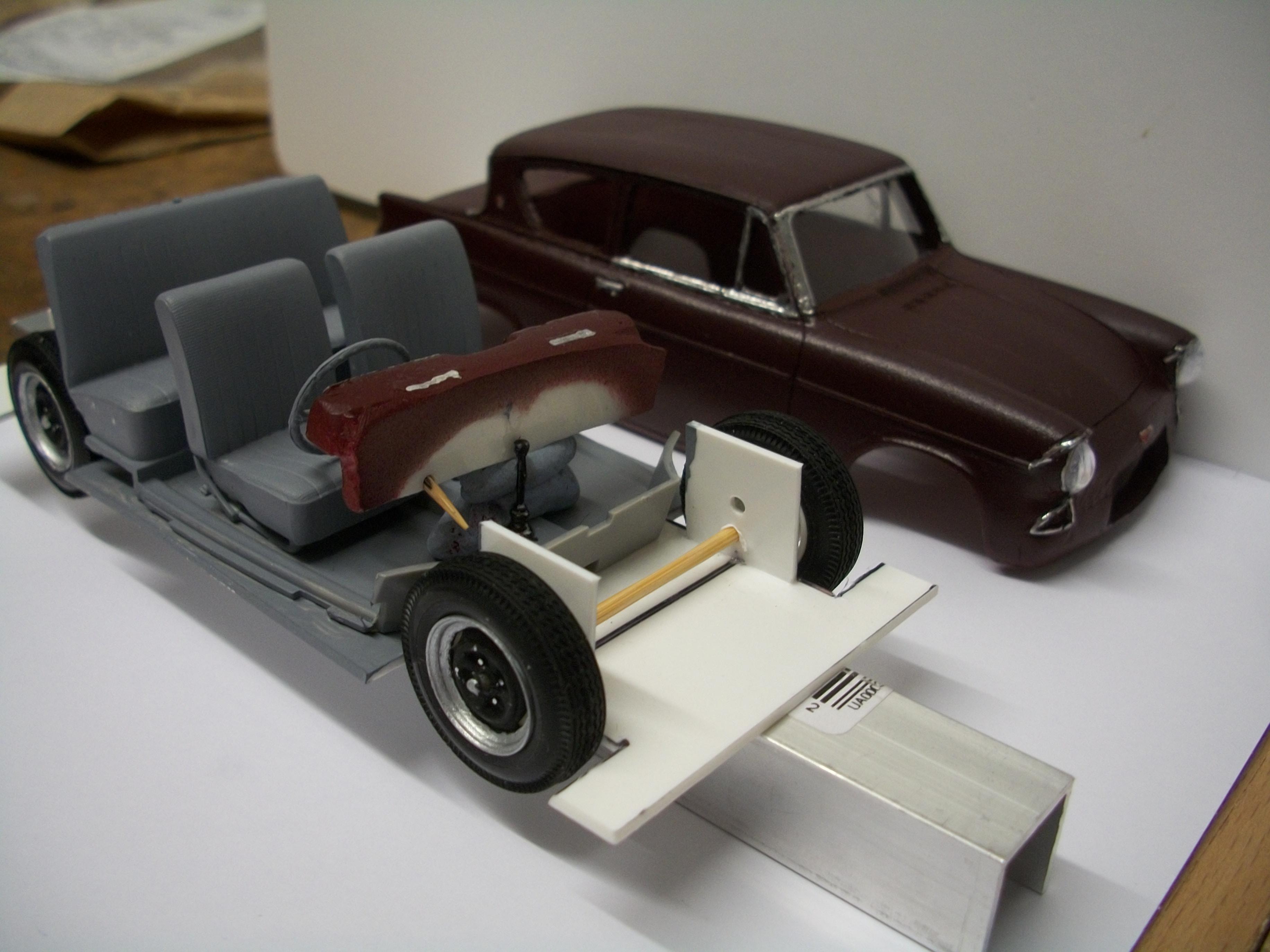

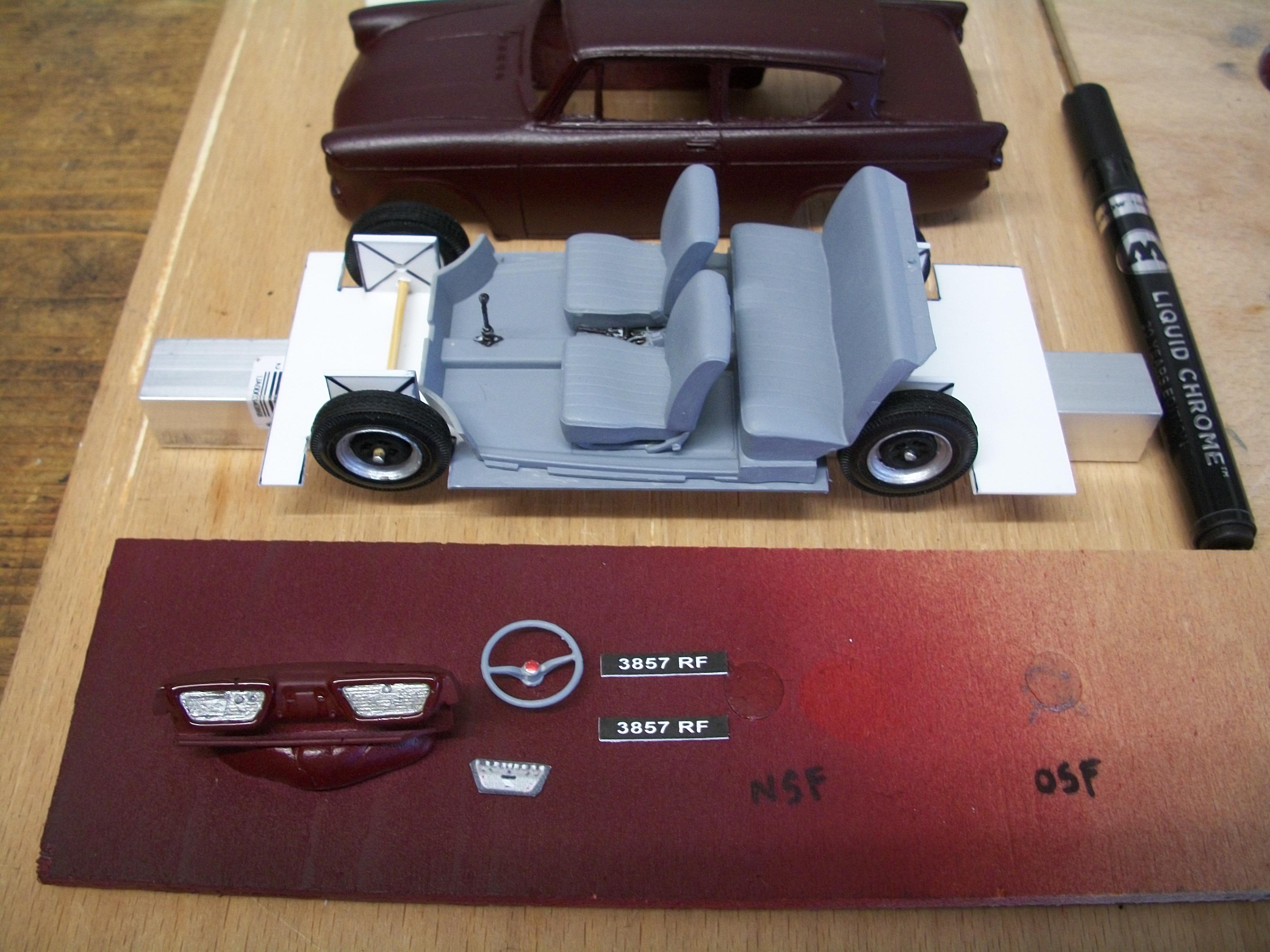

Anglia105E Posted August 26, 2019 Author Posted August 26, 2019 The Ford Anglia build is entering what I would call, the final phase....... so this includes liquid chrome pen work later today, also aligning the body with the chassis, dashboard fitting and steering wheel, registration number plates, window glass all round, chassis trimming at the edges and Meguiars Carnauba wax polishing. Usually, I leave the polishing until four or five days have passed since the final coat of paint. There will be some further cutting of the rear seats at the top corners, to allow the body to fit correctly. Then there are the headlamps, tail lights and front side/indicator lamps to detail. I shall give the front air intake a coat of matt black paint, and fit a black panel behind this , to simulate where the cooling radiator would be located. Might need an exhaust tailpipe at the rear end, and maybe the bottom half of the petrol / gas tank also. David

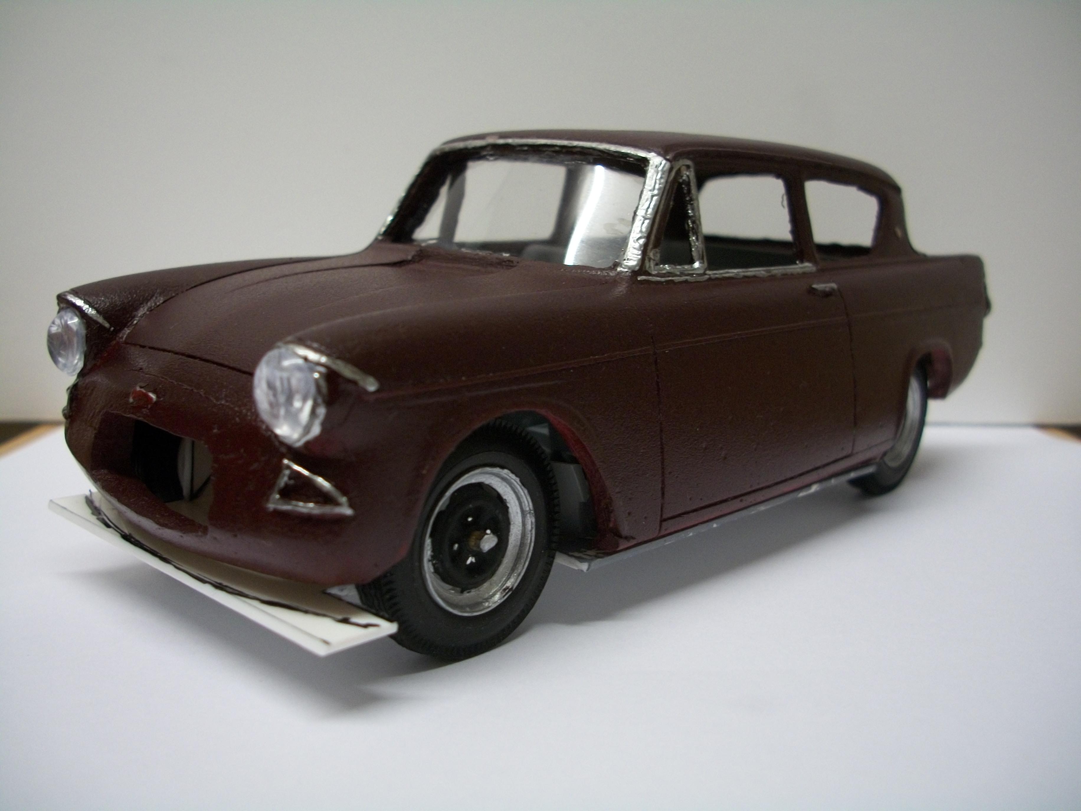

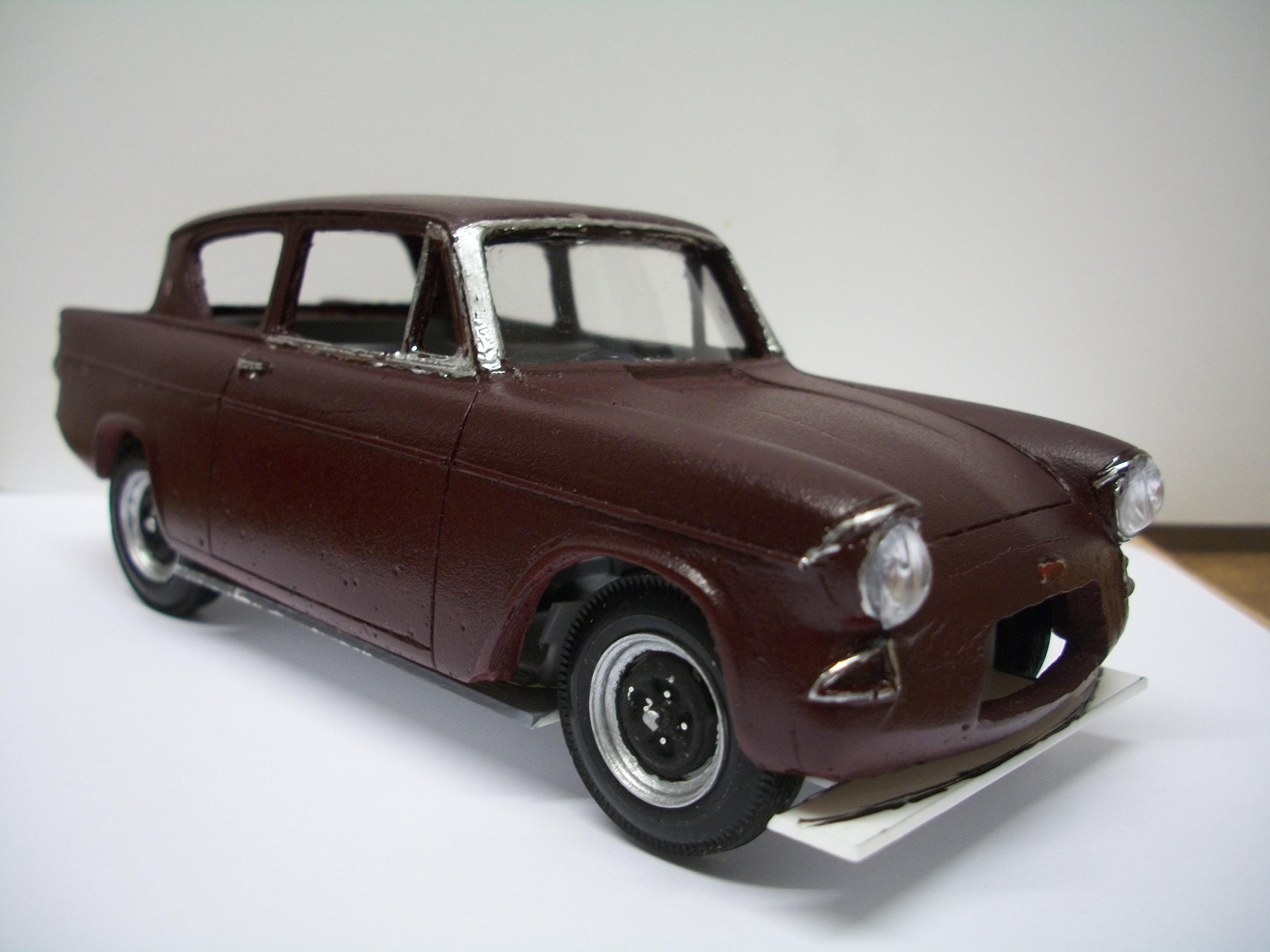

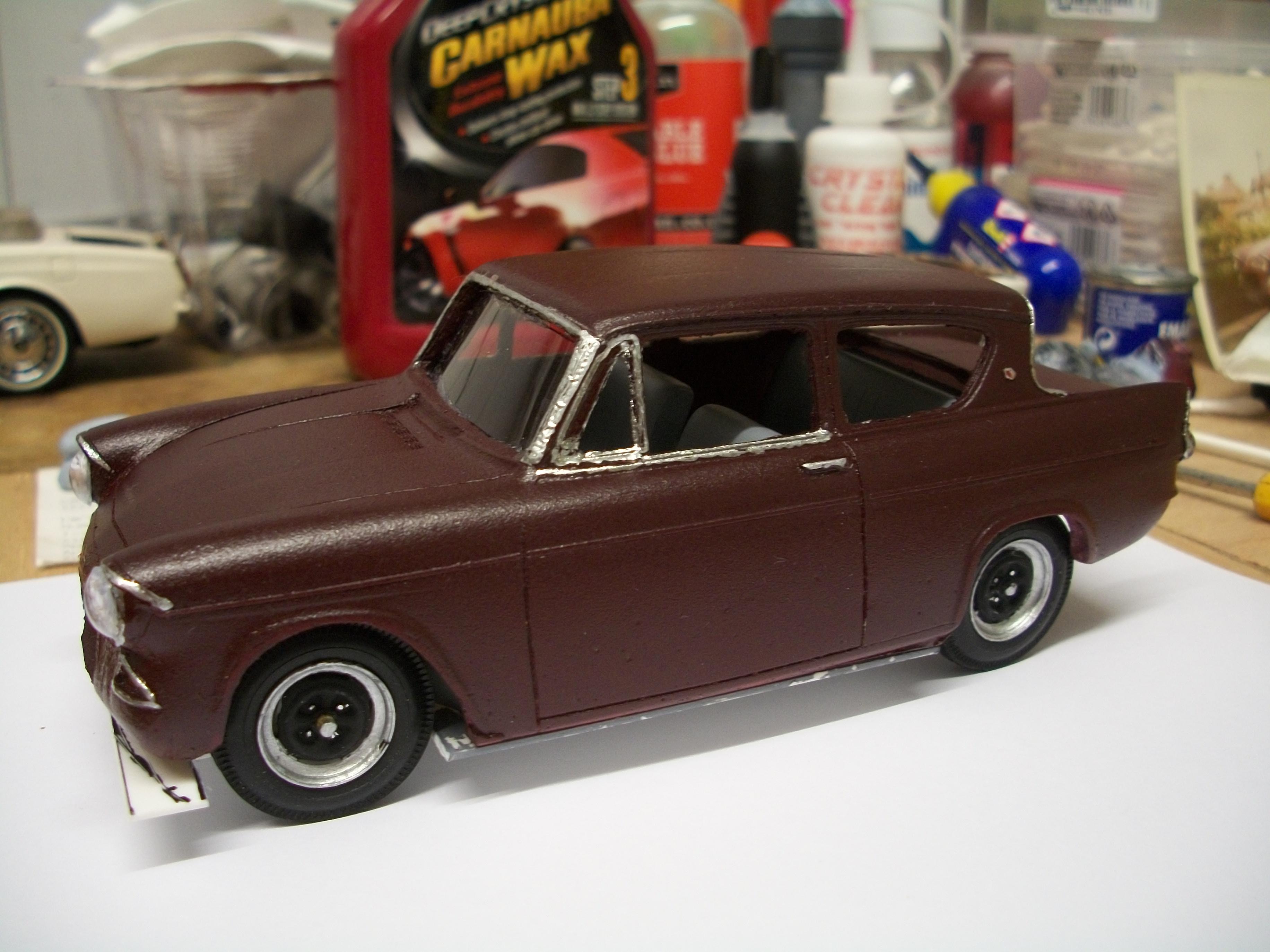

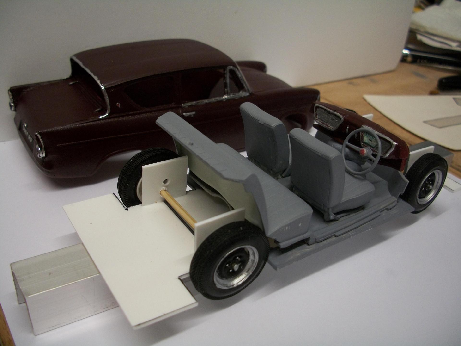

Anglia105E Posted August 28, 2019 Author Posted August 28, 2019 Windscreen is fitted, and also the headlamps. The dashboard is test fitted onto some Blu-Tak, with both speedometer and steering wheel in place. Some liquid chrome pen work done but needs tidying. Currently thinking about the order in which the remaining tasks need to be completed..... particularly the window glass, body alignment and polishing. David

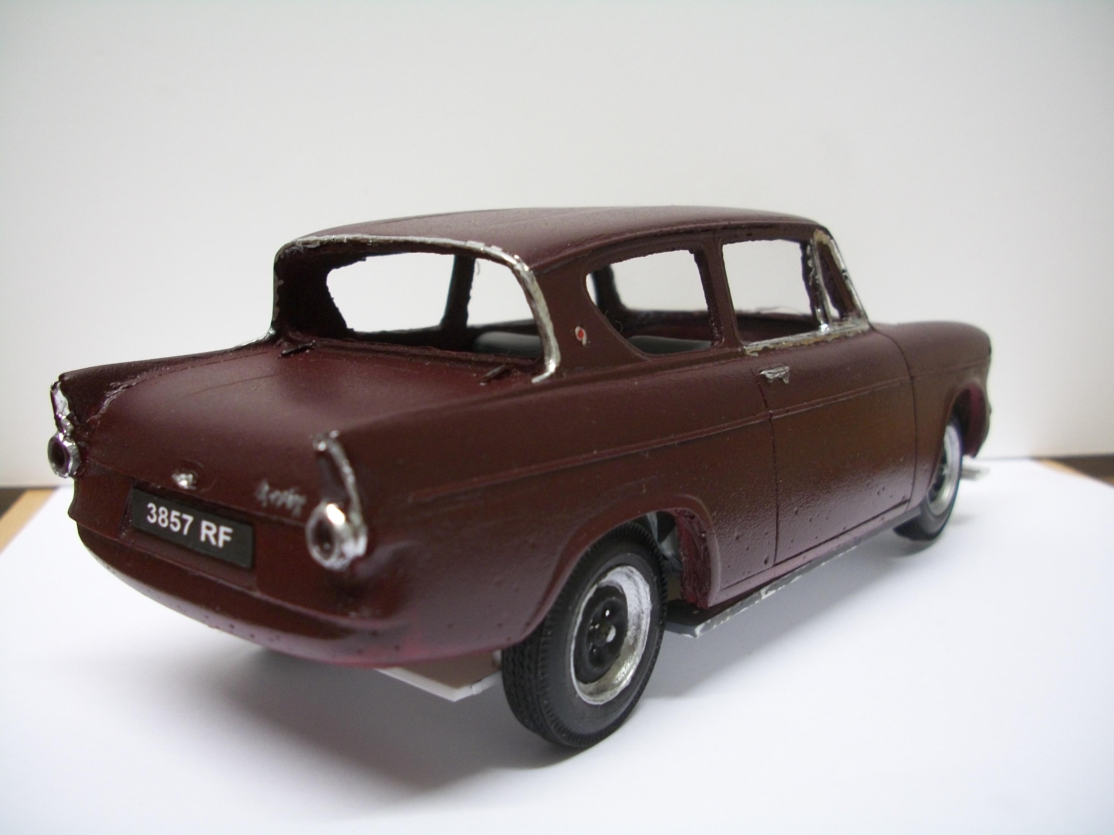

Anglia105E Posted August 29, 2019 Author Posted August 29, 2019 Managed to get the body aligned with the chassis, and as expected this was a tricky procedure. Removed the rear section of the chassis, and the front end of the chassis will be cut to follow the curve of the lower edge of the body shell. Dashboard assembly still needs to be fitted. This Ford Anglia 105E is almost entirely scratch built, with only the body being resin cast. David
Anglia105E Posted August 30, 2019 Author Posted August 30, 2019 Thanks, Dann........ hoping to complete the build this weekend, but the quality of this model is not good enough to go into the ' Under Glass ' section, because I believe this is not my best work. There are many issues that I can see with my critical eye, and there are all sorts of areas where I could have done much better. This one is a sort of in between build while two other projects are evolving. The paint job on this car is certainly not good enough and I know this is no Rolls-Royce, but even so it is not up to my standard, as I see it. Having said all that, this is an entirely scratch built resin body kit and next to the Rolls-Royce Silver Cloud the Ford Anglia 105E is my all time favourite car. ( if it's good enough for Harry Potter...... it's good enough for me ! ) David

Eric Macleod Posted August 31, 2019 Posted August 31, 2019 I see no reason to apologize for this model, particularly one with so much scratch building involved. I would be very happy with this one on my shelf!

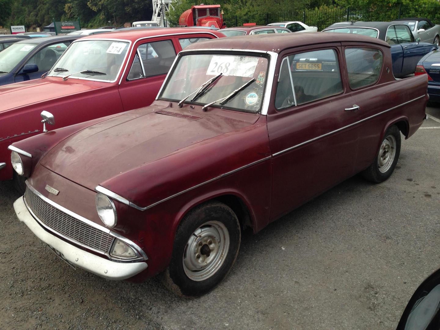

geetee66 Posted August 31, 2019 Posted August 31, 2019 Excellent work David! I'm especially pleased to see this build, as my first car was a 105E and the same colour as yours. I recently saw a battered barn find at Brooklands, awaiting auction...

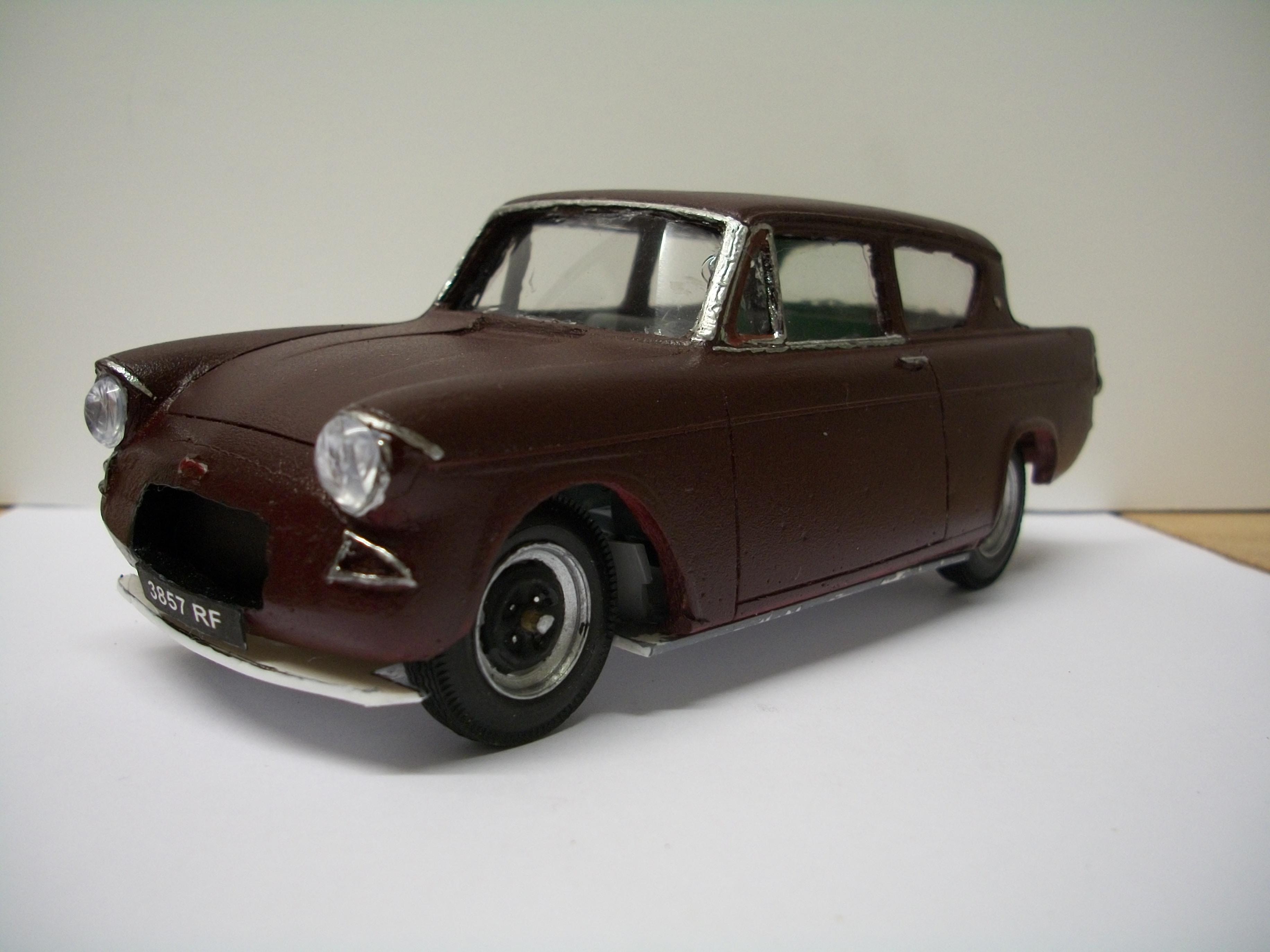

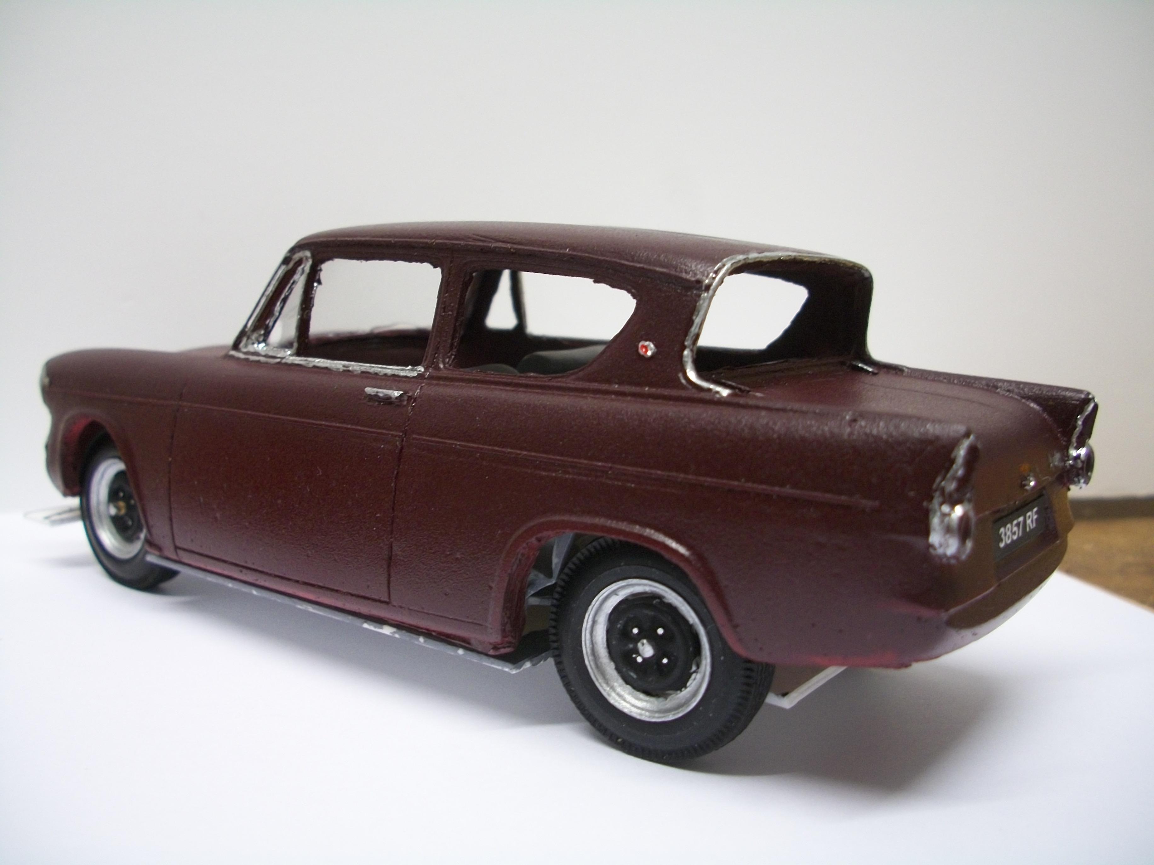

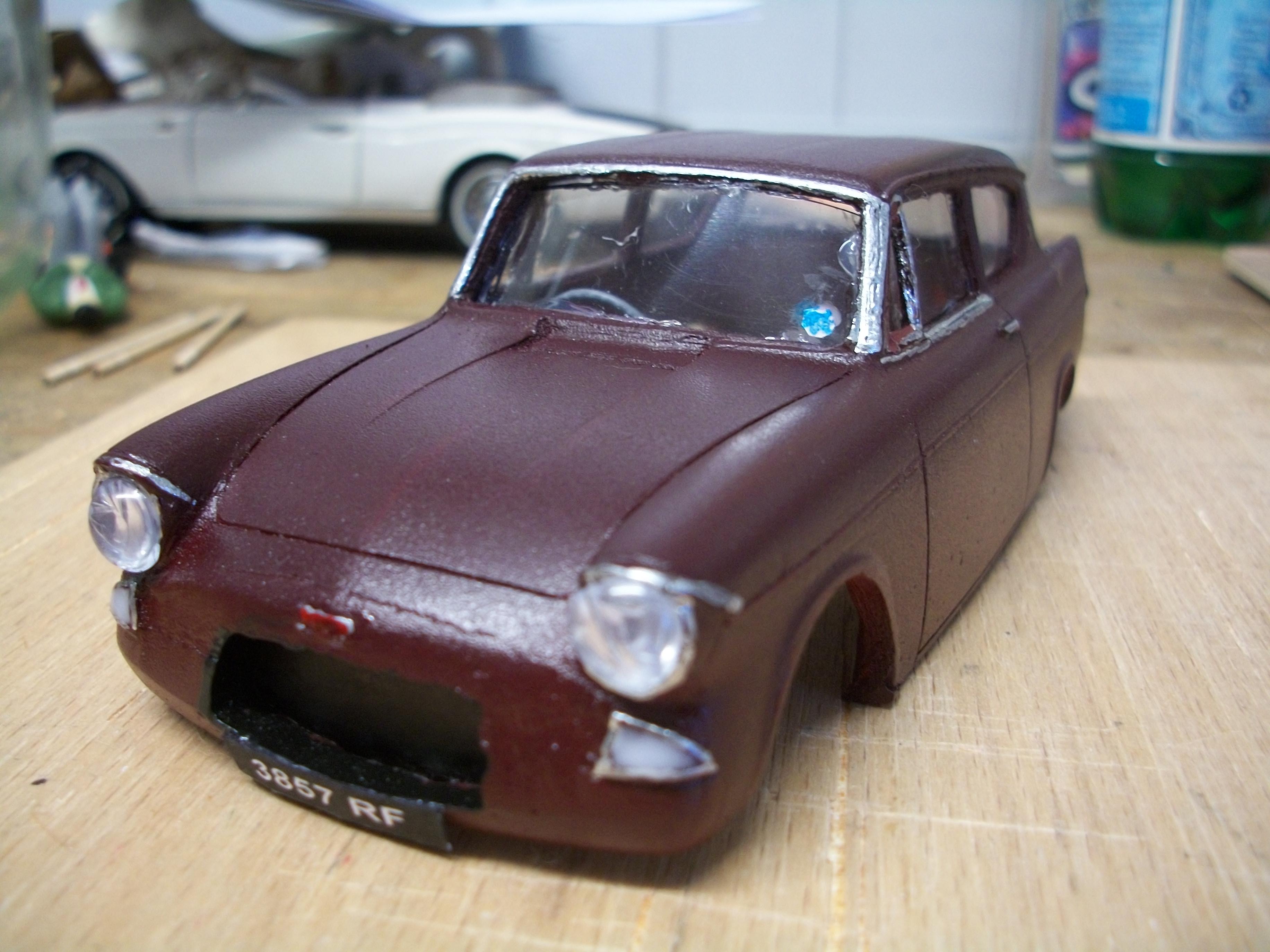

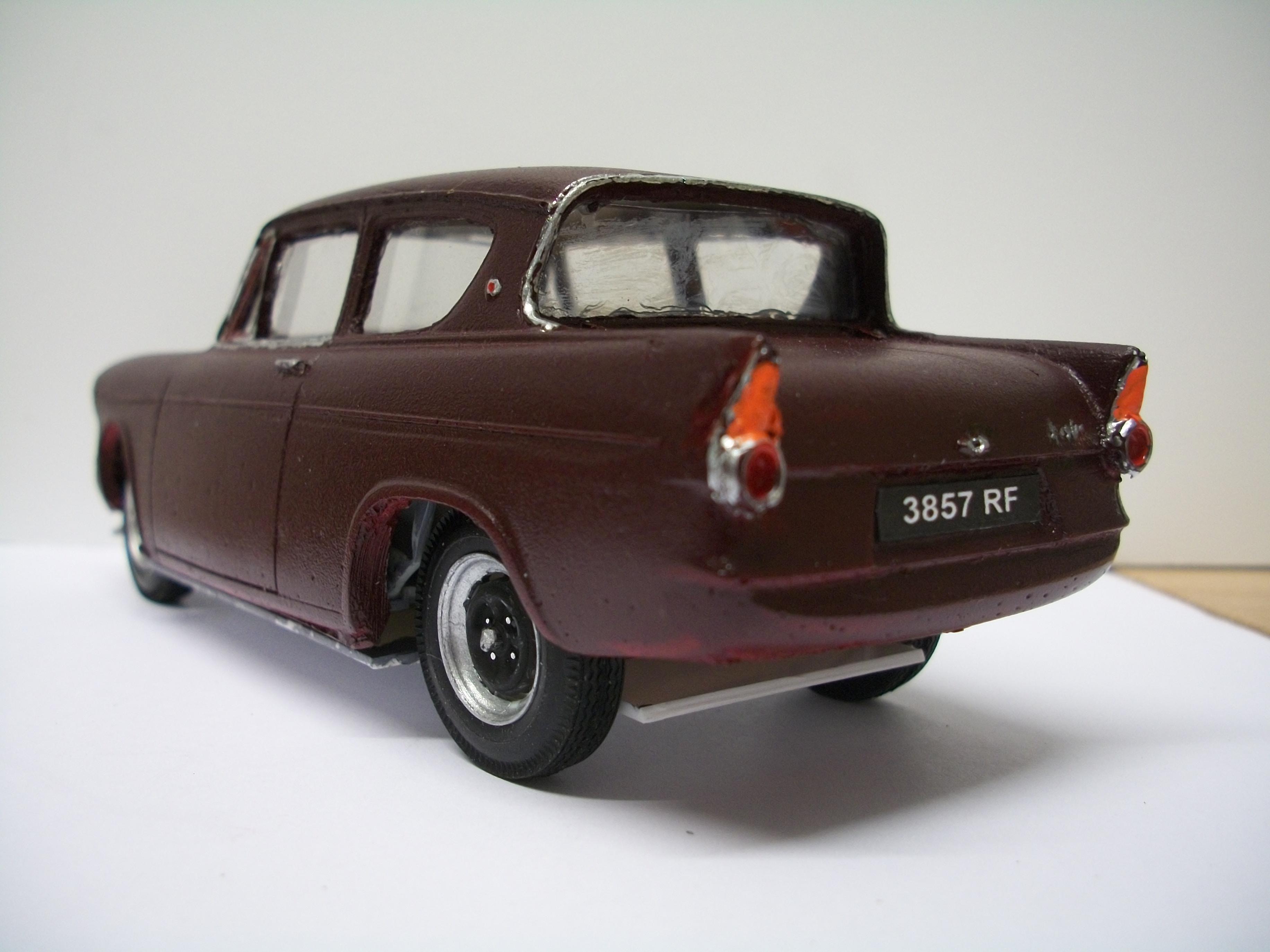

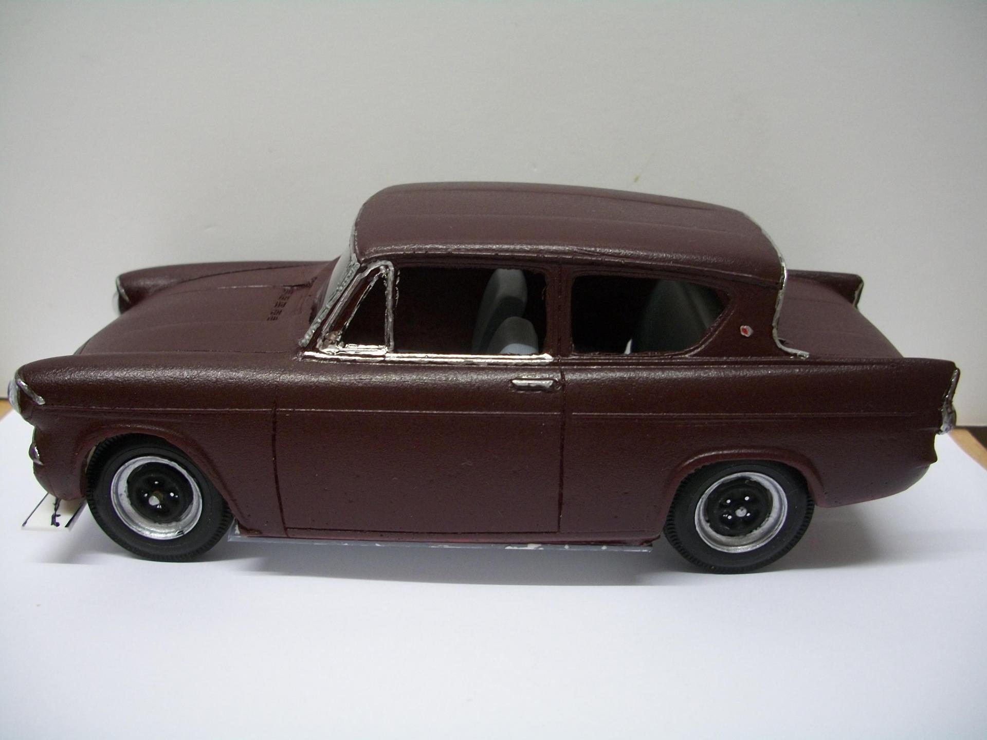

Anglia105E Posted September 1, 2019 Author Posted September 1, 2019 Thanks, Guy...... and what a surprising coincidence...... not only was your first car an Anglia 105E but it was also Imperial Maroon ! The car in your photo looks in reasonable shape, and apart from the paintwork on the nearside front wing the body is pretty good. It has an original tax disc also, I notice. Here are a couple more photos of the build, which is nearing completion. The dashboard is ready to be fitted, complete with steering wheel and speedometer. The front air intake which would normally be hidden by the chrome grille, is now painted satin black and the front registration plate is in place. Behind the air intake there is now a black backing panel that represents where the cooling radiator would have been. Windscreen glass, side windows and rear window are all fitted. David 1

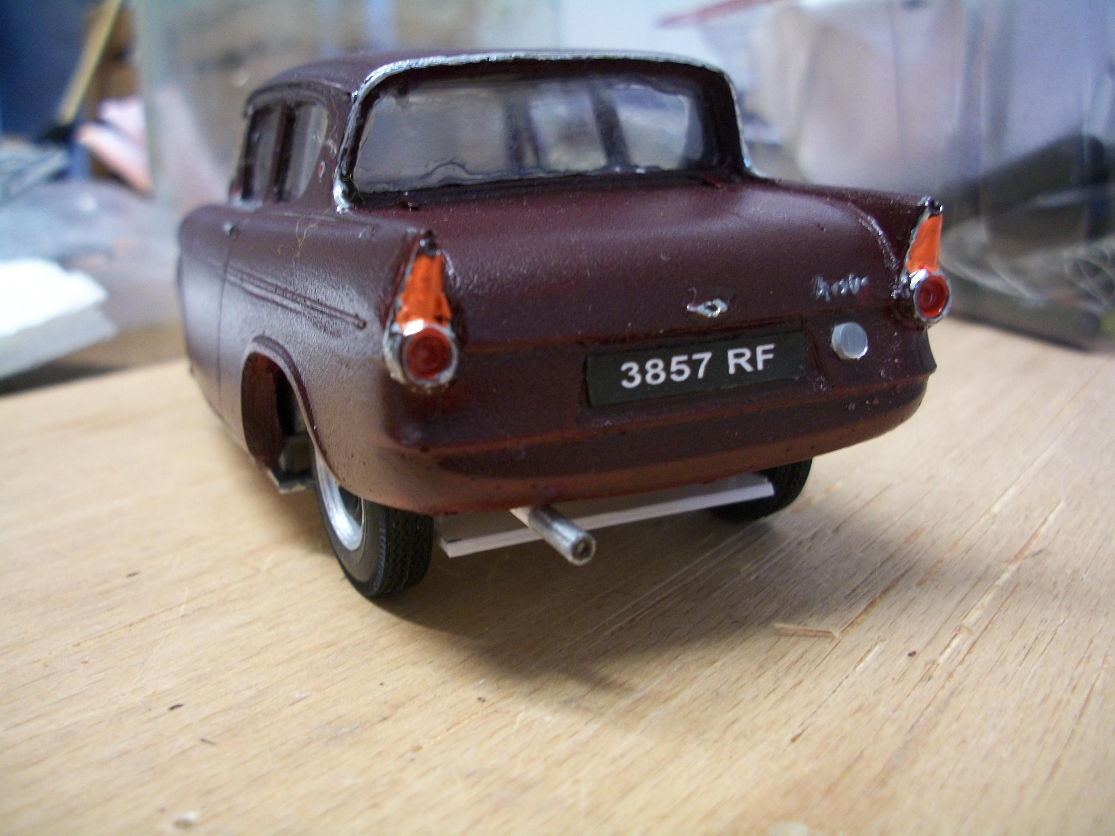

Anglia105E Posted September 2, 2019 Author Posted September 2, 2019 Further work this weekend on the Anglia 105E, which saw the dashboard fitted, also the exhaust tailpipe and fuel filler cap, as well as some work on the front sidelights and road tax disc. The back end of the car seems to be too high off the ground, and both the front and rear track of the wheels might not be quite wide enough. David
