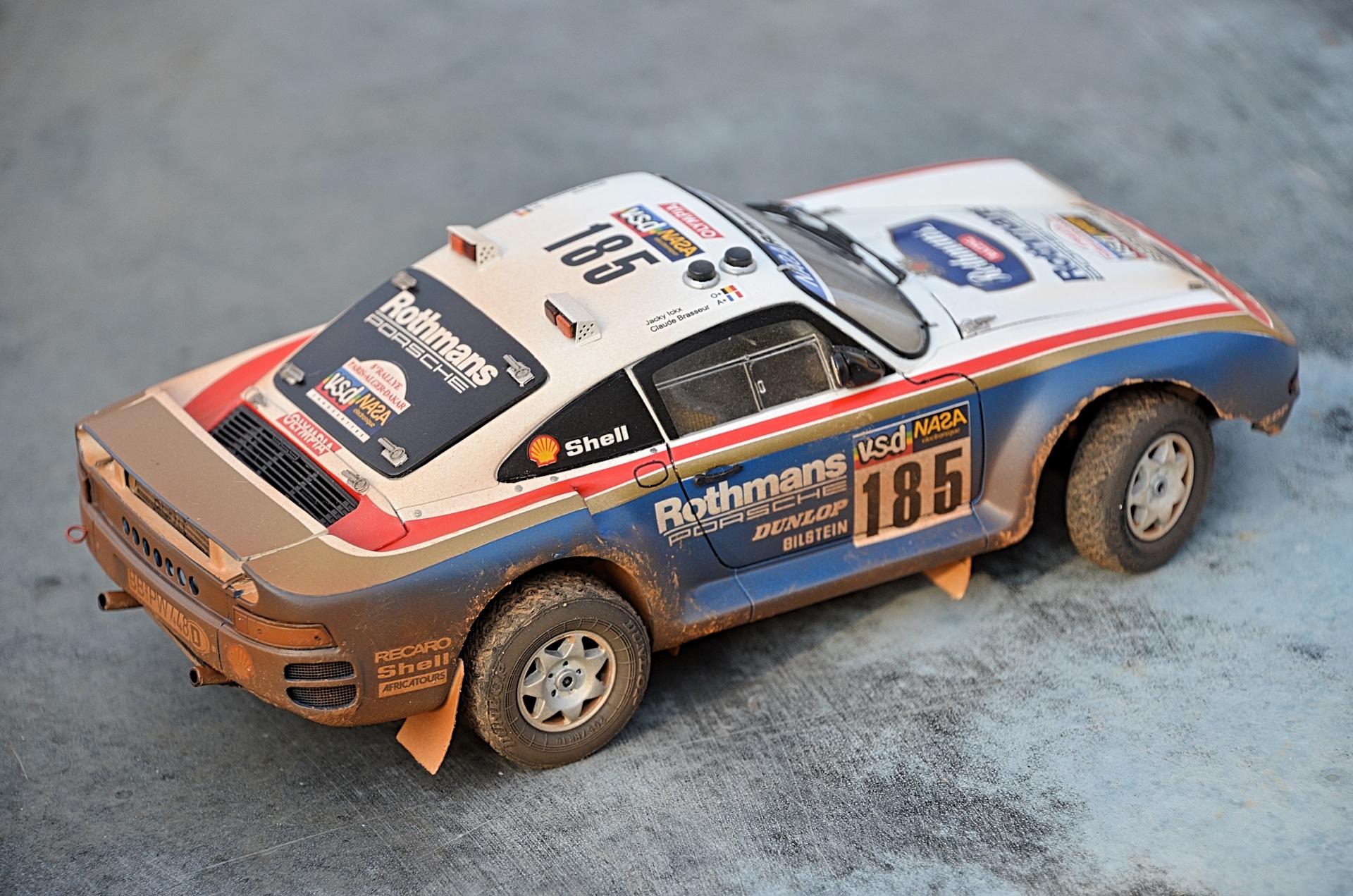

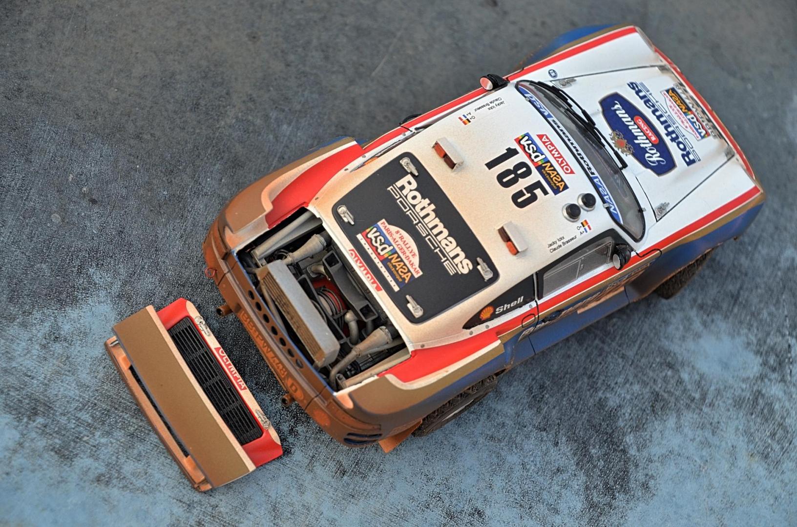

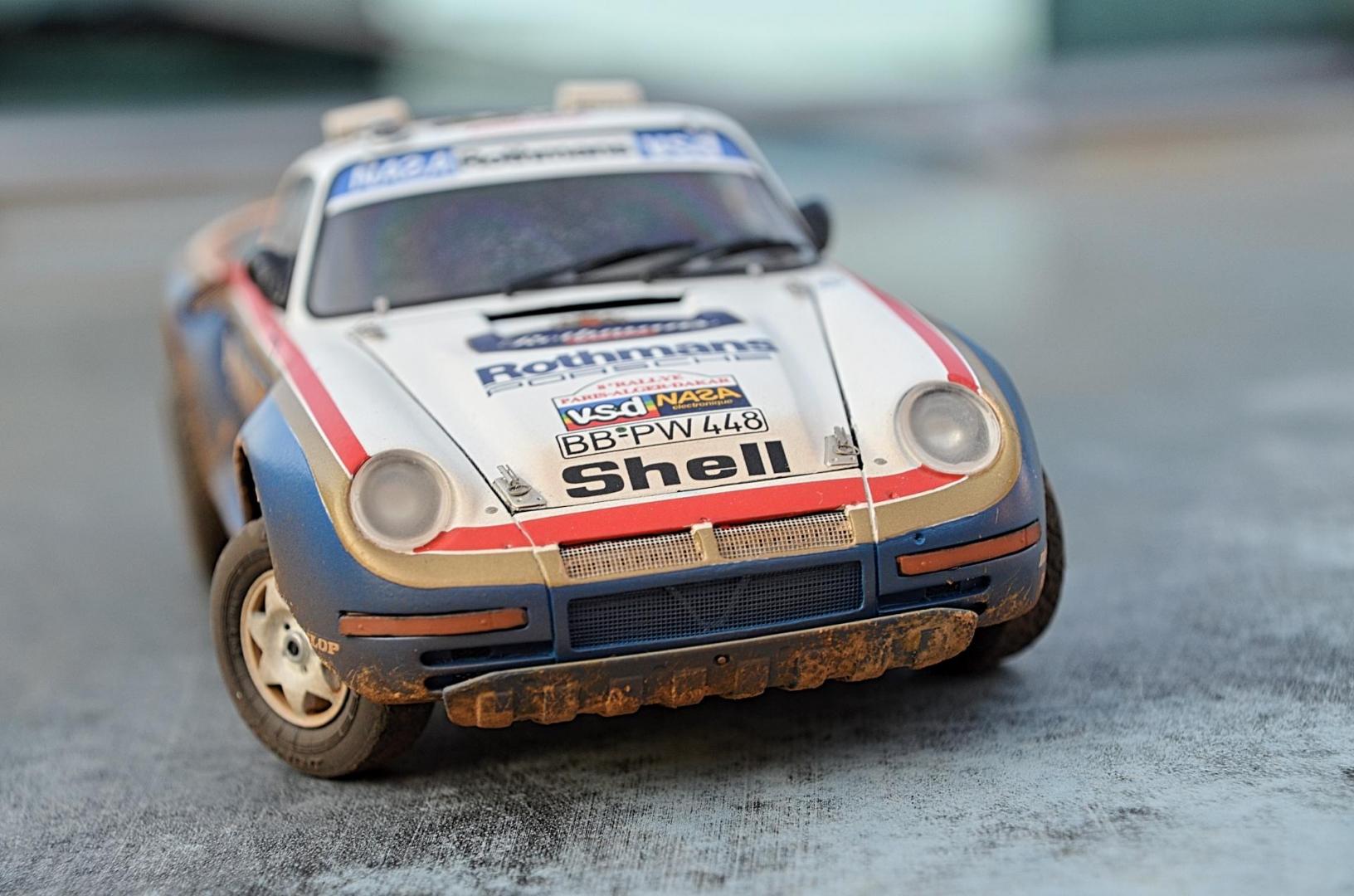

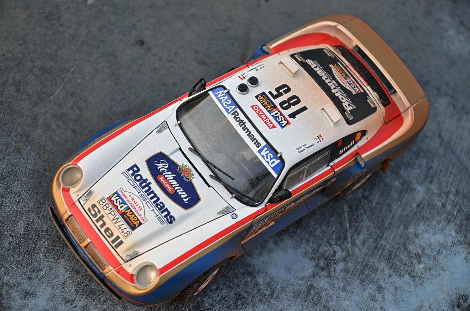

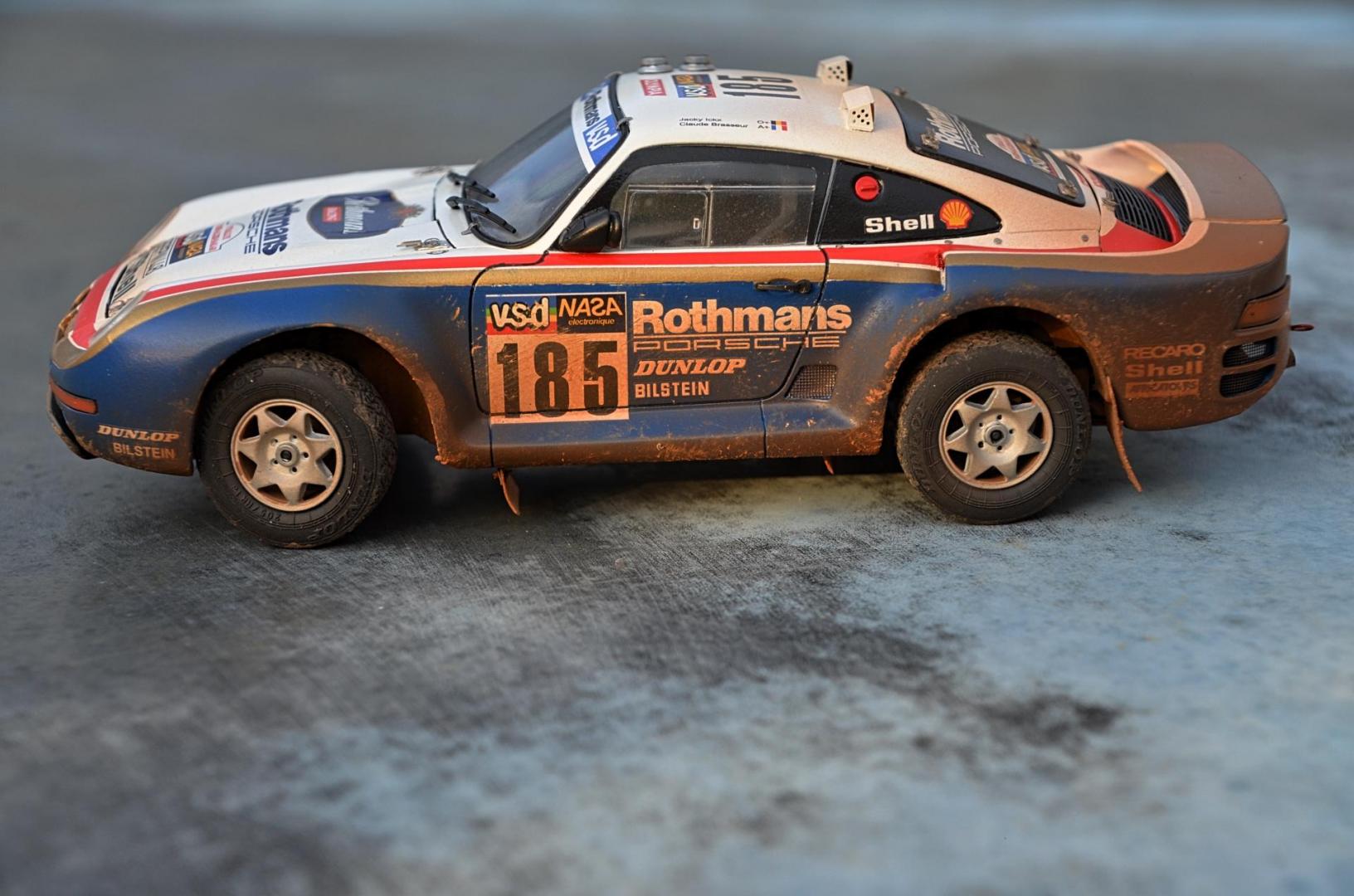

Tamiya Porsche 959 donor kit, with ModelingMaster resin transkit from Russia.  The WIP thread, showing what happened to the leftover parts.  I found the source on Facebook, ordered direct from the maker in Russia, so it was interesting to see it tracked to the border, and then waited a couple weeks for it to arrive.  I printed out all the decent pictures I could find online, and taped to a foam core board, a first for me; had to sort out the 1985 & 1986 races, then the 3 cars.  Discovered that there is a counterfeit that shows up at events such as Goodwood, the front hood is the giveaway, and lack of turbos.?  I damaged the front fender based on photos of Jacky Ickx's race, the other car has the other side with similar damage.  The third car DNF, and found out that one burnt to a crisp in an Egypt rally.  The Porsche museum car has Turbolader and Schmitthelm logos added, which were not on during the race!  Started April 22, 2018, finished Aug. 26 after 101 hours.

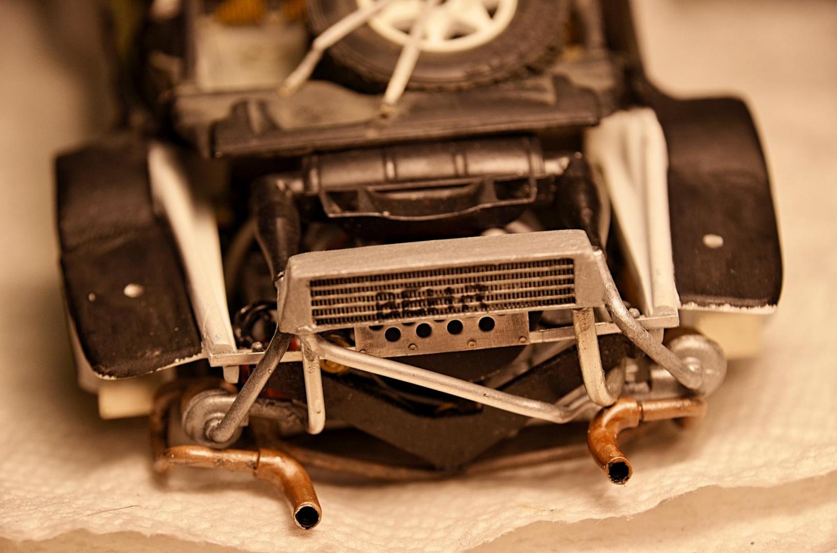

The quality is better than some mass produced kits, the photo-etch is finely done, even the glass is just like injection molded parts, the decals are perfectly done with all colors registered, but are very thick.  The Dunlop tires have very good sidewall and tread detail, but had gaps and a couple of bubbles on the back.  Some of the assemblies had fit issues, so that slowed down construction.  The pet peeve I have with both the Tamiya kit and this, no turbo plumbing from the air box to the intake manifold.  I made the two intercoolers for the road version (one picture here), but this rally car had one intercooler mounted high in the wing, so I *had to* re-engineer with rotating the turbo compressors and making all new piping, all with zero reference pictures.  Added some cargo, including 2 water bottles (it's the bloody Sahara!).  The instructions are the weakest part of the transkit, they used the Tamiya graphics, pasted crude computer drawn parts with almost invisible arrows to the general vicinity, and some parts were incorrect such as the hood pin parts that needed the top piece rotated 180°.  Some of the photo-etch parts were not even shown, and the RECARO seat decals were not shown.   I added a few photo-etch details such as hose clamps and screw/bolt heads.  Used sewing ribbon for the 5-point seatbelts.  Wired the engine, found a firing order label so IPMS rivet-counter judges will be happy; the distributor has only 5 "boots". ? All Testors paint airbrushed, but did brush paint some interior areas.  The "weathering" is flat clear, with different ratios and mixtures with Africa Korps tan and Leather brown.  Tried out tile grout and water, with acrylic paint, that was goober dry-brushed onto the bottom first before final painting, dusted the interior and engine with the tile grout too.  Scuffed the tires, flaps, and skid plates with rough emory cloth.  I really love doing this finish technique, because I suck with shiny perfect paint jobs. ? And a rally car really needs to look like it was rode hard and hung up wet!

Scratch-built turbo plumbing, intercooler mount (American hot rod style, I'm sure Porsche had a complicated setup), added sheet plastic for screw mounting body to chassis.

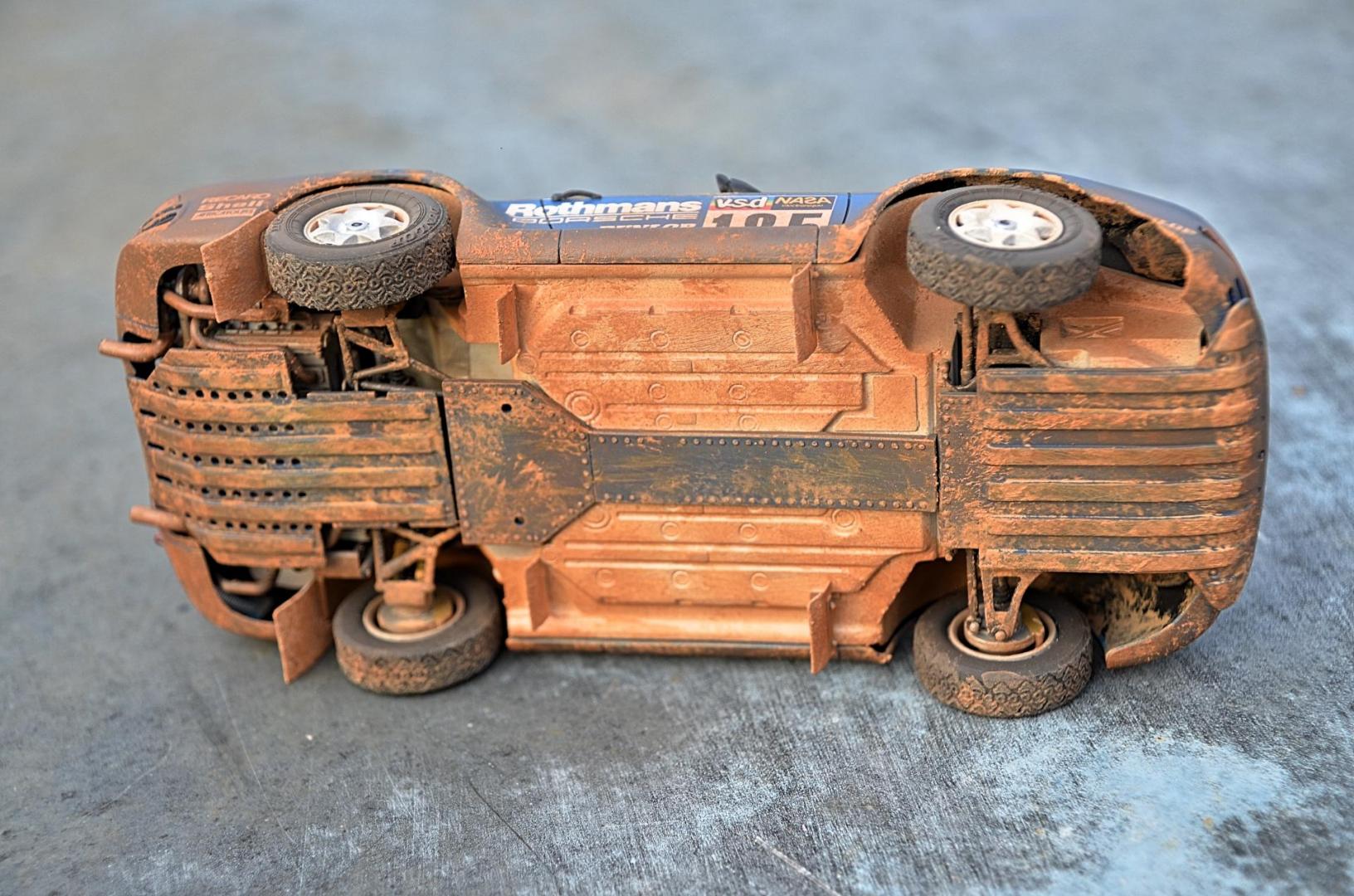

No car washes in Africa.

One of the finest Porsche builds that I have seen in a long time, Kurt..... clearly you have worked hard to get the detail right, and lots of thinking outside the box also. Your weathering techniques have pulled off the ' rally ' look and congratulations on your extensive research.
David

Thank you.  That's why I weather almost all my builds, bug splats if the paint is supposed to be shiny, it covers the dust specks. ?

Looks awesome. Great job. Good photos as well. Love that you can see the refection in the mirror.
Thank you, appreciate it.  I'm not happy with the pictures, still need to take the iPhone in to open up storage, so been using the Nikon with 300MM zoom lens, which has an extremely short depth of field.  Am planning on taking glamor shots outside, starting with Sedona.  I used AAA insurance sticker for the mirrors, instead of the dull photo-etch parts, glad you noticed that tiny detail!  Oh yea, welcome to the forum!

Thank you.  IMHO a rally model that is brand spanking new, and is really shiny, is fake looking.  I've worked several rallies (stage worker, video and photography), even the professionally prepared cars are not polished shiny, the sponsor graphics are dull stickers, and the paint is factory paint that isn't waxed (in general).  Private cars are usually beaters. ?
