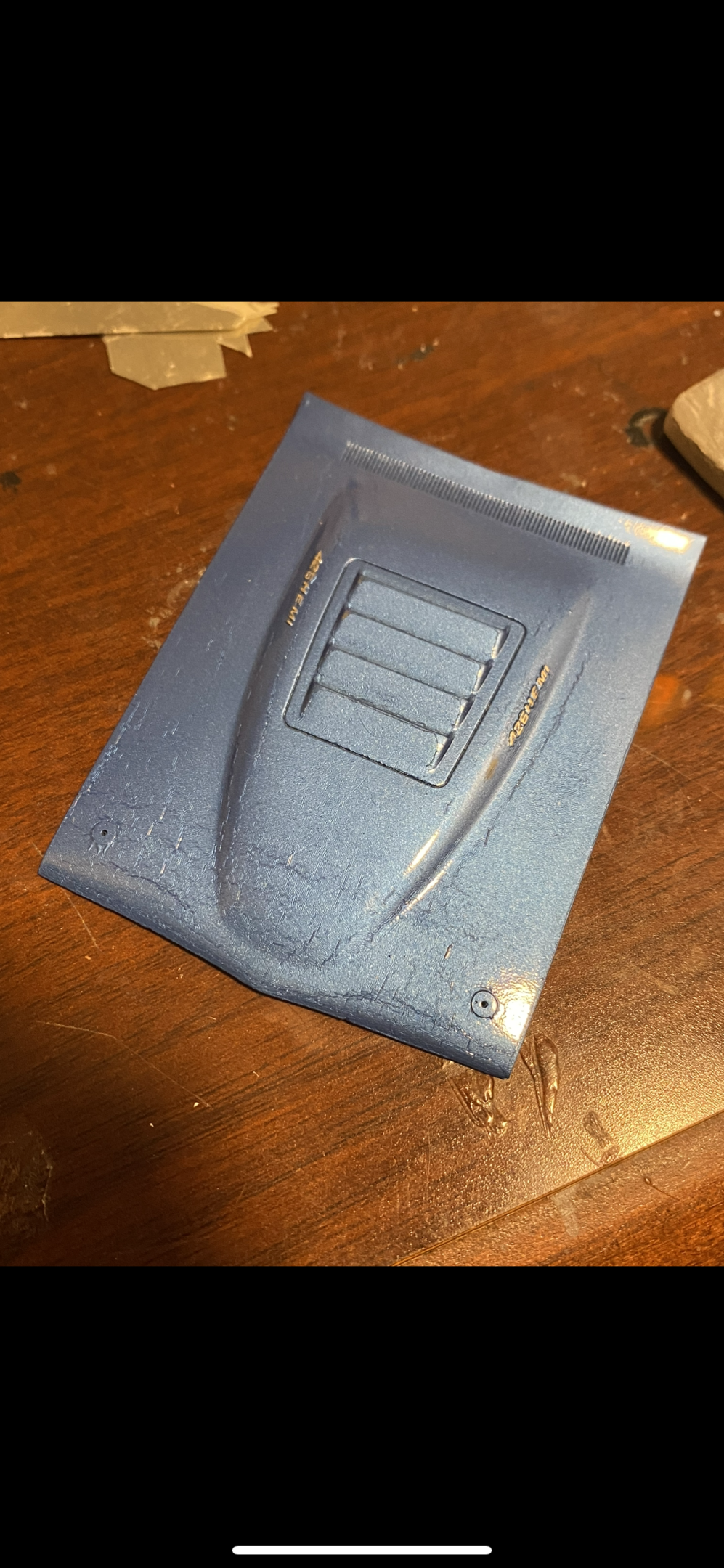

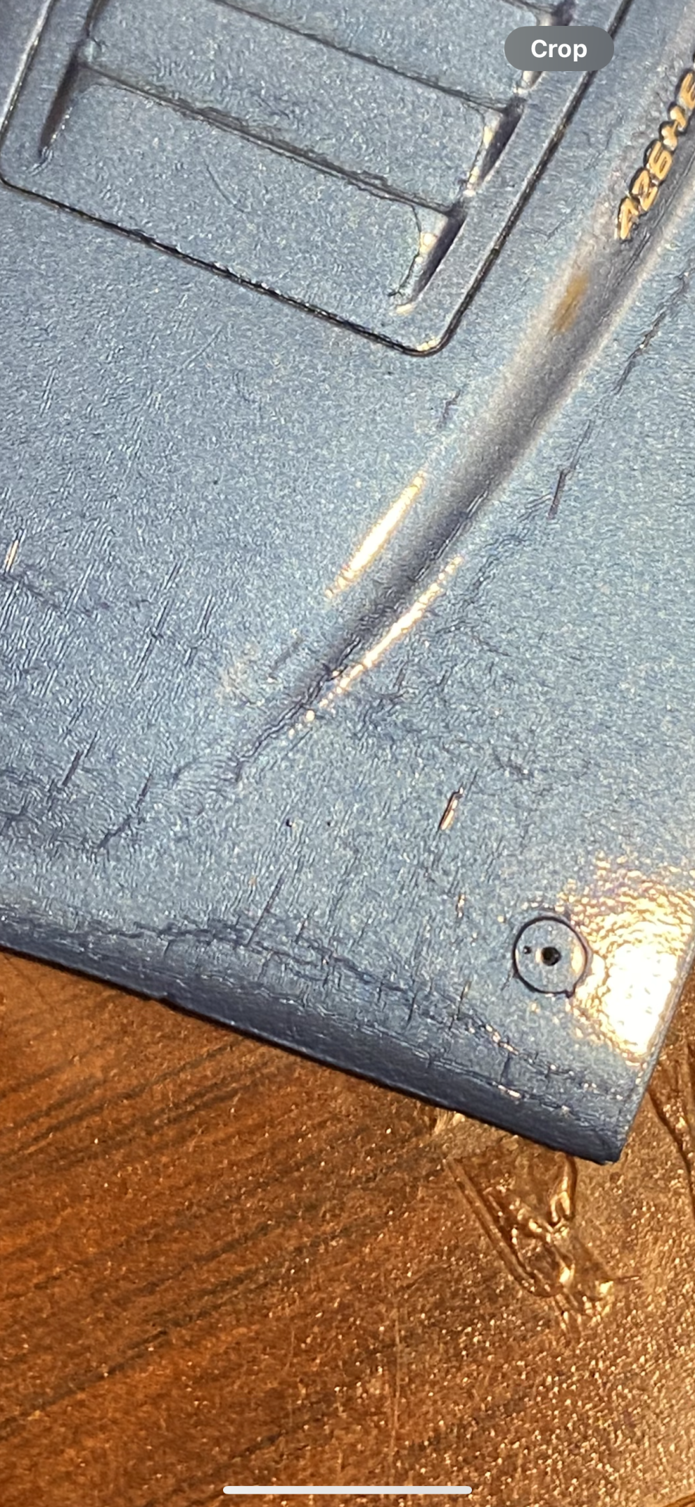

kymdlr Posted December 18, 2023 Posted December 18, 2023 Thread bump. this is airbrushed splash paints lacquer base with a rustoleum lacquer rattle can clear. This clear is usually my go-to with no problems. The base was perfectly smooth. When I sprayed on the clear, it immediately started to wrinkle and finished with this. Any thoughts on what went wrong?
Ace-Garageguy Posted December 18, 2023 Posted December 18, 2023 (edited) 44 minutes ago, kymdlr said: ...When I sprayed on the clear, it immediately started to wrinkle and finished with this. Any thoughts on what went wrong? Yup. The solvent in the clear was too hot for either the color or the primer, pure and simple, no other possibility. This looks like a classic "why you don't spray lacquer over enamel" example. Even though you say the Splash stuff is "lacquer base", there are different lacquer formulations, some of which behave more like enamels...and paint labeling for hobbyist and big-box/hardware store products is notorious for being inaccurate, vague, and confusing anyway. Have you used this exact combination of products before with no problem? If the answer is no, then this is why we constantly harp on testing each different combination before painting a model. Edited December 18, 2023 by Ace-Garageguy 2
bobss396 Posted December 18, 2023 Posted December 18, 2023 (edited) I see guys in my club do this now and then. This is something I learned by age 11, using some of my dad's touch up paints from the garage. I used to speak up, but the cheap-paint crew poo-pooed my words of wisdom. Now I just sit back and enjoy the show. Edited December 18, 2023 by bobss396 sdfghjkl
