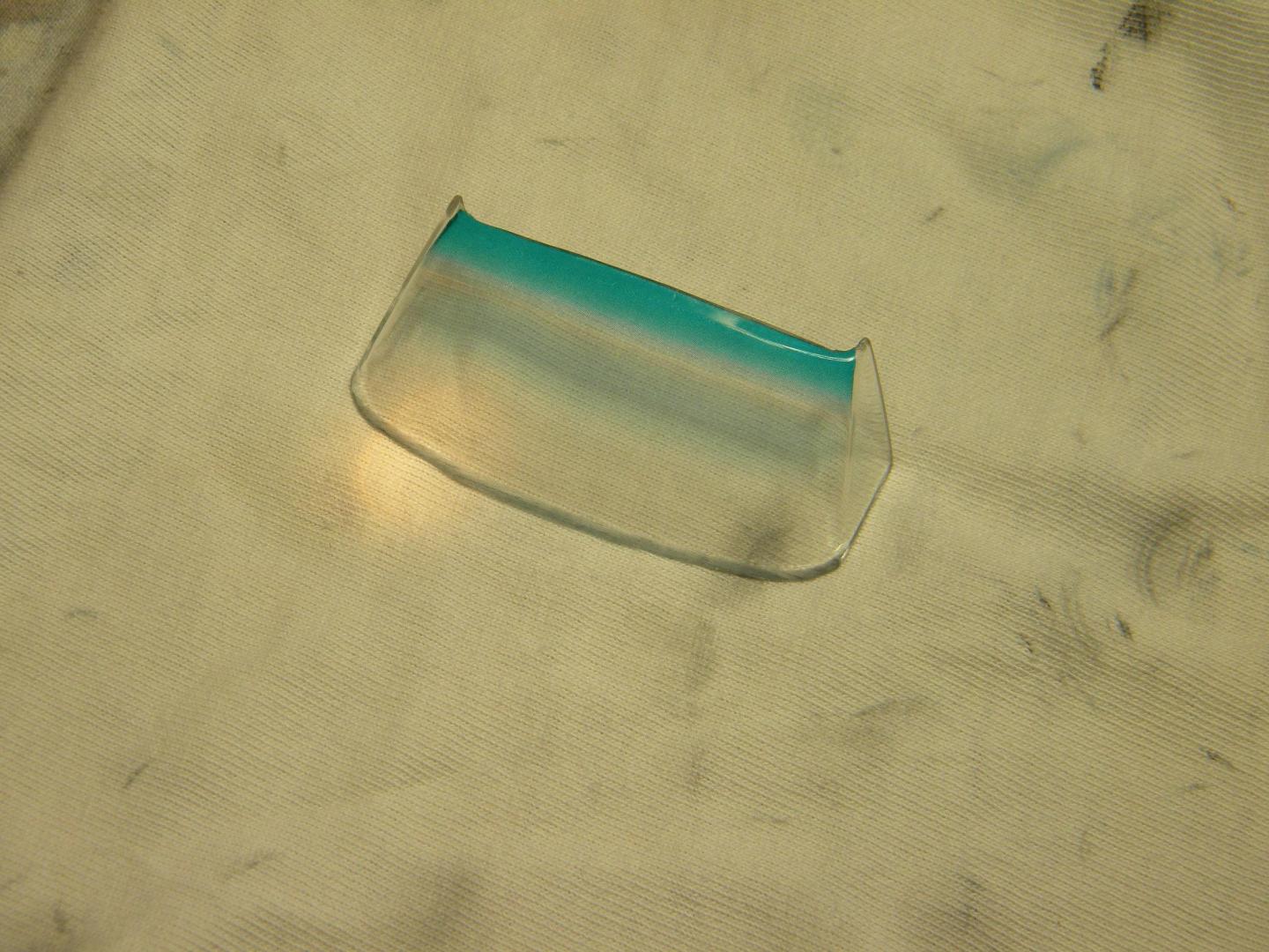

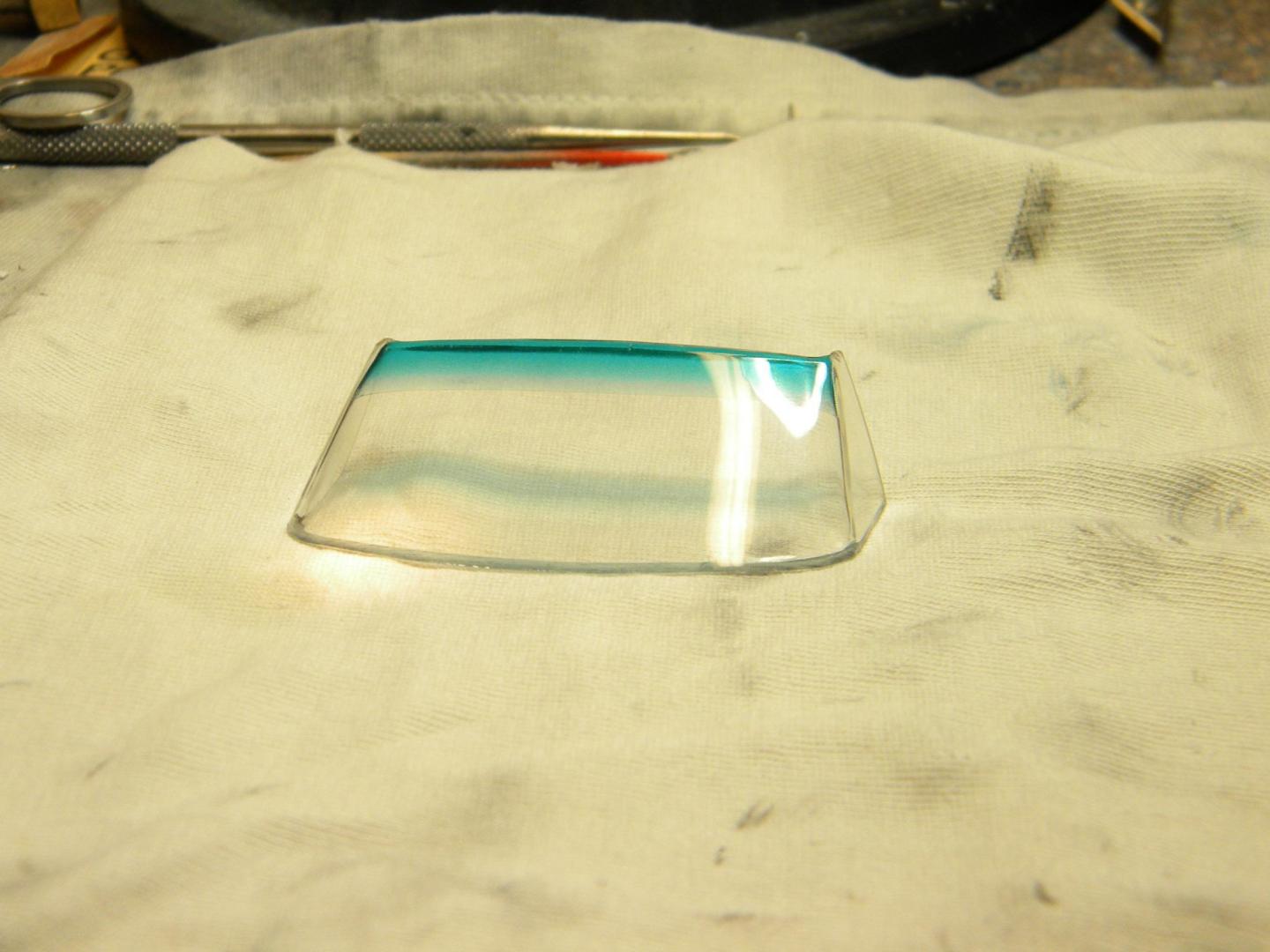

StevenGuthmiller Posted September 1, 2019 Share Posted September 1, 2019 Hi everyone. I know there have been a couple of guys interested in this product, and I just gave it my first try and thought you might like to know how it went. Basically, these are "dry transfers". The individual strips need to be cut from the sheet with a sharp Exacto blade and lifted with a tweezers. Don't try to use these using your fingers. The adhesive is so strong that it would be nearly impossible to manipulate them with your fingers. The instructions call for spraying the glass with water to facilitate positioning. Well, as you can imagine, this is difficult as the water has a tendency to bead up on the bare clear plastic. You just need to do the best that you can. The fact that the vinyl is very thin and the adhesive very strong can make positioning quite difficult, but luckily, it can be lifted and moved multiple times without degrading the adhesive. Once in place, it's easily burnished down with a Q-tip and trimmed with an Exacto blade The results are actually very good! I will offer one warning. I generally like to add a light overall tint to the entire glass with Testors #2949 "Transparent Black Window Tint" before adding the tint across the top of the glass. This didn't work because repositioning the decal pulled the window tint from the glass. Then I tried to apply the window tint after the decal. I had no luck with this technique either as the tint pooled slightly in a thin line at the edge of the decal leaving a dark line at the bottom. I have a couple of more ideas that I will try later to see if things work a little better and will post photos of the finished product when I have perfected it. But at this point, the product looks very promising. Steve Quote Link to comment Share on other sites More sharing options...

StevenGuthmiller Posted September 2, 2019 Author Share Posted September 2, 2019 1 hour ago, Foxer said: Very interesting, Steve. I like that you can pull it up and reposition. Any pics of how it looks? Well, one of my thoughts was to try using Windex instead of water on the glass to guard against beading. That didn't work either. It destroyed the adhesive on the transfer. So, it was back to the basics and just apply it as per the instructions, with water, and it looks quite nice. Steve Quote Link to comment Share on other sites More sharing options...

TooOld Posted September 5, 2019 Share Posted September 5, 2019 That does look good ! The bottom edge of the transfer is visible but for those without an airbrush this looks like a good alternative . Quote Link to comment Share on other sites More sharing options...
StevenGuthmiller Posted September 9, 2019 Author Share Posted September 9, 2019 On 9/5/2019 at 5:51 AM, TooOld said: That does look good ! The bottom edge of the transfer is visible but for those without an airbrush this looks like a good alternative . The bottom edge is visible in these close up photos on a white background, but you will never notice it with the naked eye once installed with an interior behind it. Steve Quote Link to comment Share on other sites More sharing options...

bisc63 Posted September 10, 2019 Share Posted September 10, 2019 That looks WAY better than I would expect for that attachment method! Cool stuff, but in your pics, at least on my screen it looks a bit bluer than I'd prefer. Is it perhaps more green and less saturated in person? Very curious to try this! Thanks for posting. Quote Link to comment Share on other sites More sharing options...
StevenGuthmiller Posted September 10, 2019 Author Share Posted September 10, 2019 (edited) 27 minutes ago, bisc63 said: That looks WAY better than I would expect for that attachment method! Cool stuff, but in your pics, at least on my screen it looks a bit bluer than I'd prefer. Is it perhaps more green and less saturated in person? Very curious to try this! Thanks for posting. It does look a bit stark on a white, (actually more of a dirty yellow and poorly lighted) background, but I did do a little test fitting with the other parts of the model and it appears that it will be less apparent and more subtle when installed on the finished build. With any luck, I will be able to post some photos of the finished product installed in the model in the not too distant future. Steve Edited September 10, 2019 by StevenGuthmiller Quote Link to comment Share on other sites More sharing options...
