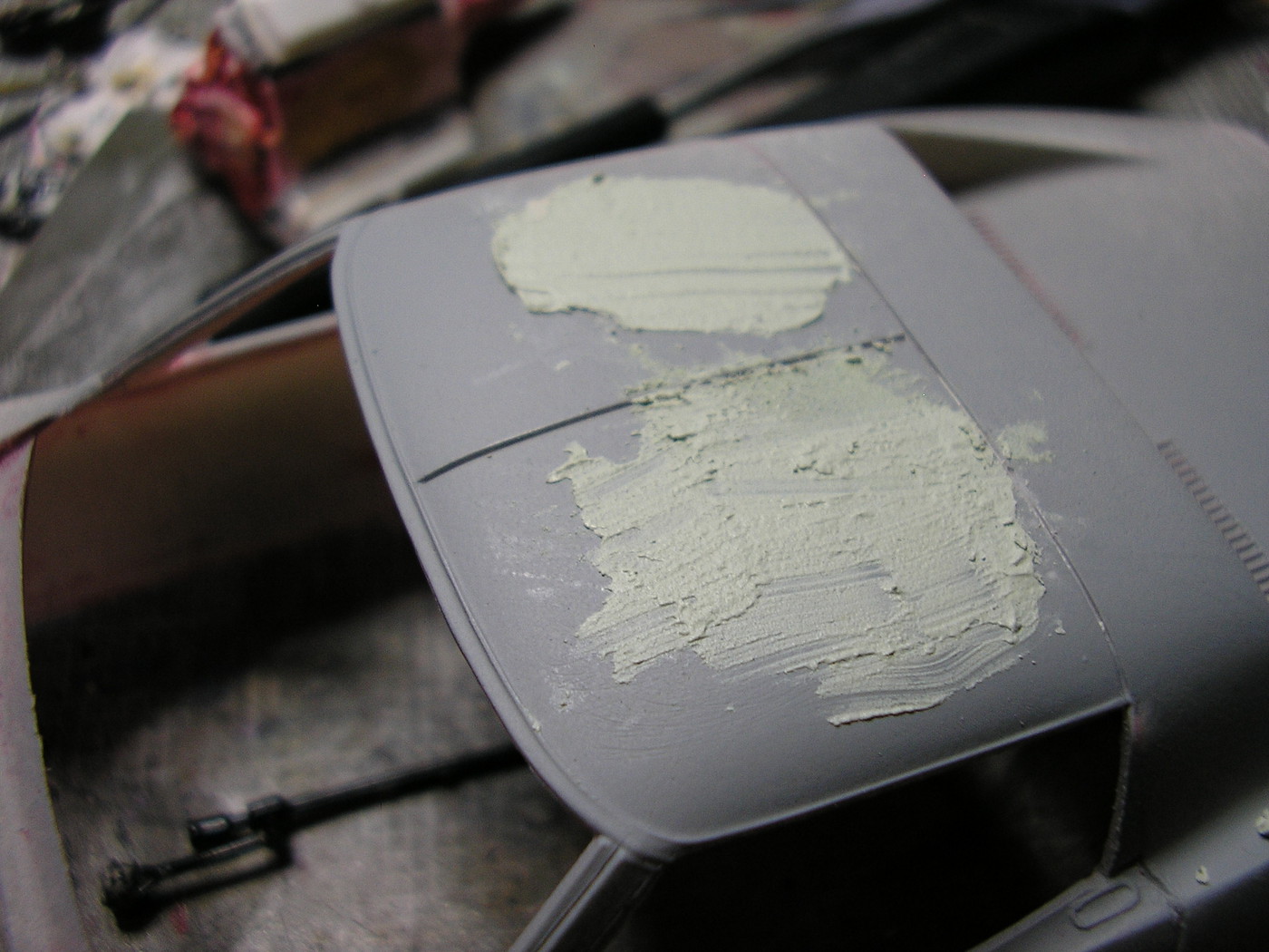

MrObsessive Posted September 3, 2019 Posted September 3, 2019 When I was restoring the '74 Corvette, I got disgusted with how much glue was used to put in the glass, I got out my Dremel and ground it out! So much was used that the roof was damaged............. Of course, I had to fill in the depressions which I did with my Dynatron Putty-Cote. Now one would never know what damage there was unless I showed them. That can be the drawback to buying a builtup......too much glue can be used which sometimes can be more trouble than it's worth to fix.

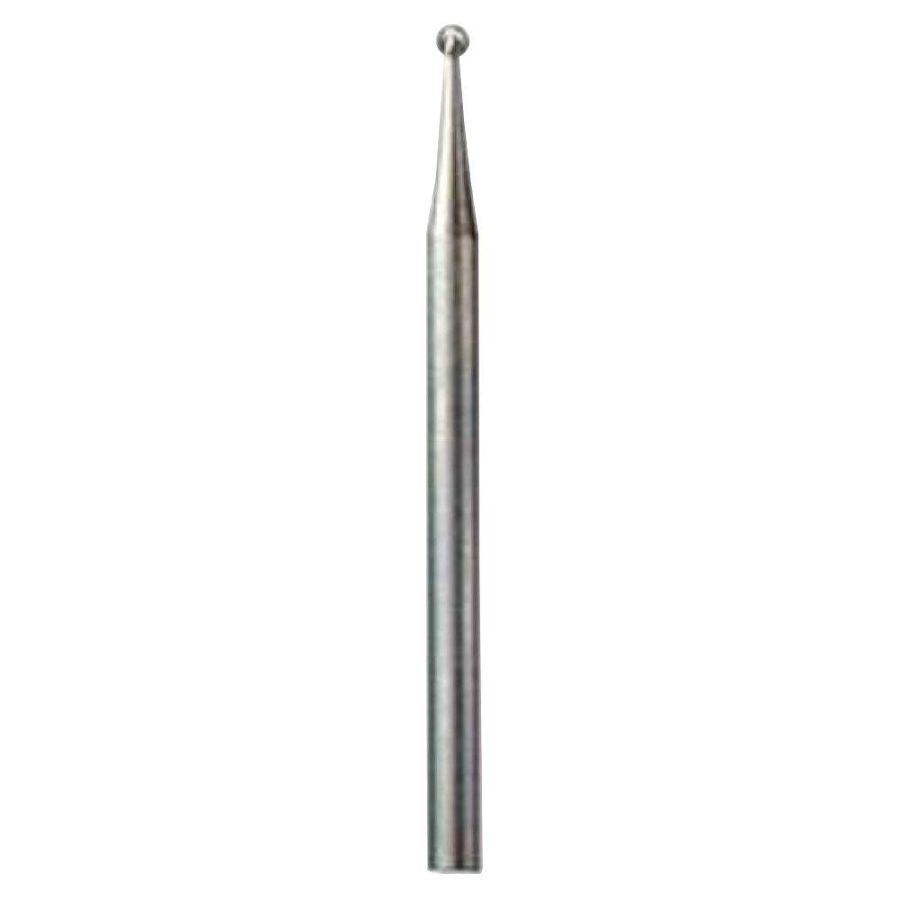

hedotwo Posted September 3, 2019 Posted September 3, 2019 I occasionally use my Dremel with this type of bit in certain cases like getting glass free from the locators. Be steady and careful.
