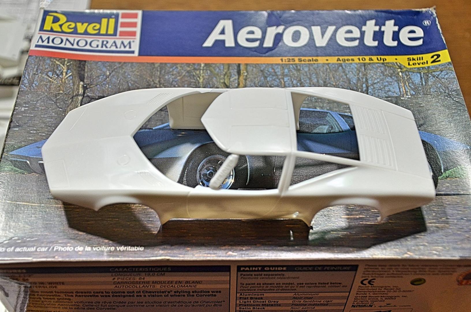

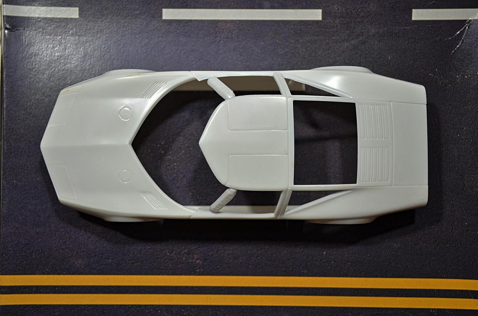

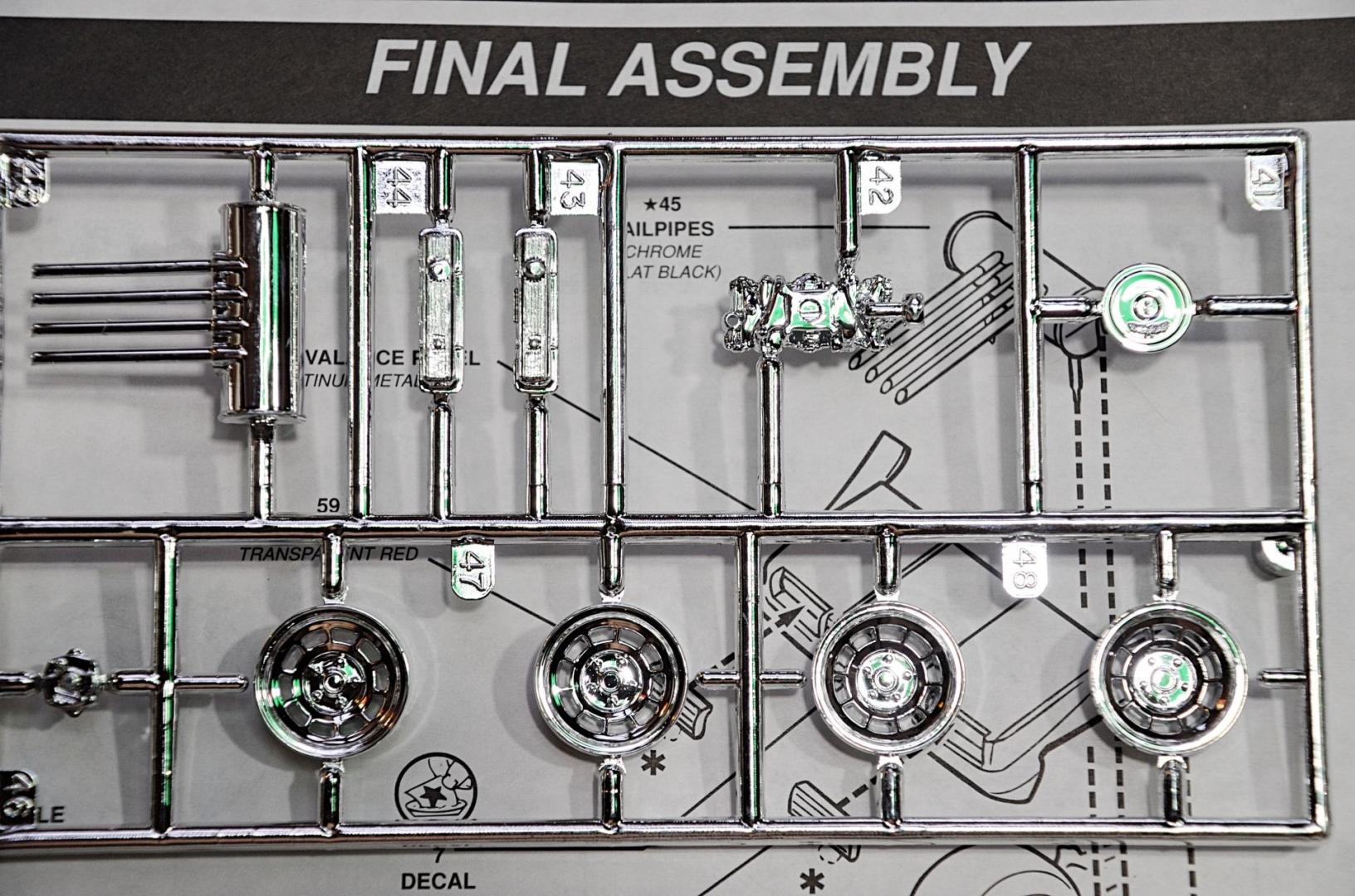

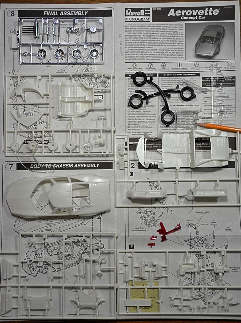

89AKurt Posted September 7, 2019 Posted September 7, 2019 Since everyone is getting excited about Chevrolet finally producing a mid-engine Corvette, dragged this Aerovette out to take a look. It was 1980 (39 years ago) when they ditched the wankel engine and put in a proper V8. I like the design, including the Jalousie windows, and you can see some styling cues were carried into the production cars. Revell produced this in 1998. It's typical Revell quality, some flash, simplified parts, but what is most annoying is the folding box! ? But it does have the highway for display. ? The usual amount of parts. Turbine wheels, not really defined enough at first glance. Now this is what ticks me off about how Revell packaged their kits, I bought it sealed, figuring it could be somewhat collectible. Read about "tire burn" in this forum, opened it up and sure enough. ? I don't want to spend a lot of time correcting or detailing this, just want to build Box Stock. Would replacing the window with sheet plastic disqualify for such a contest class? It would take a bunch of sanding and polishing to fix this, and cause distortion. Have the Bring Out Your Dead project to finish, before I dive into this. Also thinking of painting copper, since I live in Arizona. ?

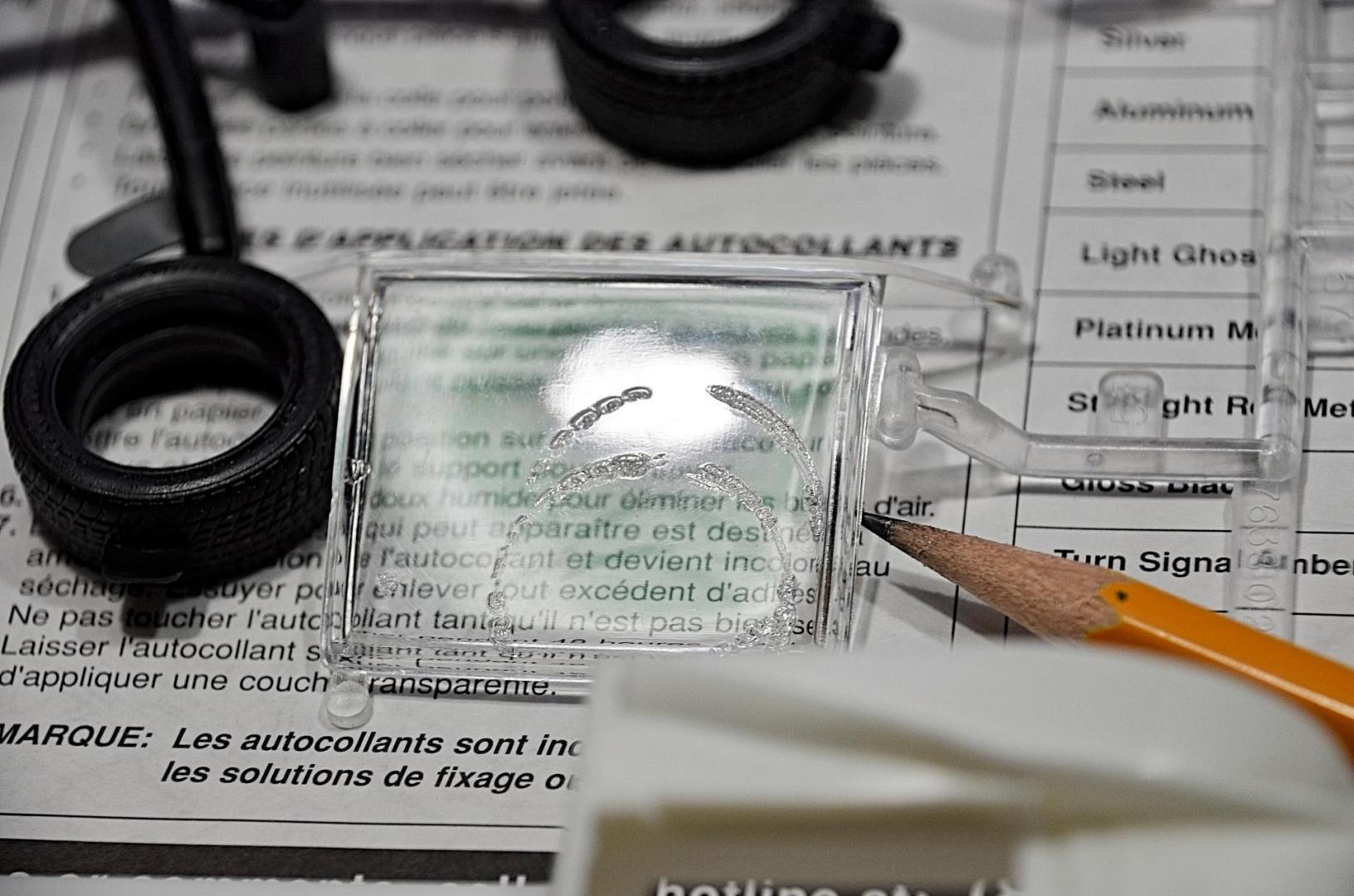

Snake45 Posted September 8, 2019 Posted September 8, 2019 2 hours ago, 89AKurt said: Now this is what ticks me off about how Revell packaged their kits, I bought it sealed, figuring it could be somewhat collectible. Read about "tire burn" in this forum, opened it up and sure enough. ? I don't want to spend a lot of time correcting or detailing this, just want to build Box Stock. Would replacing the window with sheet plastic disqualify for such a contest class? It would take a bunch of sanding and polishing to fix this, and cause distortion. Under IPMS rules, that wouldn't be allowed. Model Car World tends to be ruled by more local rules, which might be stricter or looser. That CAN be fixed, but as you said, it would take some time.
Danno Posted September 8, 2019 Posted September 8, 2019 Quote Quoth the raven. (I did not intend to insert a quote here, but I can’t get rid of this stupid #@$&% box. What you could do, Kurt, is find someone that has four or five of the Aerovette kits; someone who doesn’t intend to build any of them to ‘Box Stock’ standards; someone who would be willing to swap a pristine, virgin glass for yours; someone who might be willing to come up to Prescott for the swap meet in a couple of weeks & meet with you to make the exchange; someone like me. ?. If you’re game.
89AKurt Posted September 8, 2019 Author Posted September 8, 2019 17 hours ago, cobraman said: Man how I hate those boxes. I will be watching your progress here. I know right? They collapse when stacked too, just to be REALLY annoying. 16 hours ago, Snake45 said: Under IPMS rules, that wouldn't be allowed. Model Car World tends to be ruled by more local rules, which might be stricter or looser. That CAN be fixed, but as you said, it would take some time. That's what I thought. 12 hours ago, Danno said: What you could do, Kurt, is find someone that has four or five of the Aerovette kits; someone who doesn’t intend to build any of them to ‘Box Stock’ standards; someone who would be willing to swap a pristine, virgin glass for yours; someone who might be willing to come up to Prescott for the swap meet in a couple of weeks & meet with you to make the exchange; someone like me. ?. If you’re game. ? I just had the same "quote" thing on another thread, finally was able to delete it, screw it. Too bad Ron Mayer cancelled their Escape The Blaze, not enough people committed to it, they would casually say they were interested, but didn't pull the plug. "Normal" people get the heck out of Feenicks and come up just because this is below broiling temperature in the mountains, and get in our way on the roads. If you know someone, PM me. ?

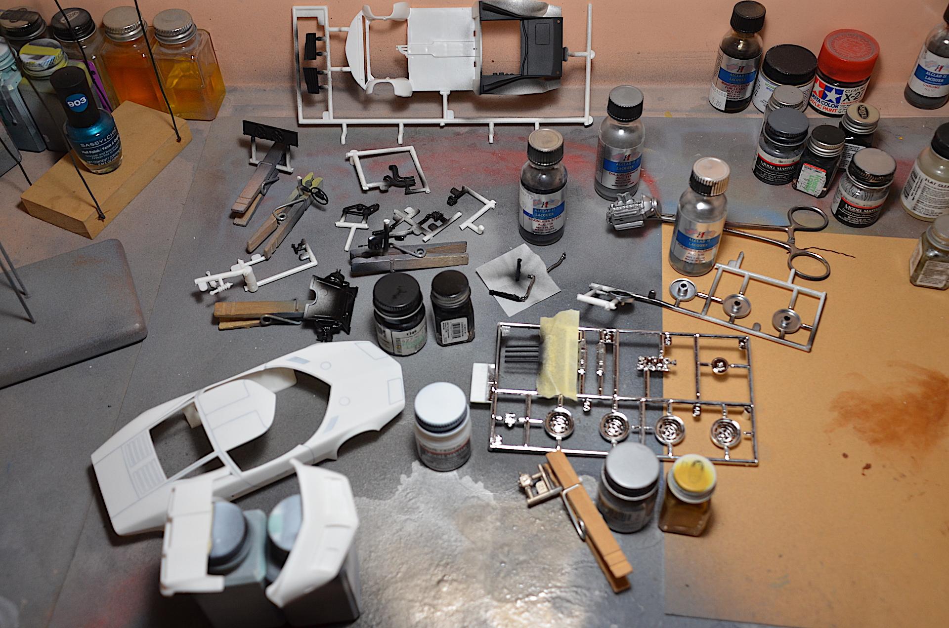

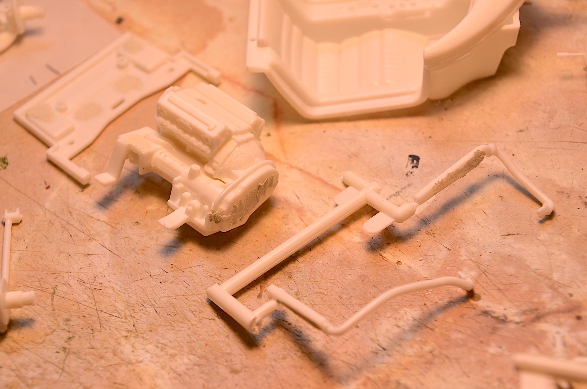

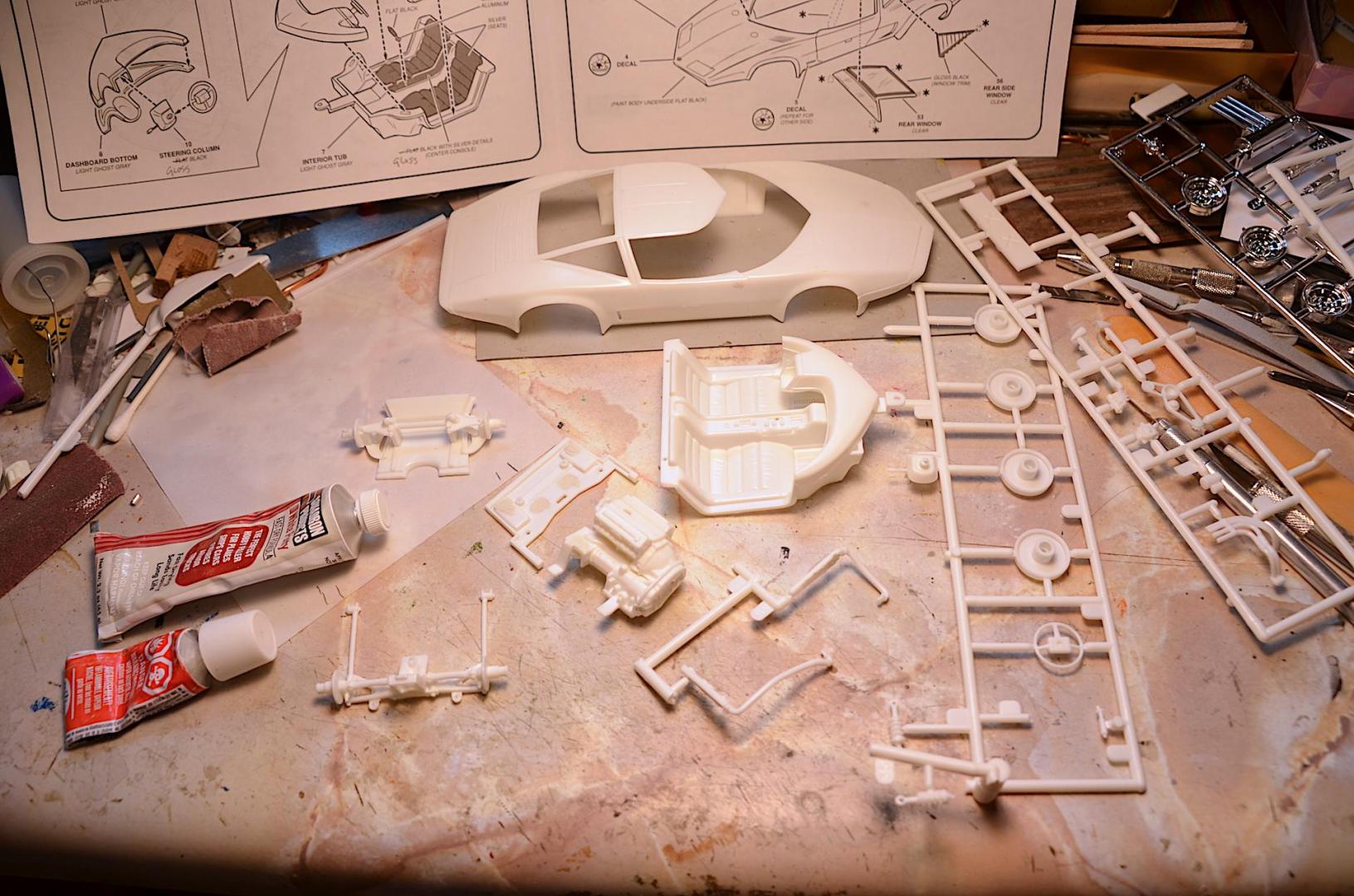

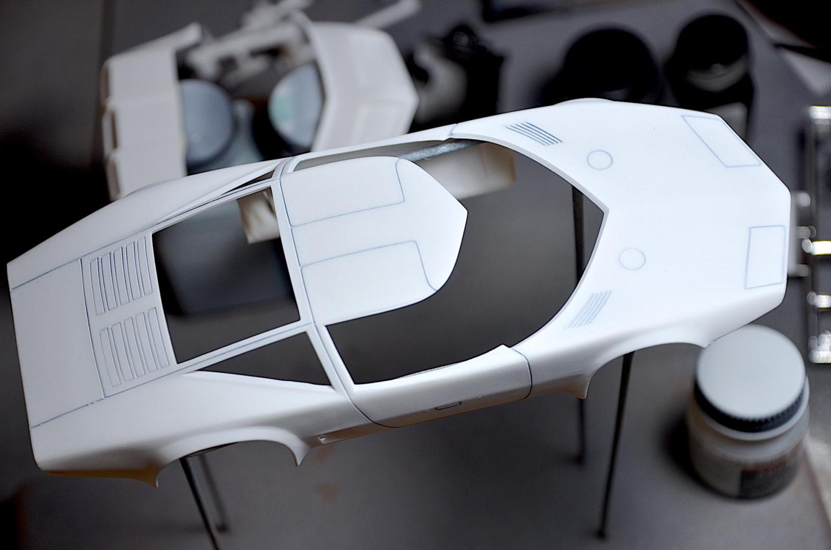

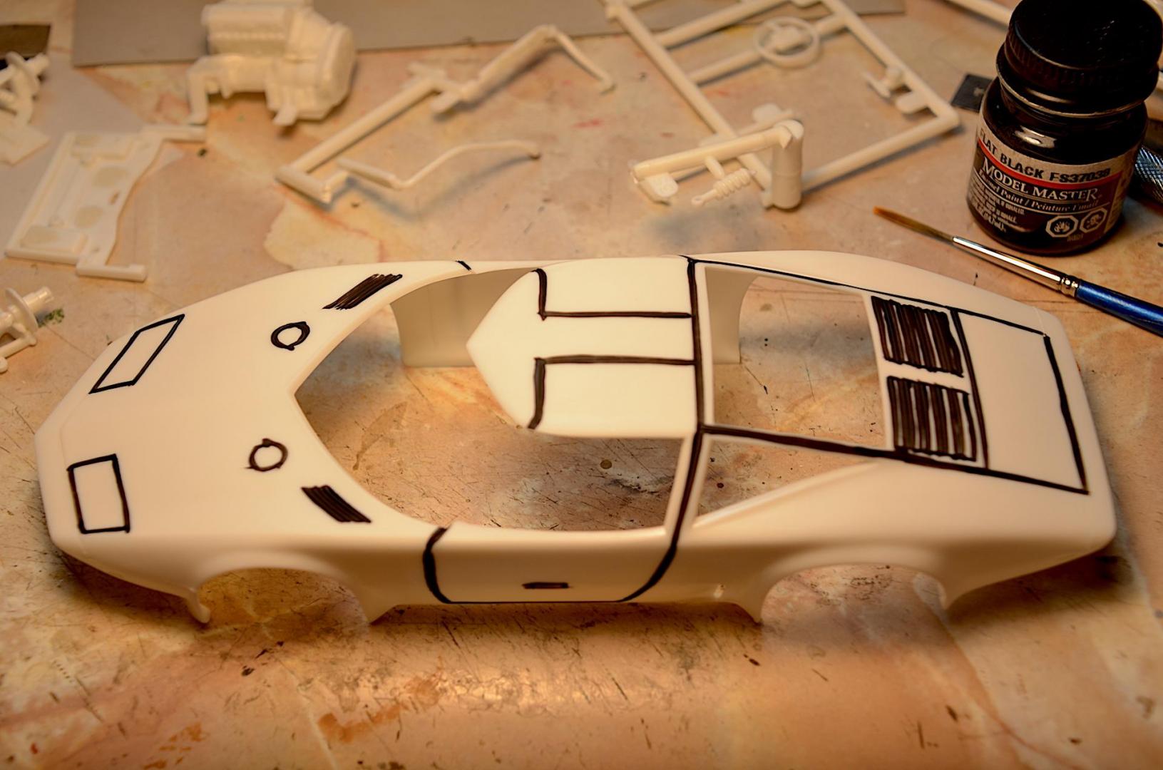

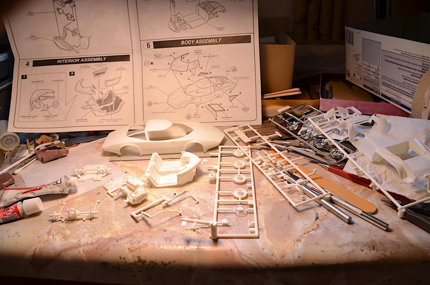

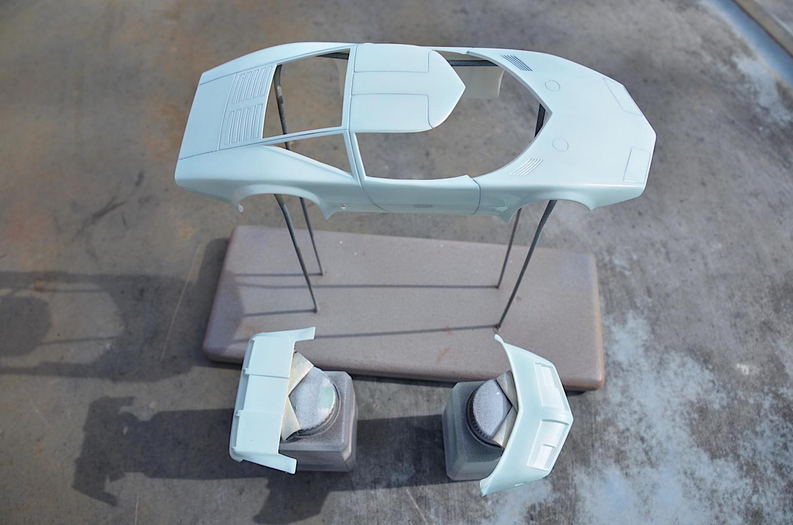

89AKurt Posted September 25, 2019 Author Posted September 25, 2019 On 9/8/2019 at 2:36 PM, Danno said: [...] I’ll send you a replacement for your glass. Received today! THANK YOU! ? That's why I started this project. Sub assemblies glued with regular Testors glue and Flex-i-file liquid cement. This is a really simple kit! Filled sink holes with Squadron putty. Trying a variation of a technique I learned on this forum, before any paint, slop brushed flat black in jamb lines. Very little scribing was needed first. Wet-sanded the body, quite a bit was needed at the louver things behind the window. The way this is assembled, made it tricky, I had temporarily glued on the bumpers so I could make everything flush and fit right, then broke apart before painting. Airbrushed Testors flat white for a primer. Painted various other parts. Gloss black for parts that would get Alclad, but I wanted the starter to be black instead of aluminum (seems like 95% is silver) for some contrast, is that wrong? ? Other parts flat black; found it interesting the instructions say "flat black" but don't show where on the chrome muffler, pictures show the 4 exhaust tips are black with no chrome tips! Pictures also show engine compartment is flat black, not shown on instructions. The inner wheels are Alclad polished aluminum, also painted the other side flat black because the wheel slots are open, something the instructions don't mention and I'm sure many builders would overlook. Instructions also say the exhaust manifold is aluminum, pictures show flat black, so had to mask the Alclad stainless steel pipe using velum paper with a slot and hole to mask, to avoid using tape. I even custom mixed aluminum and gold to spray just the carburetor. I really hate brush painting ? But I hit a snag, the engine was painted Alclad flat aluminum over black, it shrank and pulled away from all inside corners, so need to remedy that. ? Guess that paint can only be used on flat airplane panels. So cool to have the internet for reference nowadays. This You Tube video Aerovette -- Corvette Show Car shows the interior features, specifically the instruments. It's amusing to see the high tech LED tach and speedometer "in the line of sight", and to see the other functions you need to look down on the counsel and push the right buttons. I was wondering why there was not gauge decal. Also discovered they left out the pedals, not even molded into the floor! No windshield wipers either.

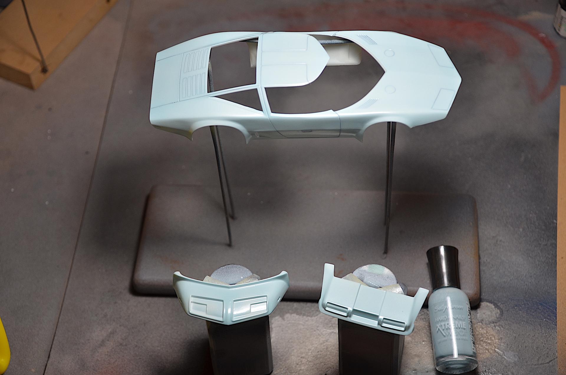

89AKurt Posted September 25, 2019 Author Posted September 25, 2019 Painted the body this morning. It was a last minute decision, I just didn't want to paint boring silver. This is Sally Hansen - HARD AS NAILS XTREME WEAR nail color, Breezy Blue. I'm now going to paint the chassis pan all flat black, instead of aluminum. I didn't edit the photos, first under LED light, second outside. I can *never* get a clean paint job, have some dust/lint to deal with. ?
