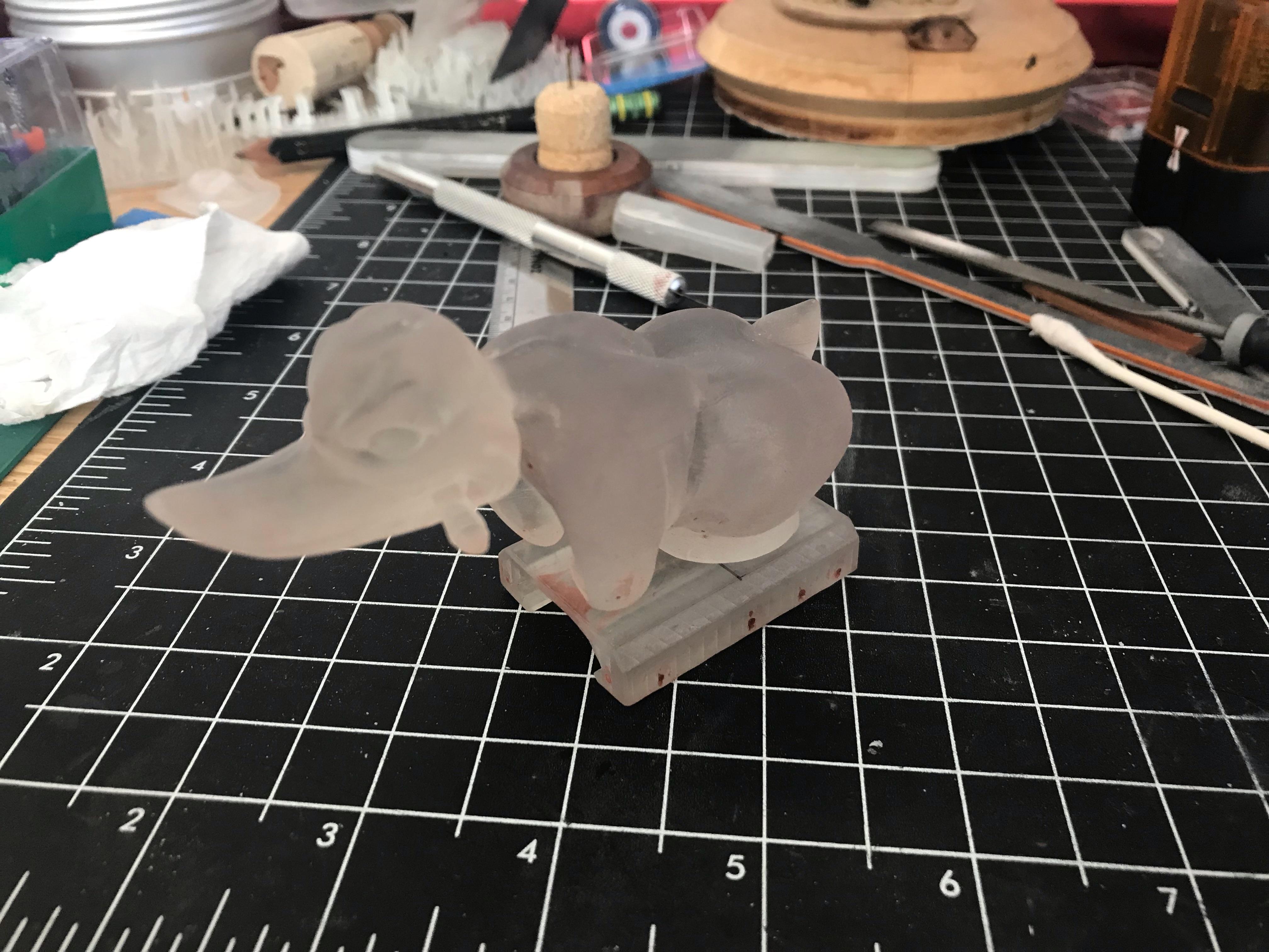

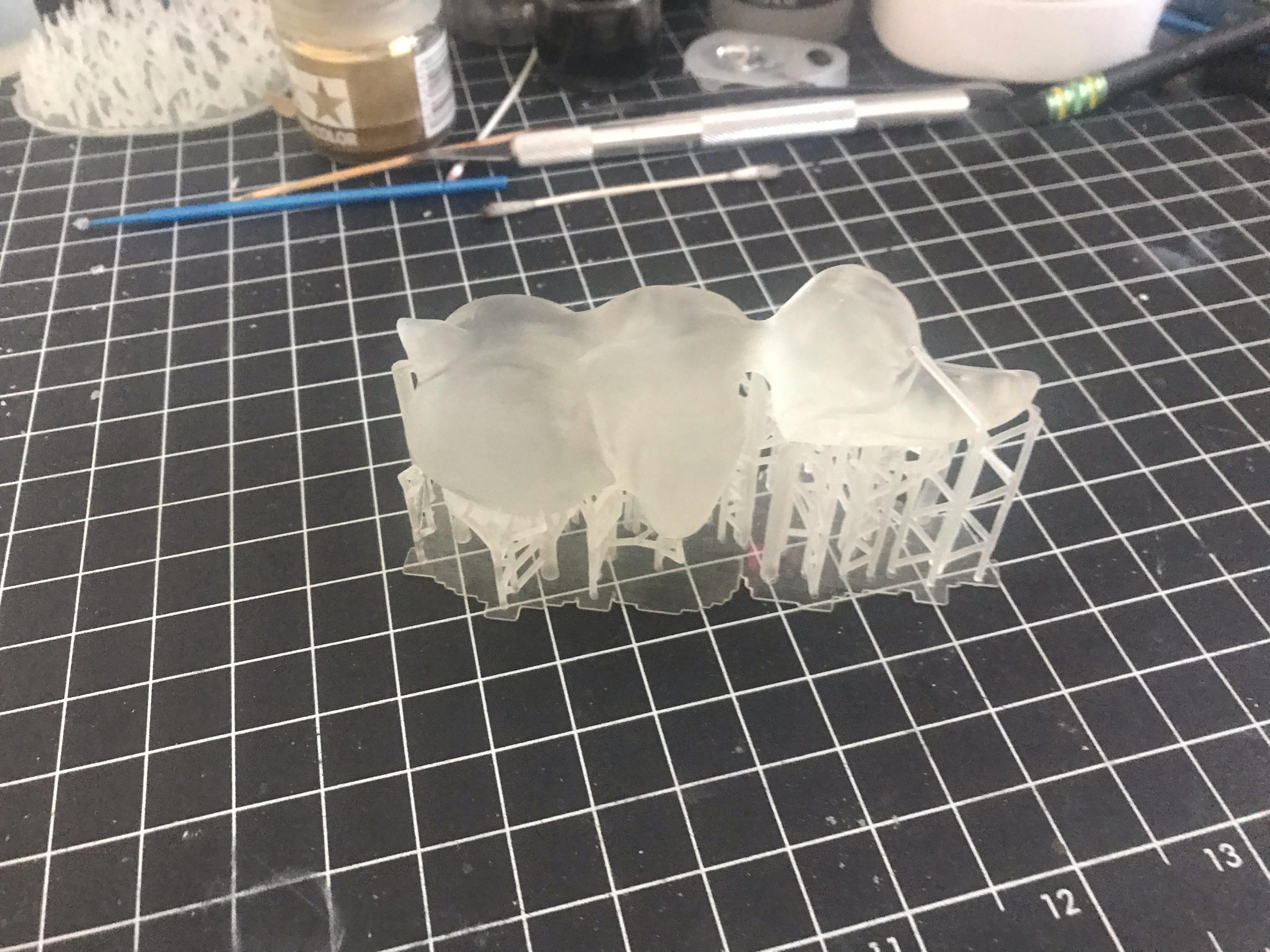

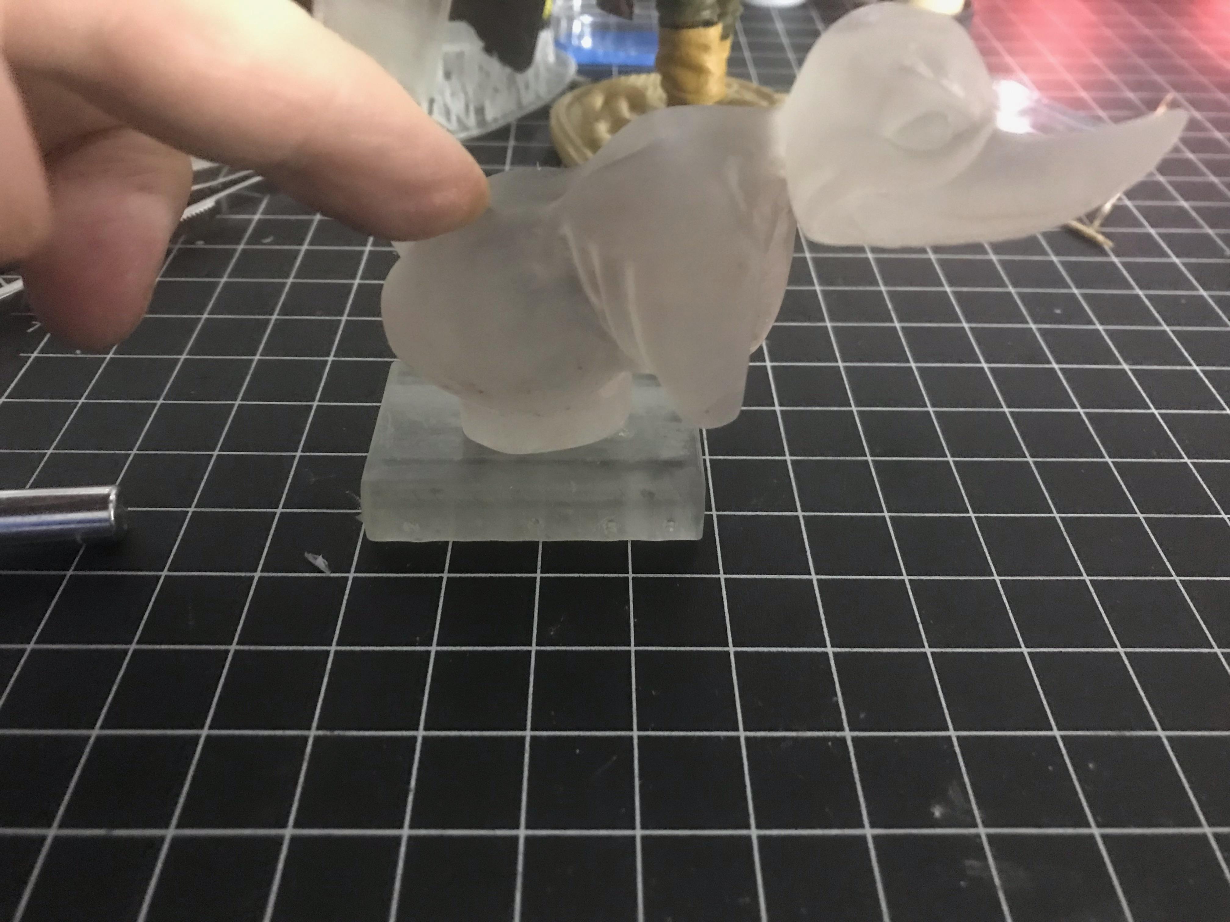

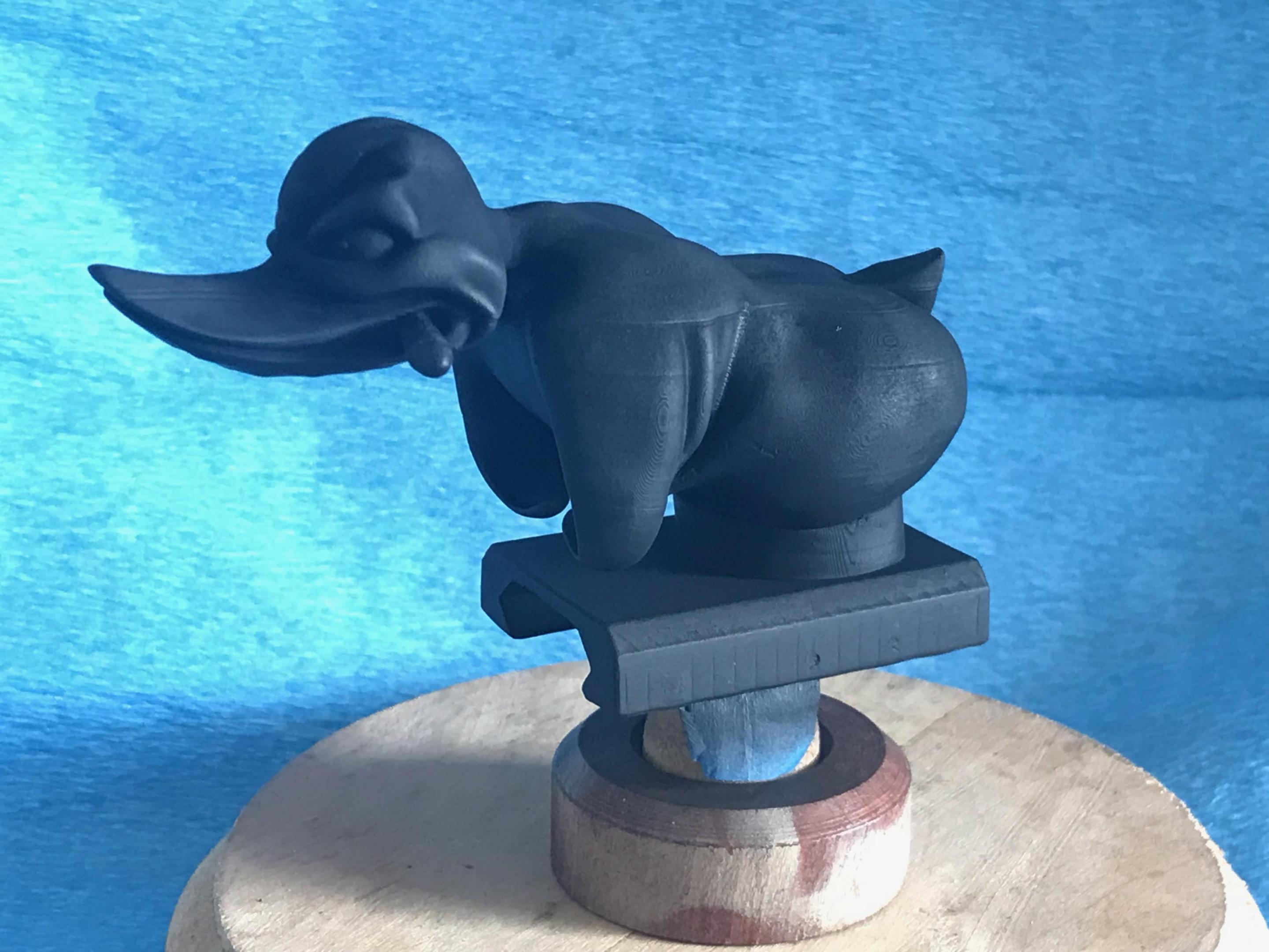

Twokidsnosleep Posted September 23, 2021 Author Posted September 23, 2021 I have taken another small step in moving this project forward Got a 3D resin printer and have been learning on it. Now have made the full size Deathproof Duck ornament, just need to reduce it
peteski Posted September 24, 2021 Posted September 24, 2021 4 hours ago, Twokidsnosleep said: Got a 3D resin printer and have been learning on it. Now have made the full size Deathproof Duck ornament, just need to reduce it Since it is a CAD file, it should be trivial to reduce it to the exact size you need, then print that one. Your SLA printer should have high enough resolution capable of producing that hood ornament in 1:24 or 1:25 scale 1

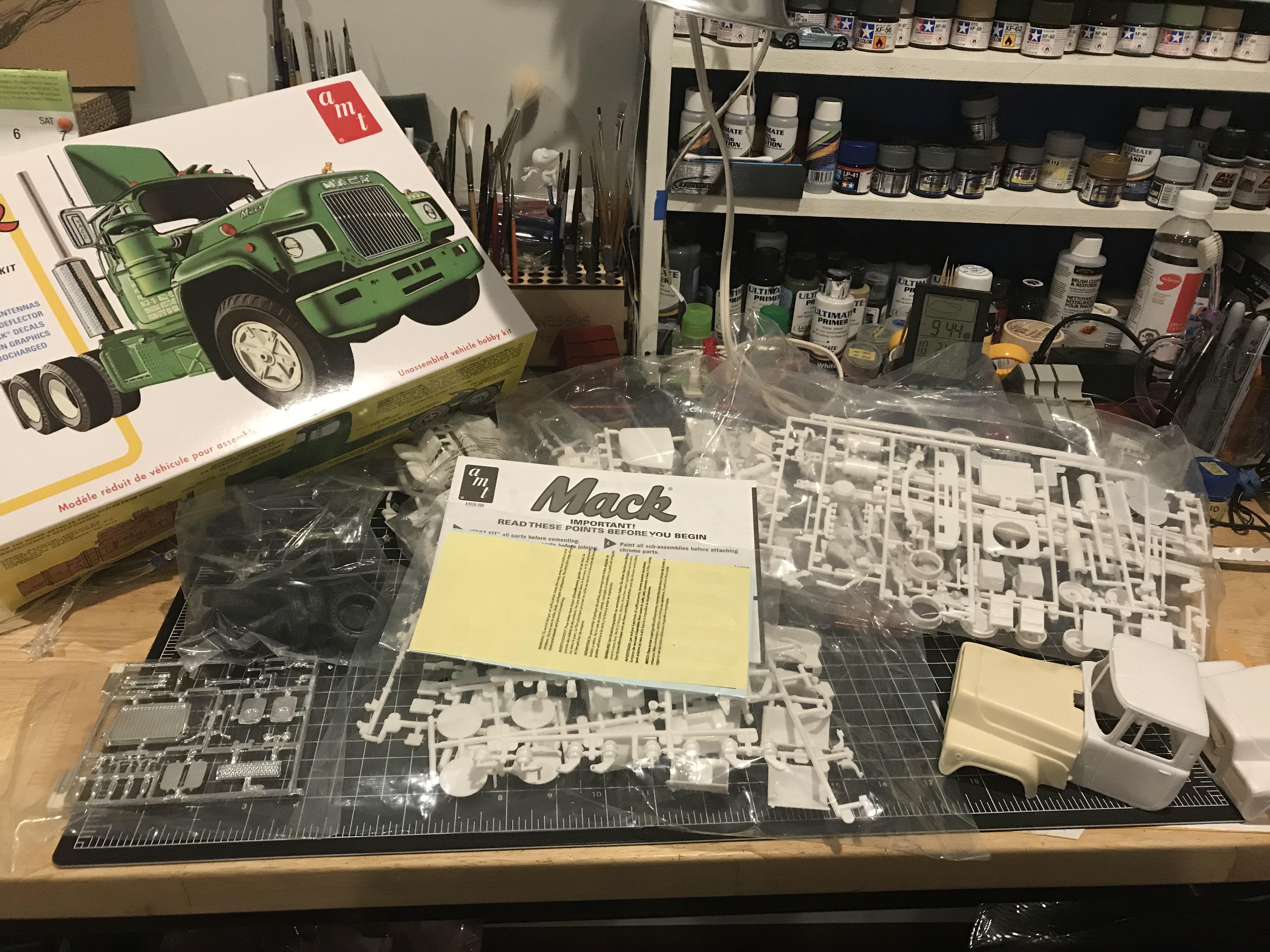

Twokidsnosleep Posted September 2, 2023 Author Posted September 2, 2023 This kit fell into my lap a couple weeks ago. Local seller, semi reasonable price, immaculate kit It came on my last day of work before a vacation so I only snapped a couple pics and poked through the box at lunch then had to leave it I am eyeballs deep at work, building a sailing ship model and doing woodwork for a ski room 4 hrs away from home…. So not likely that this will get started anytime soon 1

Force Posted September 3, 2023 Posted September 3, 2023 (edited) On 9/2/2023 at 8:04 AM, Twokidsnosleep said: This kit fell into my lap a couple weeks ago. Local seller, semi reasonable price, immaculate kit It came on my last day of work before a vacation so I only snapped a couple pics and poked through the box at lunch then had to leave it I am eyeballs deep at work, building a sailing ship model and doing woodwork for a ski room 4 hrs away from home…. So not likely that this will get started anytime soon I bought that kit back in 1978-79 a while after I had watched the movie and started to build it because I thought the movie truck was cool, but I gave up on it and it was never finished because it's so wrong, I still have all the parts in my stash after 45 years but I will most likely never finish the model. When ERTL made this kit they took the Mack truck kit they allready had, they put in a sleeper from the International 4300 and made up a few new parts for it to somewhat look like the movie truck, but they failed completely because it's so very far from what it's supposed to be. The movie truck was a Western RS700L and the model kit is a DM600 with a side shifted cab, so wrong cab, too short hood, sleeper and wheelbase, wrong wheels...well almost everything is wrong with this kit and I don't know why they ask the prices they ask for it because it's not worth much in my eyes, definately not more than a reguar DM600 kit because that's what you can build with it. The only useable parts from this kit if you want to build a correct movie truck are the air foil on the roof, the bull bar, the duck hood ornament and some of the decals, the rest is totally wrong and the AMT R600 kit is a way better starting point than this kit. Unfortunately we will most likely not see the AITM resin Rubber Duck kit anymore but that's the best one so far out there, I got that kit from Dave sometime before he passed, a Trailmobile tank body from Doug at Keystone sometime before he closed up shop, and decals from Jerry at Modeltruckin', so I have everything to do a correct replica. I just have to make the Trailmobile trailer suspension because that particular suspension used on the movie tank trailer is not available in any kit so it has to be built from scratch. Edited September 3, 2023 by Force 1

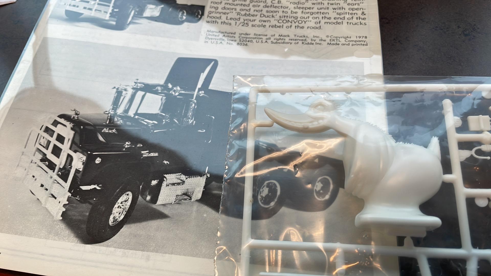

Rocketman455 Posted September 3, 2023 Posted September 3, 2023 I too was able to get one from AITM about 6 months before Dave shut down along with a set of decals. I have 2 of Ertl Rubber Duck Macks but both were missing the full size duck(something i really want). One is mint other wise and one is a builder. While completely wrong I do think the box art is kool. 1
