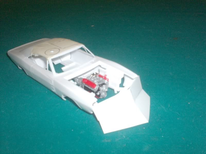

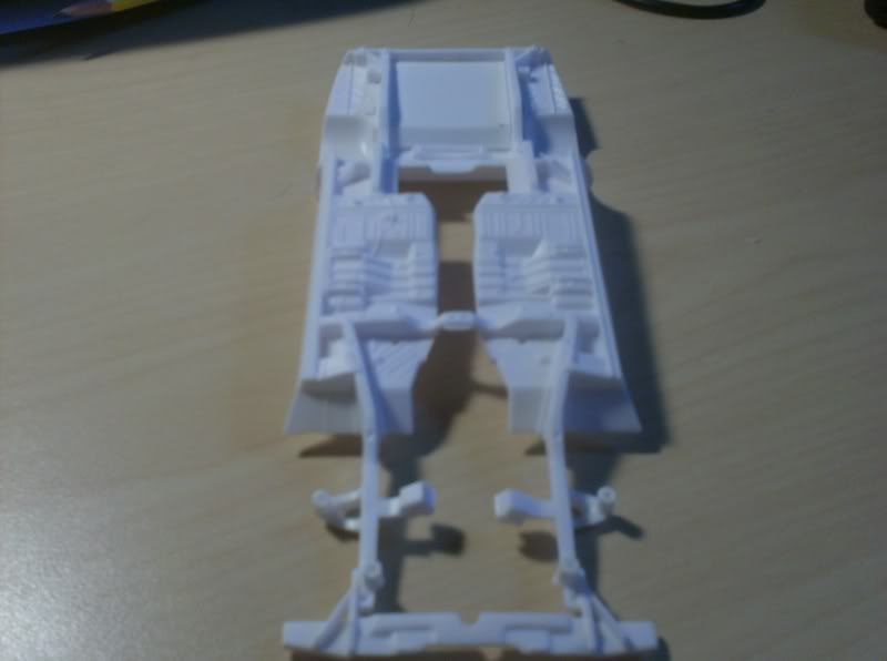

diymirage Posted September 20, 2008 Posted September 20, 2008 much like yourself i just got started on the modifying aswell the only mods i have done so far have all been on my deathracer model i opted on two different thicknesses styrene sheeting (though i forgot what the exact thicknesses were one of them was comparable to the thickness of a body panel and the other is much thinner and therefore flexable) i also went with 1/8 inch tubing for sidebars and roll cage sections like everyone said, i totally based it on the model i was building and went by that here are some reference pics of my work so you can maybe get some ideas from that here i removed the fuel tank and added some of the thicker styrene to make it look stock i chose the thicker styrene here because it only needed a very slight curve with tank with styrene the snow plow bumper is also made of the thicker styrene i cut 4 seperate sections and glued them all together (i first build a paper version so that once i had all the angles exactly the way i wanted them i had templates i could copy unto the styrene) the last thing i used the thicker styrene for was the top of the gulwing door i glued a tiny edge of the thinner styrene to part of the roof where the headliner would be and the door is basically laying on that edge. if you get the right thickness styrene it will lay flush if you do it right then i used the thinner styrene to finish up the door and block of the tront windshield in this picture i was not fully done forming the door but the thinner styrene is a little easyer to mold i used the 1/8th tubing to brace the frame and expand the roll cage they also make wicked barrels
