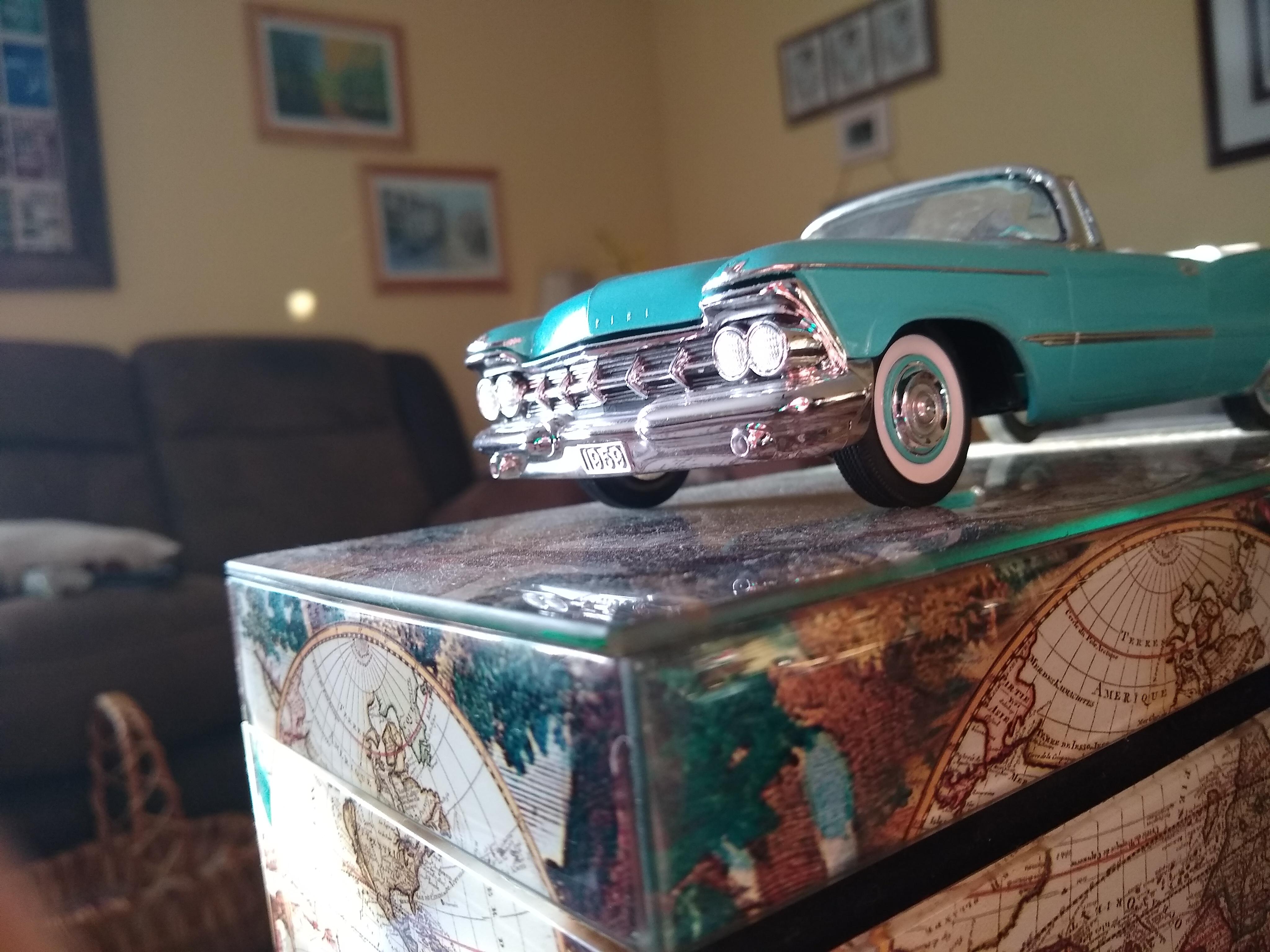

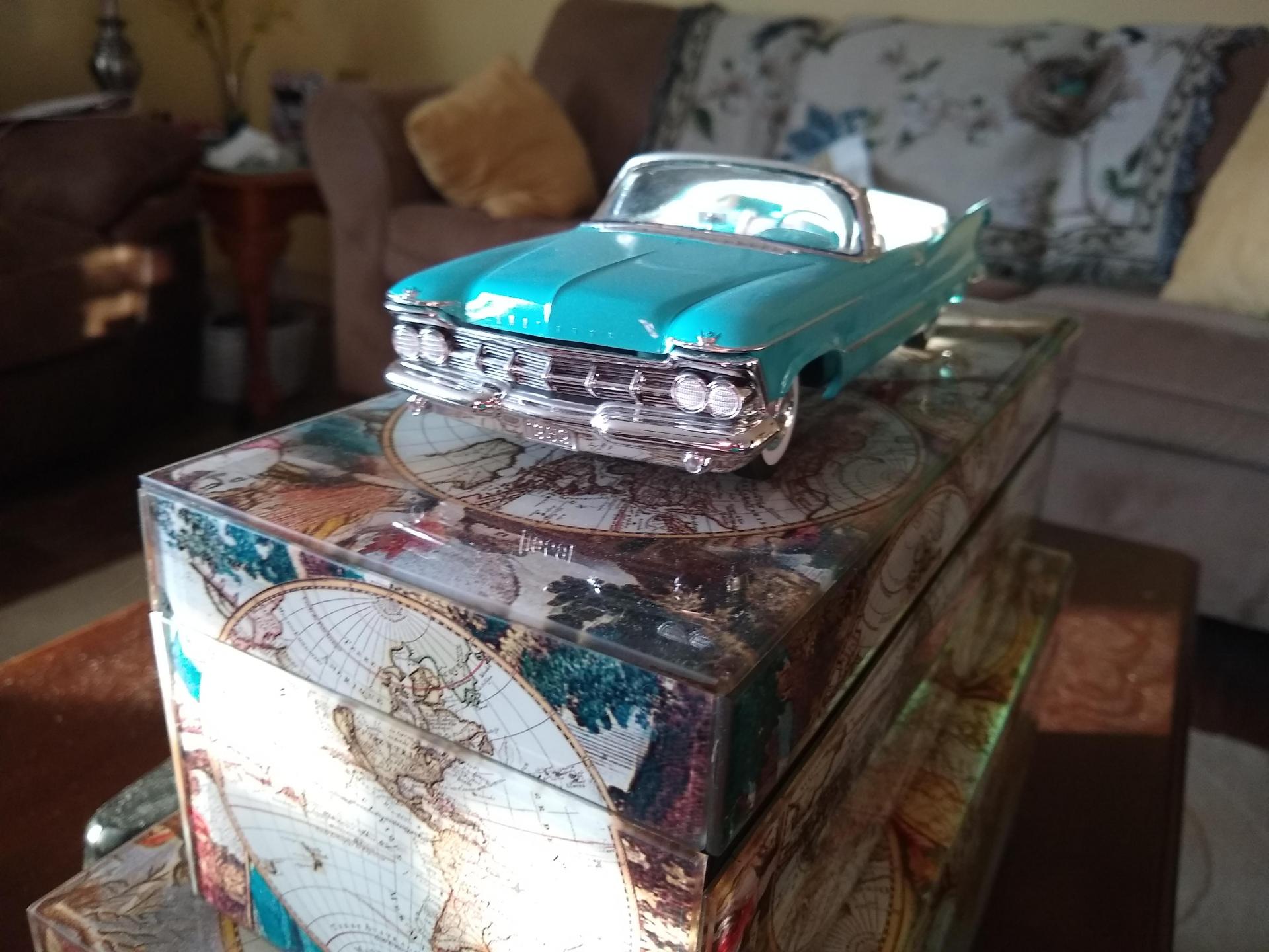

randyc Posted September 19, 2019 Posted September 19, 2019 On my current build, AMT 59 Chrysler, I tried something new. No photos but looking okay so far. I colored them in with silver sharpie. Then wiped over that to remove some of hte sharpie. Then put a dollop of Micro Krystal Kleer over that to try to make a smooth lens. I'll try to get a photo soon. I still need to run a thin black wash around them too. Anything to make them appear different from the rest of the chrome around them helps.
