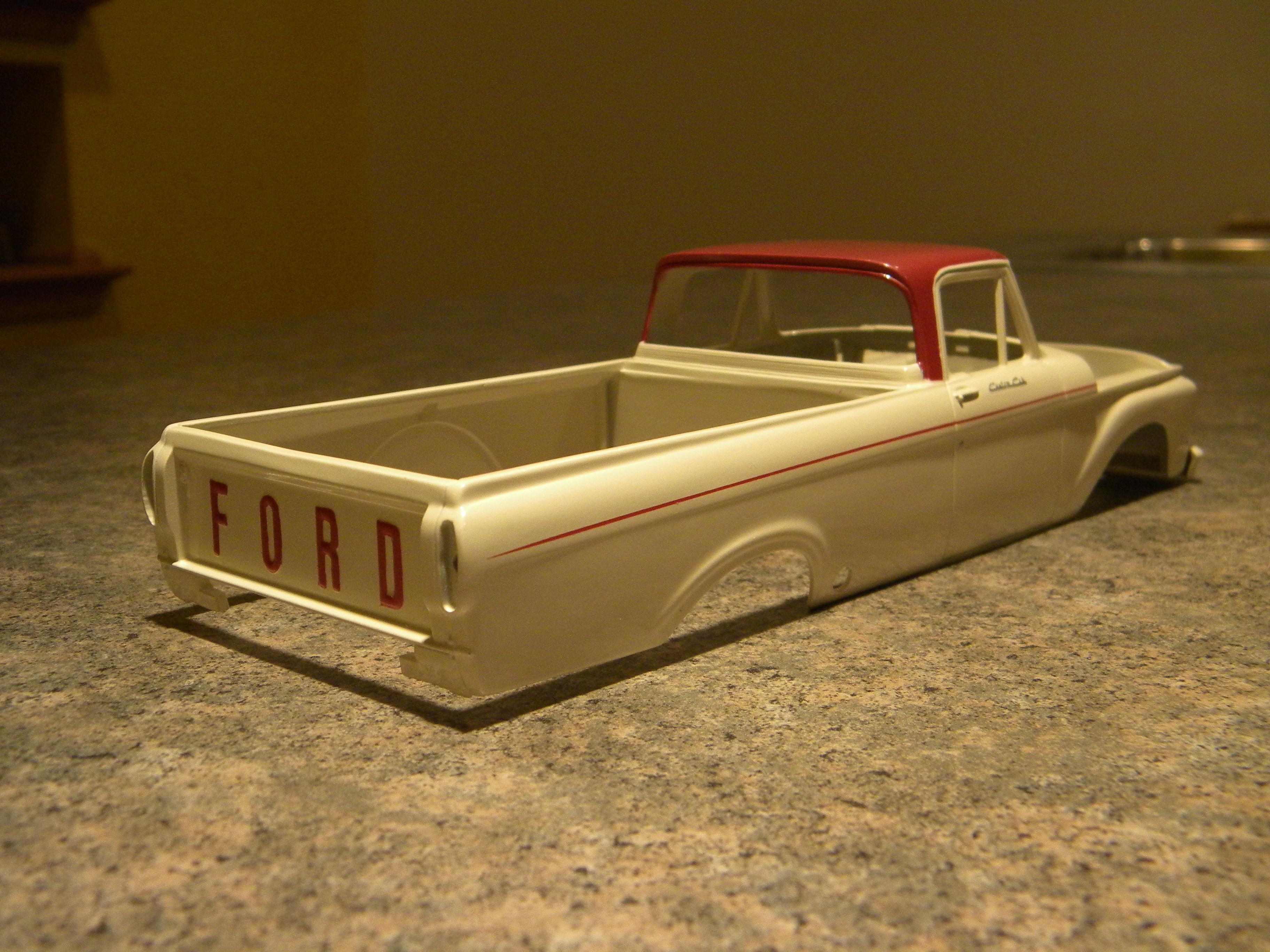

StevenGuthmiller Posted September 17, 2019 Posted September 17, 2019 43 minutes ago, Bucky said: I know some builders use Bare Metal Foil for masking, but it seems that could become expensive. I use foil occasionally, but only for small curved areas, etc. It really doesn't require a lot of foil if you are selective about where you use it. It comes in exceedingly handy for things like the Ford stamping on this Ford truck. Steve

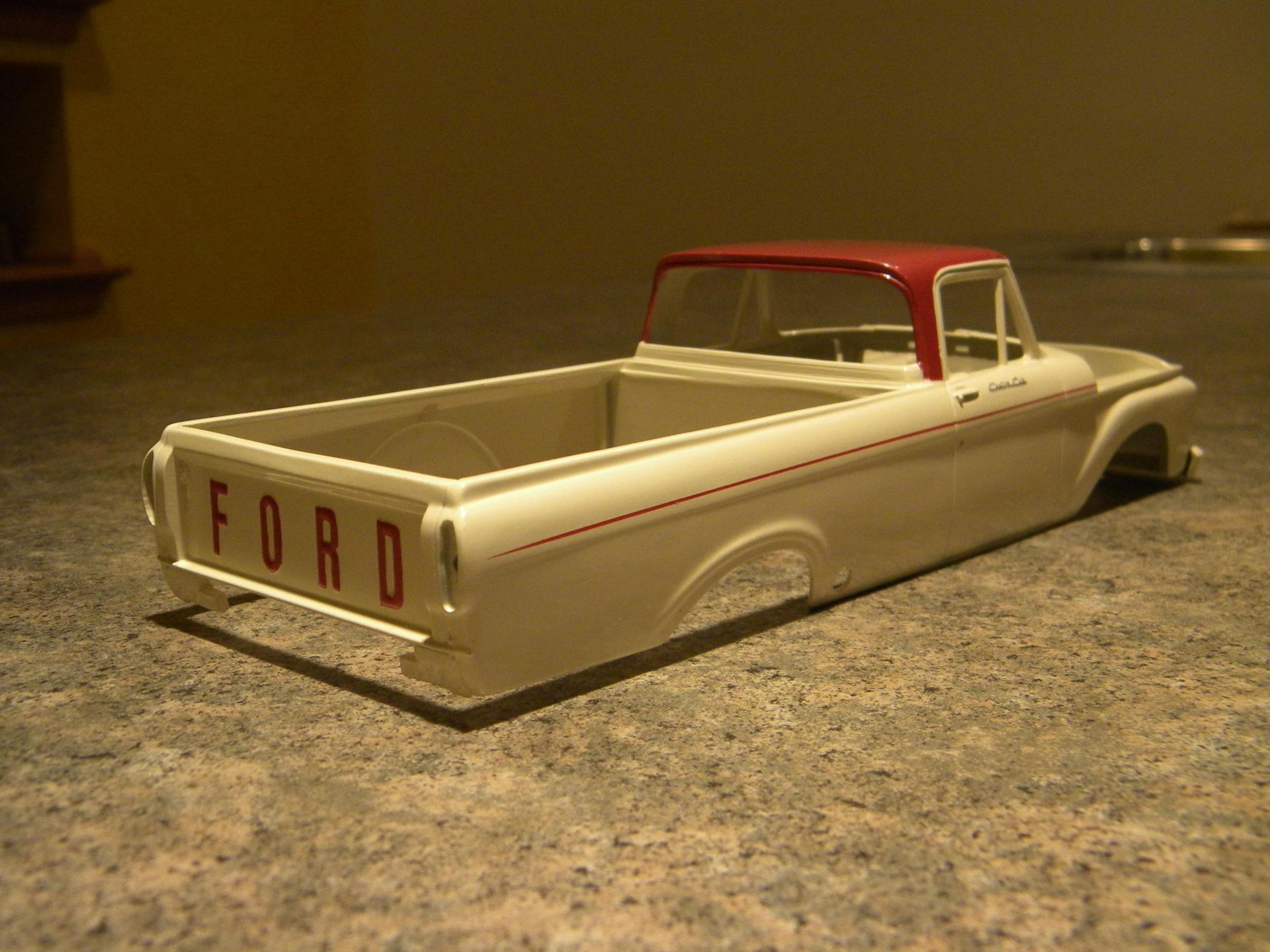

Bucky Posted September 18, 2019 Posted September 18, 2019 I used Tamiya tape for the edge of this two-tone job, both on the primer, and on the first color: After allowing one day drying time, I put the Tamiya tape down along the chrome trim between the two colors, then carefully added blue painter's tape to the edge of the Tamiya tape. Each time I sprayed a color, I pulled the tape off as soon as I could. Both colors are Tamiya colors. I had no problems at all with paint lift using this method.
