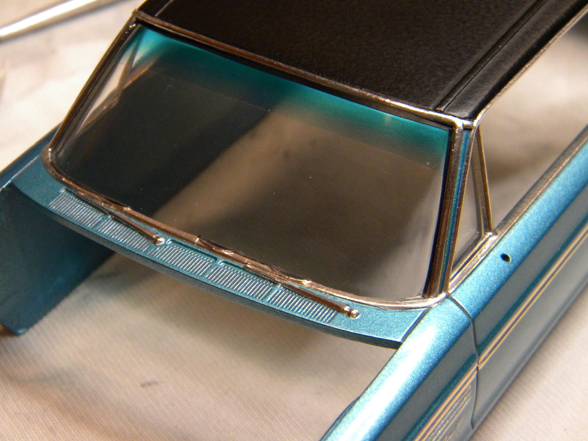

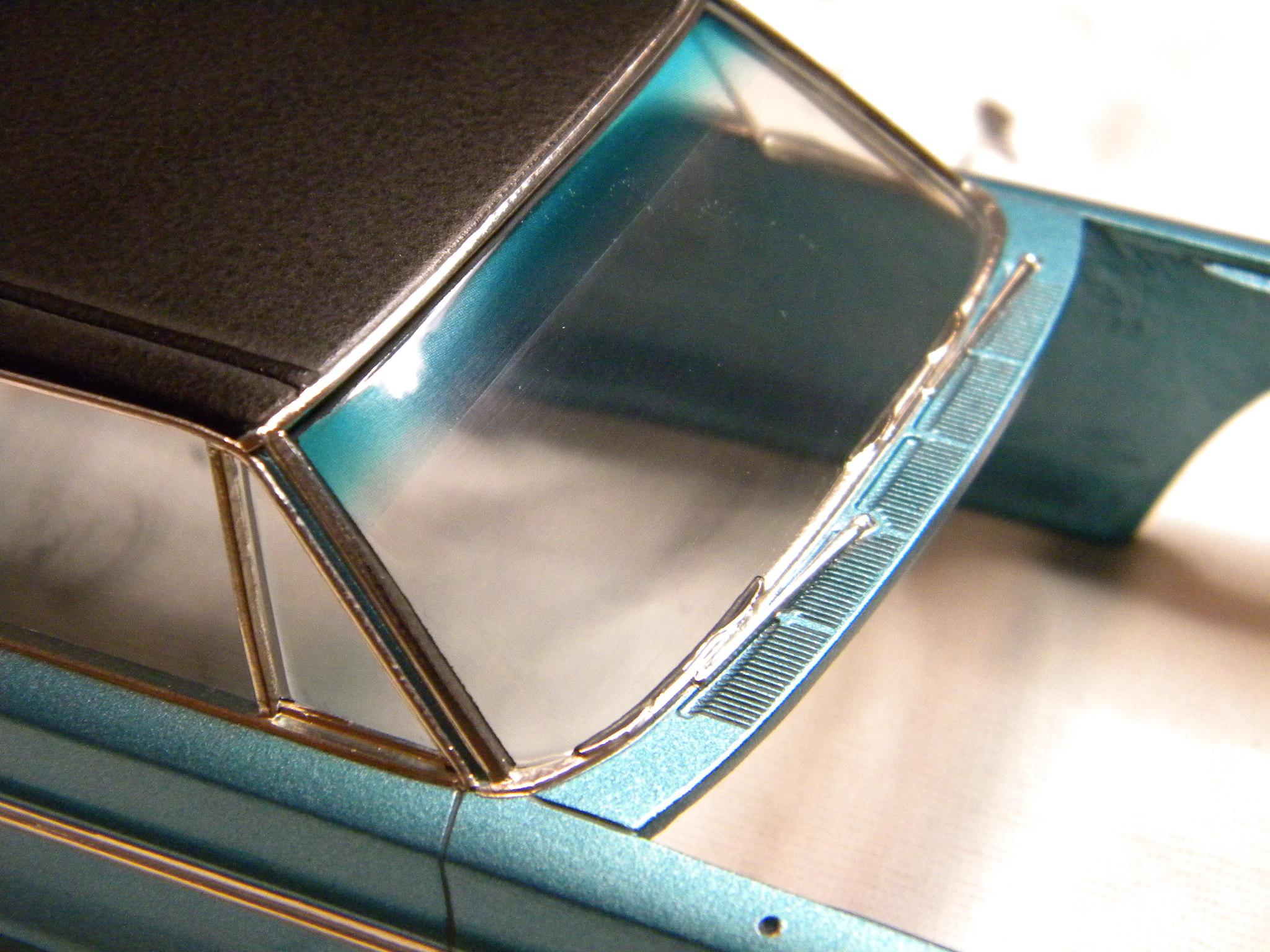

StevenGuthmiller Posted September 18, 2019 Posted September 18, 2019 I thought that this might be worth trying and so far it doesn't look too bad. It just popped into my mind to try very thin strips of electrical tape laid along the edges of the glass to replicate window seals. I don't know how long it will stick, but I thought it would be worth a try. If it fails to adhere for the duration, it will be easily removed. No harm, no foul. Steve
dmthamade Posted September 18, 2019 Posted September 18, 2019 Looks good!! Black decal material too, maybe? Check refs, sealing materials are inside the glass sometimes. On most aircraft, seal is on inside, looks "off" when applied on outside. Don
StevenGuthmiller Posted September 18, 2019 Author Posted September 18, 2019 11 minutes ago, dmthamade said: Looks good!! Black decal material too, maybe? Check refs, sealing materials are inside the glass sometimes. On most aircraft, seal is on inside, looks "off" when applied on outside. Don As far as I can tell, the seals were visible on the '65/'66 Plymouth. Hard to tell in a lot of photos, but they look pretty evident on this '66. Steve

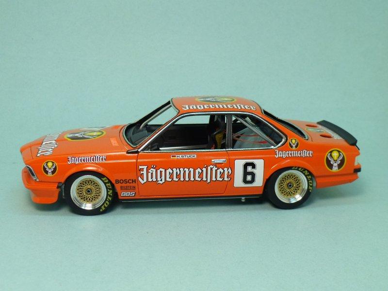

935k3 Posted September 19, 2019 Posted September 19, 2019 (edited) Try 1/64" drafting tapes. The crepe type is more flexible around bends. I used it around the BMF on the window trim on this BMW Edited September 19, 2019 by 935k3
peteski Posted September 19, 2019 Posted September 19, 2019 Drafting tape? I like that. IIRC, is paper based, and probably thinner than electrical tape. If the adhesive is stable, it is all good.
dmthamade Posted September 19, 2019 Posted September 19, 2019 (edited) Do you apply this before or after the clear coat. Just wondering if adding a sealer on top would help to stabilize and lock the tape into place. Don BTW, that BMW looks great!! Edited September 19, 2019 by dmthamade

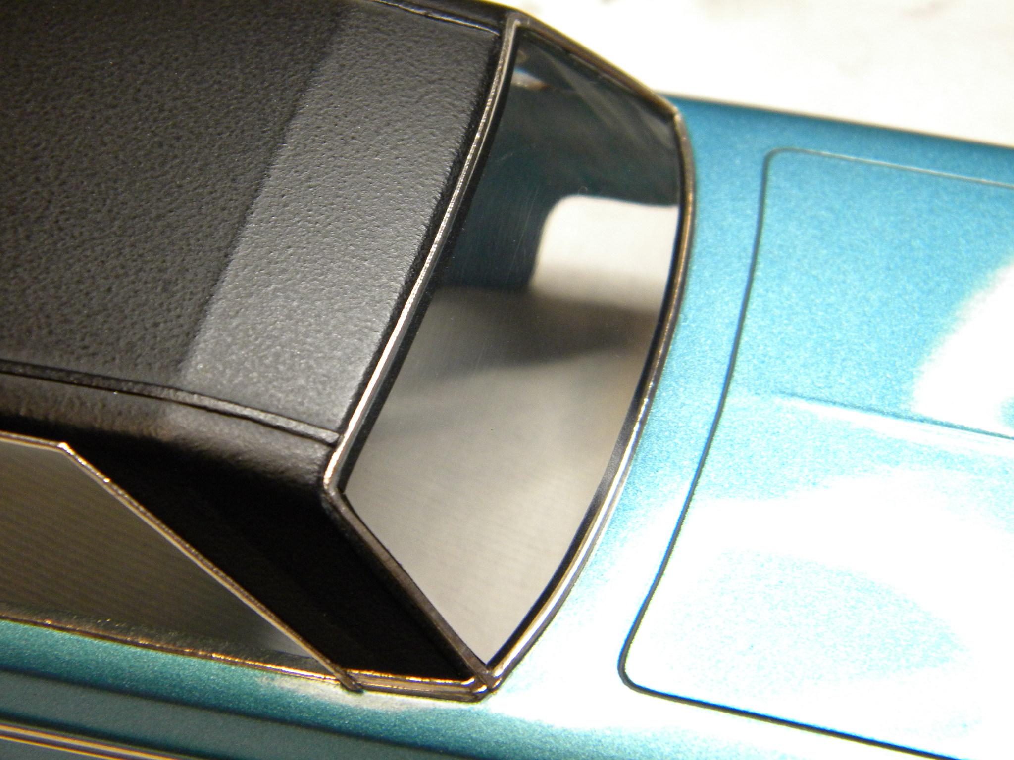

randyc Posted September 19, 2019 Posted September 19, 2019 (edited) Here's my most recent way of doing it which is completely inaccurate for real cars, but works for me. See link. I hold the glass in place and run black sharpie around the frame on the OUTSIDE of the glass. A couple coats usually gets it black enough. It turns out glossy enough to not be obviously on the outside. It's a bit wide, but I haven't been able to get it right using my smaller sharpie. This is just regular old marking sharpie with a reasonably good point. Then I can go inside glass if needed and paint back a little to get complete coverage. I just don't have the skil;s to freehand it inside the glass - always ends up shaky and/or uneven. This gives me a consistent black line around the outer edge. I have done this before paint and after foiling, but before gluing window in. If you do it after foil, you can use alcohol to clean the black off the foil. If unpainted, you can just paint over it during the paint process. So far, I'm about 3 or 4 cars into this technique and still looking for ways to improve on it. I just asked myself... how would SNAKE do this with a SHARPIE???? LOL He's my Sharpie hero. Masking, trimming and painting usually ends up incorrect or I slip and cut into glass where it shows. This works for my builds. Looks okay on shelf and that black line around the windows adds more dimension to the build. Look at photo with Chevy beside the Pontiac diecast and I think it shows the difference even a thick seal makes. That photo is a couple replies down. Edited September 19, 2019 by randyc

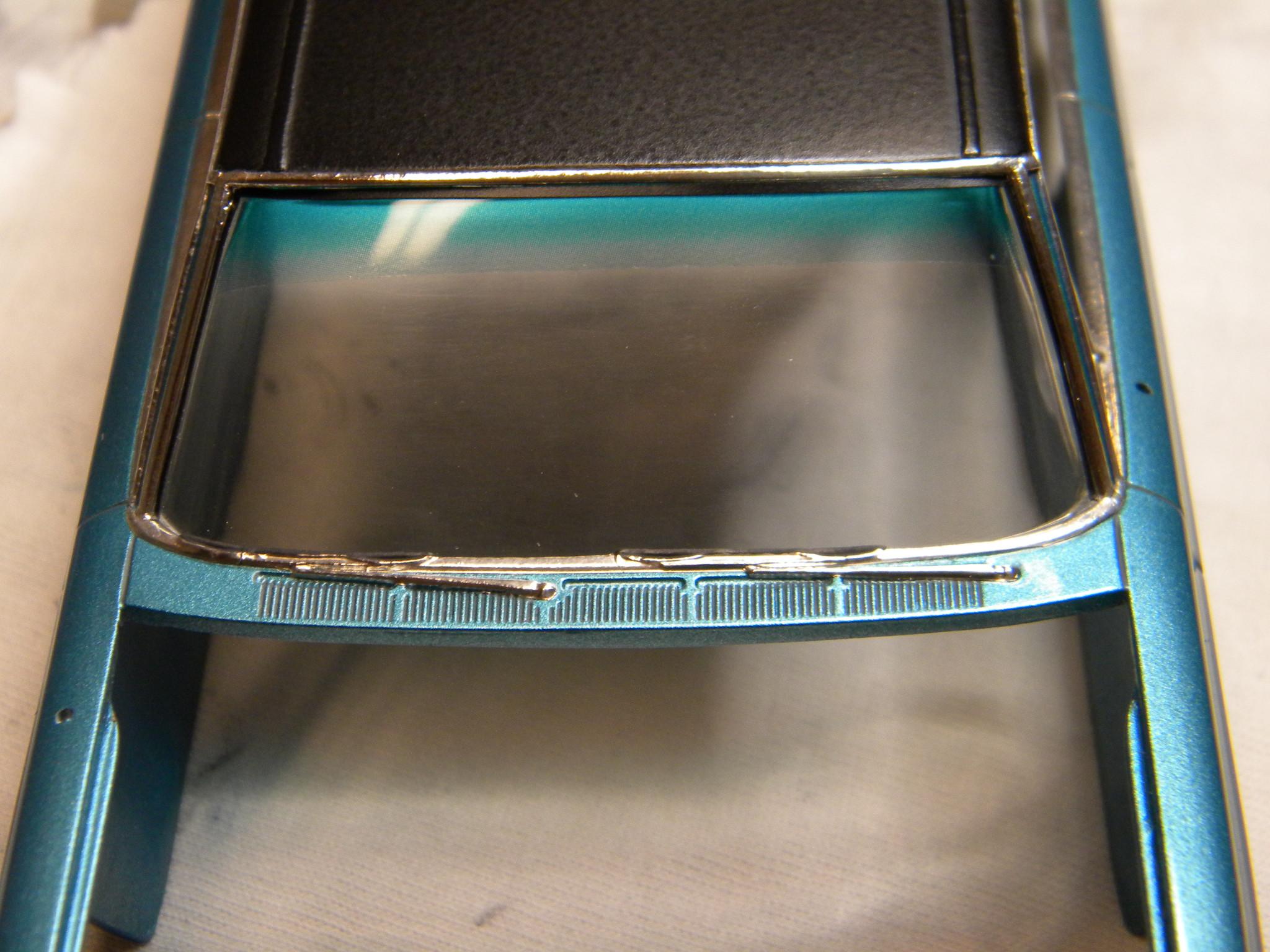

StevenGuthmiller Posted September 19, 2019 Author Posted September 19, 2019 Enough responses here got me worried about the long term viability of the electrical tape so I've already removed it and gone with masking and painting. It's really not difficult to do, but it's quite hard to see. I'm beginning to wonder if it's really even worth doing. 3 hours ago, Snake45 said: I've seen a few guys do the black window sealing on the vent windows, and IMHO that REALLY adds a lot to a model. I've even tried it myself a time or two. Some kits are easier to do this with than others. I'm going to try that as well. Steve

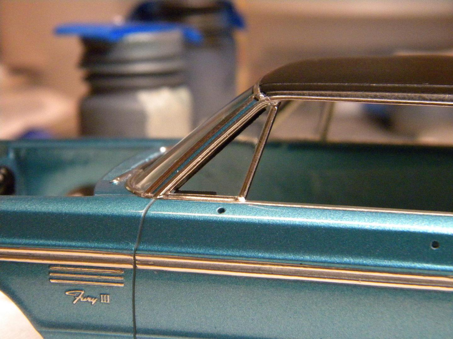

StevenGuthmiller Posted September 19, 2019 Author Posted September 19, 2019 4 hours ago, Snake45 said: I've seen a few guys do the black window sealing on the vent windows, and IMHO that REALLY adds a lot to a model. I've even tried it myself a time or two. Some kits are easier to do this with than others. I do like the look of this Snake. I just did the front edge and half of the lower edge where the rubber would be on the outside. Steve
