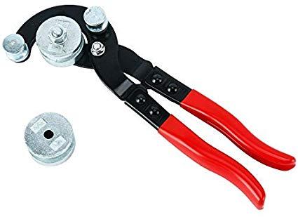

kitbash1 Posted October 4, 2019 Posted October 4, 2019 You can get one of these Brake line tube benders from Amazon for $20 online. I have one and it works fine for bending all types of metal tube.
