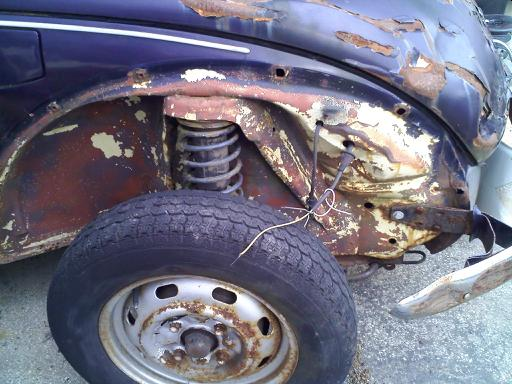

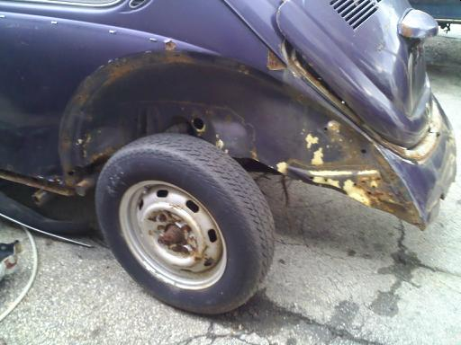

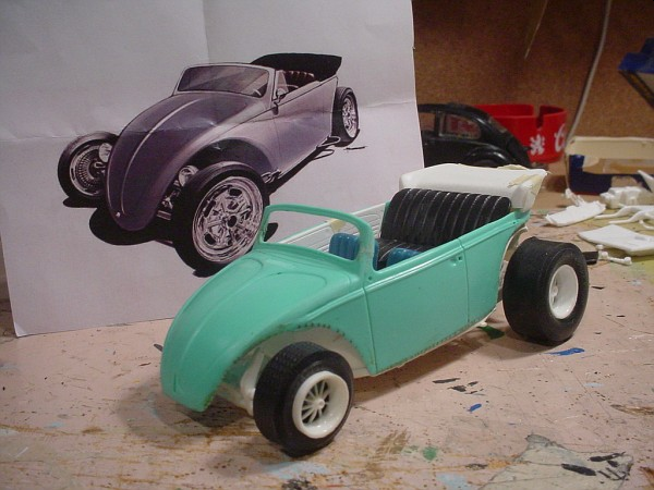

Tom Geiger Posted October 22, 2019 Posted October 22, 2019 Here's a couple of photos I took many years ago just for this same reason. and here's something I was playing with a bunch o' years ago...
Atmobil Posted October 22, 2019 Posted October 22, 2019 If you are planning a volksrod project, remember that you should move the front axle forwards by stretching the front og the floorpan. The inner fenders on a torsionbar front bug is very simple, the picture poster by Tom over here is of a SuperBeetle with macpherson struts up front. I would claim that the best bet is either the tamiya 66 or hasegawa 66 or 67 (same kits but with different body) or the gunze 56 oval. Old tool revell 1:25 could also work fine and that comes with hop up engine parts in the box.
OldTrucker Posted October 22, 2019 Posted October 22, 2019 (edited) 8 hours ago, Tom Geiger said: Here's a couple of photos I took many years ago just for this same reason. and here's something I was playing with a bunch o' years ago... Tom, that is the latter Super Beetle that had a strut front suspension. I hated those things!!!LOL Edited October 22, 2019 by OldTrucker

cobraman Posted October 23, 2019 Author Posted October 23, 2019 That's pretty much what I was thinking of building. Maybe I can find some plastic spoons or something like that to make those inner panels ?????

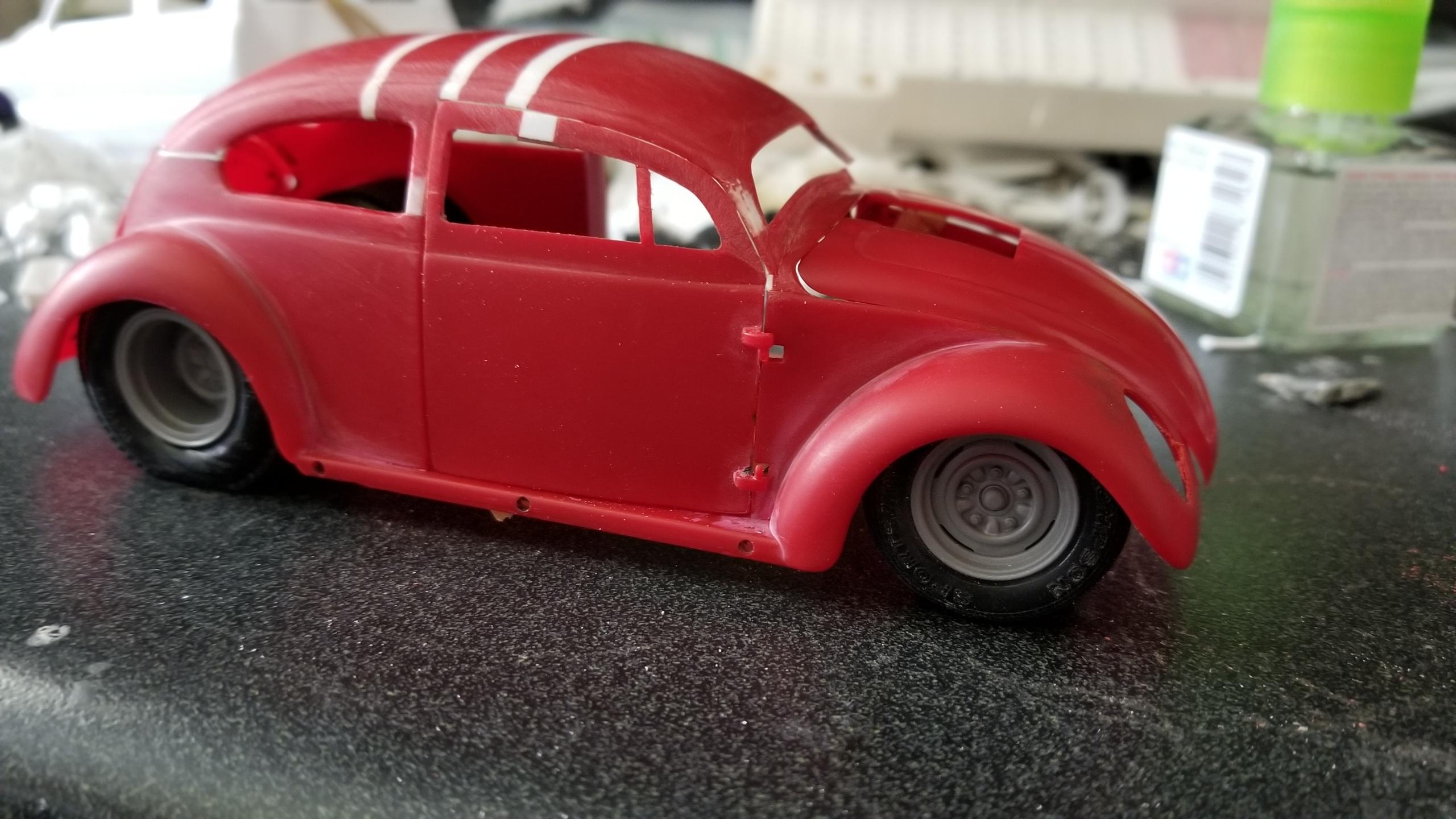

Jon Cole Posted October 23, 2019 Posted October 23, 2019 On 10/21/2019 at 7:56 PM, Dave Van said: Just cut them off!!!!! old tool Revell Dave, that would make any Vee Dub fan proud to call their own!
