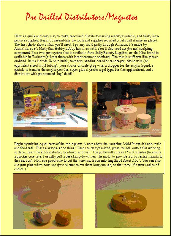

SfanGoch Posted November 6, 2019 Posted November 6, 2019 This method by Ray Ferguson (BigTallDad) is an excellent way to do it:
Nitrobarry Posted November 6, 2019 Author Posted November 6, 2019 Thanks for this. The Photo bucket images are fuzzy but I get the gist of the method.
Straightliner59 Posted November 6, 2019 Posted November 6, 2019 I have posted this tutorial in several places, online, including this forum. I can't understand why so many guys are so set on drilling tiny holes in their distributor caps. This method is inexpensive, uses readily available materials, and works GREAT! I've been using it since the mid-'80s, or so, since Don Fahrni developed the technique.

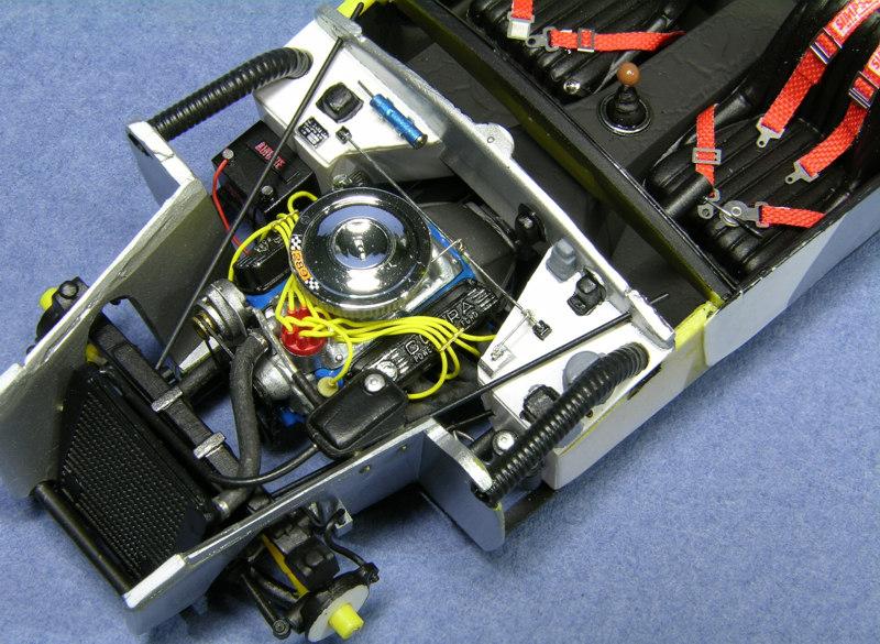

afx Posted November 7, 2019 Posted November 7, 2019 (edited) Norm also offers a 4-cylinder version. Edited November 7, 2019 by afx
Tom Geiger Posted November 7, 2019 Posted November 7, 2019 I have Norm's distributors and the early ones weren't marked for which wires to use. I figured out it was the Detail Master wire, which is a very thin wire and thinner than most other brands.
afx Posted November 7, 2019 Posted November 7, 2019 I use wrapping wire I got from Radio Shack when they were in business. It is a tight fit on Norm's distributors but it does work.
Casey Posted November 7, 2019 Posted November 7, 2019 16 hours ago, Straightliner59 said: I have posted this tutorial in several places, online, including this forum. I can't understand why so many guys are so set on drilling tiny holes in their distributor caps. This method is inexpensive, uses readily available materials, and works GREAT! I've been using it since the mid-'80s, or so, since Don Fahrni developed the technique. This is one of the better methods for including the distributor end boots, which are very often overlooked, and always noticeable in their absence. Getting all nine boots cut squarely and to the exact same length seems to be the most challenging part.
Straightliner59 Posted November 7, 2019 Posted November 7, 2019 1 hour ago, Casey said: This is one of the better methods for including the distributor end boots, which are very often overlooked, and always noticeable in their absence. Getting all nine boots cut squarely and to the exact same length seems to be the most challenging part. I usually lay out a piece of masking tape, and just start cutting, until I have way too many, then I use the best ones.
SfanGoch Posted November 7, 2019 Posted November 7, 2019 19 hours ago, Straightliner59 said: I have posted this tutorial in several places, online, including this forum. I can't understand why so many guys are so set on drilling tiny holes in their distributor caps. This method is inexpensive, uses readily available materials, and works GREAT! I've been using it since the mid-'80s, or so, since Don Fahrni developed the technique. You're absolutely right. My omission. Pretty beat when posting my reply yesterday.
Straightliner59 Posted November 8, 2019 Posted November 8, 2019 4 hours ago, SfanGoch said: You're absolutely right. My omission. Pretty beat when posting my reply yesterday. I can see how it happens. There's so much information, on here, that there's no way we can remember all of it! Add fatigue into the equation...yeah!
randyc Posted November 8, 2019 Posted November 8, 2019 Could you poke the wires all the way through the mold before casting and have the distributor wired when it comes out of the mold? I gave up wiring engines a while back. Occurs to me that my models never leave the house and people that see my cars may not even know what a plug wire is. And I rarely marvel over the engine after I build the kit. I do have a few prewireds that I bought years ago. Just in case. One thought I have is to make sure you have a reasonably good set of bits though. I have *most* of a set of Kona bits that work well. I bought a $5 set on ebay. The points are useless on those. they walk, they don't drill. Basically can be used to clear out holes that already exist. Interesting tutorial though
Straightliner59 Posted November 8, 2019 Posted November 8, 2019 40 minutes ago, randyc said: Could you poke the wires all the way through the mold before casting and have the distributor wired when it comes out of the mold? I have never tried that, but, it seems feasible. I would probably use a release agent, on the wire, as a precaution. I agree about good bits.

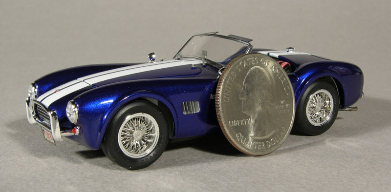

peteski Posted November 11, 2019 Posted November 11, 2019 (edited) This is a Monogram Ultimates 1:43 scale 2879 Cobra. I drilled out the model's distributor using a PC Board drill bit (those are very sharp Tungsten Carbide bits with 1/8" shanks) held in a pin vise. Those bits are very fragile (but I have large supply at hand). This type of very small and precise work I do under magnification. I use a stereo-microscope (aka. a dissecting microscope). 1:43 scale distributor is quite small. Edited November 11, 2019 by peteski

peteski Posted November 13, 2019 Posted November 13, 2019 18 hours ago, Bainford said: 1/43, eh? That's some mighty clean and impressive detailing! Thanks! I'm quite happy with the way it turned out. I did bunch of scratchbuilding to add more details to that already nice kit. That was last automotive model I built (few years back). I have bunch of photos of it (in progress, and finished). Someday I'll post it in the Under Glass section.

Tommy124 Posted November 13, 2019 Posted November 13, 2019 5 hours ago, peteski said: Thanks! I'm quite happy with the way it turned out. I did bunch of scratchbuilding to add more details to that already nice kit. That was last automotive model I built (few years back). I have bunch of photos of it (in progress, and finished). Someday I'll post it in the Under Glass section. Wow - what a HUGE coin! Very nice model... I have both of the Monogram Ultimate 1/43 scale kits (Cobra and '67 Corvette). Did the Vette back in 1990 when those kits were just released and it looked okay with the PE parts for the exhaust etc. Some years later on, I took the chance when both kits were on sale real cheap. I guess 1/43 scale still is more of a collector's than a builder's scale. Though there are some fine kits out there. Long story short, if I build mine one day, I'd be happy if it would turn out somewhere near as good as yours!
