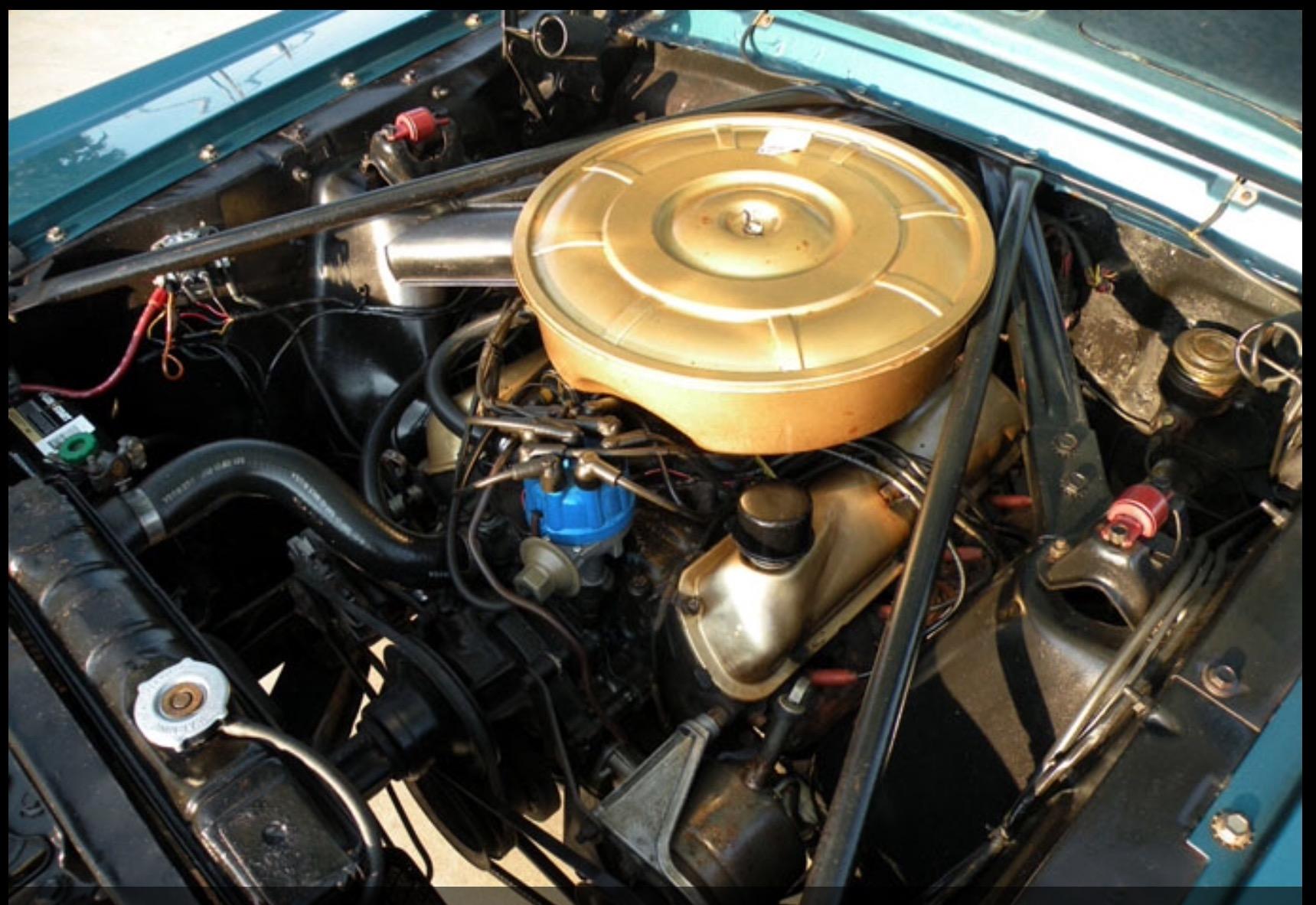

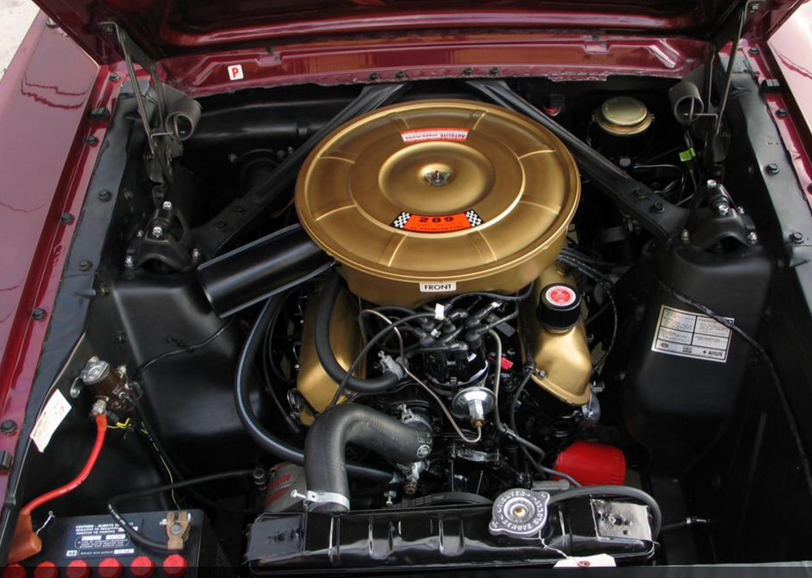

vamach1 Posted November 8, 2019 Posted November 8, 2019 (edited) 1 hour ago, hpiguy said: I'm going to be building a larger scale Mustang 289 V8. The block is clear but I want to paint the oil pan and air cleaner which are cast in silver plastic. On some cars I google see the air cleaner is chrome with the 289 decal, some all blue with the 289 decal. Also, on some the oil pan is black, on some it is Ford blue. Any consensus on which is most 'correct'? If not I'll just wing it and do blue oil pan and chrome air cleaner.Thanks! To the surprise of many the block and everything but the valve covers and air cleaner are black. The rest is gold. Only the hipo engines had the chrome air cleaner and valve covers. So even 65 Shelby engine should be black. Ford blue was not used until 1966. Needless to say there are many restored cars out there that are incorrect as people assume the corporate blue was used from day one. 1 hour ago, hpiguy said: 1 hour ago, hpiguy said: Edited November 8, 2019 by vamach1
vamach1 Posted November 8, 2019 Posted November 8, 2019 Air cleaner decal. The hipo would have chrome valve covers and Shelbys had the cast ones.
