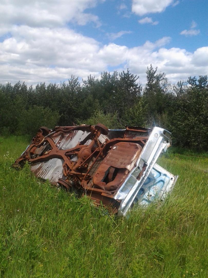

mk11 Posted November 10, 2019 Posted November 10, 2019 Here's a, um, retired '64 laurentian Even with north of the border cars using the '58-'64 chevy x-frame, underbody priming practices were probably similar.
Deuces Posted November 10, 2019 Posted November 10, 2019 2 hours ago, mk11 said: Here's a, um, retired '64 laurentian Even with north of the border cars using the '58-'64 chevy x-frame, underbody priming practices were probably similar. Must have taken 20 or so people to roll that one over......??
