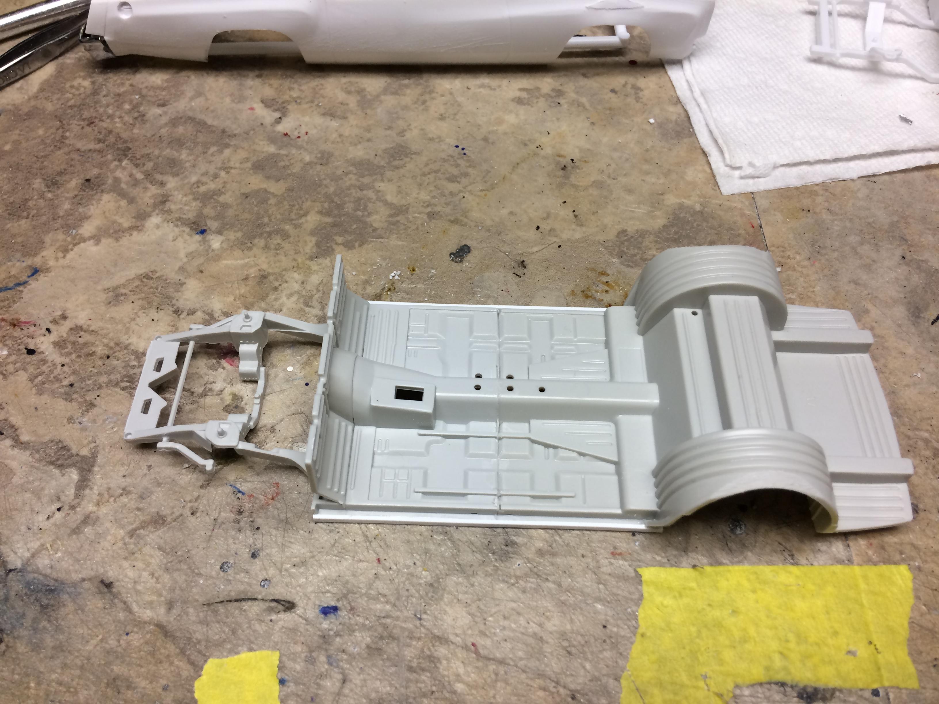

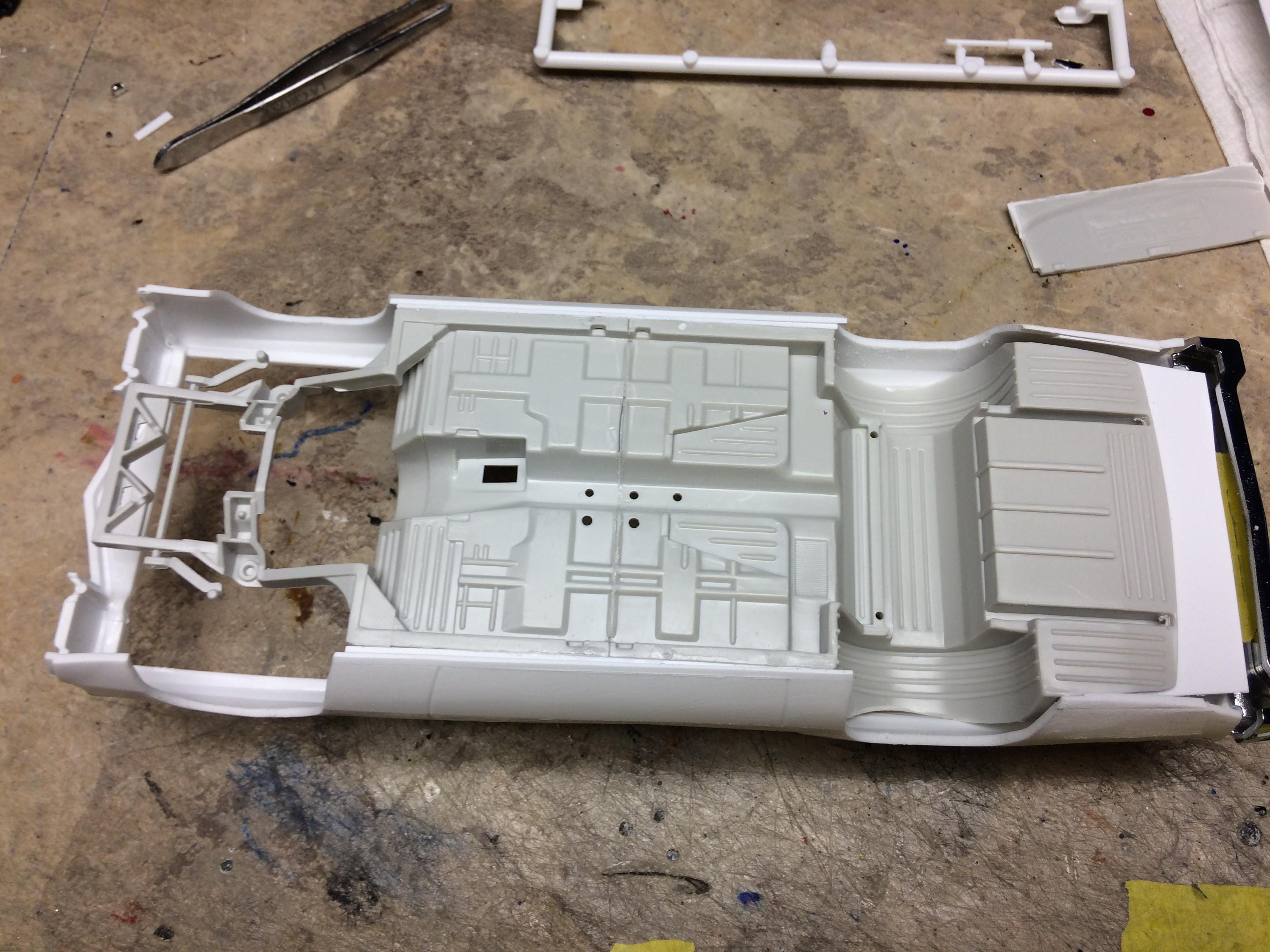

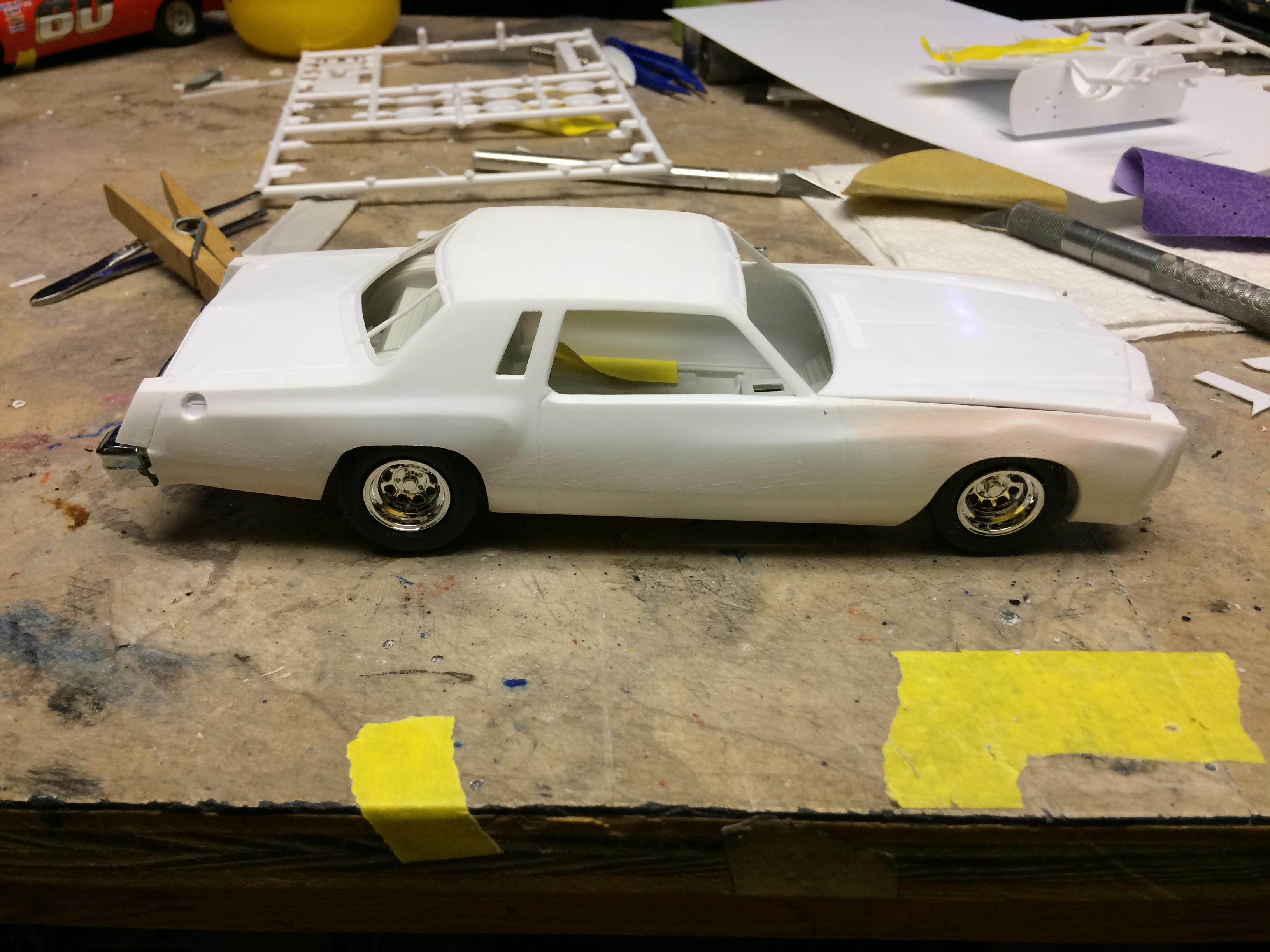

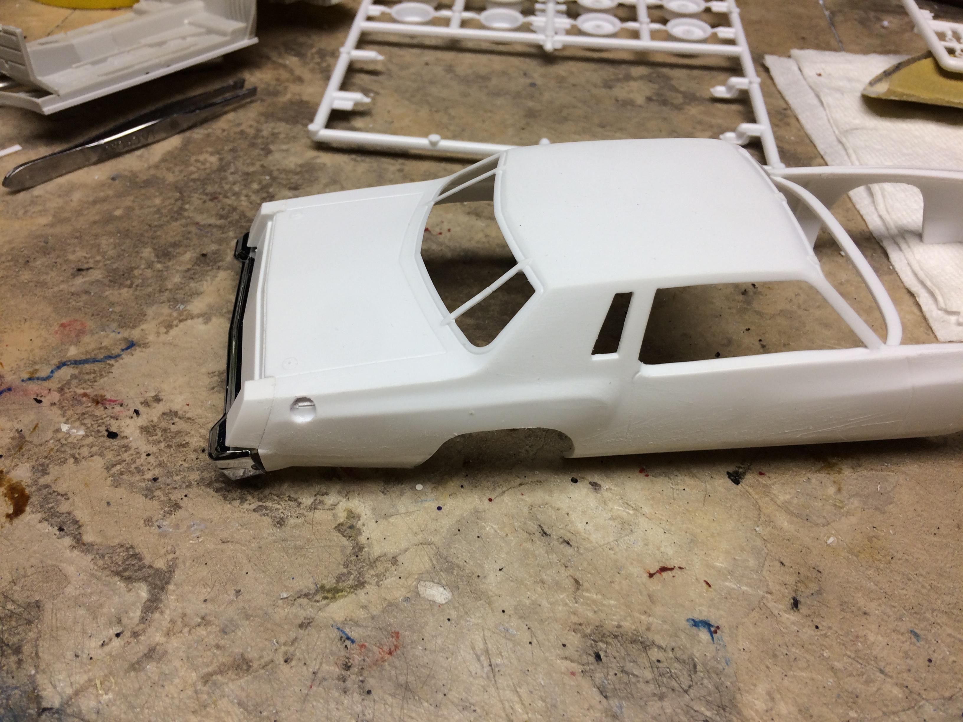

yellowsportwagon Posted November 11, 2019 Posted November 11, 2019 So this started as s Salvinos Baker Monte Carlo kit. I planned on modding the body a little and building it mostly out of the box. Well things changed quickly. I mocked up the kit chassis and said”I really don’t like the looks of this chassis.” So I looked at my old standby AMT TBird chassis. The way I usually stretch them didn’t look like an option. So I cut two in half in the middle and stretched it that way. Good thing I had a spare bare chassis laying around.

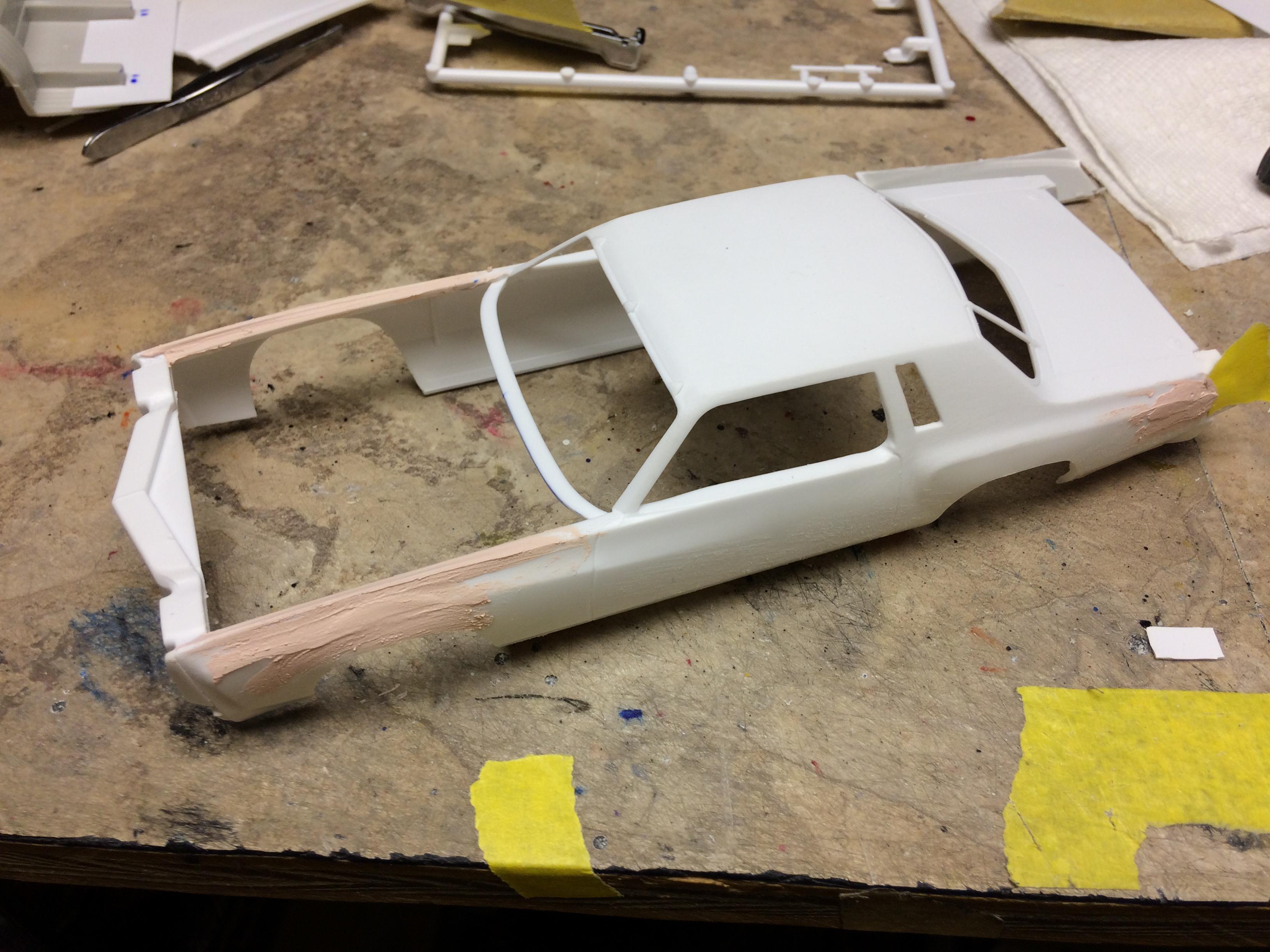

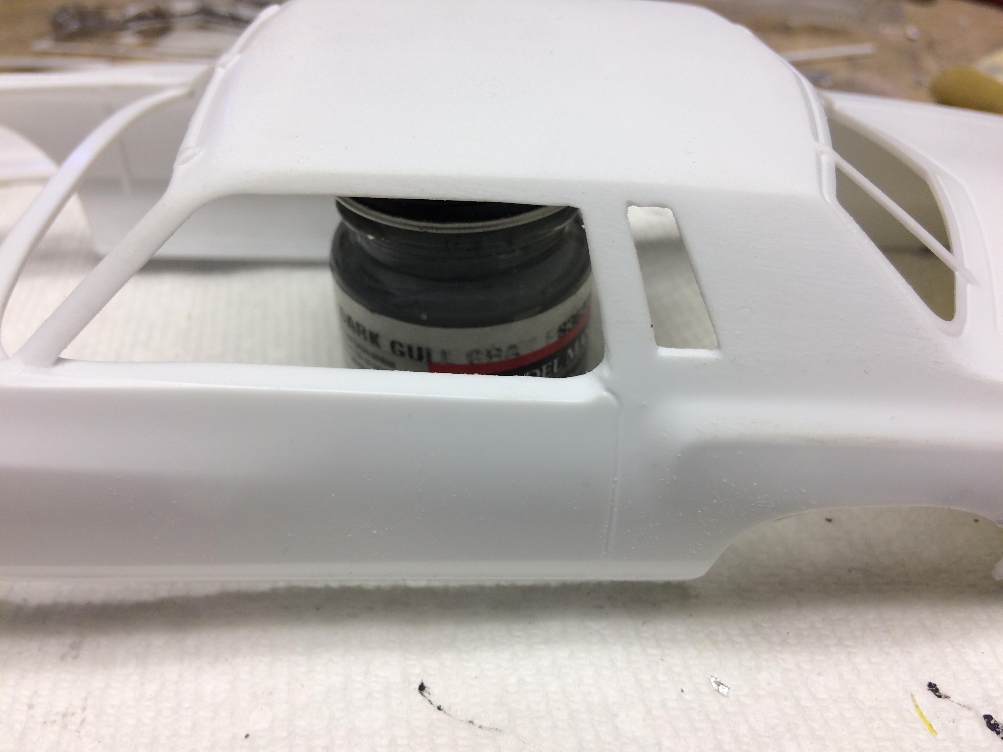

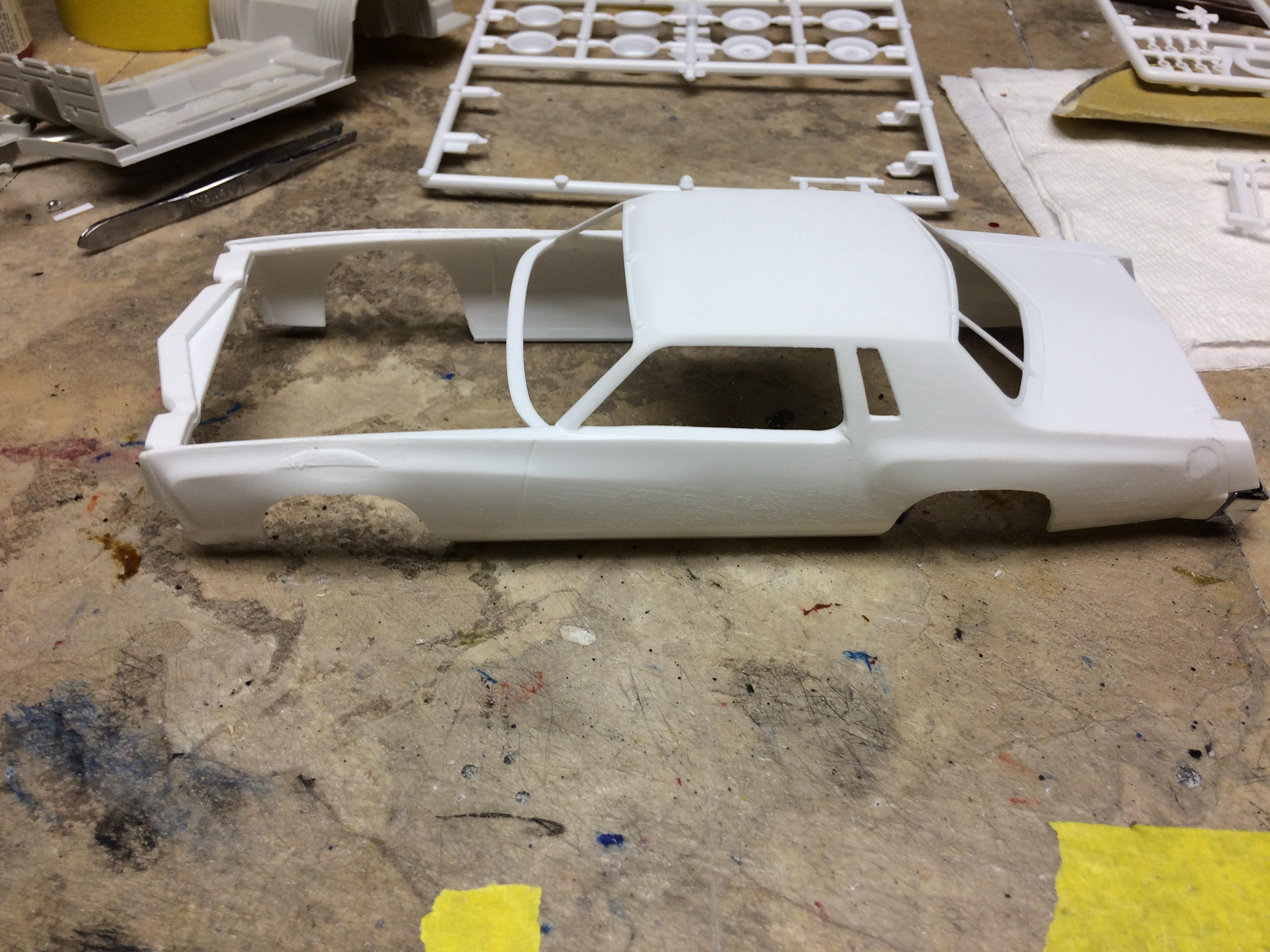

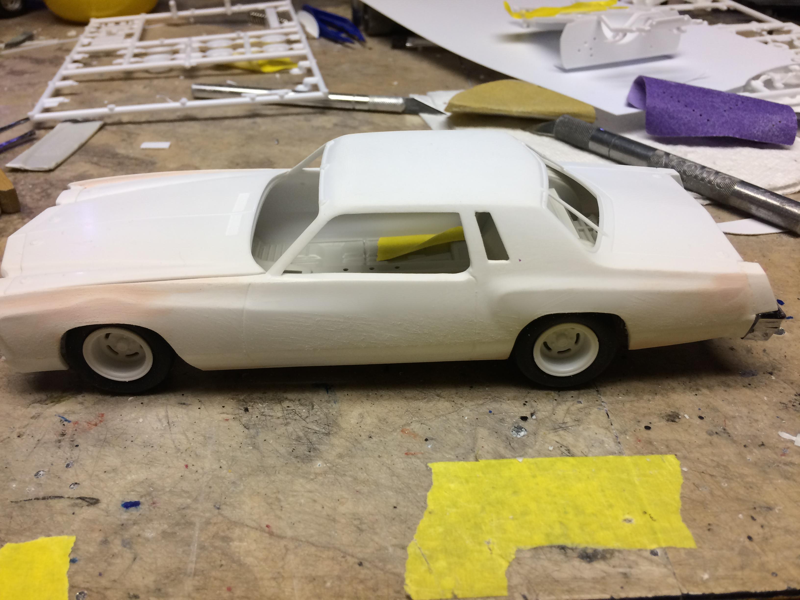

yellowsportwagon Posted November 11, 2019 Author Posted November 11, 2019 On to the body. This body never looked right to me. Most of its faults looked to be a sanding block away from correcting though. First is the side window area. I brought the door window opening up to be even with the opera window. Next I brought the back of the door window opening back to be even with the door crease. Leaving a swoop forward at the bottom like these cars had.
yellowsportwagon Posted November 11, 2019 Author Posted November 11, 2019 Next I sanded the top of the roof thinner above the door and opera windows. It was going up hill. Also the bodylines marked by my tape went uphill. I sanded them till they met my tapeline.

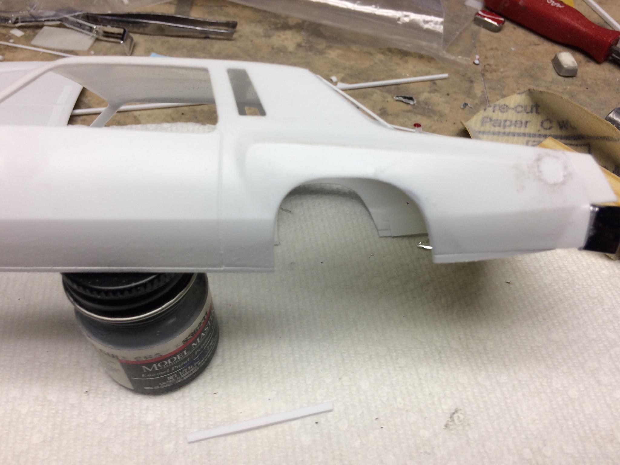

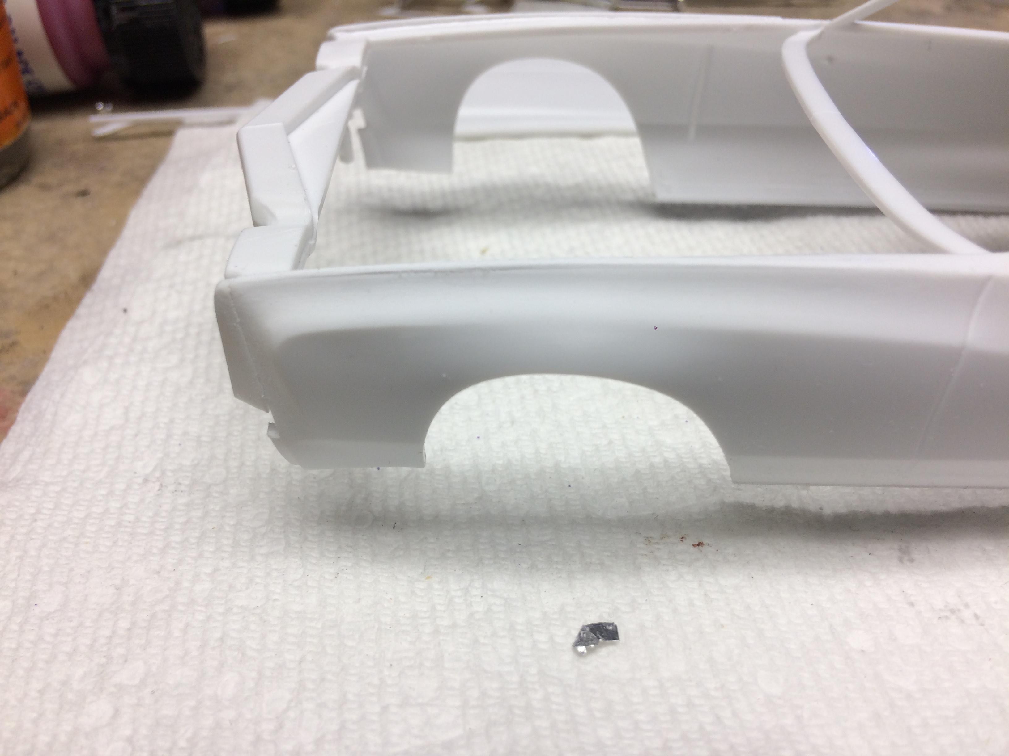

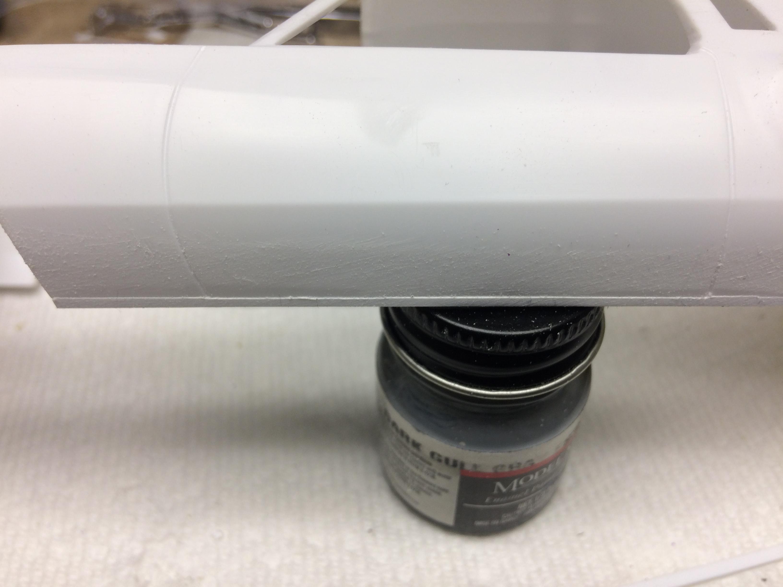

yellowsportwagon Posted November 11, 2019 Author Posted November 11, 2019 Now I added a strip of plastic to the bottom of the qtr behind the tire. I felt this area was too narrow top to bottom. Added a strip under the main body too. These cars had a small rocker panel that was missing on the Model. Also filled the fuel fill. Will be moved to the other side per road race car.

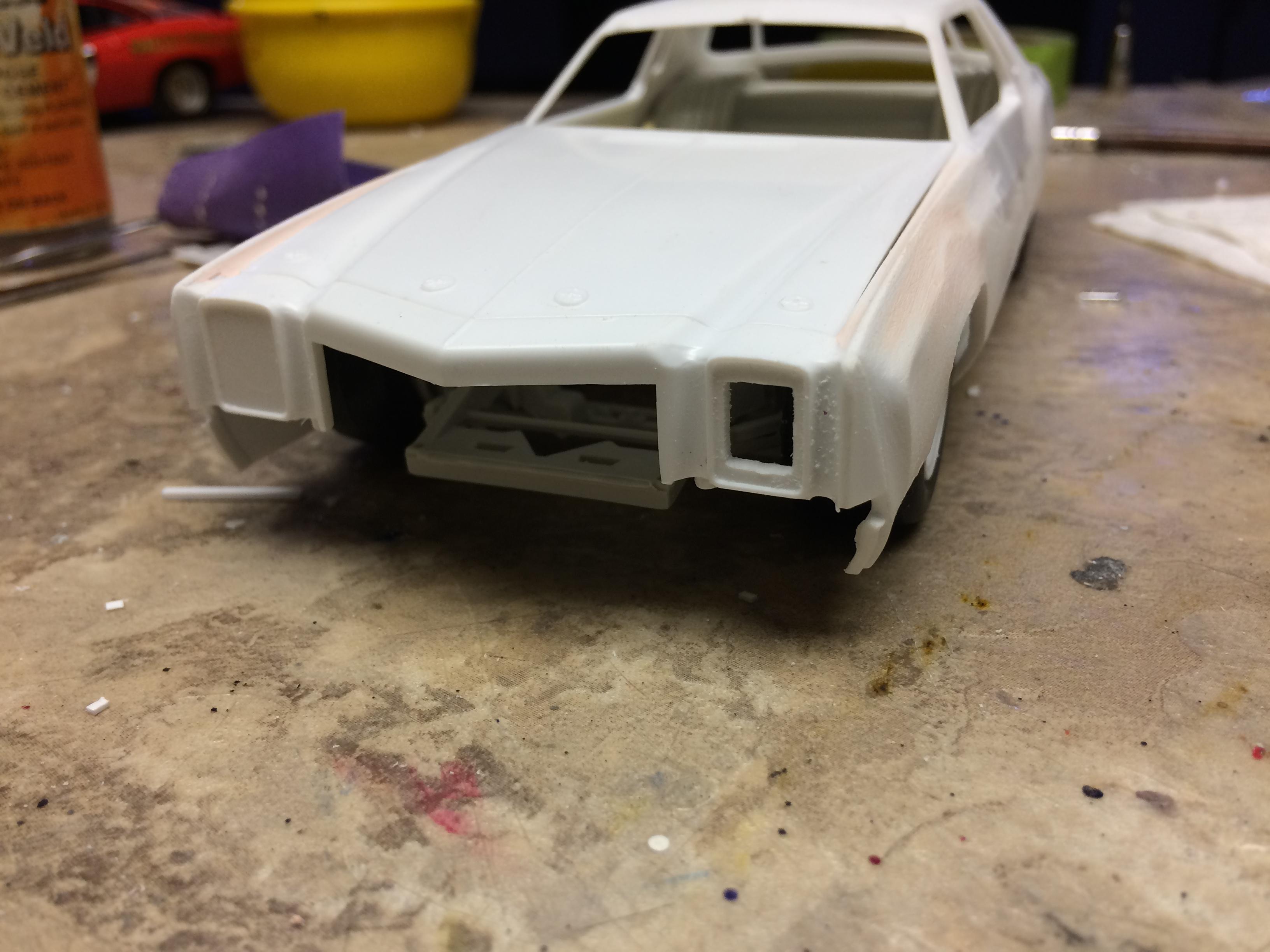

yellowsportwagon Posted November 11, 2019 Author Posted November 11, 2019 Next I reshaped the frt fenders by bending the nose down slightly. Added a strip to the top edge of the fender. Tapered it in to give the fender more arch. Also reshaped the scallops to bring the frt of them lower. Giving them more arch too.
yellowsportwagon Posted November 11, 2019 Author Posted November 11, 2019 Now added bits of plastic to the fenders too replicate the bulges put in them for tire clearance. Added fuel fill to passenger side.

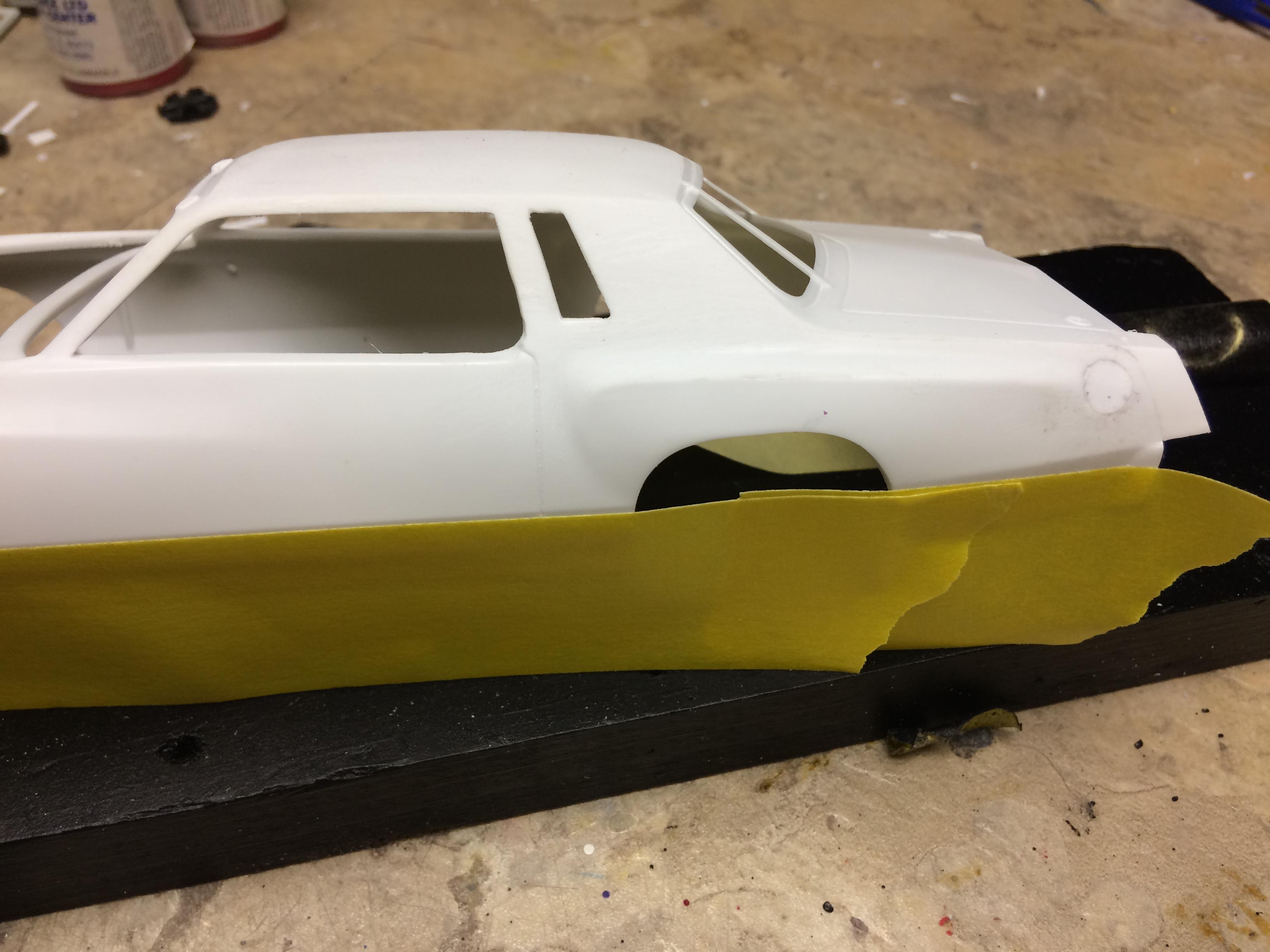

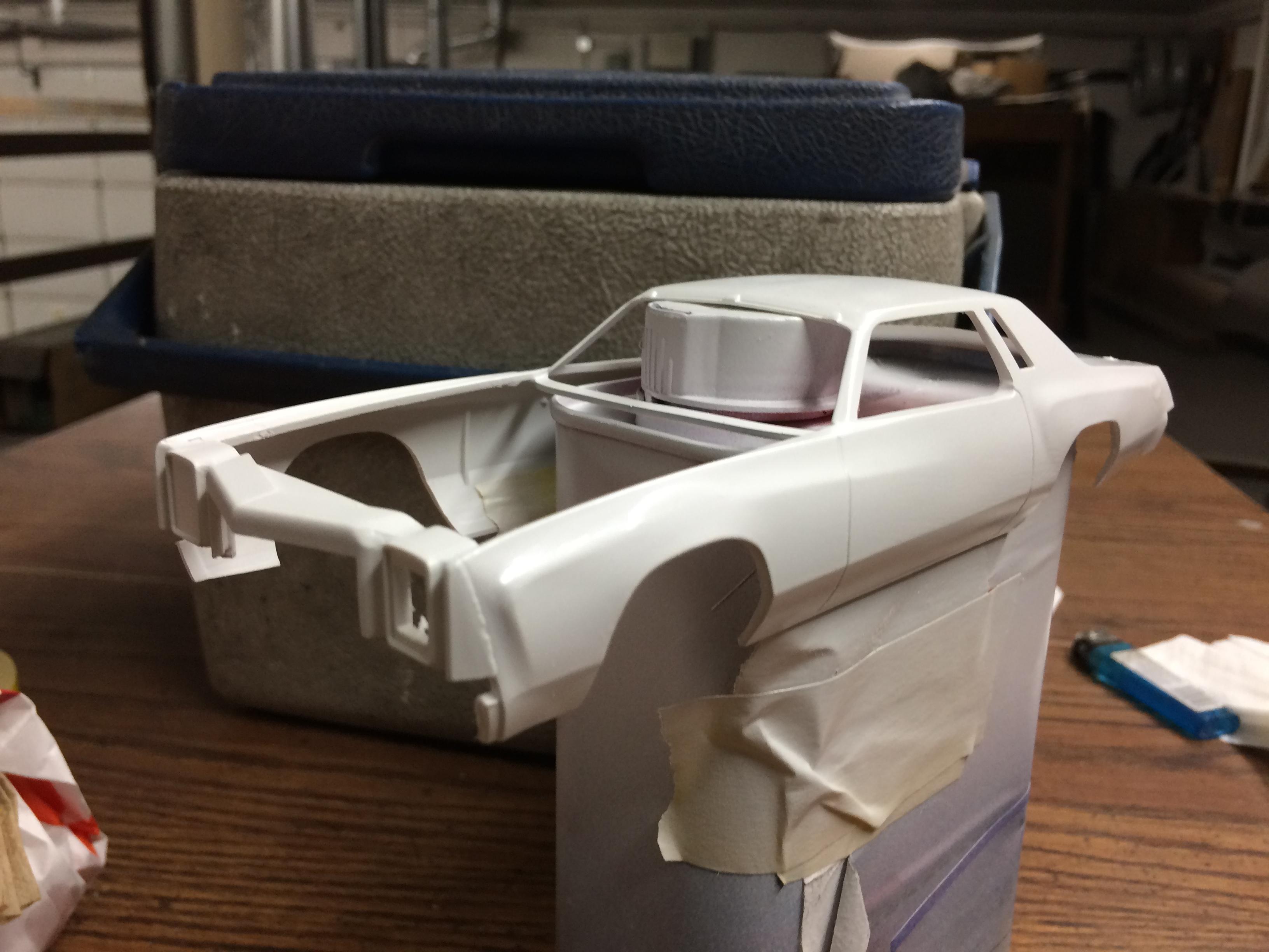

yellowsportwagon Posted November 11, 2019 Author Posted November 11, 2019 Next I puttied all that stuff up. Then I noticed the trunk was wrong for the car I’m doing. I had to fill the spoiler groove. I’ll have to make a spoiler. The kit spoiler wouldn’t work with the decals that have to go on the back of the trunk. Also the trunk had no seam where the trunk and filler panel above the bumper would meet. So I corrected that and added a fuel over flow to the right taillight cover. The top groove is where I added plastic to cover the spoiler groove. It will be puttied tomorrow.

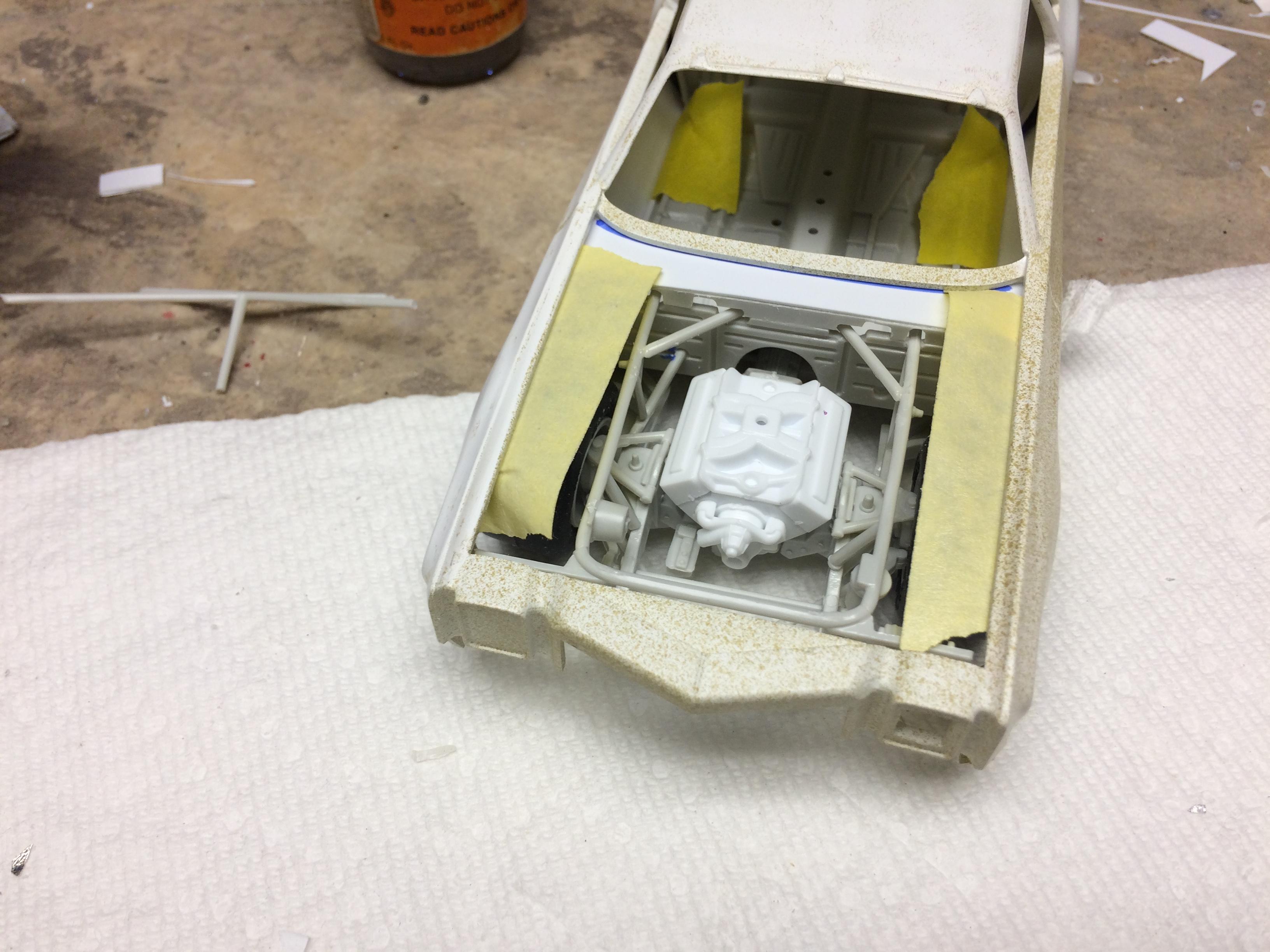

yellowsportwagon Posted November 11, 2019 Author Posted November 11, 2019 Finally opened a cooler slot in the headlight cover. Set it in its chassis to check tire wheelwell relationship. I previously opened up the wells to match pictures I have of the car.

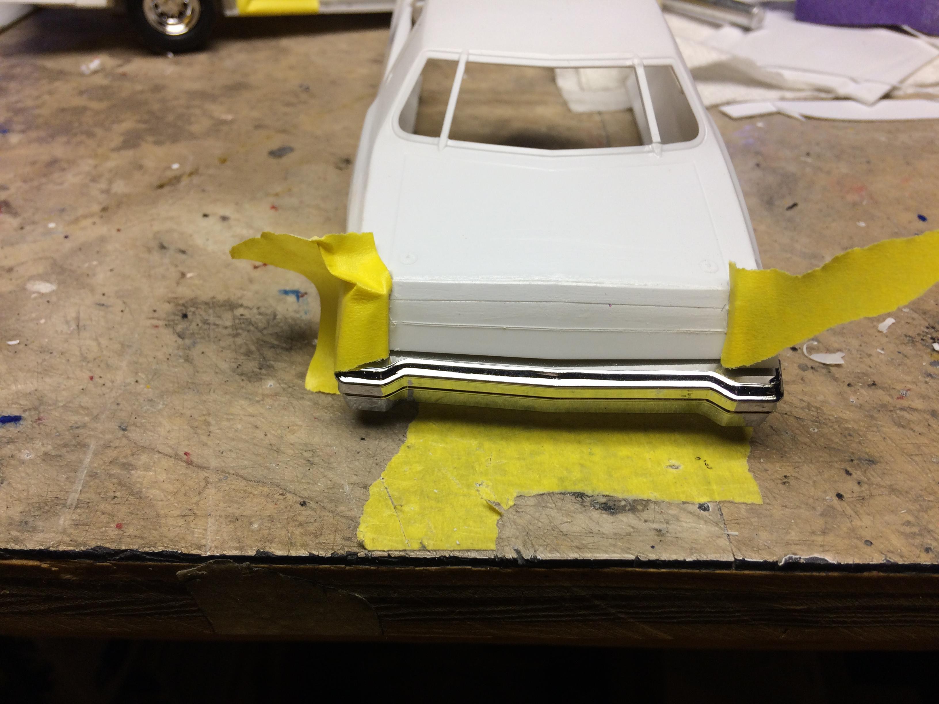

yellowsportwagon Posted November 11, 2019 Author Posted November 11, 2019 Forgot the most important mod as far as I’m concerned. Tuck that stupid rear bumper in. I cut about 3/32 of an inch off the rear bumper fairings and moved that sucker forward. Makes a world of difference. Plus it’s correct they always tucked those rear bumpers.
MarkJ Posted November 11, 2019 Posted November 11, 2019 Tim, Its sad that you have to do so much work to make this model look right. One other thing that looks off to me are the taillights. They look like they stick out too far to the rear. Its probably just me. I'm sure you have this thing figured out and it will look awesome when you are done.
Nitrobarry Posted November 11, 2019 Posted November 11, 2019 I agree with Mark but at least you showed us how to do it right!
yellowsportwagon Posted November 11, 2019 Author Posted November 11, 2019 (edited) 1 hour ago, MarkJ said: Tim, Its sad that you have to do so much work to make this model look right. One other thing that looks off to me are the taillights. They look like they stick out too far to the rear. Its probably just me. I'm sure you have this thing figured out and it will look awesome when you are done. I agree but if I mess with them the bumper will not look right. I don’t think they are really all that bad. Believe it or not I don’t mind doing this kind of stuff. It’s kinda satisfying to look at it and say see I knew I could fix that. Edited November 11, 2019 by yellowsportwagon

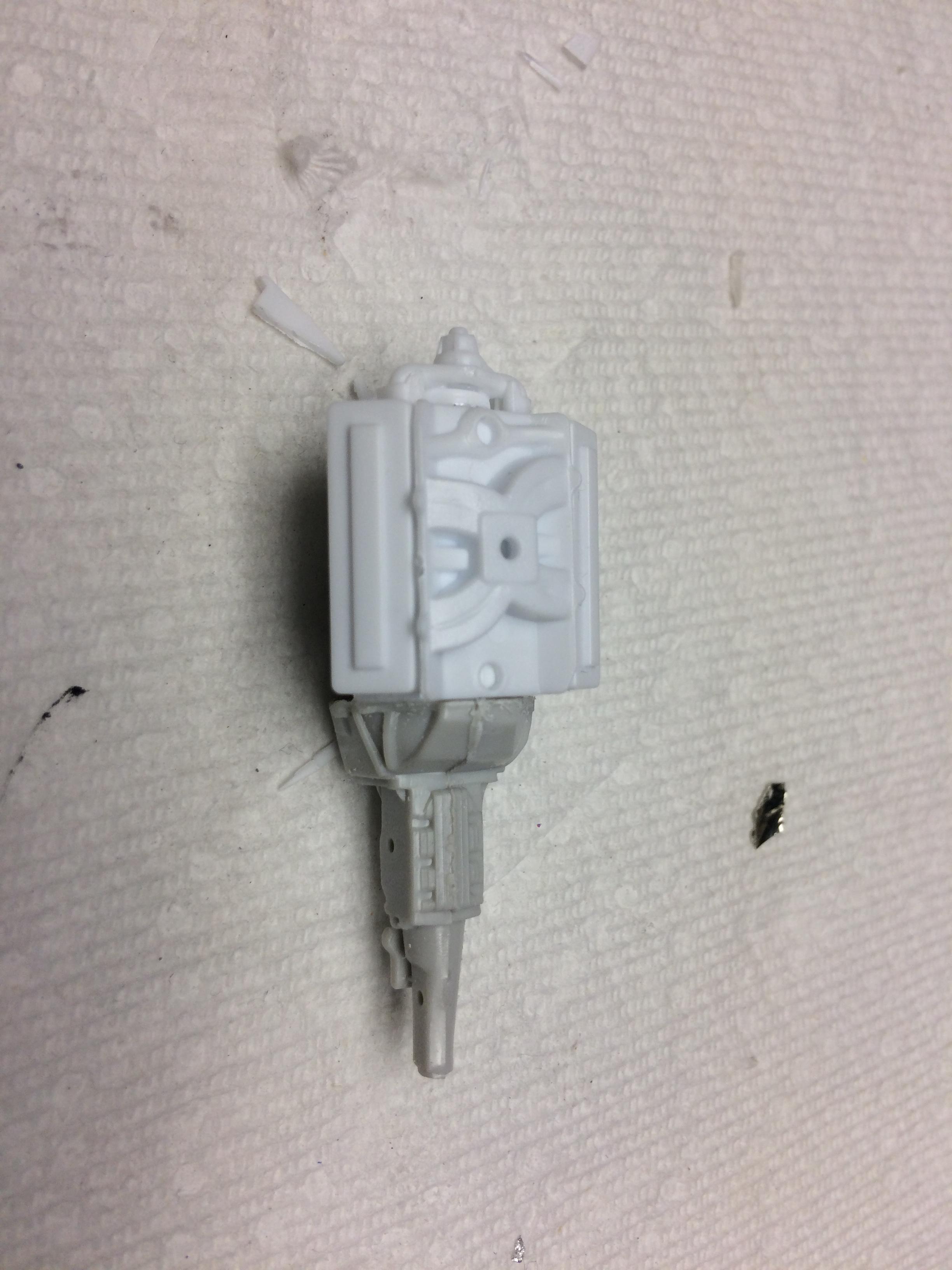

yellowsportwagon Posted November 12, 2019 Author Posted November 12, 2019 Salvinos engine mated to AMT transmission and mocked up in chassis.

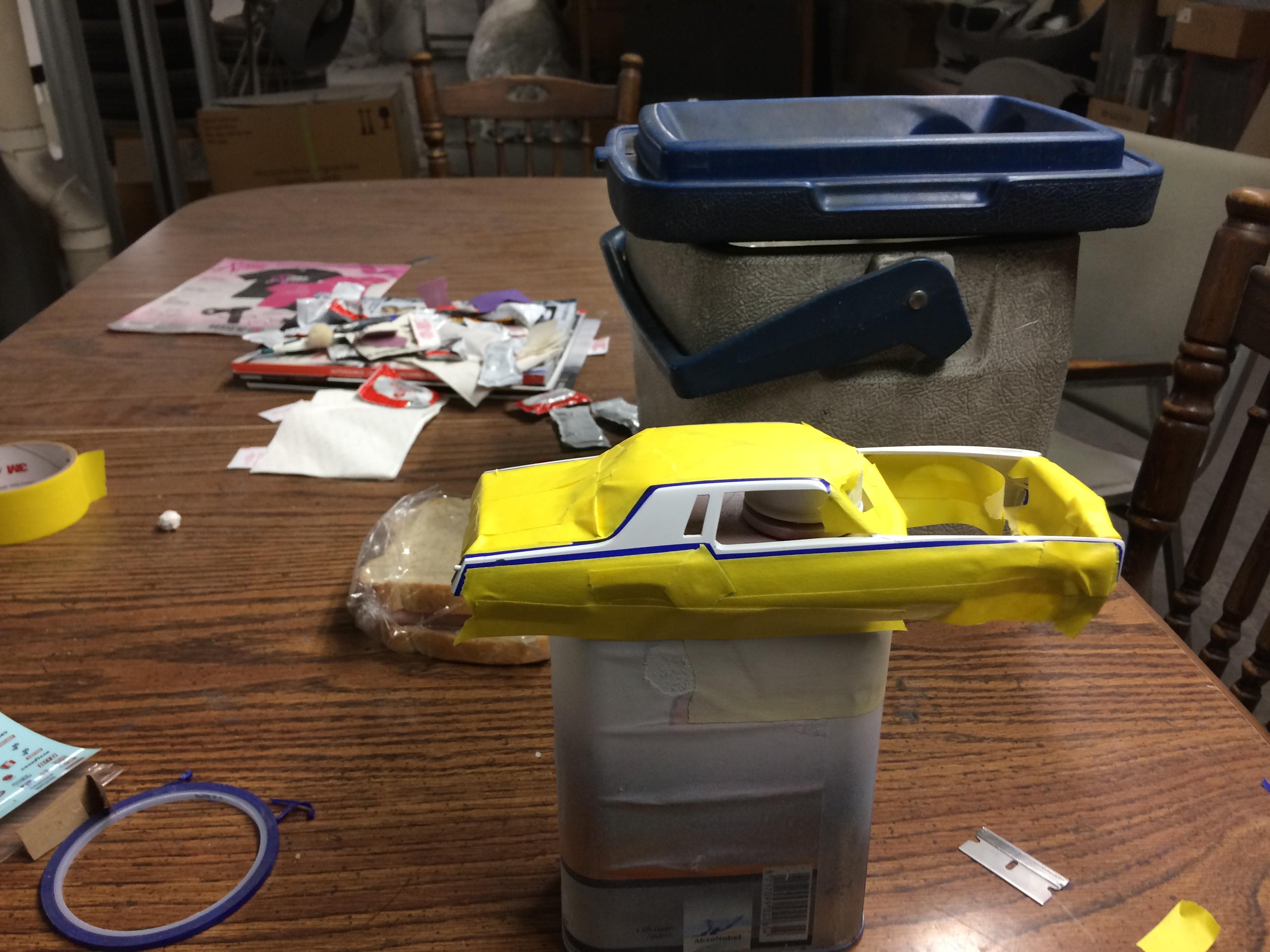

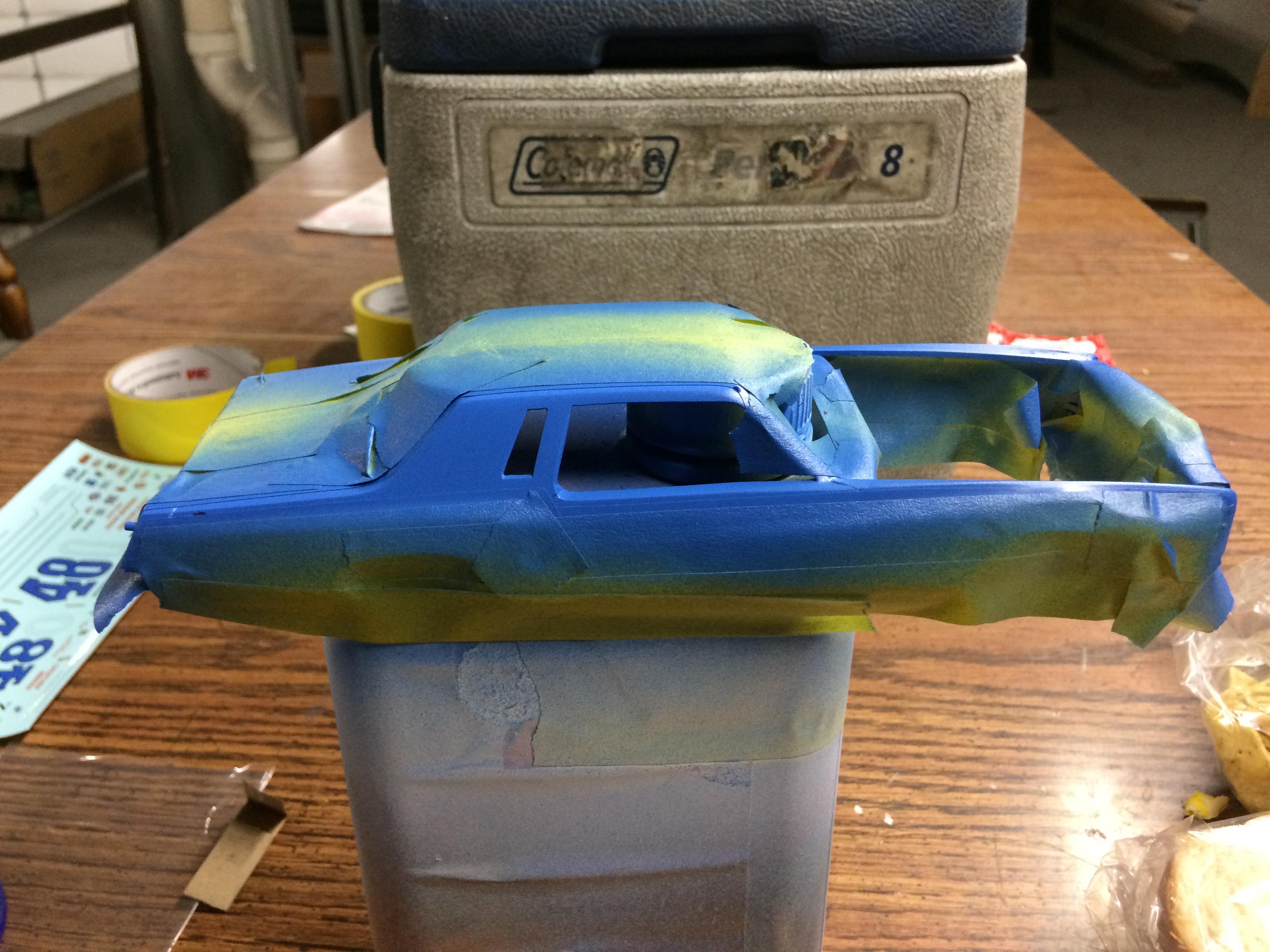

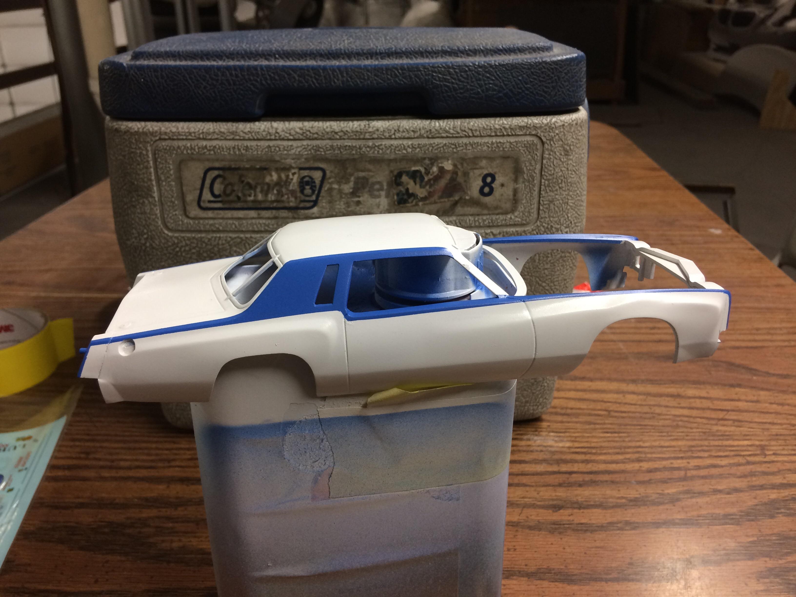

yellowsportwagon Posted November 13, 2019 Author Posted November 13, 2019 Basecoat done ready for clear
yellowsportwagon Posted November 14, 2019 Author Posted November 14, 2019 8 minutes ago, MarkJ said: Looks perfect. What brand of tape is that? 3m blue fine line and the yellow is 3m too. Automotive masking tape.
MarkJ Posted November 14, 2019 Posted November 14, 2019 2 hours ago, yellowsportwagon said: 3m blue fine line and the yellow is 3m too. Automotive masking tape. Where do you purchase it?
yellowsportwagon Posted November 14, 2019 Author Posted November 14, 2019 2 hours ago, MarkJ said: Where do you purchase it? Any automotive paint store should have it.
