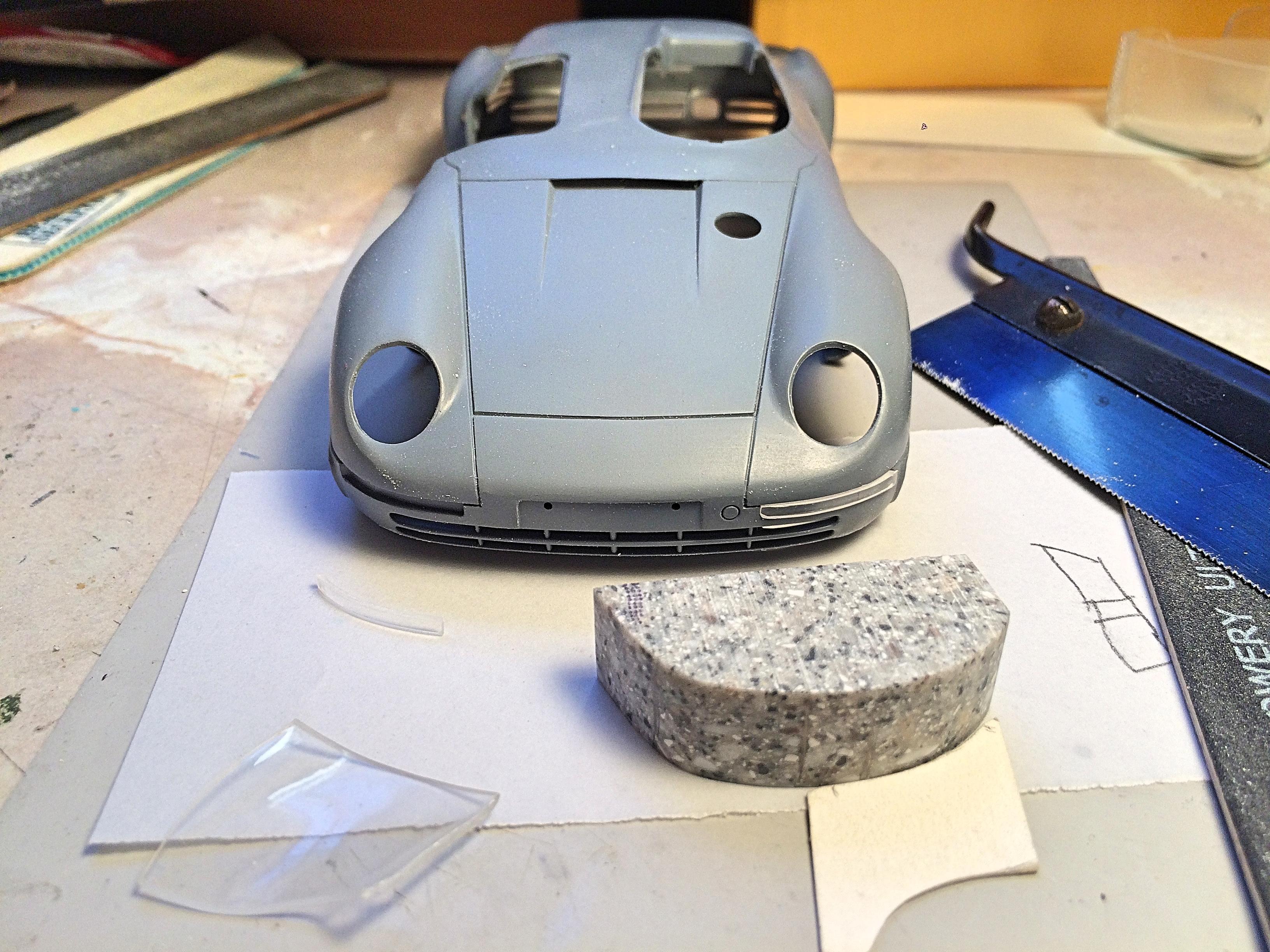

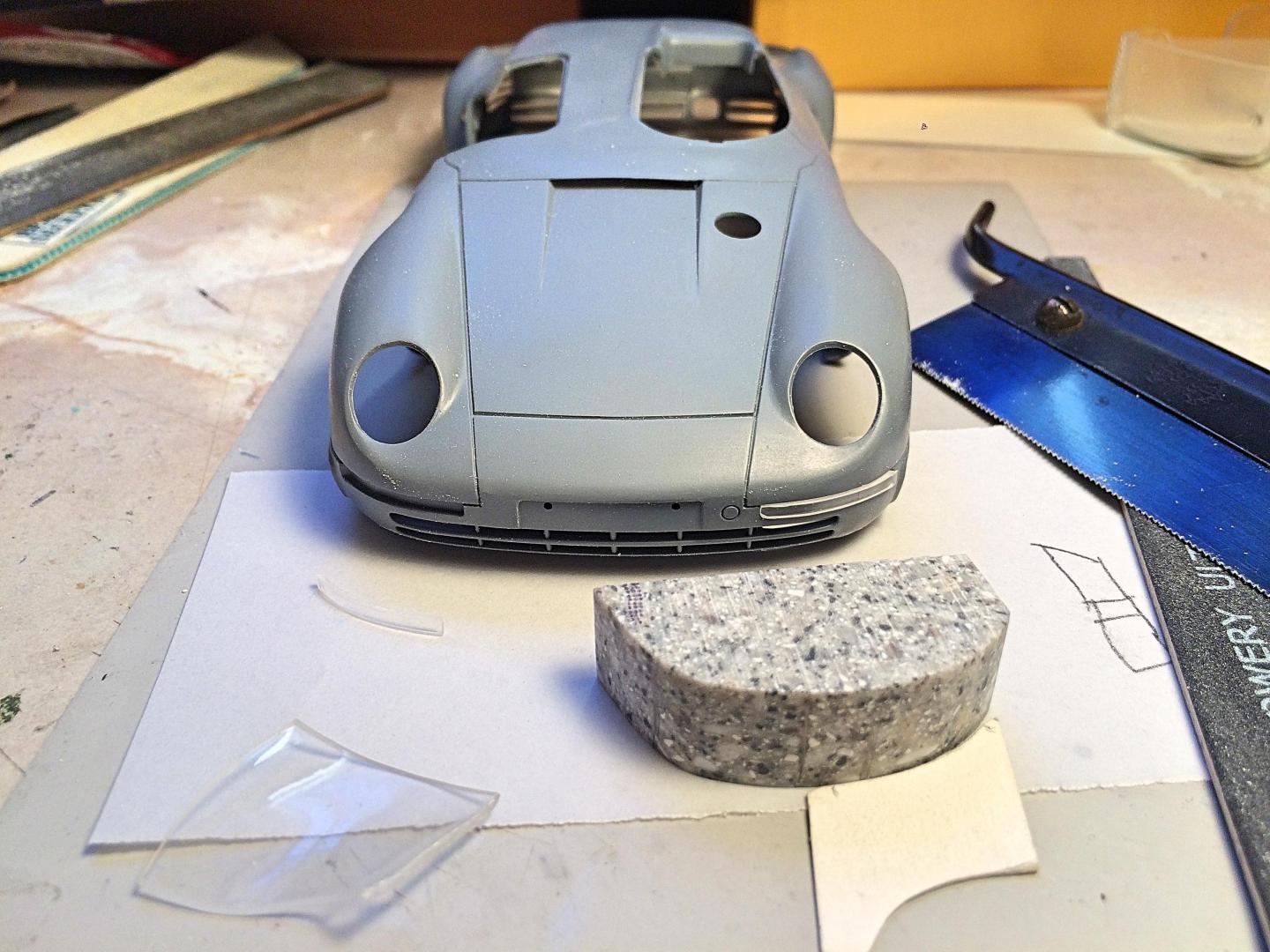

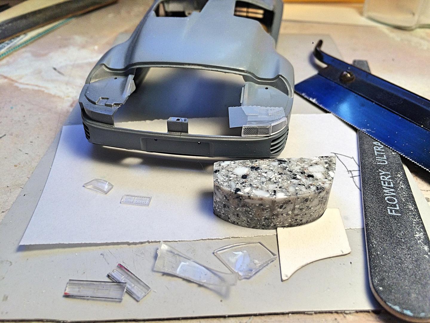

89AKurt Posted November 14, 2019 Posted November 14, 2019 Here is the hard way.... Make a pattern, I used Corian because it shapes easy and is resistant to heat (can bend metal sheet, say a soup can for example). Profile should be the back, my mistake was outside profile. Use a parts box windshield, heat over your range to get it soft (hold with pliers), then slap on the form. The piece should be much larger, then pick the best section, saw cut (don't use a knife), sand edges to final shape. You could do aftermarket "Alteza" style lights too, they are clear lens with round red lights. If you aren't a sadomasochist, then ignore this. ? 1
SCRWDRVR Posted November 14, 2019 Author Posted November 14, 2019 18 minutes ago, Brutalform said: Possibly a plastic drinking straw, cut to fit, painted silver, with some “stop light” red paint. Hmmmmm, possible, that gives me an idea though. I wonder is there is a soda bottle thats red? Dr. Pepper is to dark... 8 minutes ago, 89AKurt said: Here is the hard way.... Make a pattern, I used Corian because it shapes easy and is resistant to heat (can bend metal sheet, say a soup can for example). Profile should be the back, my mistake was outside profile. Use a parts box windshield, heat over your range to get it soft (hold with pliers), then slap on the form. The piece should be much larger, then pick the best section, saw cut (don't use a knife), sand edges to final shape. You could do aftermarket "Alteza" style lights too, they are clear lens with round red lights. If you aren't a sadomasochist, then ignore this. ? I like the Alteza tail light idea, that's a good alternative and makes for much more leave way....

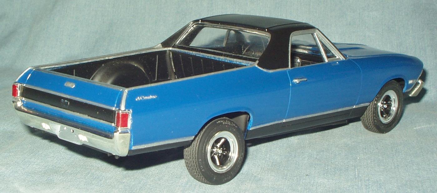

Snake45 Posted November 14, 2019 Posted November 14, 2019 Keep your eyes open for all the vac-formed food and "bubble" packaging that comes your way. Sooner or later you might find one with corners of just the radius you need. Cut your taillights from this plastic, then color it with either Model Master Clear Red Acryl or (I'm not kidding) a red Sharpie (on both sides). I made the missing right taillight for this glue bomb rescue Elky from a Walmart blueberry container (just folded the plastic) colored with red Sharpie. It actually fits and looks better than the kit part on the left.
