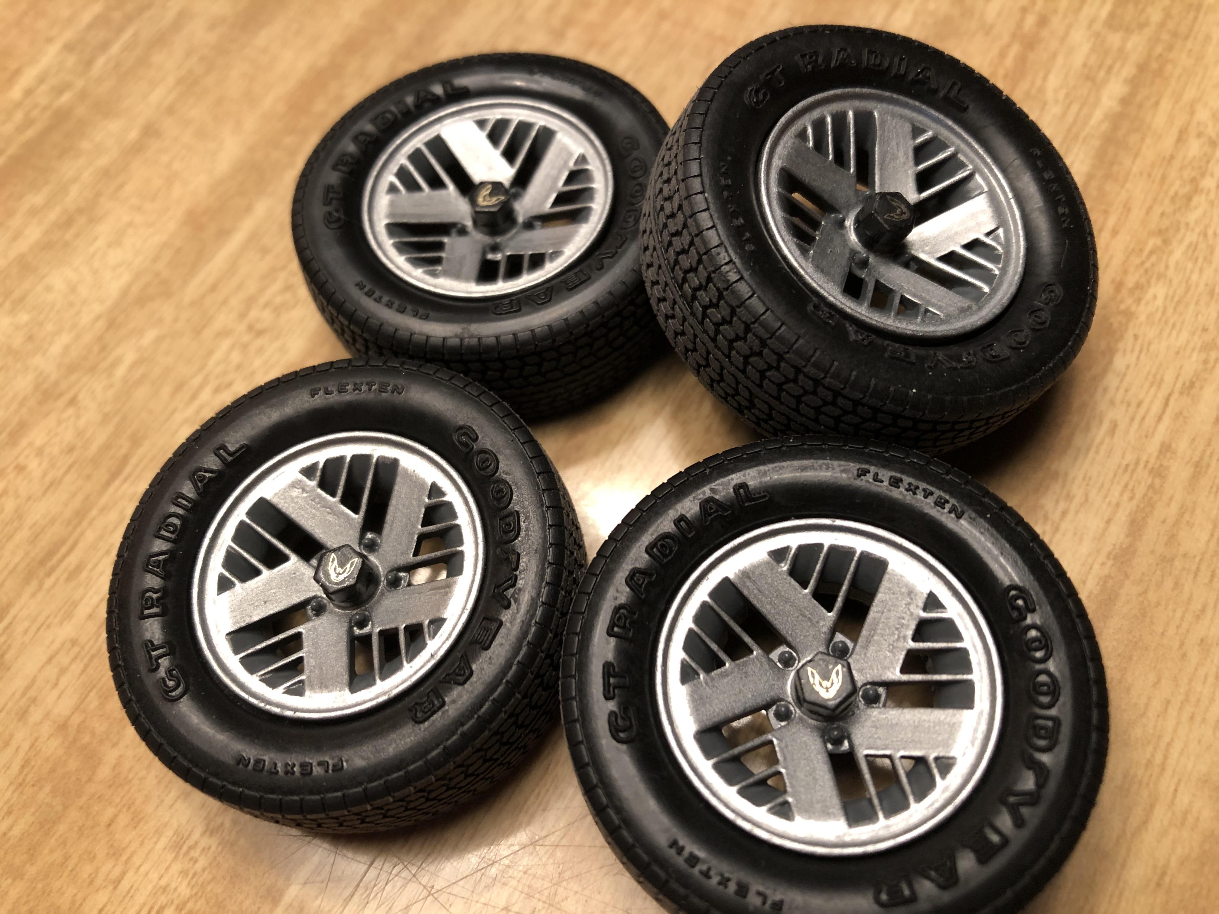

Safire6 Posted November 23, 2019 Author Posted November 23, 2019 These are the center cap decals (from echoxrayniner) that I applied using everyone's suggestions. They measure .15" diameter. They are on Trans Am wheels that camaro69 modeled for me and Shapeways made. Soon they'll be on the 1/16 AMT kit that echoxrayniner made additional decals for. I'm happy with the way the wheels and decals turned out.
