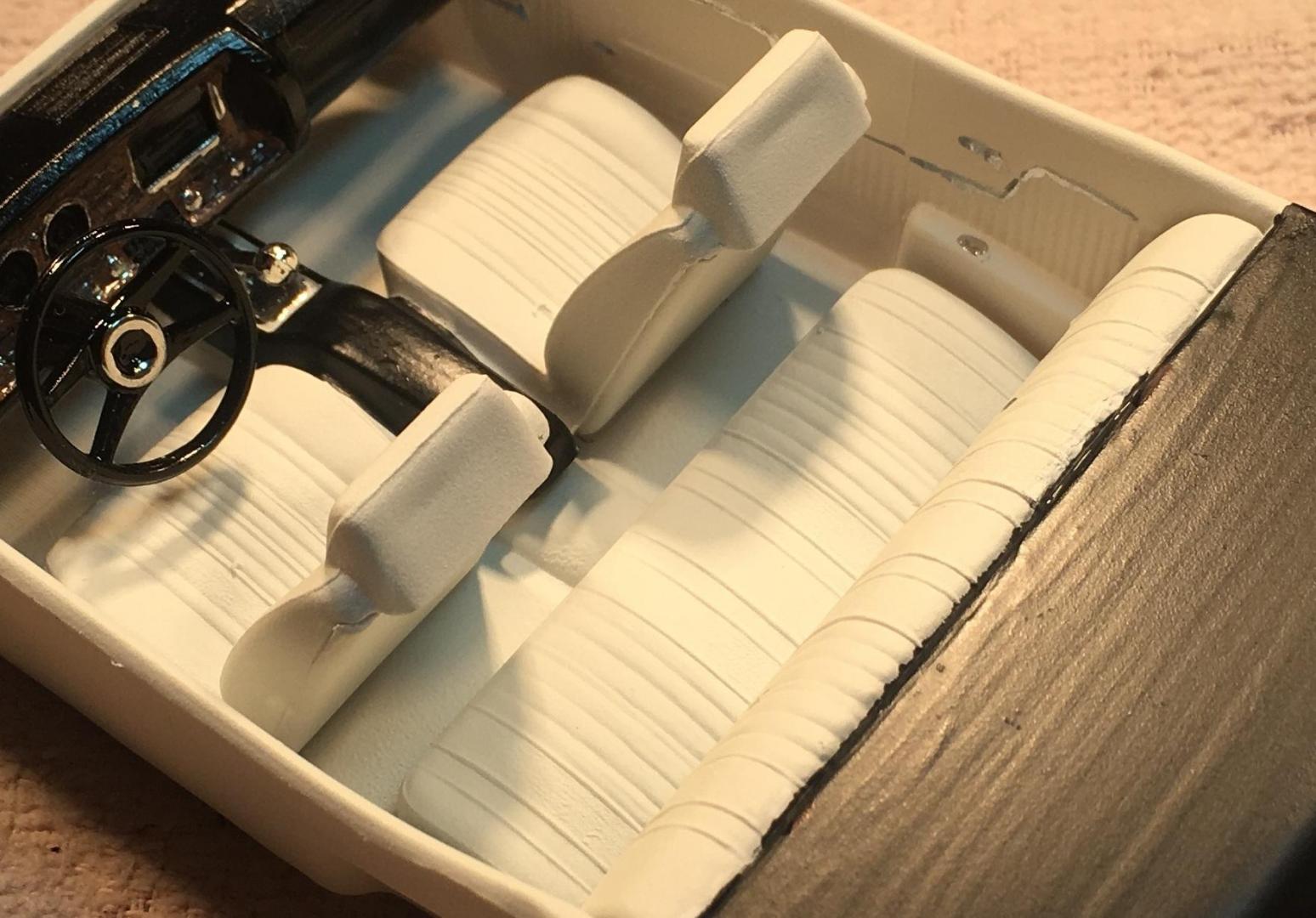

Bills72sj Posted November 22, 2019 Posted November 22, 2019 (edited) This model was built to loosely resemble a black over red 70 Grand Prix I owned for a number of years in the late 90's. It started out as a built-up glue bomb purchased on ebay. It was brush painted blue and looked pretty bad at first. After a dip in the "purple lake" I surveyed what was salvageable. The body, bumpers and interior were fair but the engine was a blob. Fortunately, I had a Revell Parts-Pack Pontiac 421. I soaked it in Westly's to dechrome it and sourced the stock air cleaner and other items from the parts bin. I actually made my own wired distributor from supplies picked up at Radio Shack and Hobbytown USA. I used a technique I learned on Drastics about BMFing emblems BEFORE painting and then scraping off the paint on the raised areas to expose the letters. It actually worked quite well. Especially since the "Grand Prix" emblems are separate block letters. It did a fair job on the front fender louvers as well. The interior is pretty basic, with just some minor detailing. The underside being an old MPC offering with chassis screws, is nothing to write home about. I did do my signature red mufflers (a throw back to the Cherry Bomb glass pack days). The engine compartment is anatomically all wrong compared to a real GP. Especially in the fan shroud/radiator areas. I did not have the parts to correct it though, so it is what it is. The mags are Modelhaus Keystone Klassics which have been painstakingly detailed. I performed my signature rear tire widening technique to fill in the rear wheel wells. The tires have been lettered with a "Gelly Roll" pen from a local stationary store. The windows were boogered up but, using progressively finer grit polishing cloths, finished off with a coat of Future, they look as good as new. Sharpie markers applied here and there round out the small details. I am pretty pleased at how my first restoration turned out. Edited November 22, 2019 by Bills72sj Change picture

StevenGuthmiller Posted November 23, 2019 Posted November 23, 2019 18 hours ago, Geno said: I have a '69 kit I'm going to build to emmulate my 1:1 '69. I do as well. I'm going to give mine the full treatment. That will include a good portion of the guts from the '70 Monte Carlo kit. (ie, chassis and most of the engine bay detail). My goal is to transform my kit from an SJ to a J model, which is what my 1:1 is. The toughest part of that transformation will be changing the seat upholstery from the wide horizontal pleats of the SJ, to the narrower vertical pleats of the Model J. That is unless I can find seats that are reasonable facsimiles to the correct Model J seats. Steve

Bills72sj Posted November 23, 2019 Author Posted November 23, 2019 8 hours ago, StevenGuthmiller said: I do as well. I'm going to give mine the full treatment. That will include a good portion of the guts from the '70 Monte Carlo kit. (ie, chassis and most of the engine bay detail). My goal is to transform my kit from an SJ to a J model, which is what my 1:1 is. The toughest part of that transformation will be changing the seat upholstery from the wide horizontal pleats of the SJ, to the narrower vertical pleats of the Model J. That is unless I can find seats that are reasonable facsimiles to the correct Model J seats. Steve Steve, I just looked at some of my built A-bodies, The Monte has vertical pleats, A 69 Olds has vertical pleats with a little bolstering and and old 72 Chevelle has the with wider pleats on the outside edges
StevenGuthmiller Posted November 23, 2019 Posted November 23, 2019 21 minutes ago, Bills72sj said: Steve, I just looked at some of my built A-bodies, The Monte has vertical pleats, A 69 Olds has vertical pleats with a little bolstering and and old 72 Chevelle has the with wider pleats on the outside edges I have done a little looking, and while there are some seats from other kits, they all would require some modification. The pleats in the '69 GP only run about 2/3 of the way up the seats. Steve
