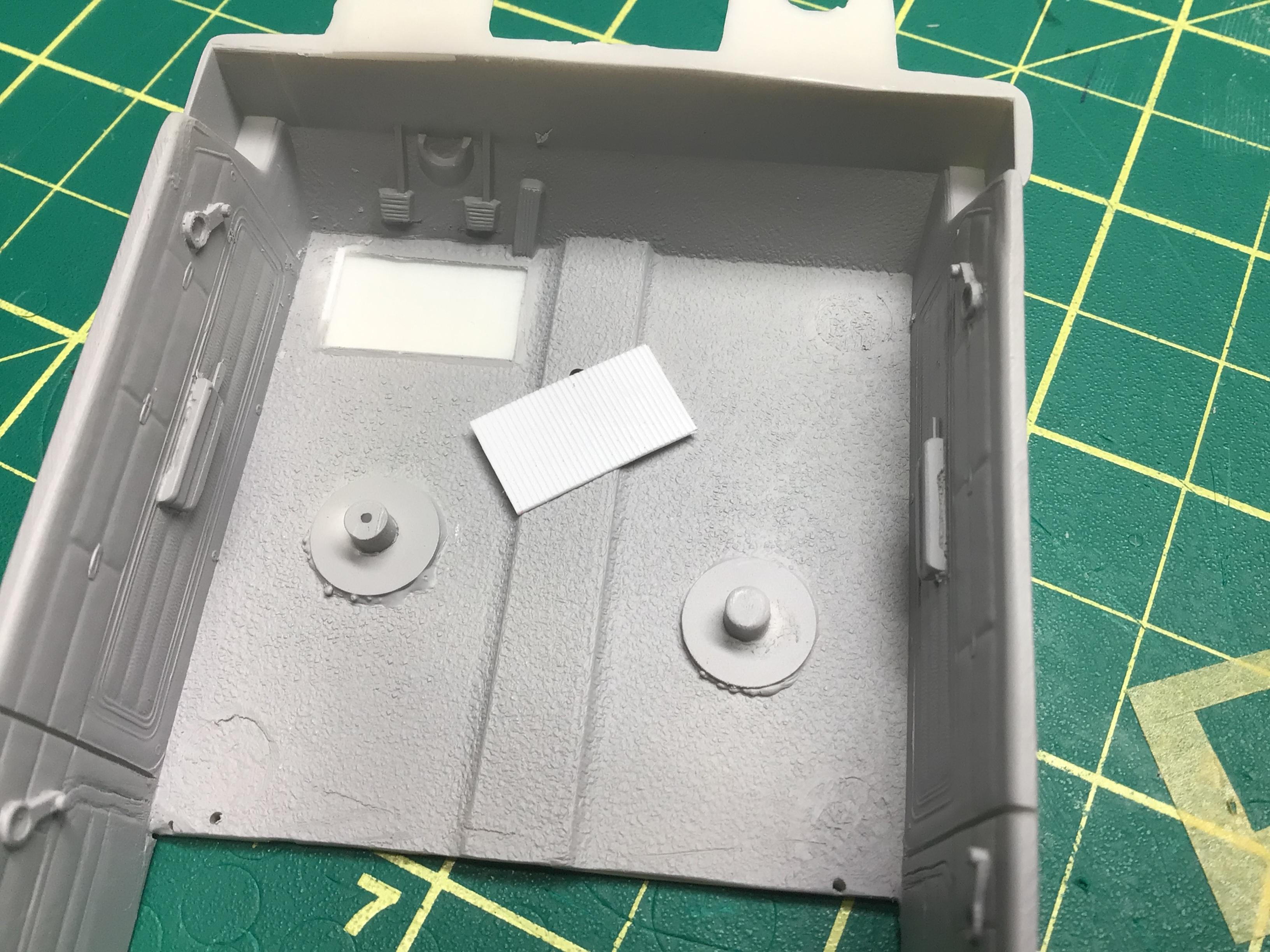

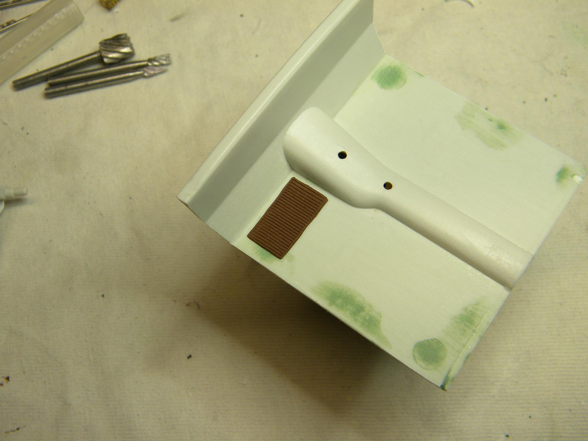

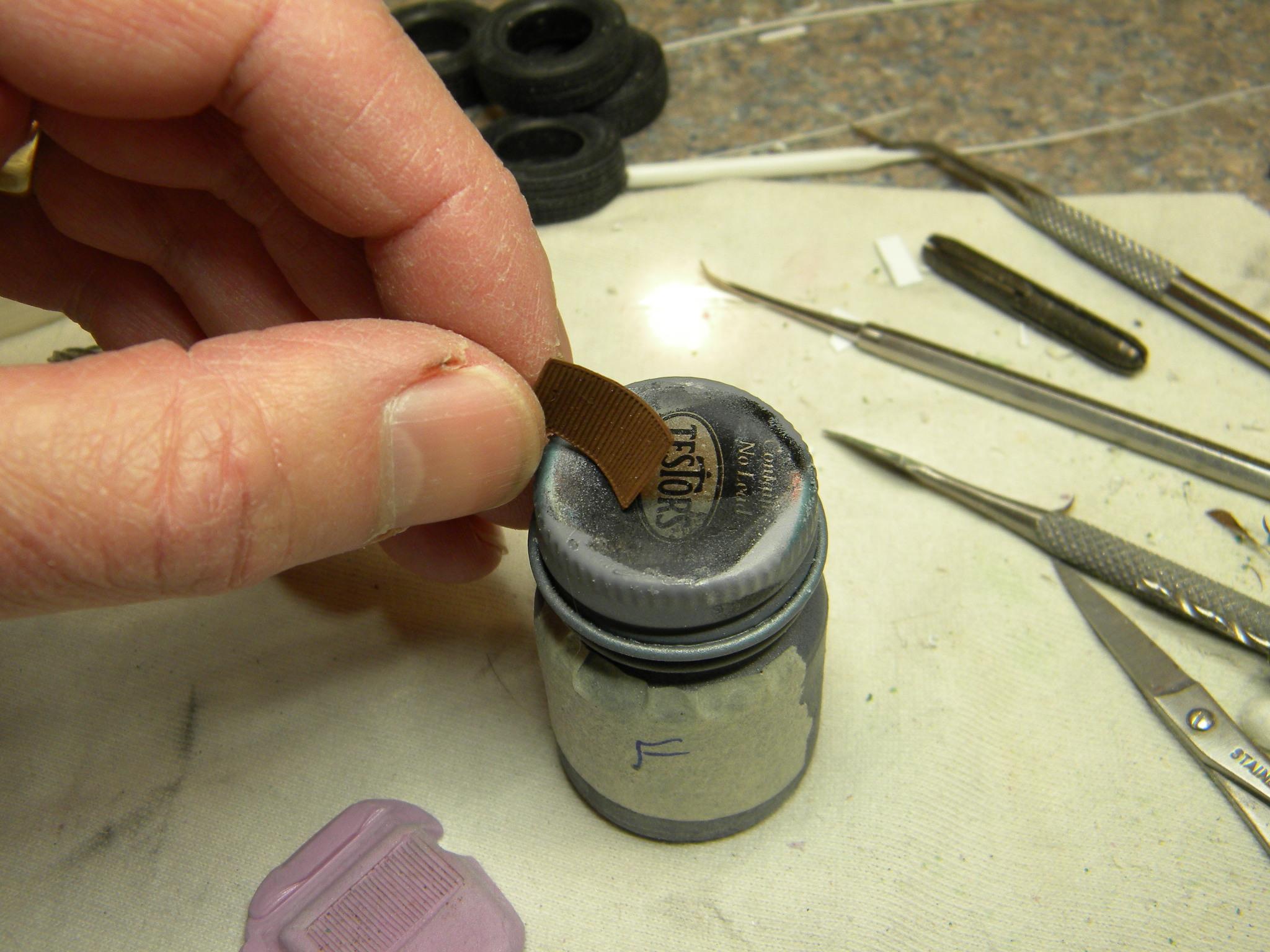

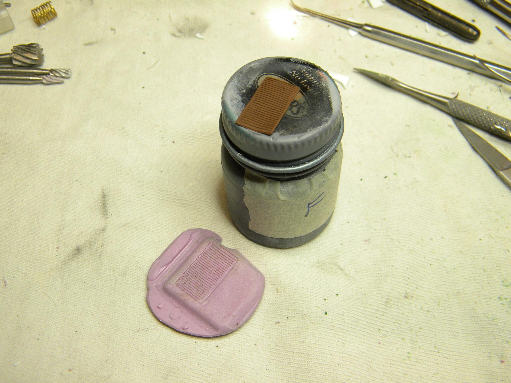

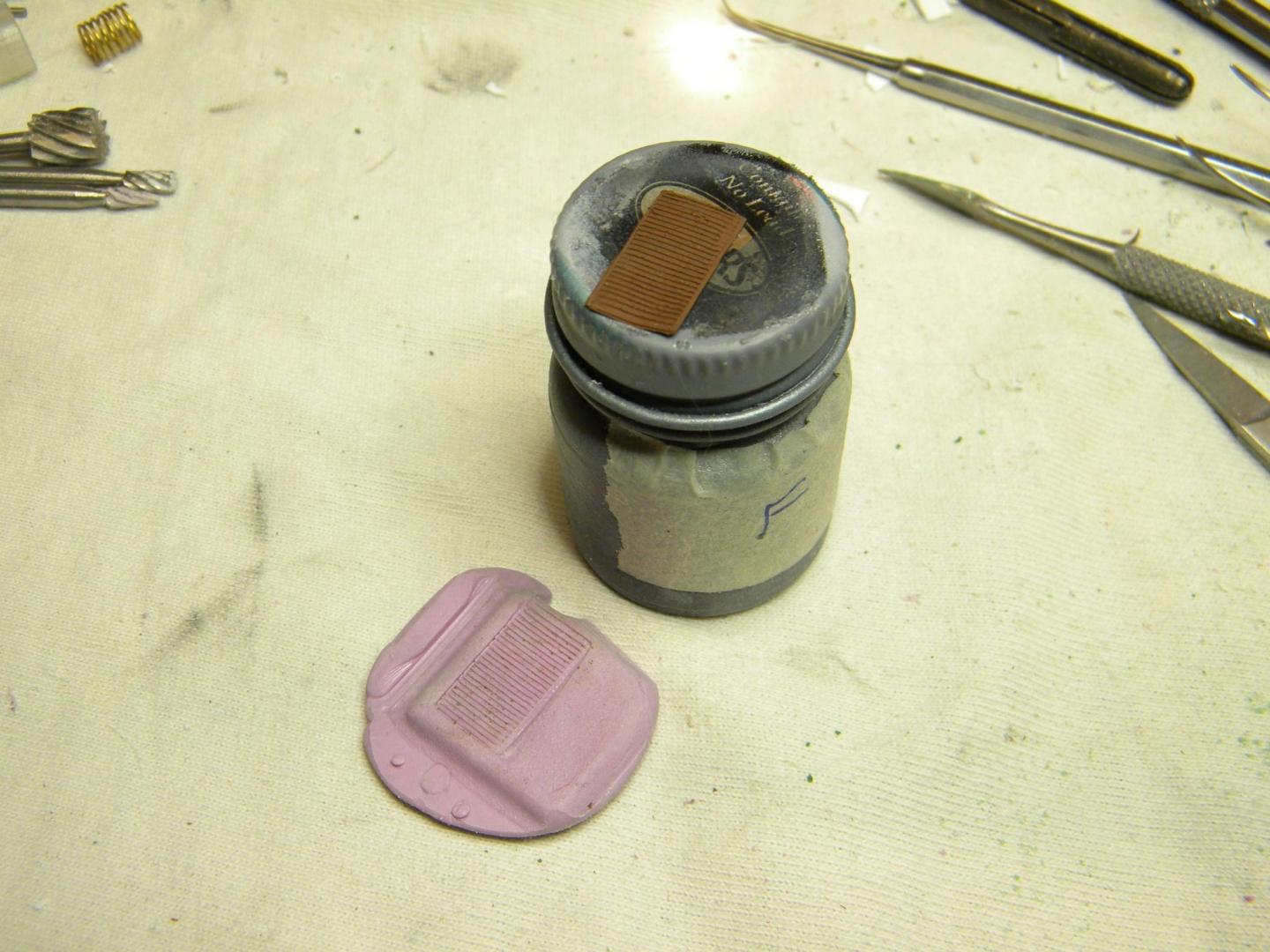

StevenGuthmiller Posted November 27, 2019 Posted November 27, 2019 Here's a little trick that some might find useful. I picked this technique up somewhere, I just don't remember from whom. I decided that I wanted to replicate the drivers side "floor protector" mat on my current project after sanding of the interior tub floor was necessary after removing pedal detail and pin marks. A mold was made of the mat from another kit with mold putty. (in this case the AMT '62 Catalina kit) Then a relatively thick coat of acrylic craft paint, in your color of choice, was flowed into the mold. After drying, the mat can be carefully peeled from the mold and trimmed creating a very thin and flexible mat to be installed after flocking. This technique can be used for many other applications including floor mats and seat and door panel upholstery. Thank you to whomever I stole this technique from originally! Steve 5

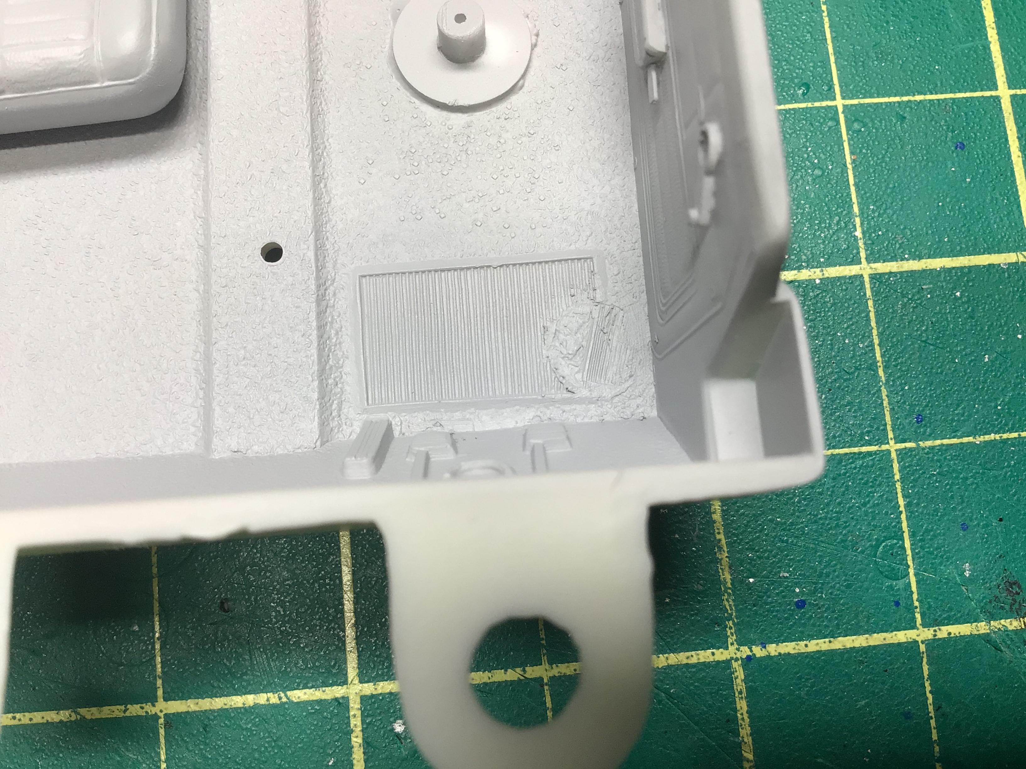

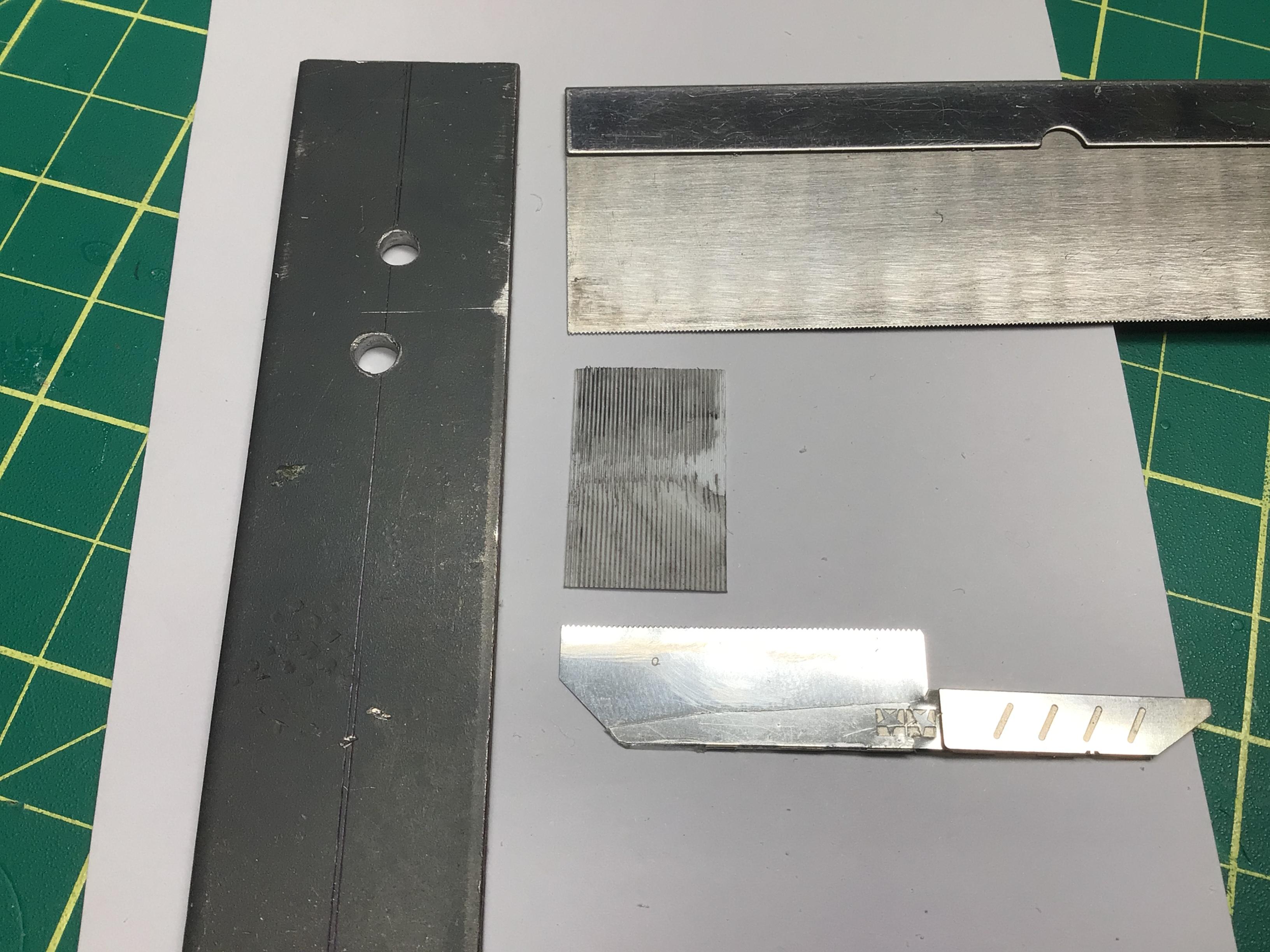

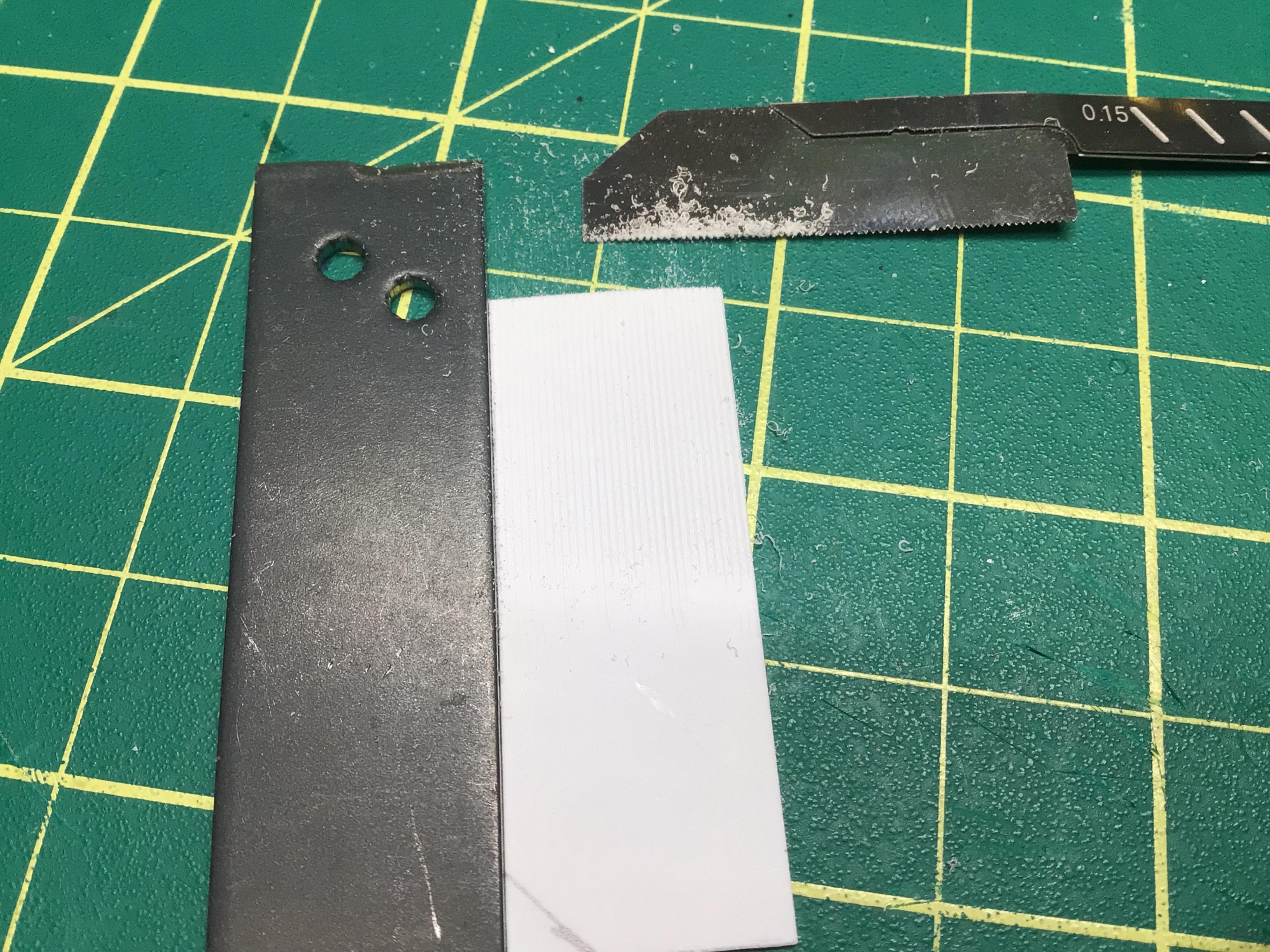

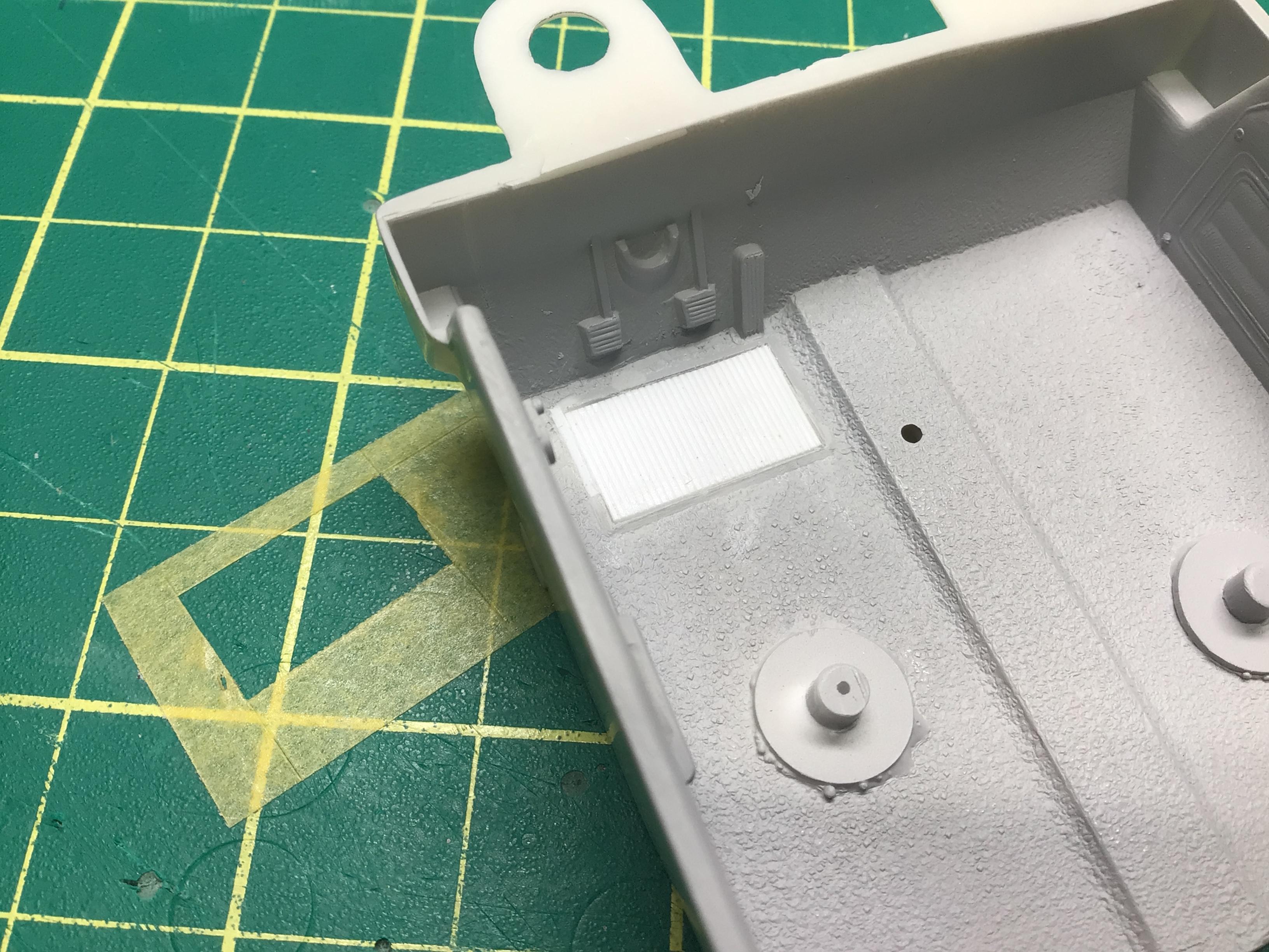

NOBLNG Posted October 18, 2024 Posted October 18, 2024 (edited) No point in starting another thread I think. I just want to add to this great tutorial how I went about fixing an ugly floor mat. I scraped out the interior section, leaving the border intact. Added a sliver of styrene to repair the outer edge and scraped it to shape. Then used a photo etch saw blade to scrape ridges into a piece of .015” thick styrene using a piece of metal as a guide fence. Cut it to size and glue in place with CA. Any fine tooth saw will work, but preferably one with non-directional teeth. Edited October 18, 2024 by NOBLNG 4
johnyrotten Posted October 18, 2024 Posted October 18, 2024 32 minutes ago, NOBLNG said: No point in starting another thread I think. I just want to add to this great tutorial how I went about fixing an ugly floor mat. I scraped out the interior section, leaving the border intact. Added a sliver of styrene to repair the outer edge and scraped it to shape. Then used a photo etch saw blade to scrape ridges into a piece of .015” thick styrene using a piece of metal as a guide fence. Cut it to size and glue in place with CA. Any fine tooth saw will work, but preferably one with non-directional teeth. Great technique. ? 1
