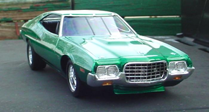

Dave Van Posted December 4, 2019 Posted December 4, 2019 1 hour ago, Fat Brian said: Ok, how I noticed the difference was I wanted to build a better detailed stock 72 so I tried to swap the Bobby Isaac stock car body onto the Revell chassis. When comparing the two kits it's like putting a 1/24th kit next to a 1/25th kit, I haven't run the numbers to see which one is correct. This is the Issac MPC body, JoHan Grille and JoHan interior and promo chassis......a Franken model!
LL3 Model Worx Posted December 4, 2019 Posted December 4, 2019 22 minutes ago, Dave Van said: This is the Issac MPC body, JoHan Grille and JoHan interior and promo chassis......a Franken model! That's a very nice model... Until I read your description I honestly thought it was a 1:1 at first glance! That reflection is what really had me fooled! Very well done!
Fat Brian Posted December 4, 2019 Posted December 4, 2019 40 minutes ago, Dave Van said: This is the Issac MPC body, JoHan Grille and JoHan interior and promo chassis......a Franken model! That looks very good, Dave. I bought a stock grille, rear bumper, and hood from a resin company and I'm going to take the back half of the Bobby Isaac cars roof and the top of the rear quarters and trunk area and transplant them onto the Revell kit along with some of the area around the grille.
