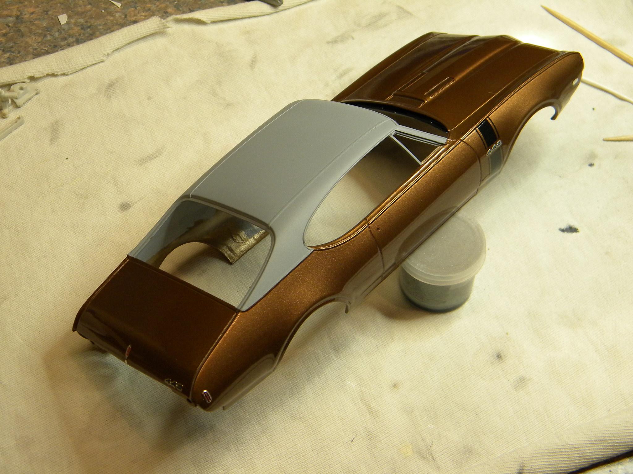

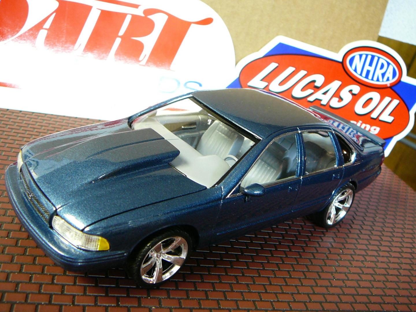

64SS350 Posted December 4, 2019 Posted December 4, 2019 (edited) Yes, just be sure to use an automotive type primer under it. Like Duplicolor or the like. Many have even used base coat/clear coat. Actually, MCW paints are PPG based. Here's a couple of mine Edited December 4, 2019 by 64SS350
2zwudz Posted December 5, 2019 Author Posted December 5, 2019 1 hour ago, 64SS350 said: Yes, just be sure to use an automotive type primer under it. Like Duplicolor or the like. Many have even used base coat/clear coat. Actually, MCW paints are PPG based. Here's a couple of mine Nice!!! Did you clear coat over the decals???
